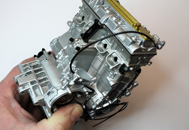

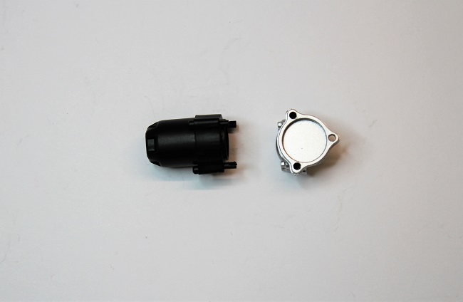

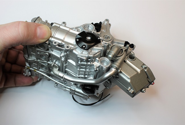

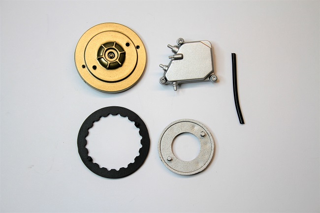

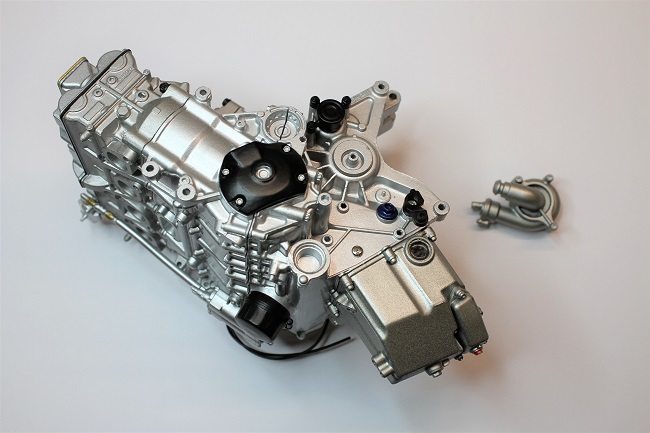

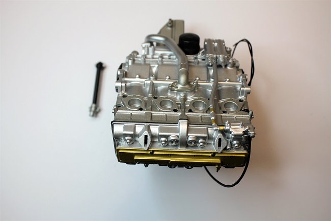

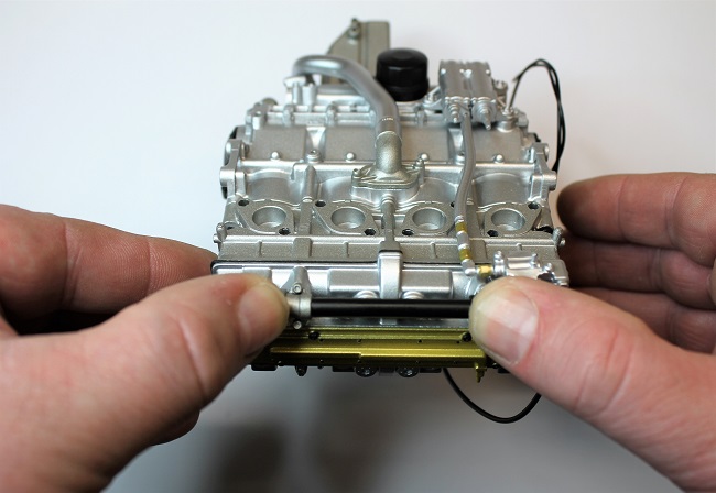

Stage 32
Contents: Oil pump,Pump cover, Coupling
Locating the holes in the oil pump and the corresponding pins on its cover,press the two together.Retrieve the engine block and orientate it to show the three holes on the left side.Align the pins on the pump with the three holes, and then press it into place.Press the two ends of the coupling into position.

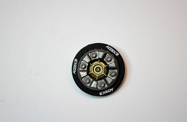

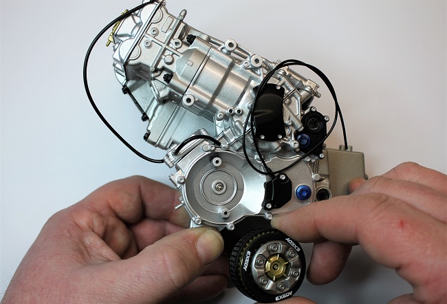

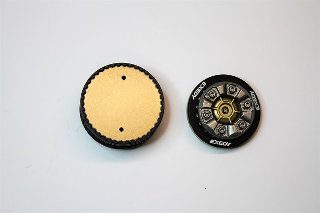

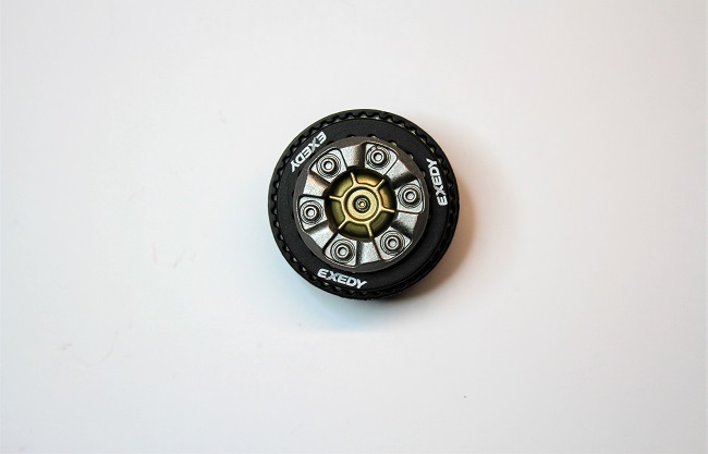

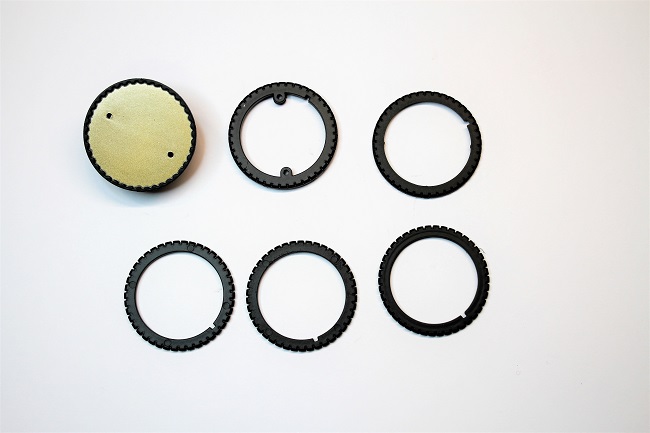

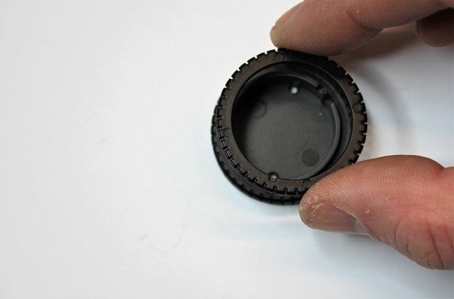

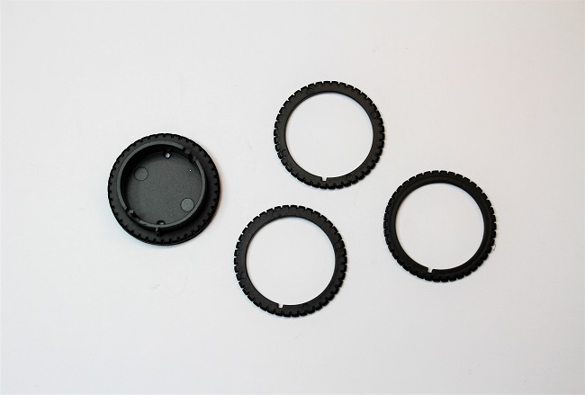

Stage 33
Contents: Clutch bell,Last plate,First plate, Intermediate plates x3
Prepare the clutch bell and the first plate. The notch on the inside of the plate corresponds with the tab on the bell.Place the first plate onto the bell, fitting the tab on the bell into the notch on the plate.Now take the three intermediate plates, and locate the notch on the inside of each one. As with the first plate, these notches correspond to the tab on the bell.Place all three intermediate plates onto the bell before fitting the final plate onto the bell, inserting the two pins into the holes in the plate.

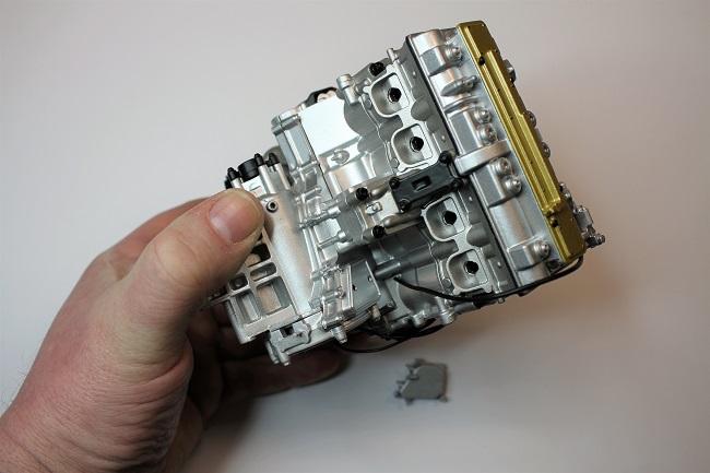

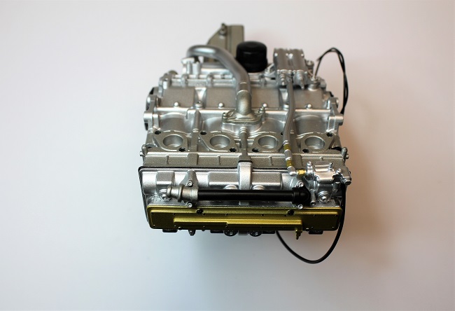

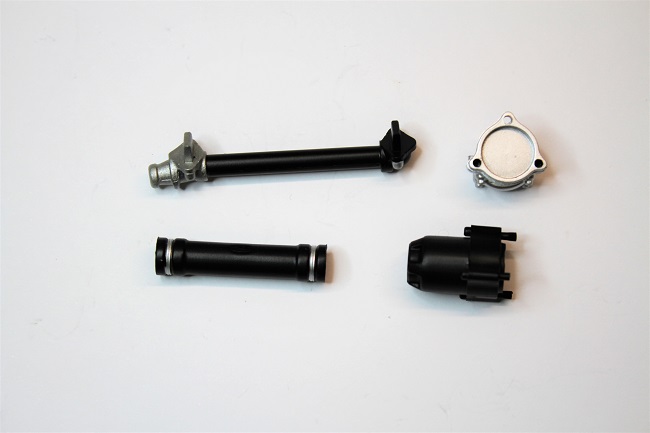

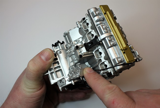

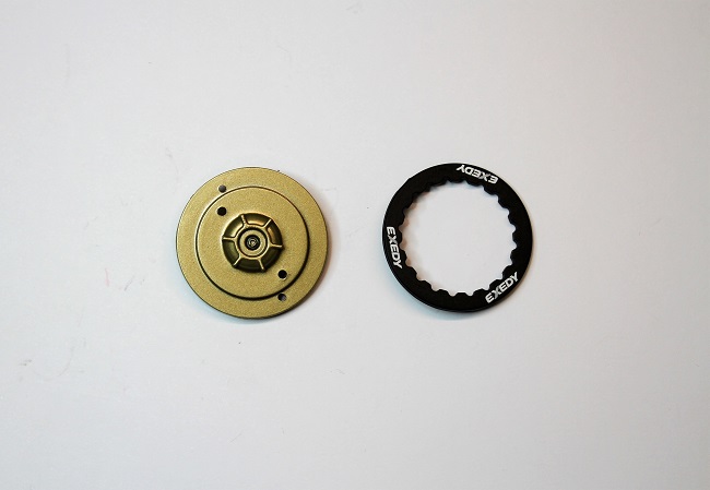

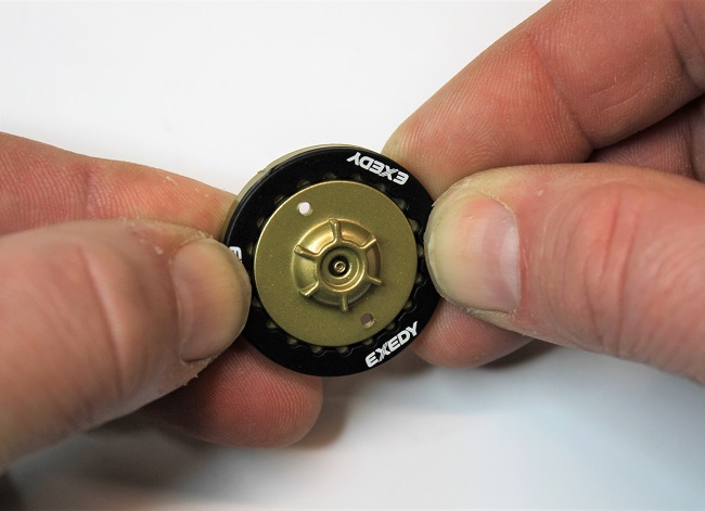

#3 Posted : 04 March 2019 18:55:36

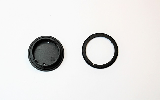

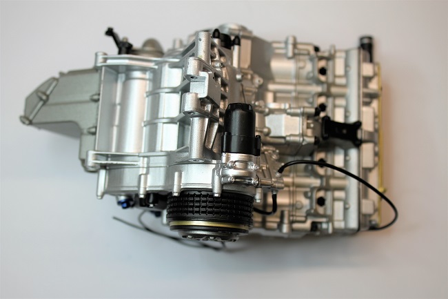

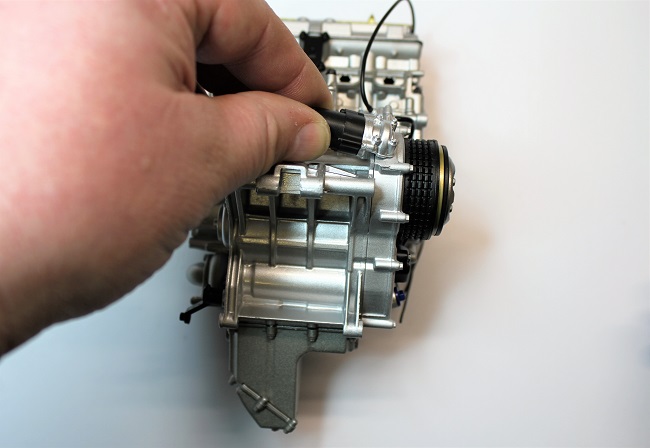

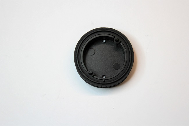

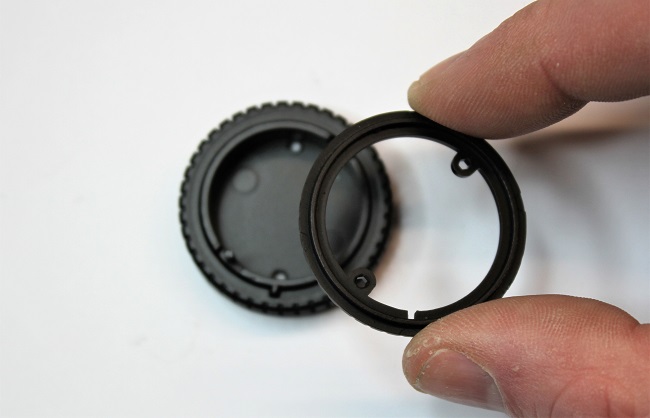

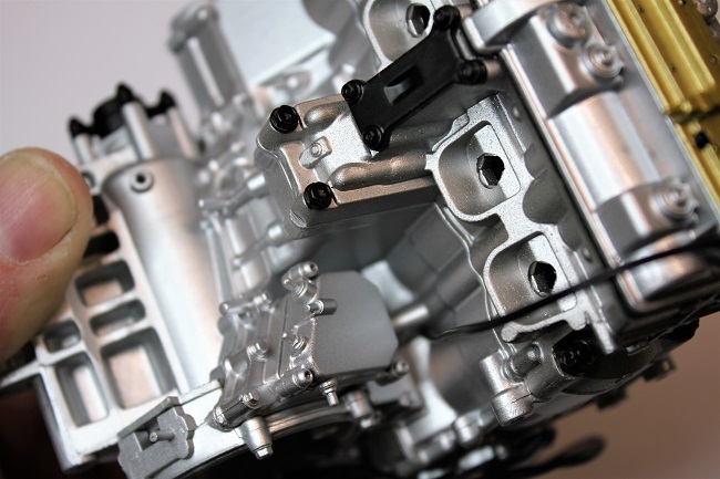

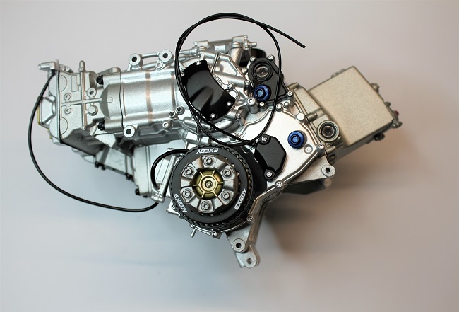

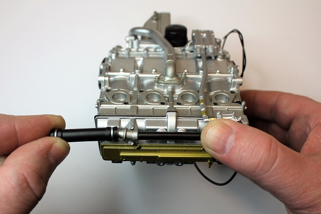

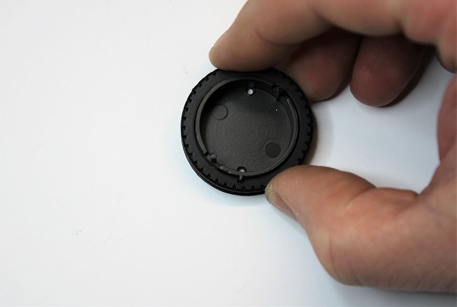

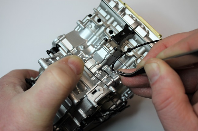

Stage 34
Contents: Box,Tube,Clutch cover,Clutch ring,Clutch flange
Place the box onto the engine, inserting the pins into the holes. Push the end of the tube coming out of the cylinder head onto the circled pin on the box.Locate the two circled pins on the right hand side of the engine and push the ends of the tube supplied with this stage onto the two pins.Insert the pins of the clutch ring into the holes on the clutch cover. Fit the clutch flange onto the clutch cover, inserting the pins into the holes. Retrieve the clutch assembly from Stage 33 placing the clutch cover into place on the rest of the clutch to complete the assembly.Finally insert the two pins on the reverse of the clutch into the two holes in the side of the engine block.

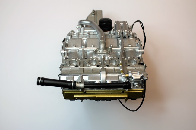

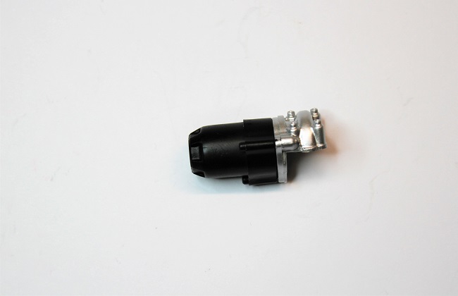

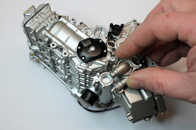

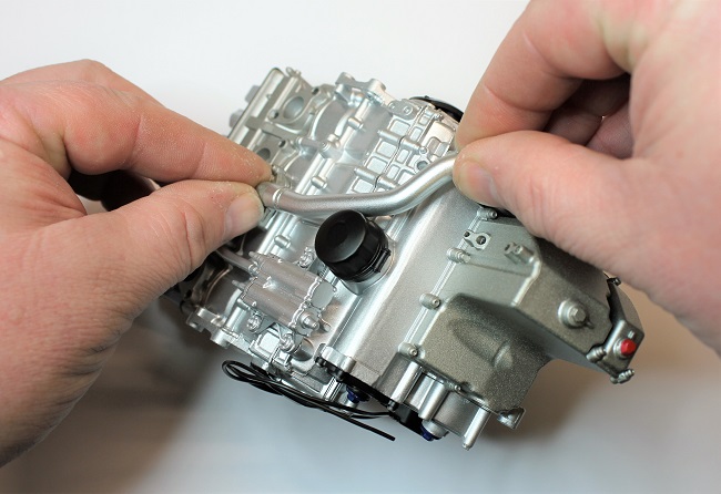

#4 Posted : 05 March 2019 21:24:58

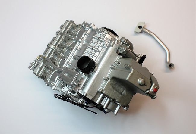

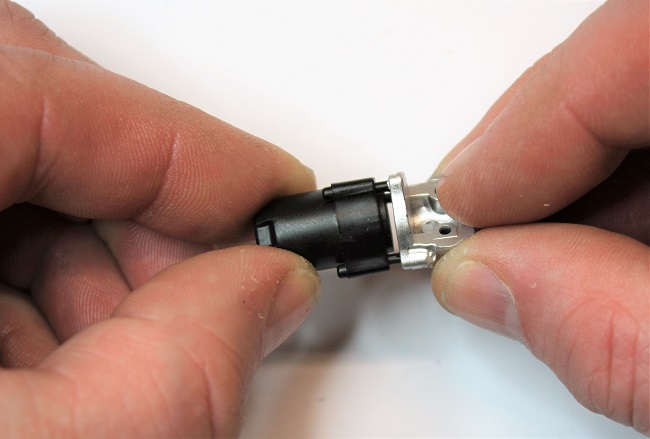

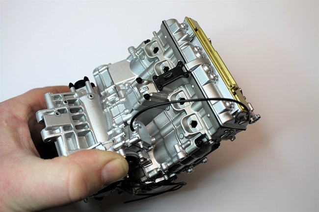

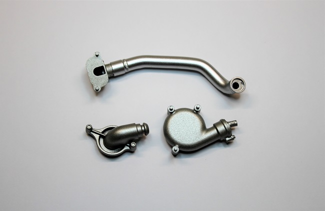

Stage 35

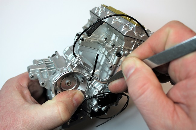

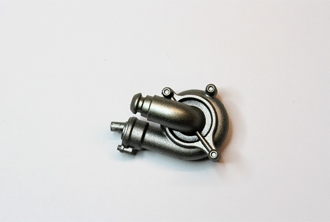

Contents: Coolant hose,Coolant pipe,Starter motor base,Starter motor
Take the coolant pipe, and insert the two tabs on the underside into the two slots in the cylinder head cover, noting its orientation.Now push the coolant hose onto the end of the pipe.Insert the pins of the starter motor into the corresponding holes in the starter motor base, and push the parts together.Locate the two holes in the starter motor and the two pins on the engine.Press the starter motor into place, inserting the pins into the holes.
