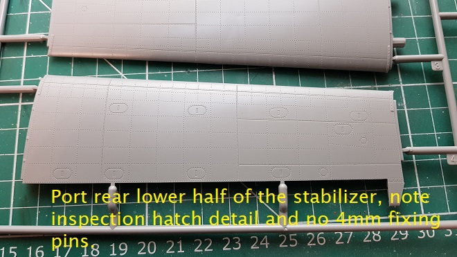

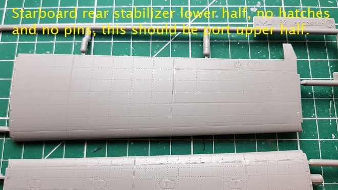

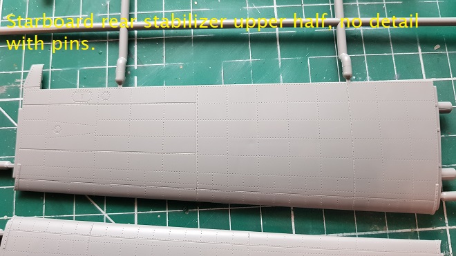

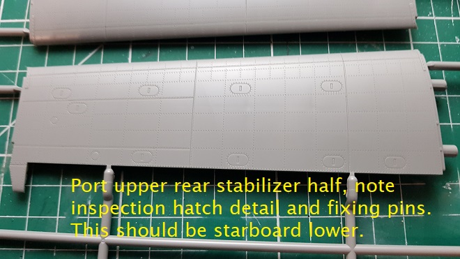

It seems HKM have really dropped the ball with this kit. They have completely messed up the stabilizer halves, so that the port stabilizer is made up from 2 lower halves and the starboard is made up of 2 upper halves. For a £400 pound kit I think this is terrible. Let's hope they do something to sort it out or I can see kits being sent back.

Looking at your photos Daran, I think basically, the upper and lower halves (the ones with the hatch detail are the lowers and the ones without the hatch detail are uppers?) will mate together perfectly well except that you'll end up with one stabiliser with no pins at all and the other with two sets of pins that probably interfere with each other and you'll also have to do something about the locator pins that are present within each half - is that correct?
If it is what's to stop you cutting one set of pins off and then drilling the other stabiliser and fitting them to that one? Or am I not understanding the HKM fault here?
#3 Posted : 23 January 2019 09:35:22
You are correct Kev, you will have to cut of locating pins for the alignment of the halves and then remove the 4mm locating pins and glue them to the correct half and then cut out the semi circle that fits around those pins. It is a fairly easy fix for those who can, but for those who build oob it could cause an issue, but its the fact that a £400 kit that is not able to be built out of the box without cutting it about that I find really poor.
