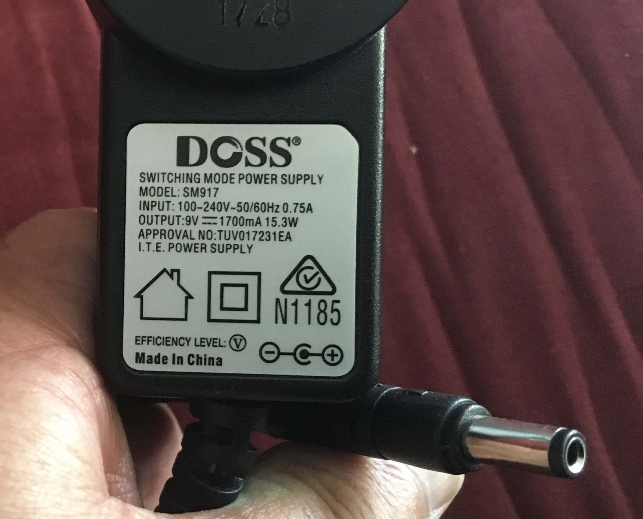

Location: Adelaide, Australia
This is what i’m Using. Ebay purchase.

Great advice. Thanks. Problem solved by ordering and now using a 9v switching power supply with 1200mA output as compared to the official supply's 1000mA. Works a treat.
