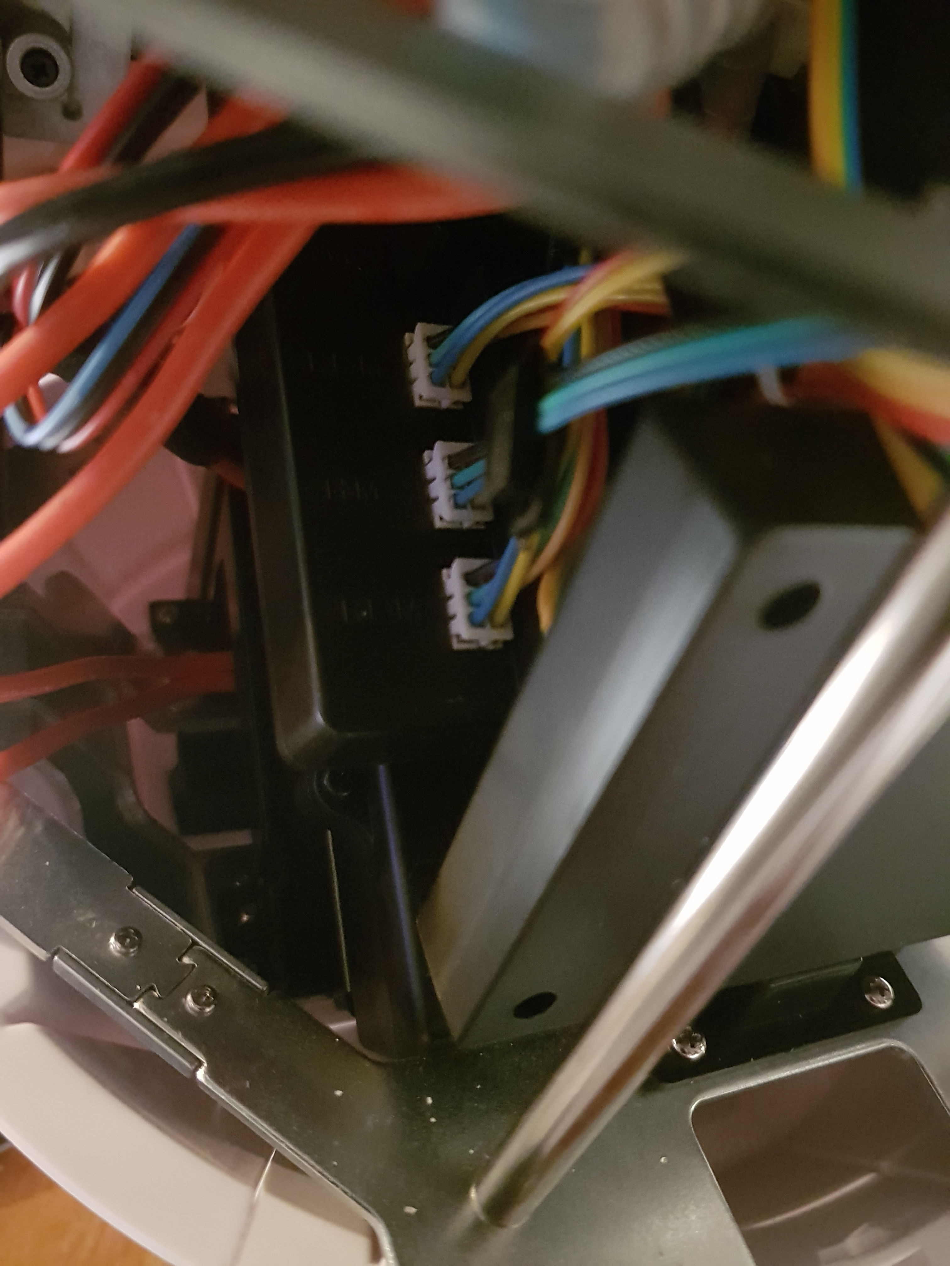

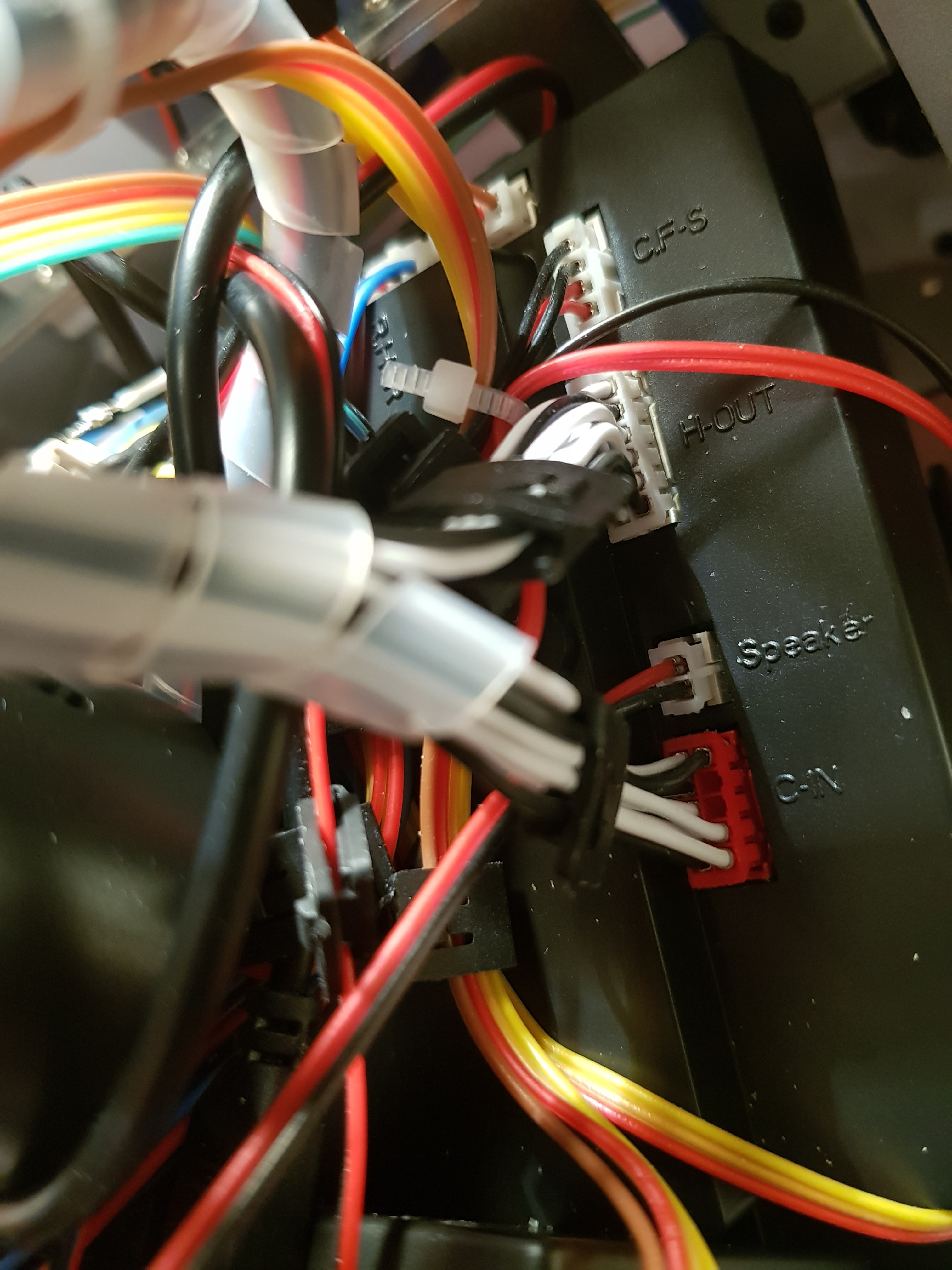

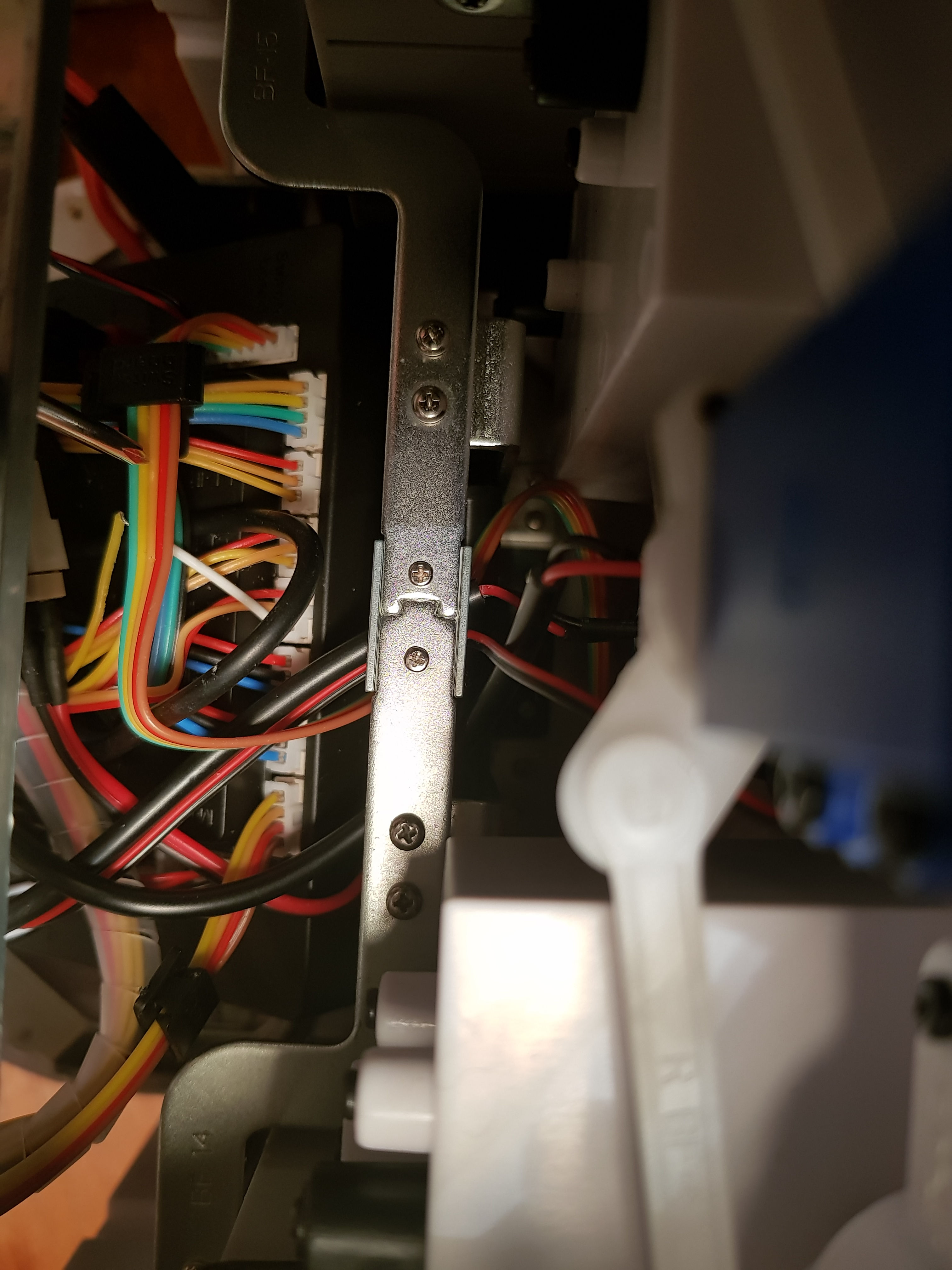

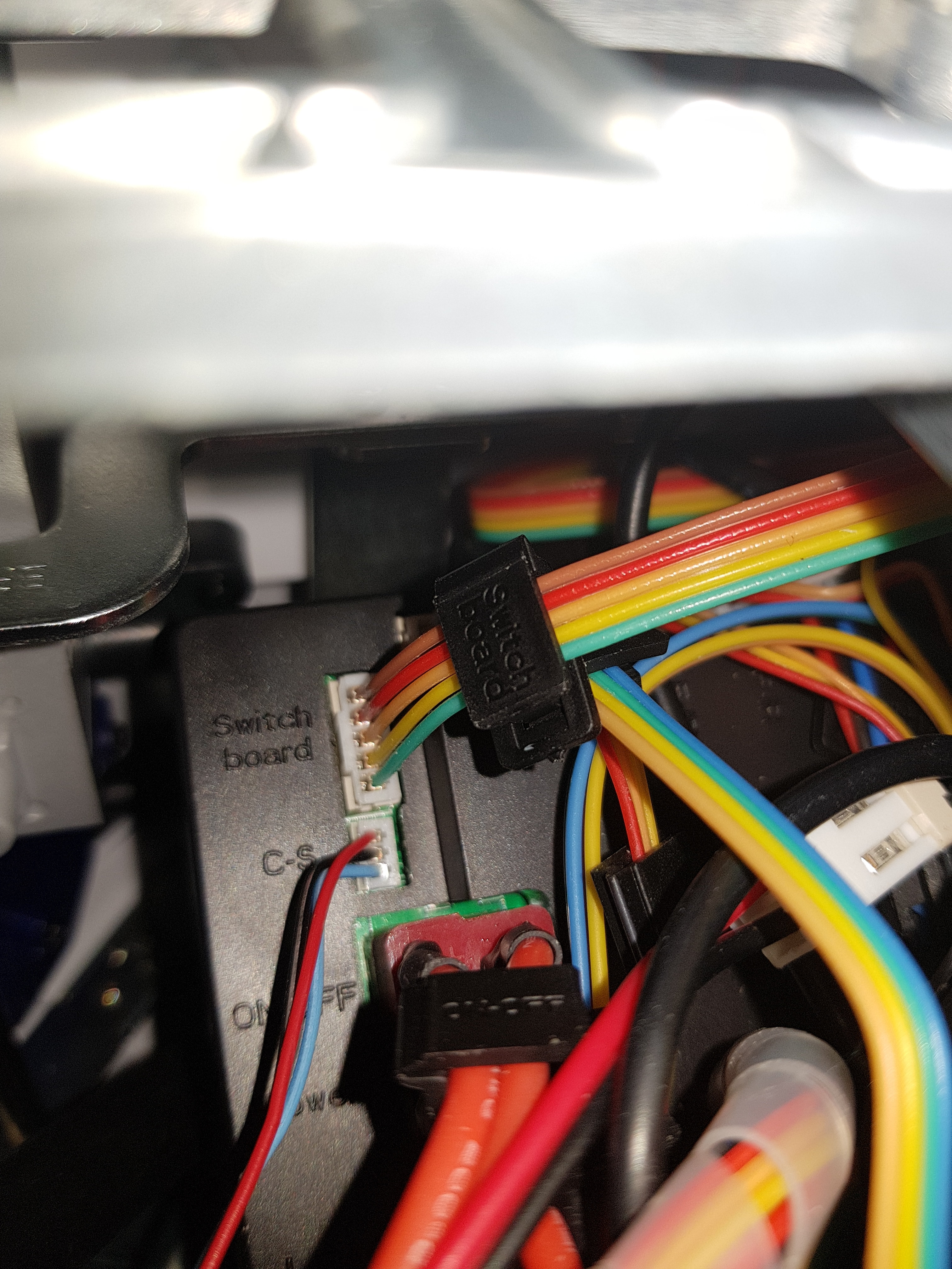

Hi,
I am having the same issue, when I power up the unit the head slams to the right and left then stops causing the motor to make a whining noise. If I disconnect the head motor, power up and manually turn the head left and right the unit seems to work ok (Minus any head movement).
I have triple checked all wiring connections and the batteries I use are these https://18650.uk/product...ktRHjtgtIwcays9RKVwPR40
I do not believe it is the motor at fault as it works fine when connected to the test board
I tried contacting your customer support, but they insist I use this forum.
Also I am very disappointed at the fact that the R2 unit does not work on a carpeted floor, this fact was not made clear at the start of the subscription as my house is completely carpeted apart from the bathroom I would not have taken out a subscription and If I could return the whole thing I would
Please can you advise my next steps

Hi can you double check your connections are fully seated and without any bent pins and that they are all labeled correctly too.

Yes I've double and triple checked the connections and pins. I've even been on the Facebook group and watched several videos to confirm they are connected correctly, everything at the moment points to a faulty mcu.

Ok, I've just removed all the cables, checked they are all labelled correctly and reinstalled them, but it still slams the head to the Right then the left and makes a whining noise.
I have installed the extra 2 washers in the front wheel but am unable to test until I get the R2 unit working.
I have also rotated the dome drive shaft, but this made no difference.
I shall be contacting C/S tomorrow for a replacement MCU.
Do you know how long it will take for a replacement MCU to be sent out as I have a very expensive R2 unit sitting here completely useless until I get the part?
