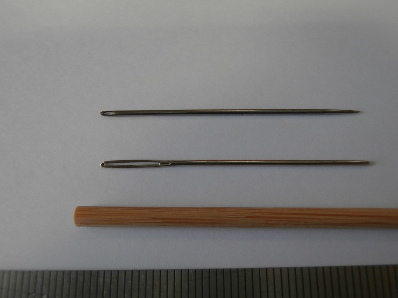

This a simple home made tool I use for applying thin super glue (can also be used with liquid poly).
All you need is a sewing needle and a length of barbecue skewer (or thin dowel). Pic.1.

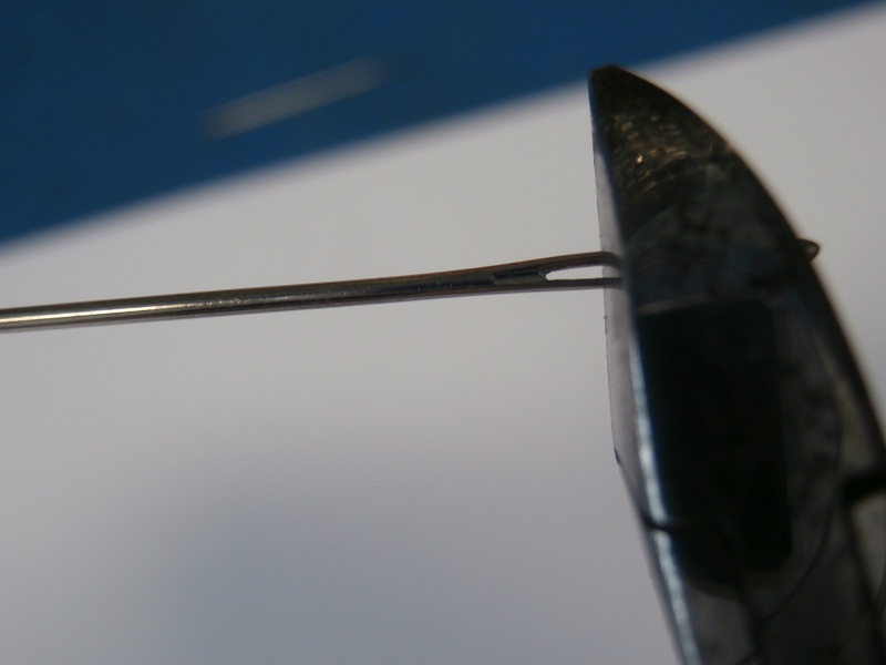

You take the needle and cut through the eye with a pair of side cutters, Pics 2 & 3.

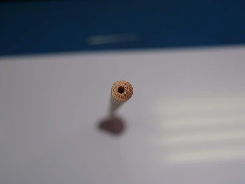

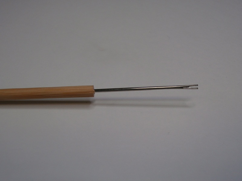

You then insert the pointed end of the needle into the end of the skewer - it is safest to drill a pilot hole slightly smaller than the diameter of the needle first so as not to split the wood. Alternatively you use a pin vise to hold the needle, Pics 4 & 5.
You then just dip the cut end of the needle into the glue and apply to the part being glued.
The smaller the needle used the less glue is applied and the handle length can be made to suit the jop at hand - useful for getting into confined areas and when rigging ships.
I usually keep 2 or 3 different ones and if the super glue dries in the cut eye you just need to dip into acetone for a couple of minutes and wipe clean - I have been using the same ones for the last 18 months.

I guess the only thing to add is watch your eyes when chopping through that needlecend in case it goes "supersonic".
