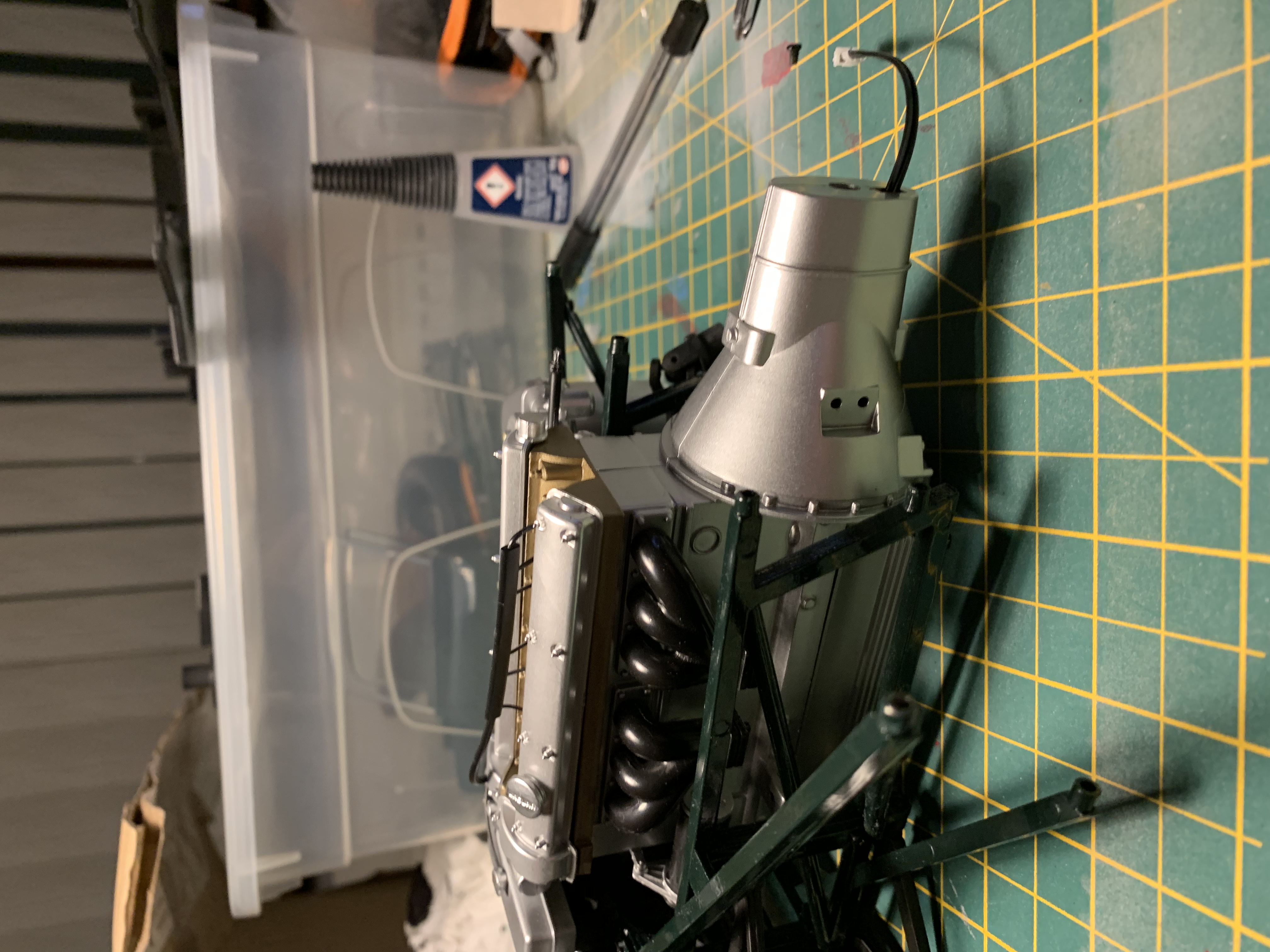

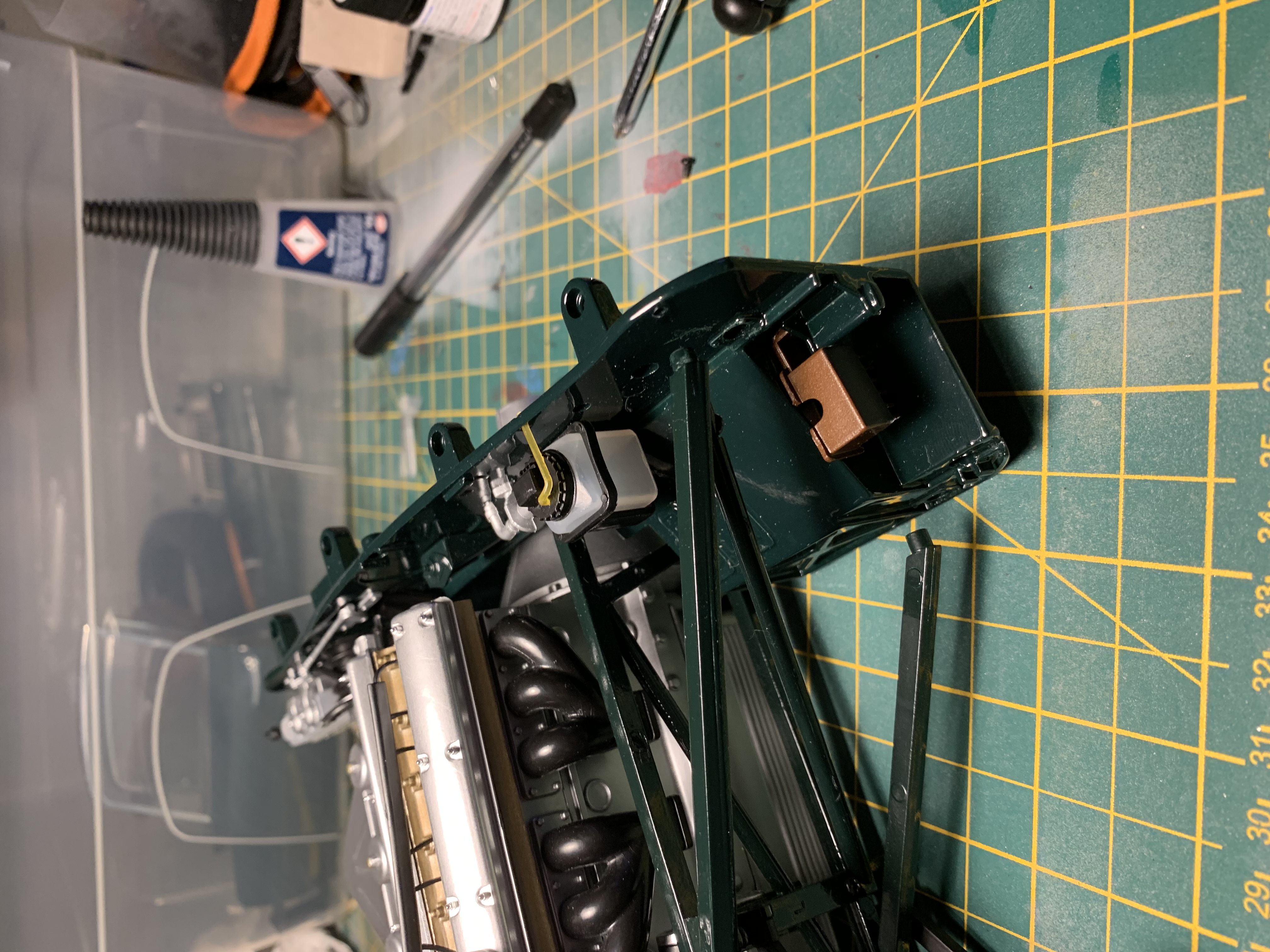

I am at that stage where I'm putting the engine and mounting and bulkhead together but it just doesn't want to go !! the build has been followed to the letter can anyone give any advice?? cheers

Can you post some pics of where parts won't go or fit, and maybe give some details about what's wrong?
Mine went together easily if I remember.

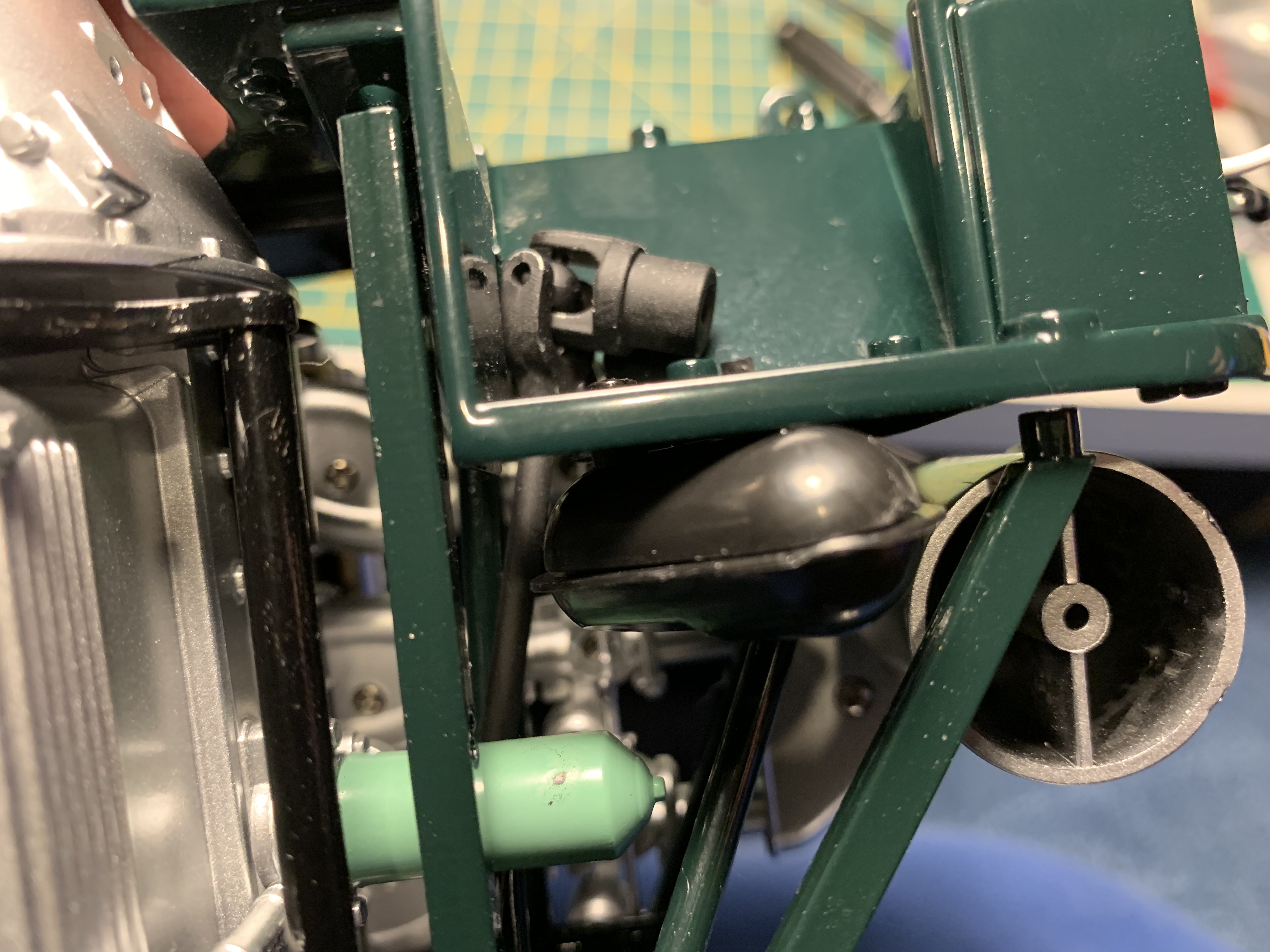

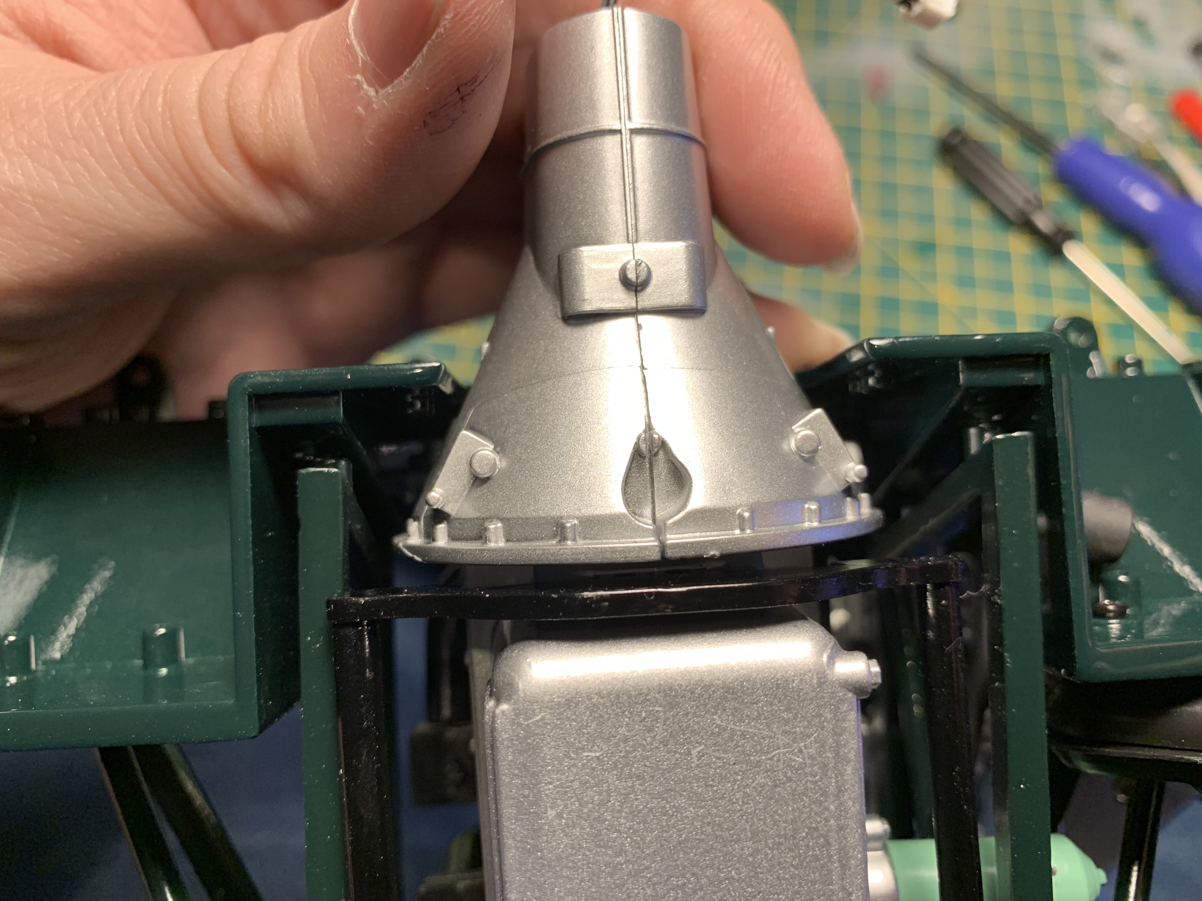

Attached photos on original post!
It seem like there is something stopping the correct alignment of the holes,
I followed the instructions in the issues to the letter it might be me doing something wrong I just can’t figure it out it has to be something so simple

I've looked at your pics.
It seems as if something is preventing the engine and frame going back far enough to meet the bulkhead.
When you try, can you see anything that is 'in the way', or stopping you getting the parts together?
Also, is the steering column going through the side frames properly?
If not, it will foul the bulkhead and prevent the frame going all the way back.
Another small but important point:
The throttle linkage on the manifold needs to go through the little hole on the bulkhead.
If it doesn't, the frames wont reach...
Fingers crossed.
