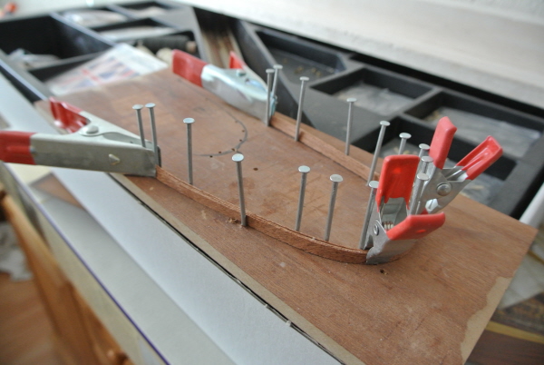

Hi Ant
I had this problem on the stern of the Cutty Sark in which I tried soaking and bending only to split. in the end I made a jig from ply and nails and then laminated the plank using thinner planks.
Hope this helps
Terry
Terry Benson attached the following image(s):
On the bench. Cutty Sark 1869

Is that two pieces you are bending there terry....
