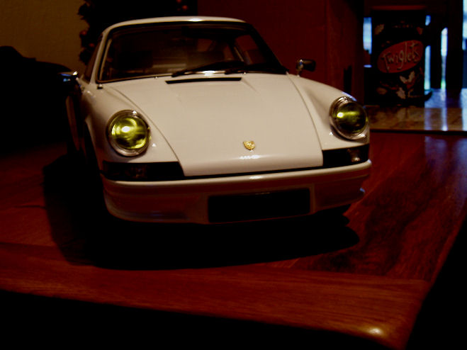

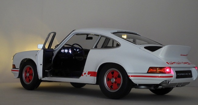

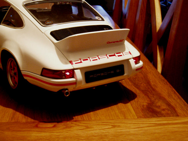

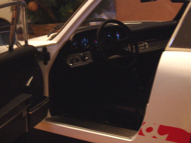

Sorry to hear you had a few problems.
Once I had taped my wires into place and out of the way, the body went on fairly easily.
The dashboard was a bit tight in the door apertures but that was about it.
I've attached a few dodgy images of my car with the lights on.
They are blurry as I didn't use flash, and left the room fairly dark - hence a slow hand held exposure...
Roy.
