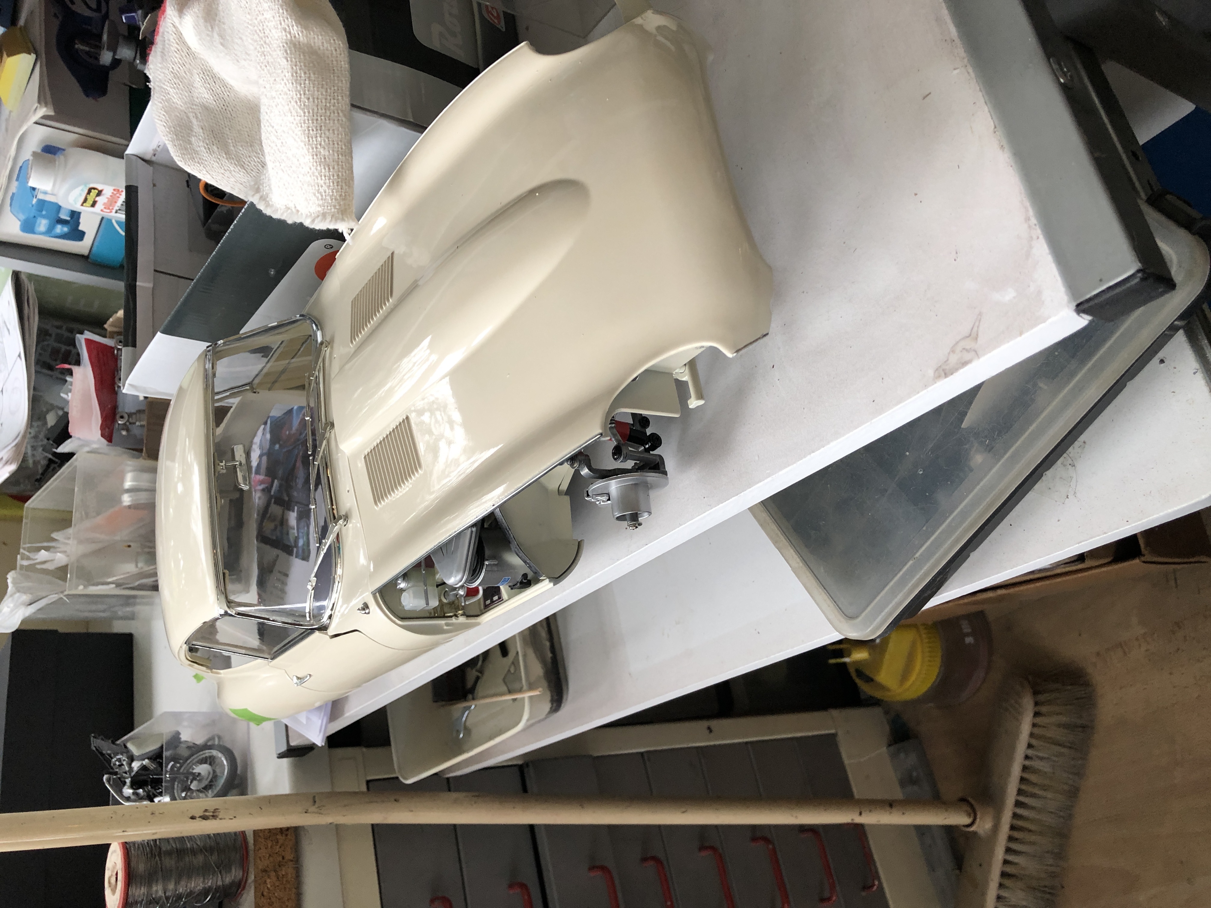

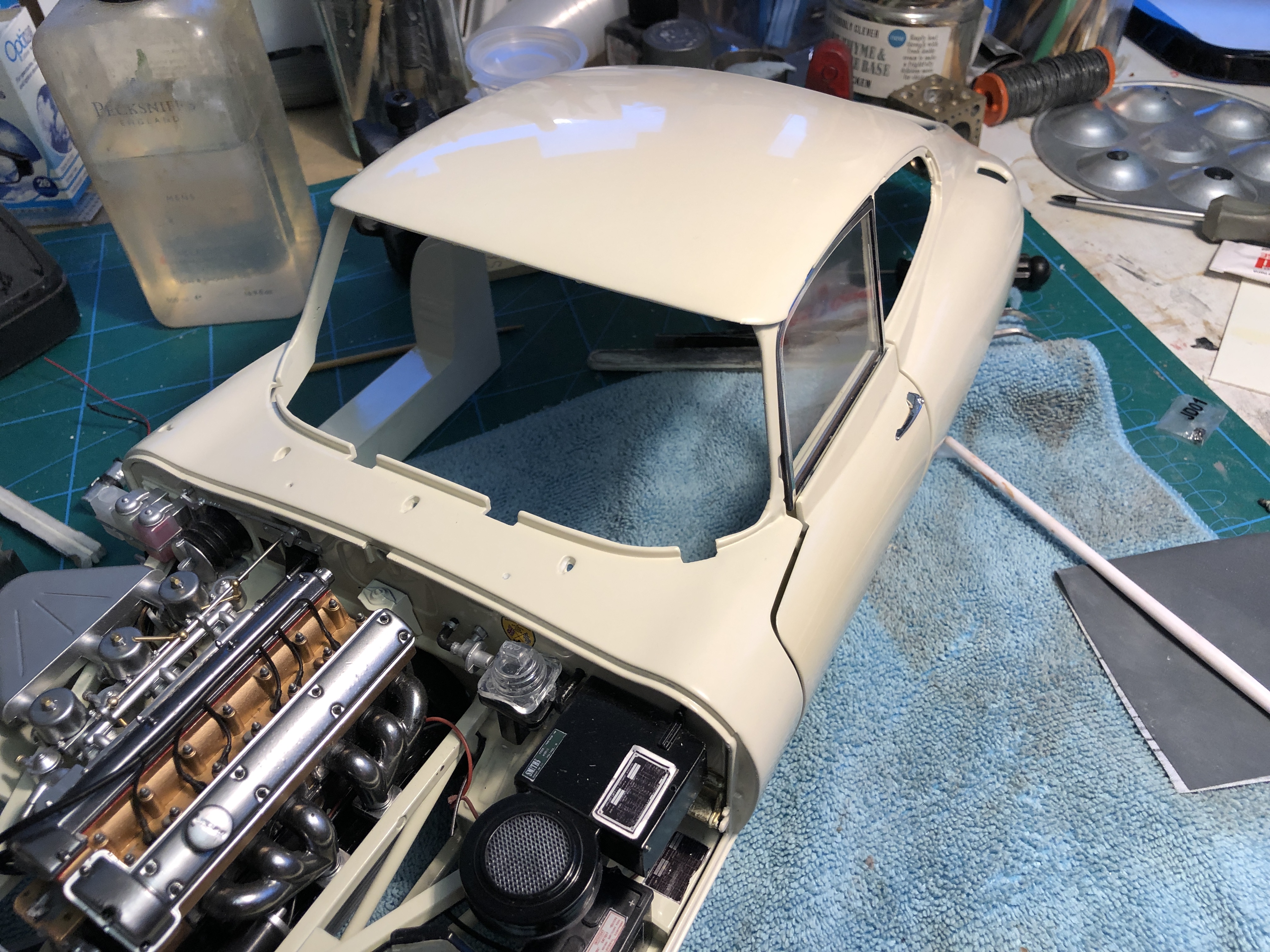

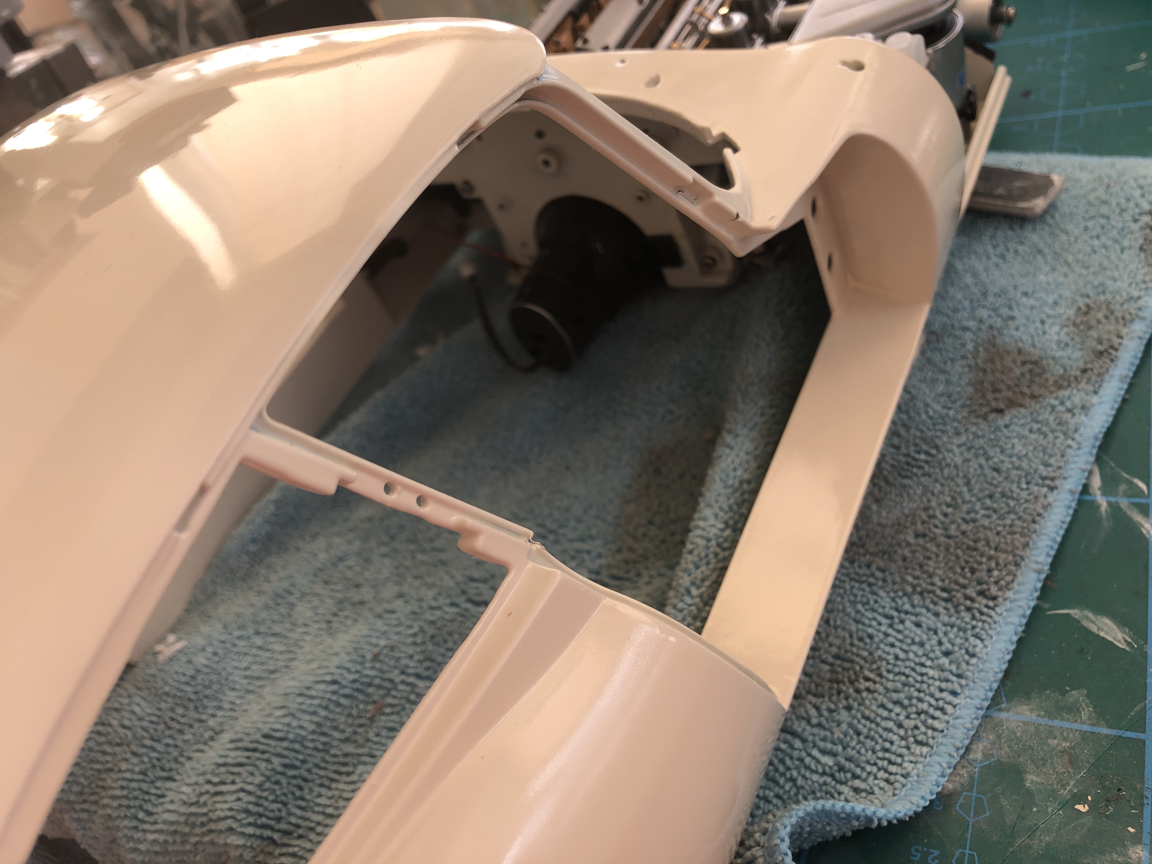

Further progress following a long lay-off. The change of colour I find very pleasing although I would like to hear any comments.
#31 Posted : 01 January 2019 13:40:38
Posts: 5,192
Points: 15,725
Looks like a nice colour there.
Just wondering though - is the door a different shade, or is it just the picture...?

Looks great in the cream and the pics show a nice finish to your paintwork.
