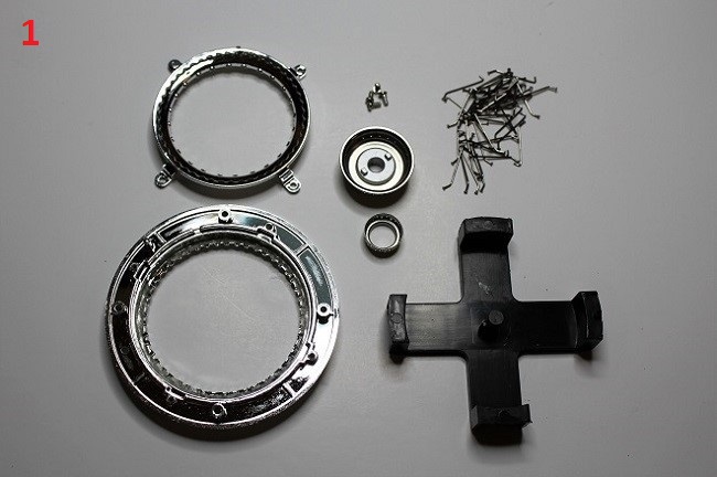

Photo 1 - Is what we start with.

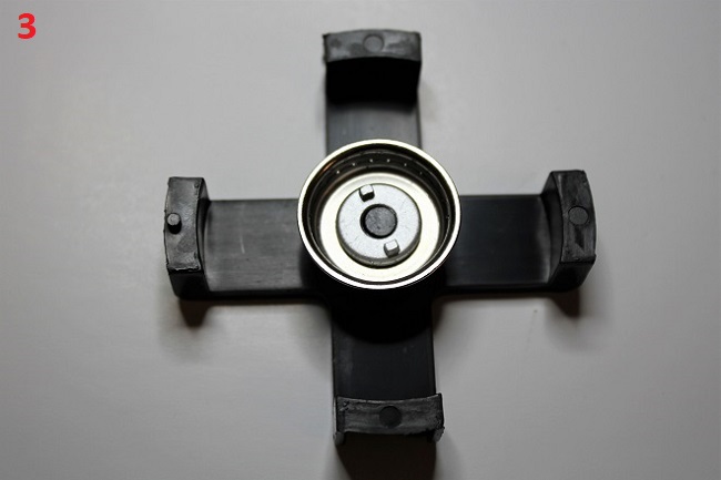

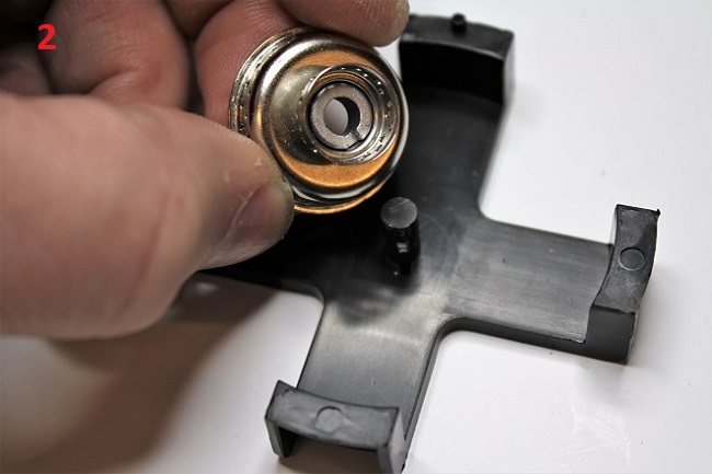

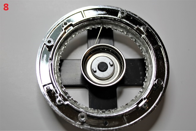

Photos 2 & 3 - First the hub is mounted on the jig and positioned on its peg.

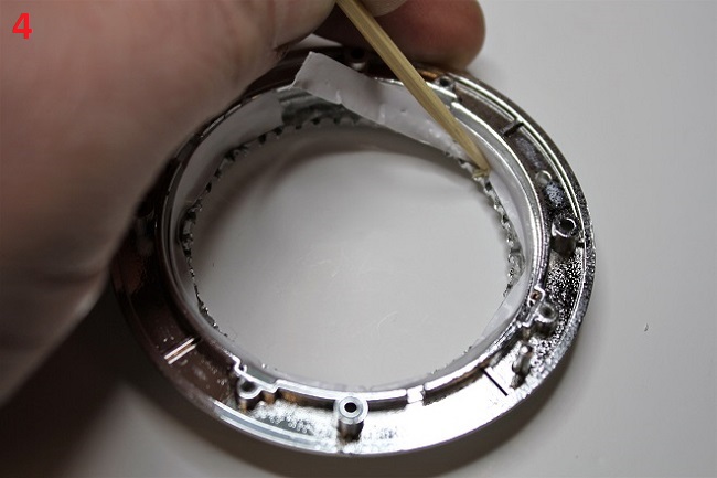

Photo 4 - The double sided tape is applied to the inside rim and pushed into the groove where the spokes sit and its outer coating removed.

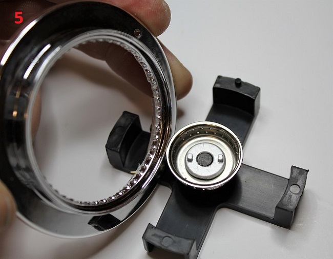

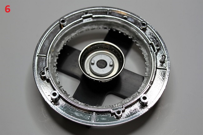

Photo 5 & 6 - The wheel ring is then placed on the jig, locating the peg on the jig and hole in the rim.

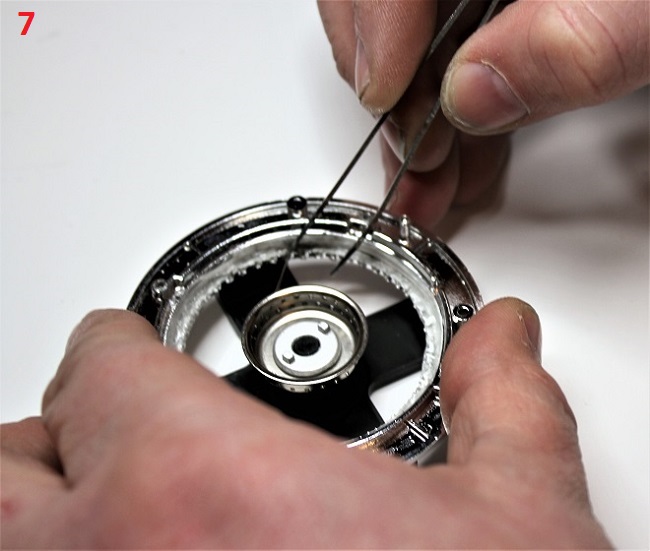

Photo 7 & 8 - Hold the rim with thumb and second finger, allowing the forefinger to assist with pushing the spoke and preventing the hub from lifting off its slot, the first spoke is then pushed through a hole on the lower layer set on the hub and using the tweezers pulled tight against the hub and then placed in the slot in the rim that is a tight fit, to the right hand side of the hub.
Using the tweezers it can then be pushed into the rim sticking it to the tape.

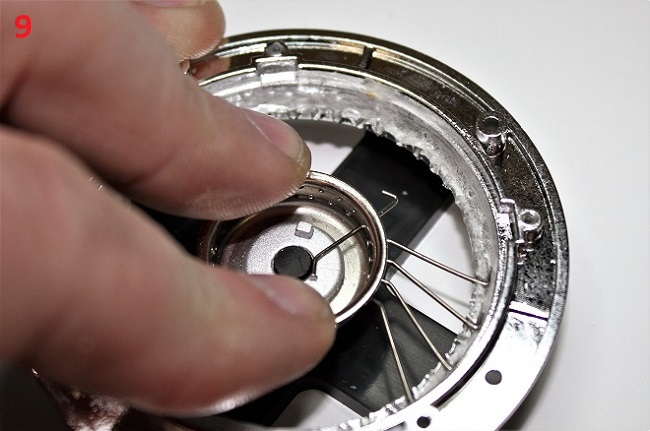

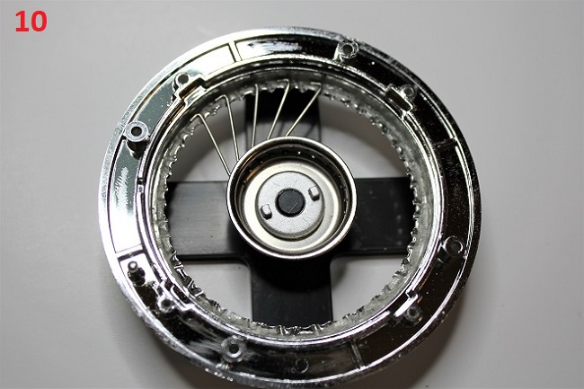

Photo 9 & 10 - Once this important first spoke is fitted you can proceed to fit the rest of the bottom layer ensuring every other slot on the rim was missed. I found it was easier to position the spoke as shown and to follow an anti-clockwise pattern as there was less chance of getting spokes snagged on others.

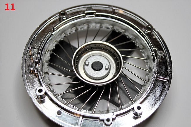

Photo 11 - Once all the lower spokes are fitted you can proceed with the upper layer.

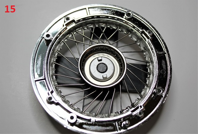

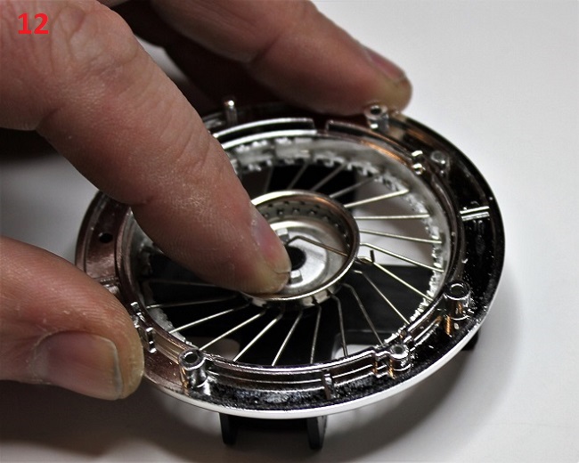

Photo 12 - Holding the jig as shown helps to keep the lower layer in position as you fit the important first spoke.

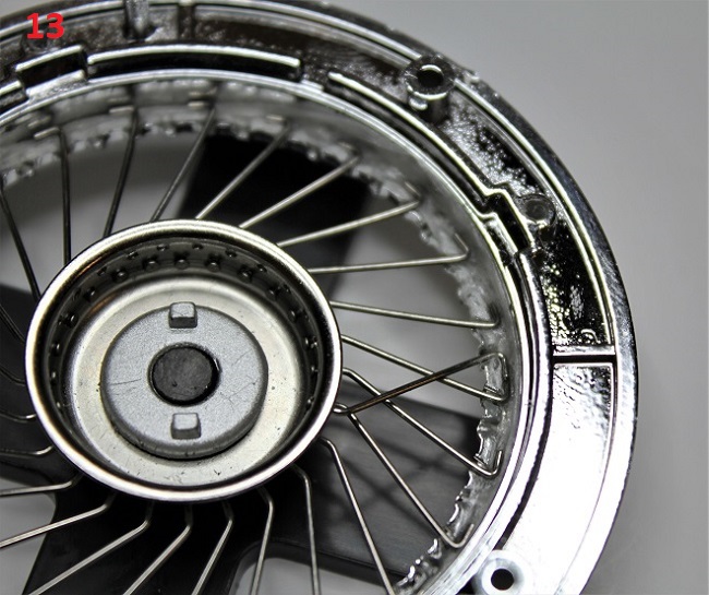

Photo 13 - Pulling the spoke through the hub place it to the opposite side to the lower layer as shown then push it into the tape using the tweezers.

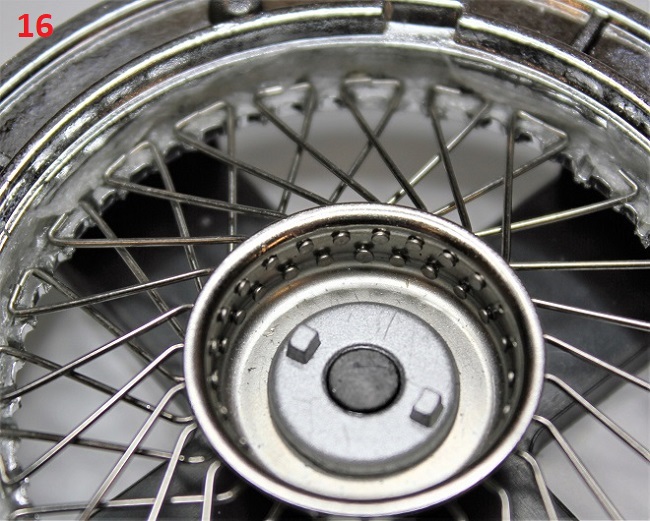

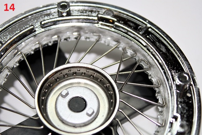

Photos 14 to 17 - Repeat this with the rest of the spokes noting how the spokes are positioned in the hub.

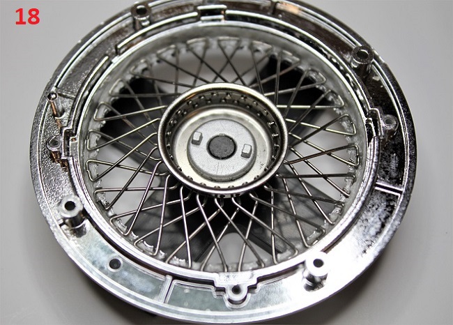

Photo 18 - Once all the spokes are fitted you may need to slightly reposition a spoke or two if they have moved slightly.

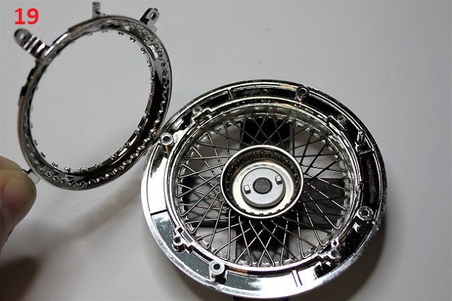

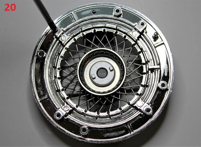

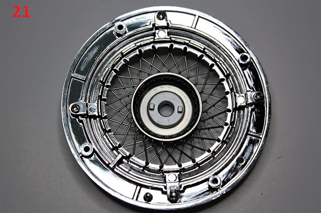

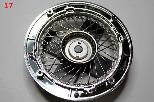

Photos 19 to 21 - Then fit the securing ring.

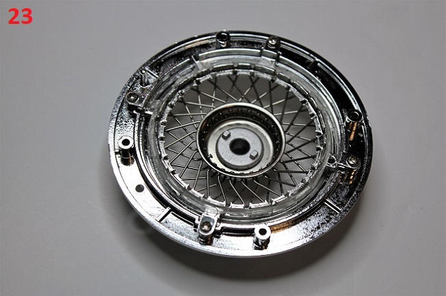

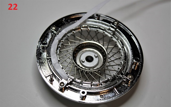

Photos 22 & 23 - First double sided tape was applied.

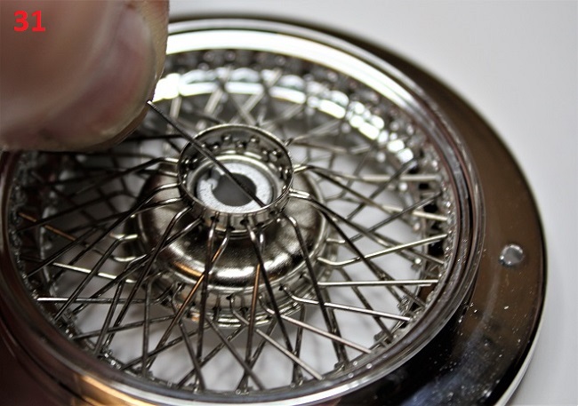

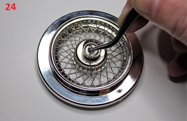

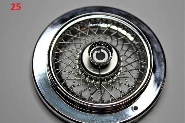

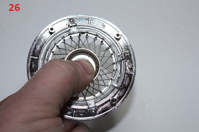

Photos 24 & 25 The first spoke from pack A was placed through the lower hole of the hub and placed through the central space formed by the spokes fitted in issue 4.
Photo 26 - Once the spoke has been passed through the spokes, to prevent it sliding back during the turning over of the wheel, I placed my forefinger over the wheel center and my thumb on the hub as shown.

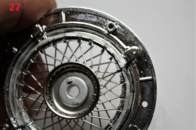

Photo 27 - Then I used the tweezers to lift the spoke over the mounting lug into position, this required a little force.

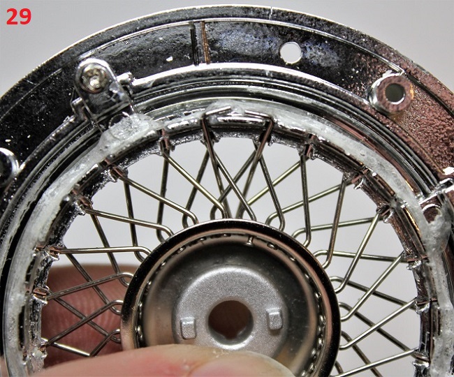

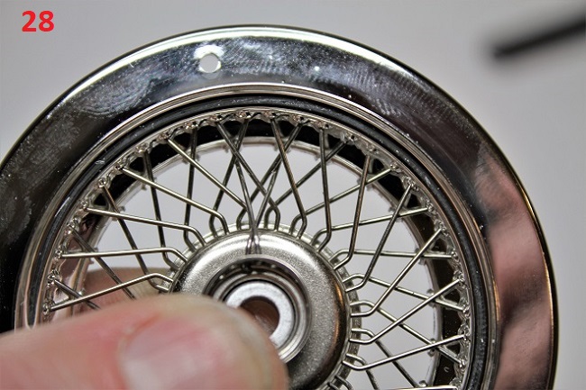

Photo 28 & 29 - Then taking a spoke from pack B, place it to the left of the one just fitted and over it and through the next central gap and over the mounting lug as before.
Photo 30 - Repeat this for the rest of the spokes as per the instructions.

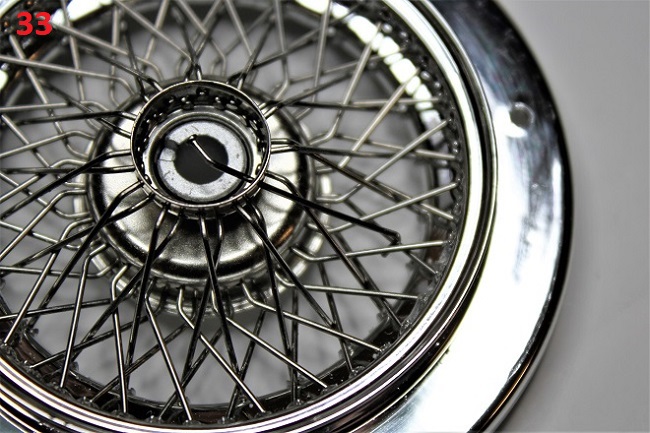

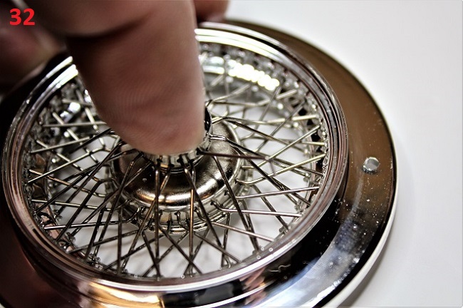

Photos 31 to 33 - I found by placing the pack B spokes in this position then applying a little downward pressure helped to thread them through the gap.

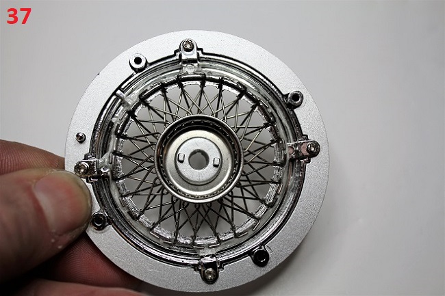

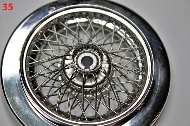

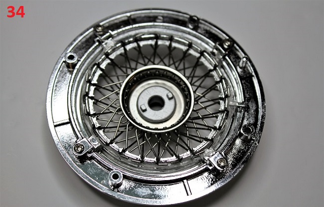

Photo 34 & 35 - Once all the spokes are fitted the wheel is ready for the spacer and outer rim fitted.

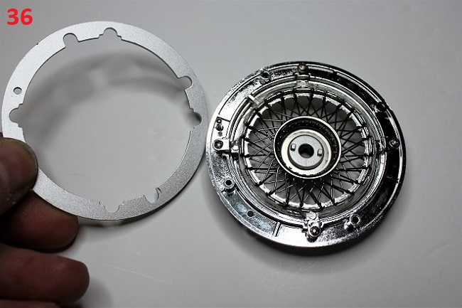

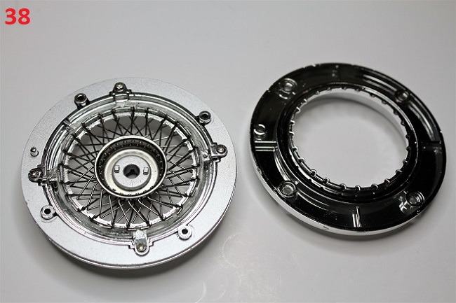

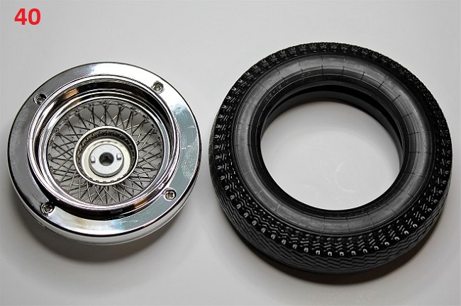

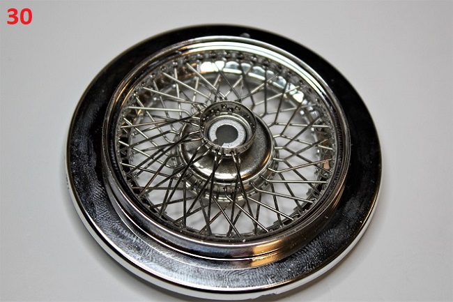

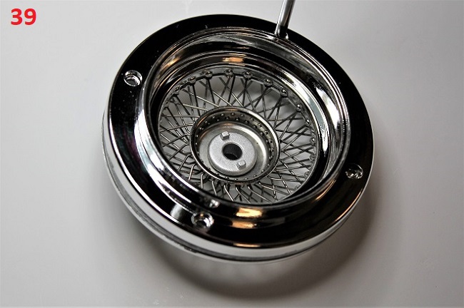

Photo 36 to 39 - Show the spacer and outer rim fitted.

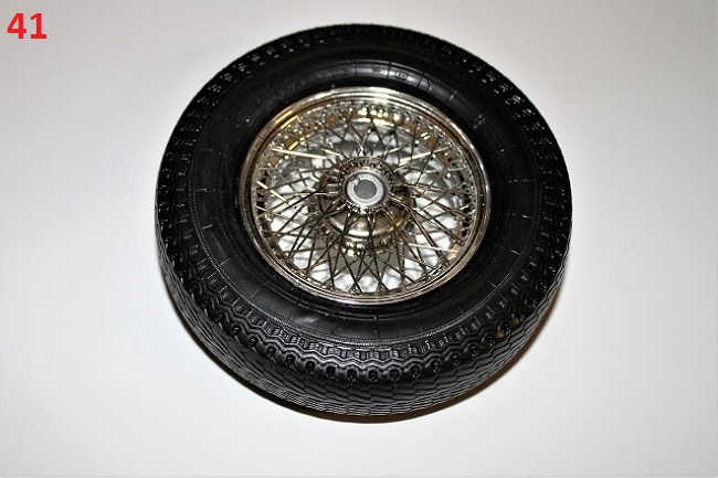

Photos 40 & 41 - Then finally the tyre can be fitted.

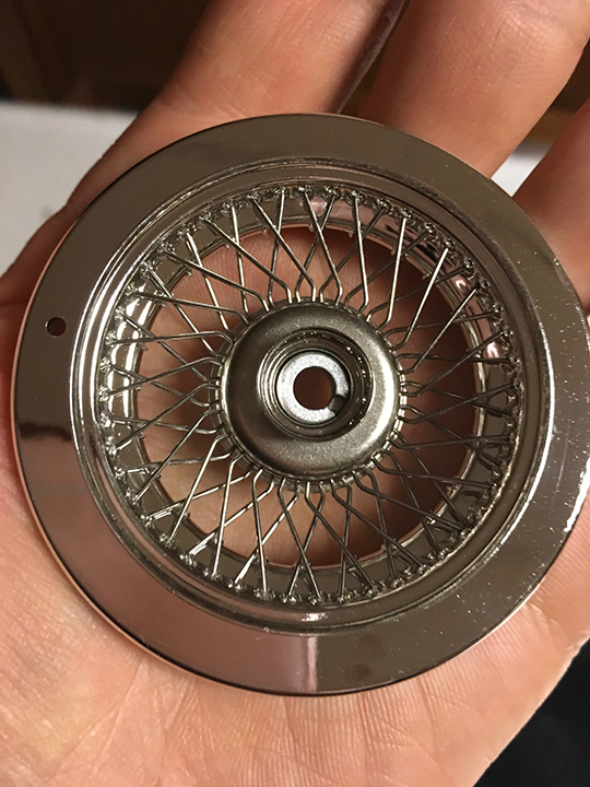

Many Thanks @Spal for the detailed construction of the wheel. I've not built a model kit in 40 or more years. Enjoyed doing it as a kid with my dad. I had to admit I was spooked when I saw that wheel in issue 4 and said there's no way I'll ever be able to do that.
The book was helpful but your instructions were spot on! Did the whole thing in about an hour and 40 minutes. Watching a movie to stay relaxed. Once you got into a rhythm, it was smooth sailing. My only issues now is after putting it back in the bubble to protect it until it's needed again, it appears one of the spokes popped out or off. Haven't taken a good enough look yet but was happy to see how this turned out. Thank you!
