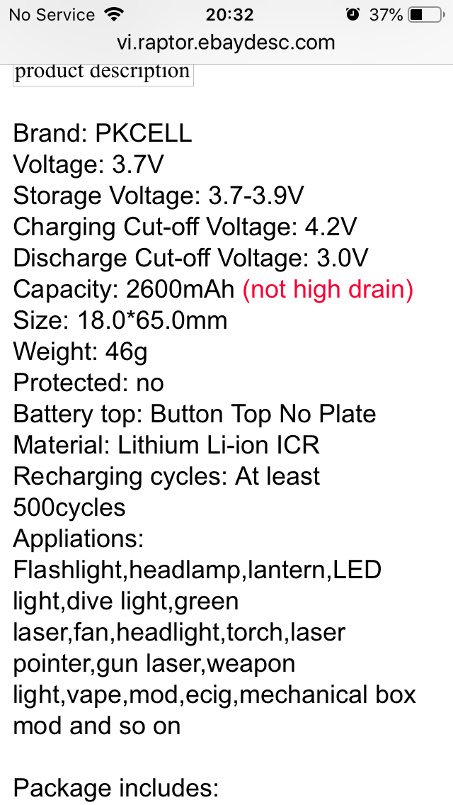

sirbawbag
#4 Posted : 10 December 2018 21:35:22
Joined: 10/12/2018
Posts: 15
Points: 45
sirbawbag attached the following image(s):
#5 Posted : 10 December 2018 21:57:00
Can you confirm the amperage output of the above batterys.

Not very good at this, how do I do that?
#7 Posted : 10 December 2018 22:35:17
Ask the shop you bought them from they should know the continuous discharge capacity of your batterys.
Some one posted a link to some Samsung 30Q batterys earlyer if you look at the battery spec on the 7th line down it says-
Discharge: 15A Max Continuous.
The above is what you need to find out.
Link here-
https://18650.uk/product/samsung-30q-button-top/

Not sure about the batteries I bought, but I’ve ordered different ones , they have a maximum continuous discharge of 20A is that ok?
#9 Posted : 10 December 2018 22:57:08
They sound good
