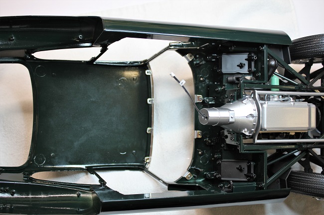

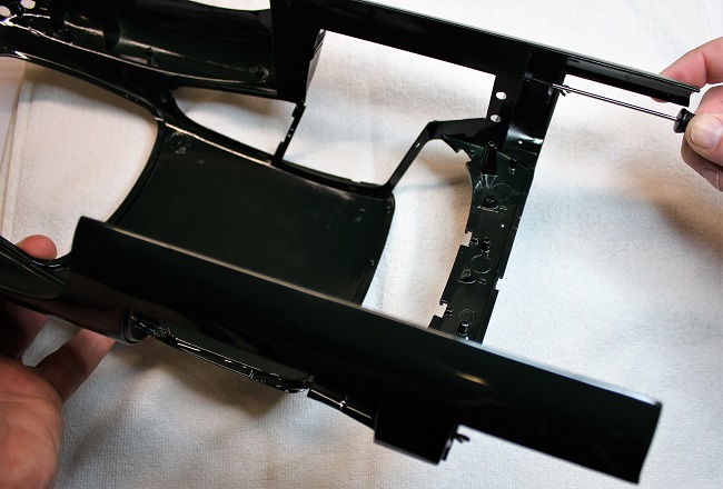

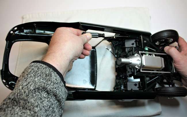

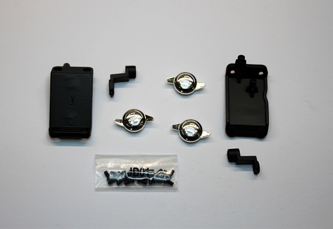

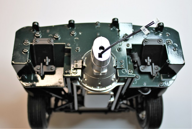

Issue 86

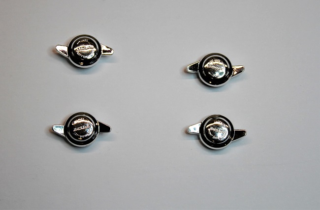

Contents: Side brackets (x 2),Right-hand bulkhead bracket,Left-hand bulkhead bracket,Left-hand hubcap,Right-hand hubcaps (x 2),Screws

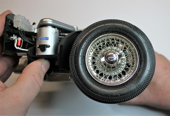

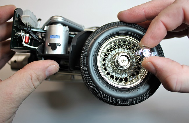

Identify the left and right hubcaps by comparing them with the first of the left hubcaps, which was supplied with Issue 1.Take the front subframe assembly and one of the right hubcaps, fitting the hubcap over the central screw holding the right front wheel in place.Now fit a left hubcap to the other front wheel in the same way. You can also add the other two hubcaps to the rear wheels if you wish, or leave them until later.

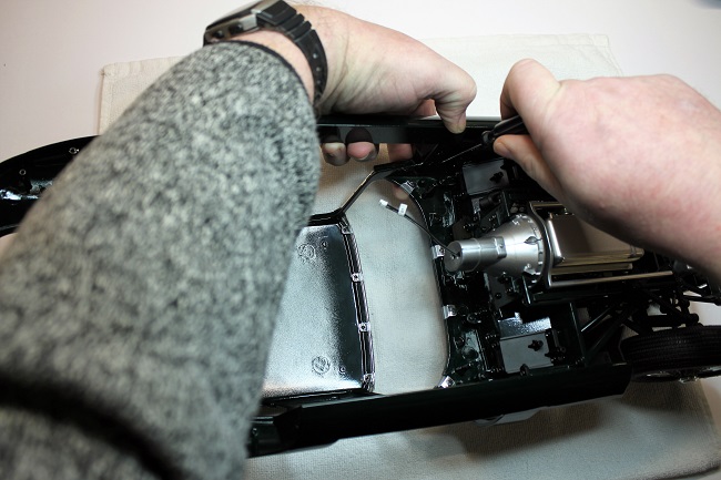

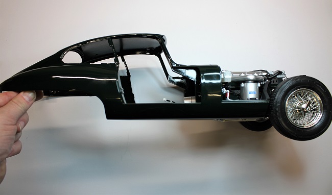

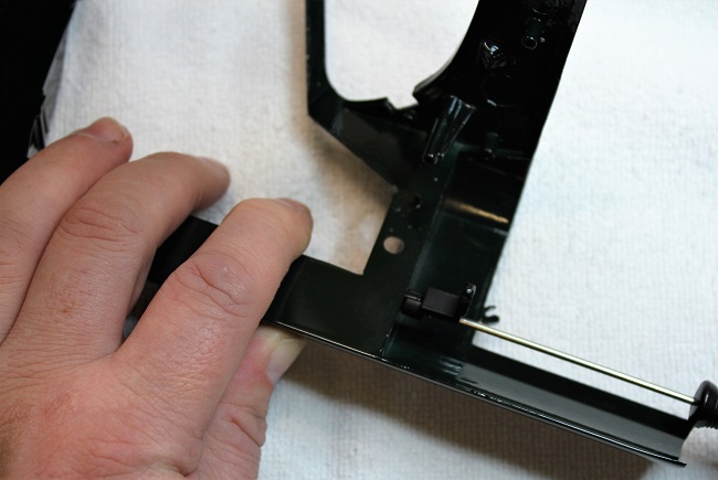

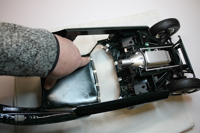

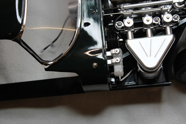

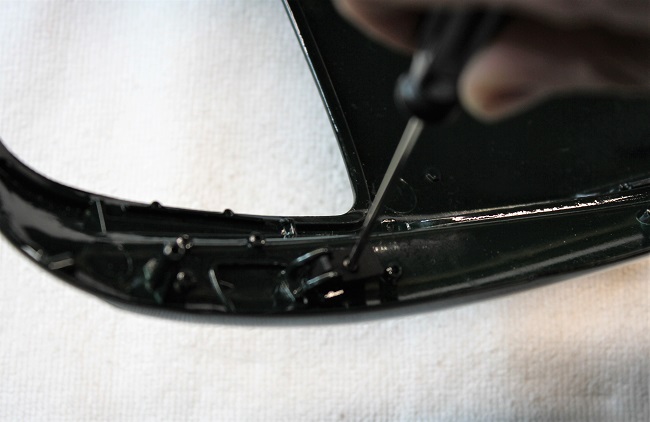

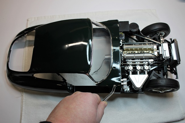

Take the bodyshell from Issue 85, plus the two side brackets and two screws. The brackets are identical, but the long oval holes face inwards and forwards.Fit the left-hand bracket over the mounting lug on the bodyshell. The slot in the side goes over the locating tab to hold it at the correct angle.Screw the bracket to the bodyshell with a screw, repeating this step with the right hand bracket on the opposite side of the bodyshell.Line up the four holes on the right-hand bracket, which has an ‘R’ on the back, with the lugs on the recess on the right of the bulkhead.Having pressed it into place secure it with four screws.Repeat this with the left bracket.

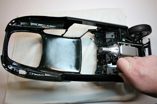

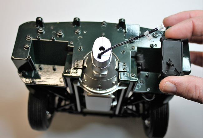

Invert the bodyshell onto a cushion or pad of soft cloth, to protect the paintwork during assembly.Identify the four lugs, which are used to attach the bulkhead. You will also fix it with the two brackets you fitted earlier.

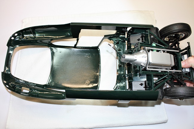

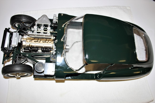

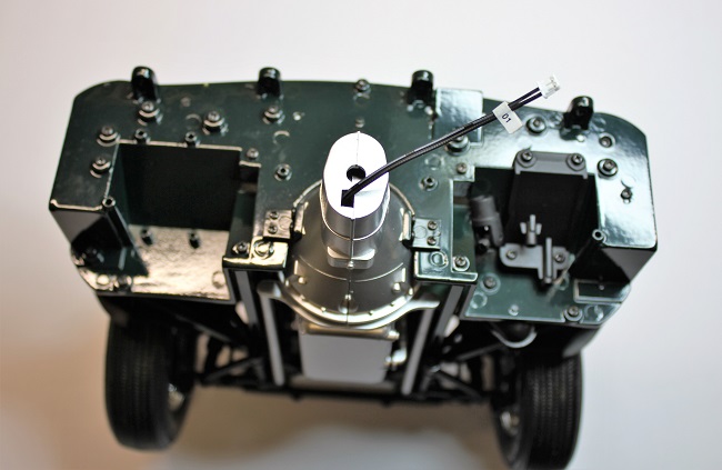

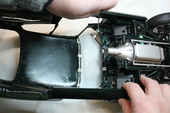

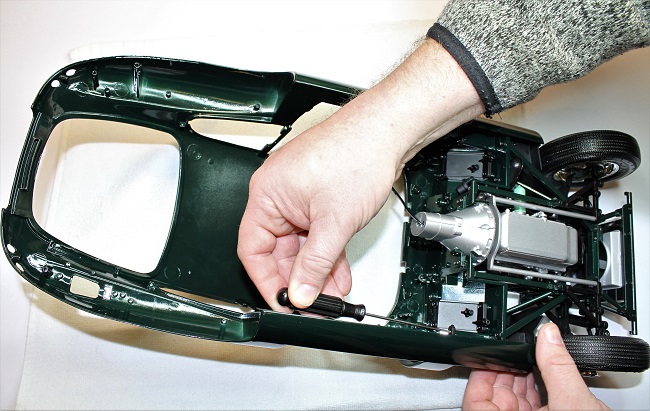

Carefully lower the front subframe onto the bodyshell, lining up all four mounting holes with the lugs before securing them with 4 screws.Now use another screw to fasten the right-hand side bracket to the bulkhead and finally add another screw to secure the left-hand side bracket.
This issue is now complete. Store the assembly and any unused parts in an issue labelled bag.

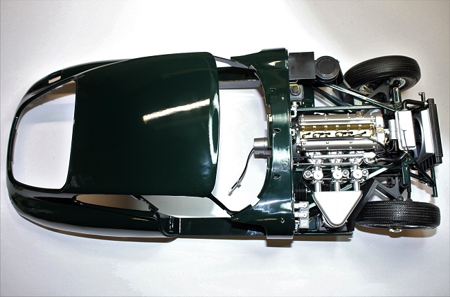

#2 Posted : 07 November 2018 13:03:16
Issue 87

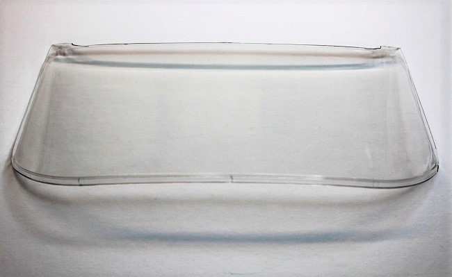

Contents: Windscreen
There is no assembly to be done at this stage.
Carefully store the windscreen for later assembly.

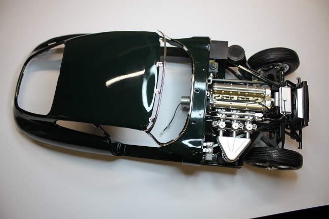

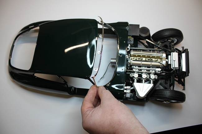

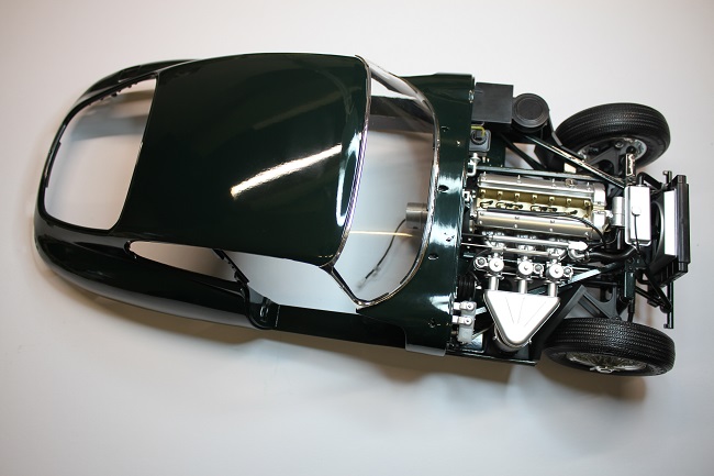

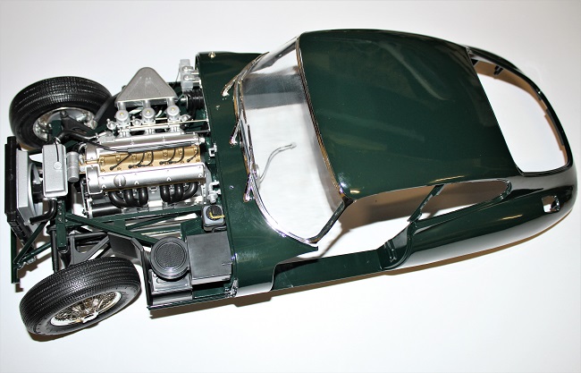

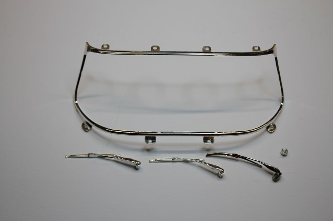

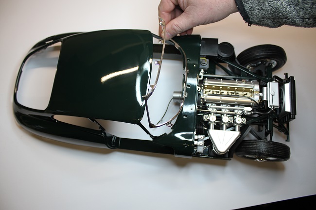

#3 Posted : 19 November 2018 11:32:33

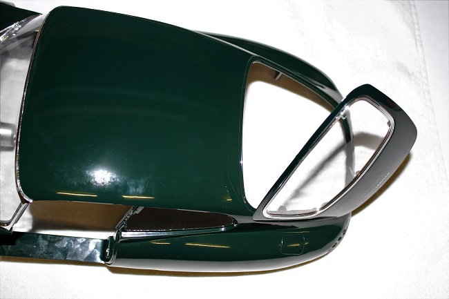

Issue 88

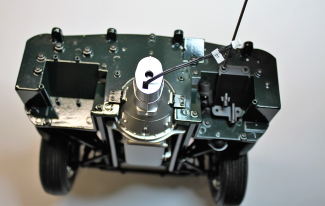

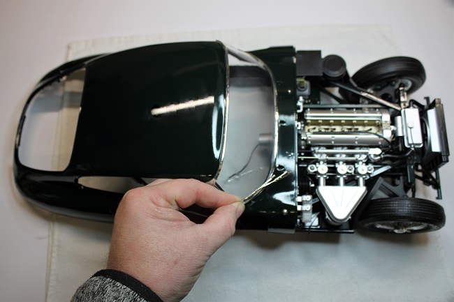

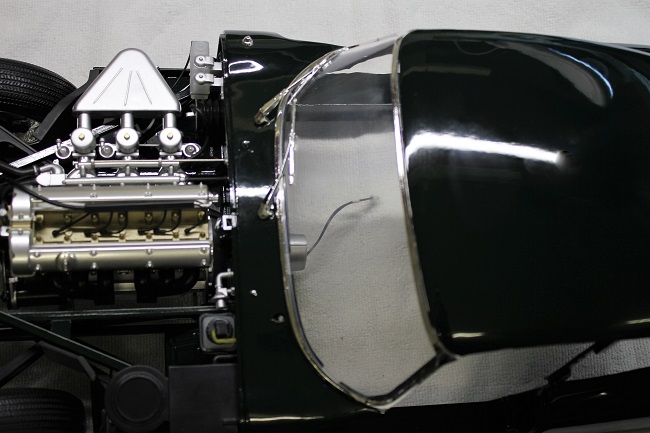

Contents: Windscreen frame,Windscreen wipers (x 3),Radio aerial,Screws

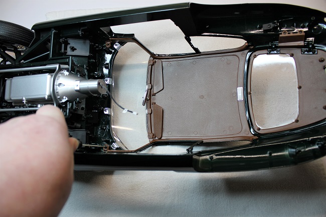

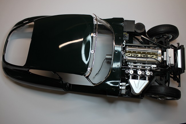

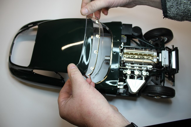

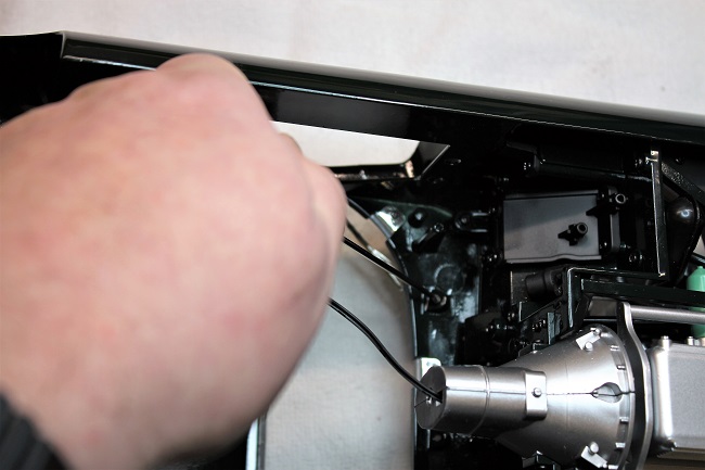

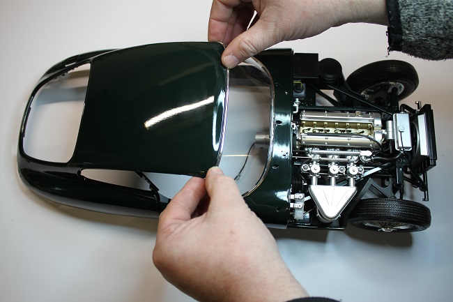

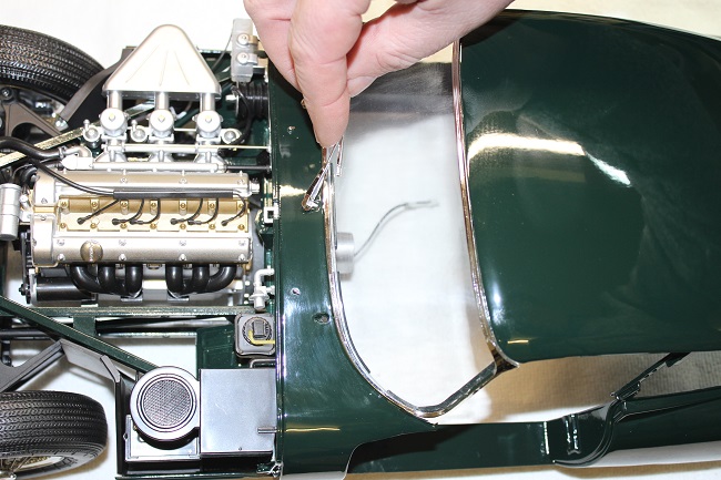

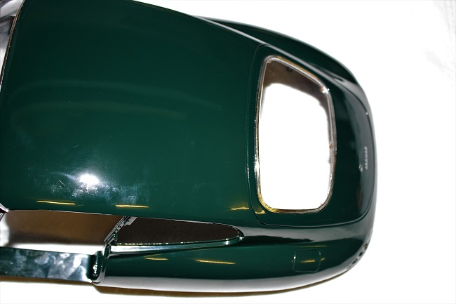

Align the frame with the opening in the bodyshell and fit the outermost tab on the lower edge into the notch in the bodyshell. Follow this by inserting the second,third and fourth tab along into the bodyshell.Flex the frame gently to open up a gap along the top edge and align the windscreen so you can ease it down behind the frame,being careful not to scratch it as you do so. Once the bottom edge fits between the bodyshell and the frame,start at the outer corner and press the top tabs on the frame into the opening in the bodyshell until all four tabs are fitted into the body.Using a soft cloth to protect the paintwork,invert the body and press the holes in each of the four top tabs over the matching pins on the bodyshell until they are firmly located in place.Then secure the bottom tabs to the holes in the bodyshell with screws, beginning at one corner of the windscreen.Continue fitting screws to the two centre tabs and finally the one at the opposite corner.Take the aerial, which has a keyhole-shaped lug on the back, and fit it into the matching hole in the body.Carefully invert the body and secure the aerial with a screw.Take the first of the windscreen wipers, these also have shaped tabs on the back to ensure that they fit into the holes in the right position.Invert the body, and secure the wiper with a screw.Fit the other two wipers in the same way.

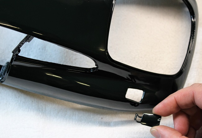

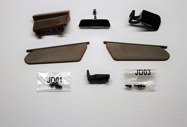

Contents: Left sun visor, Right sun visor, Rear-view mirror, Fuel filler cover, Fuel filler cover retainer, Rear door hinge retainer, Screws

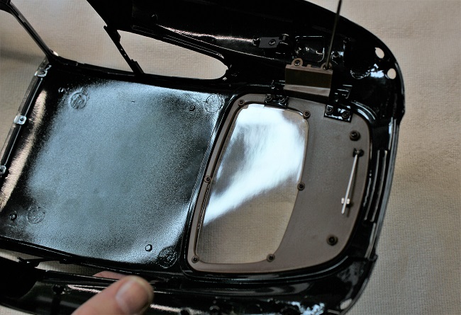

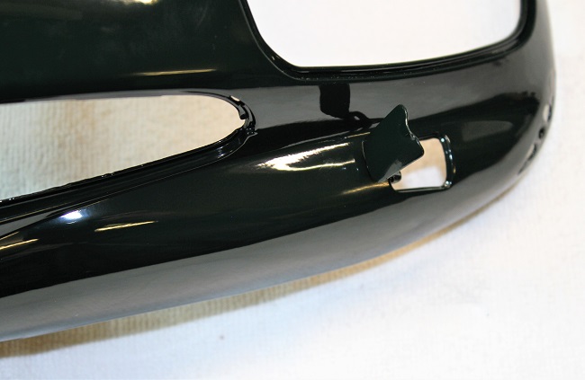

You will need the assembly from Stage 88, the fuel filler cover and its retainer, plus a JD01 screw.The fuel filler cover is shaped to fit the opening in the rear wing, and has a curved hinge that goes inside the car.Fit the cover into the body shell and hold it in place with a fingertip while you invert the car.The retainer has a round retaining pin at one end and a square hook at the other.Push the square hook through the hinge on the filler cover, and press the pin into the hole in the body shell, securing it in place with a screw.Check that you can open and close the filler cover, and that it will stay in the open position.

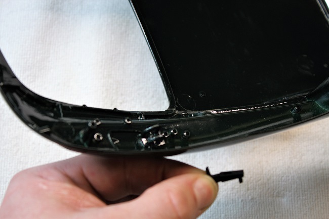

Retrieve the rear door assembly from Stage 84, plus the hinge retainer and two JD03 screws from this issue.Fit the hinge bar through the opening and fit the door flush with the body.Hold the door in place while you turn the car over to access the hinge.Place the hinge retainer over the hinge bar, fitting its two holes over the mounting posts on the bodyshell and securing it in place with two screws.Check that the door opens and closes smoothly.

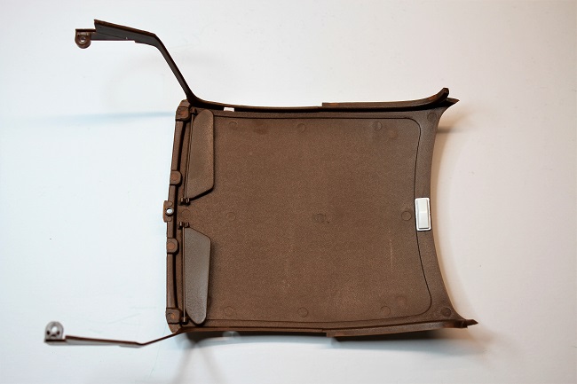

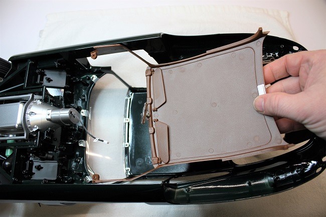

#5 Posted : 24 November 2018 21:14:49

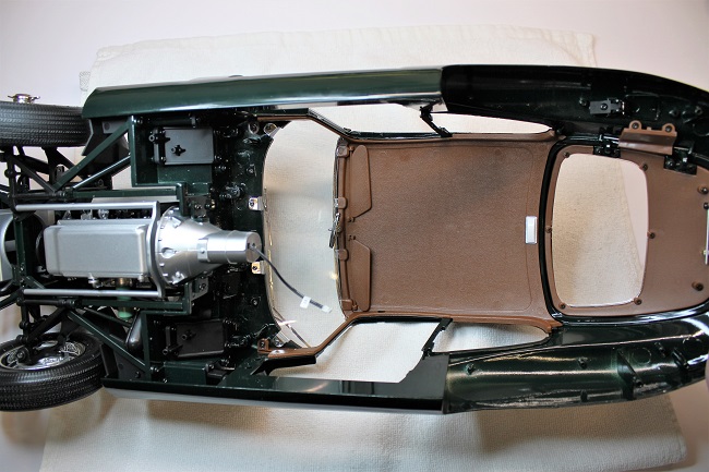

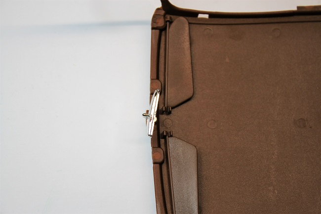

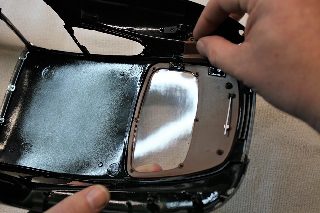

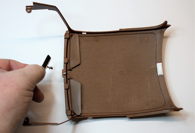

Issue 90
Contents: Head lining,Screws.

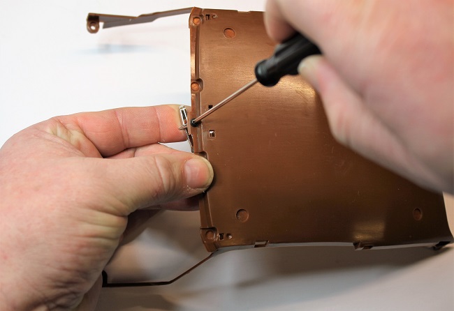

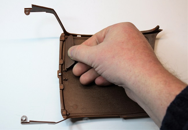

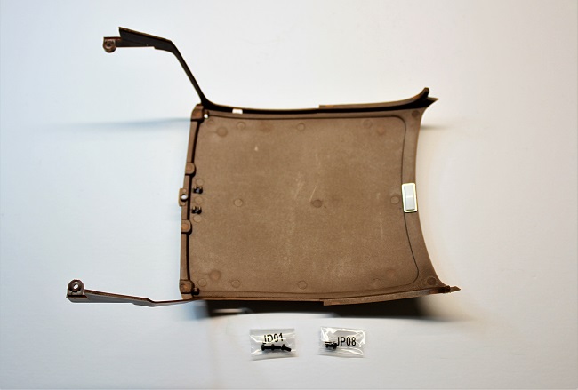

You will need the head lining, and the two sun visors and the mirror from the previous issue.Fit the pin on the narrow end of the left sun visor into the socket in the corner of the head lining and press the pin on the other end into the clip near the centre ensuring the visor will pivot to lie flat or flip down.Fit the right sun visor in the same way.The mirror stalk fits into the central hole. It has a small lug to ensure that it will fit only in the correct position.Press the mirror all the way into the hole and hold it in position while you turn the head lining over and fix the mirror in position with a screw.Inverting the body onto a soft cloth to protect the paint,align the head lining with the car and press it firmly into position at the back.Secure the front of the head lining to the A-pillar, on both sides of the bodyshell, with screws.
