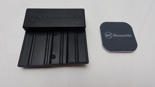

BigGrin A couple of pictures of the tool, it arrives with a few pages of instructions, the tool and a micromesh pad for polishing the tip after rectification.
How it works is you have for sets of angled grind stones of various grits that you insert the bent needle into to gring a new straight needle tip. The prosess takes a couple of minutes and then its the tip is polished with the micromesh pad.
Works a treat and I now have some rectified spare needles.

The average cost of a genuine Iwata replacement needle is around £15 at the moment so yes you could buy 3 for the cost of the tool but you still need to await it to drop though your door maybe a week at best after you damaged your old needle.
As for grinding by hand good luck and I bet even with a home made jig the results would be questionable. All the parts for an airbrush are a presision fit, airbrush needles are set at a fine tolerance and angle of point the above tool has its diamond stones set at the precise angles needed to maintain the correct angle to produce a fix that will provide a workable solution.
