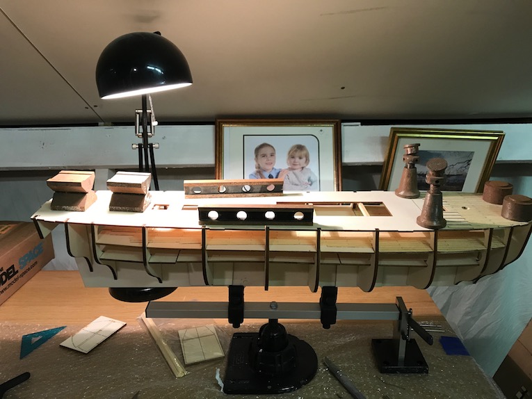

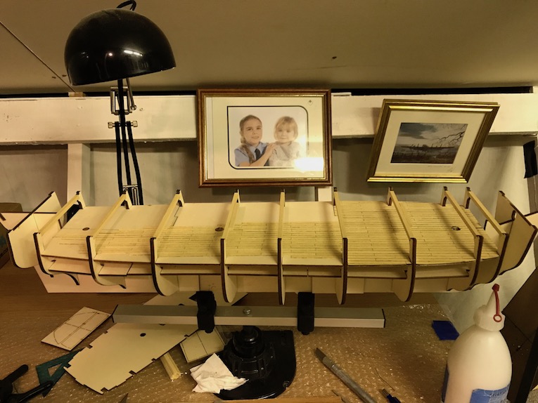

So on with the build. I started to progress the planking of the lower deck, however after downloading all the available instructions I noticed that this deck will not be visible. The cannons are mounted on backing plates and the deck is fully grated so no planking will be seen unless you plan to show some grating open or plan to swop out the cannons for full ones with garages etc. Which I am not so to save myself a good deal of time I have abandoned the decking and progressed with installing and planking the upper deck which is now complete other than soothing the deck and sealing with matt varnish.
The ply insert for the bow and stern have also been fitted completing me up to the end of the second delivery.

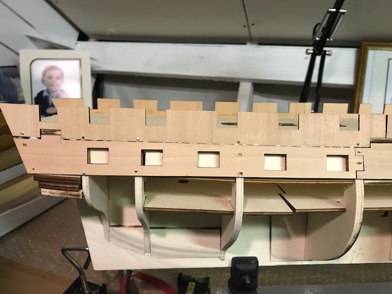

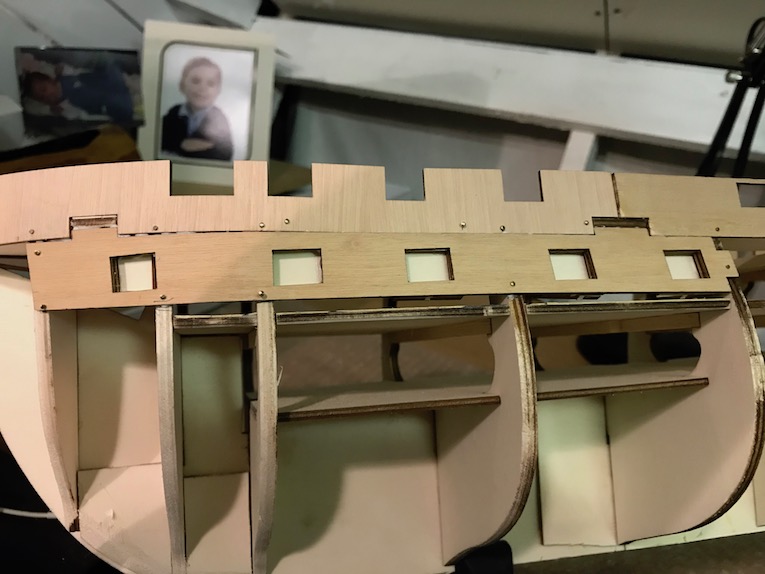

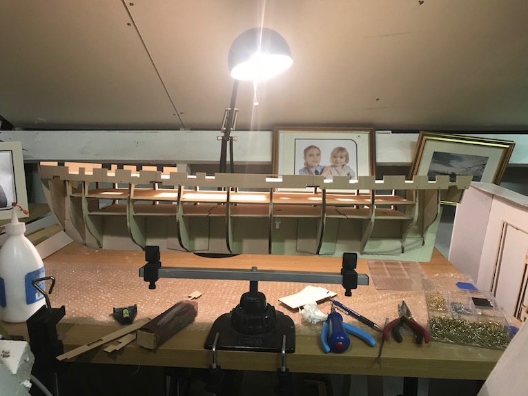

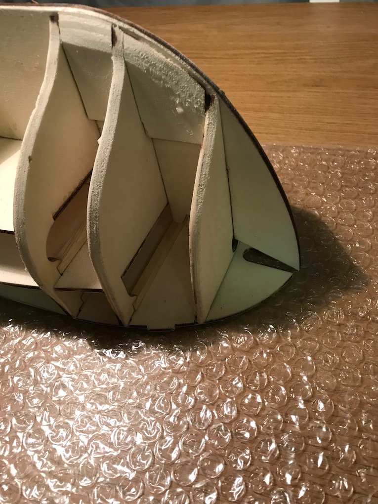

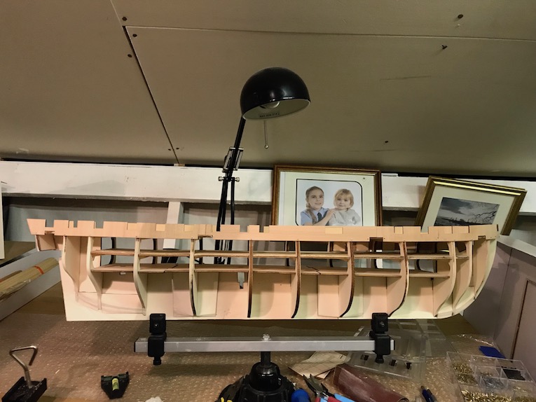

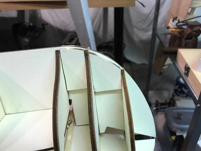

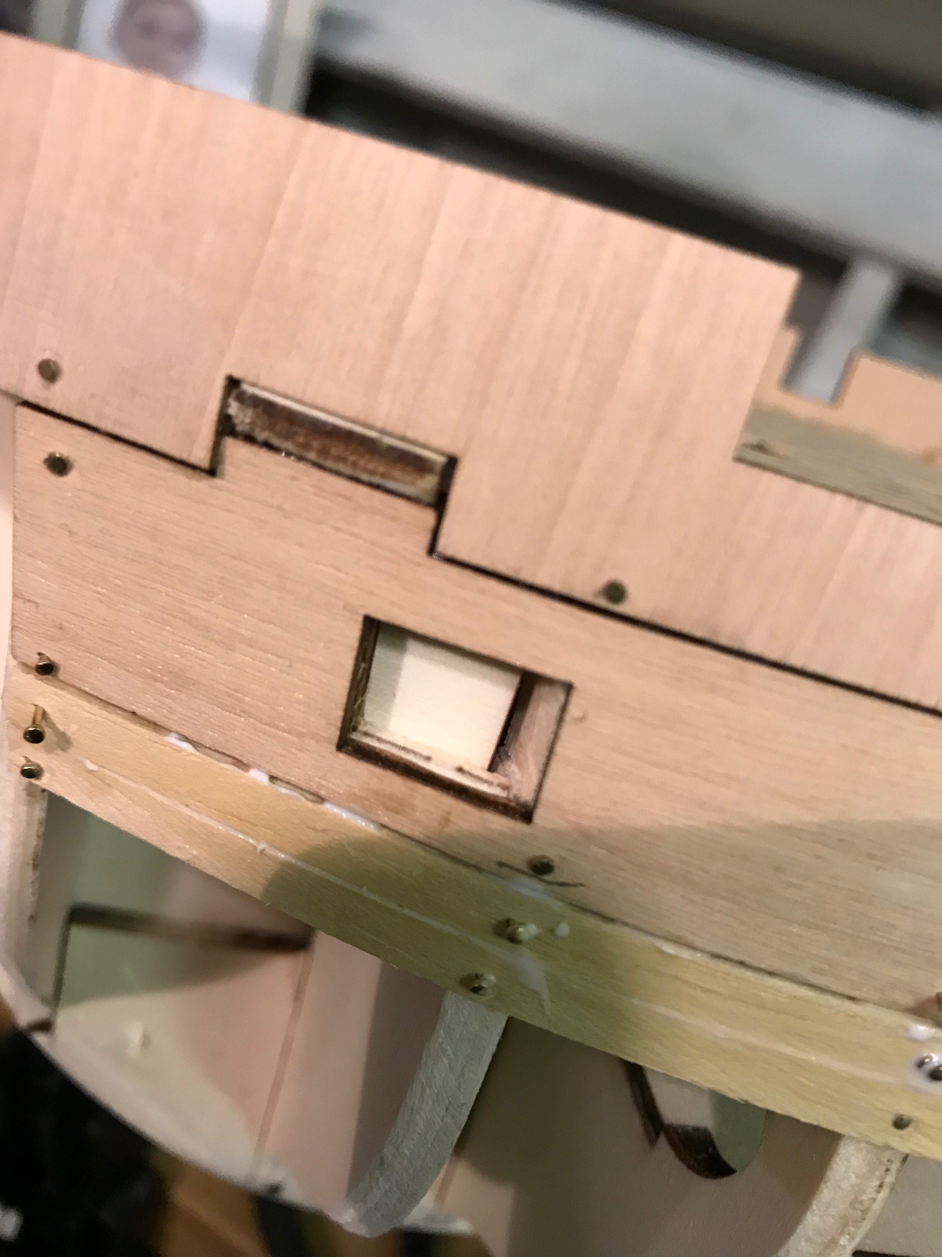

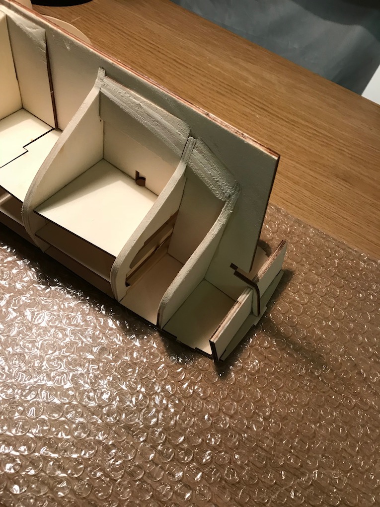

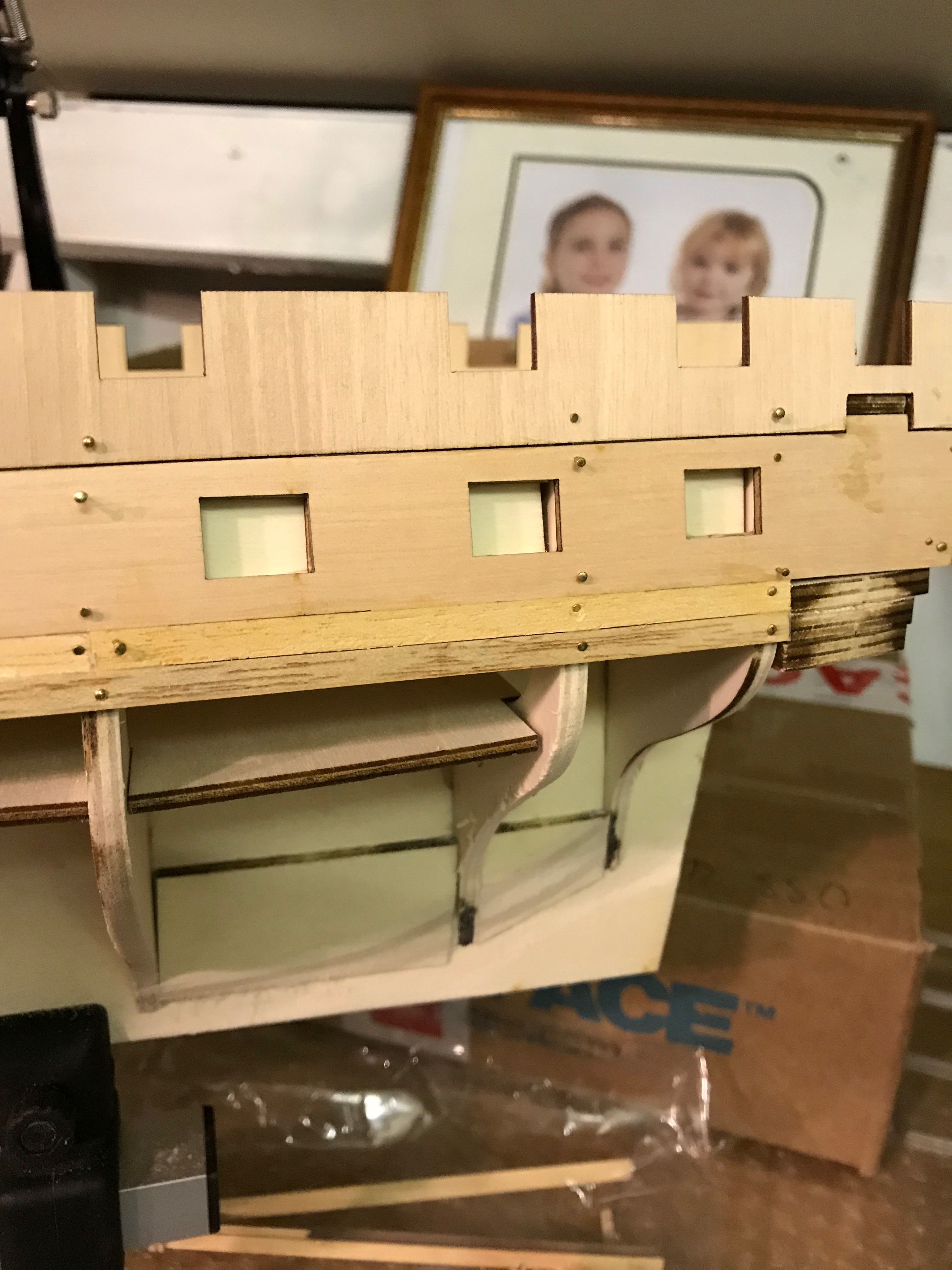

The fearing process is not to bad, I used Permagrit files for most of it, they power through this stuff.

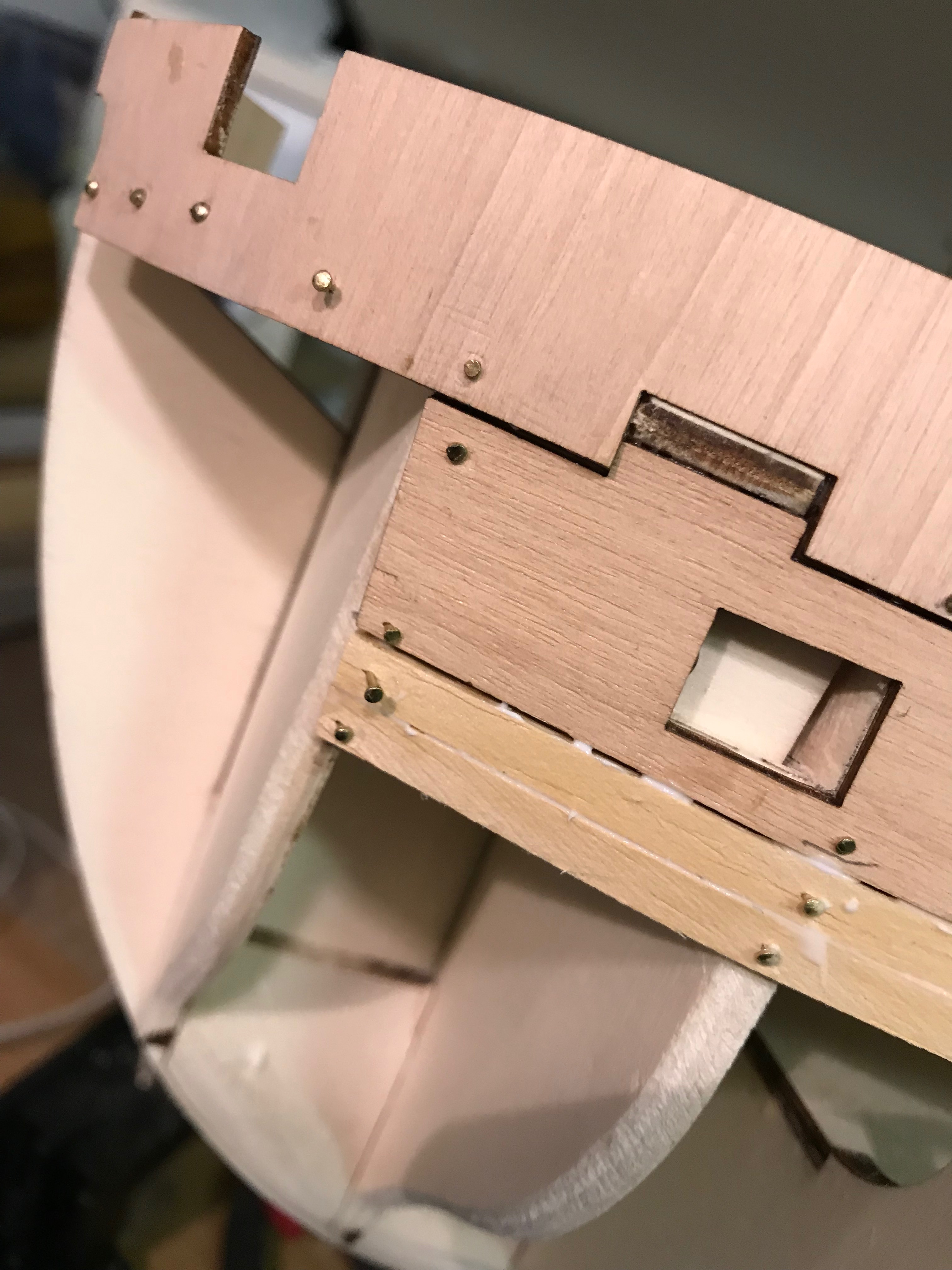

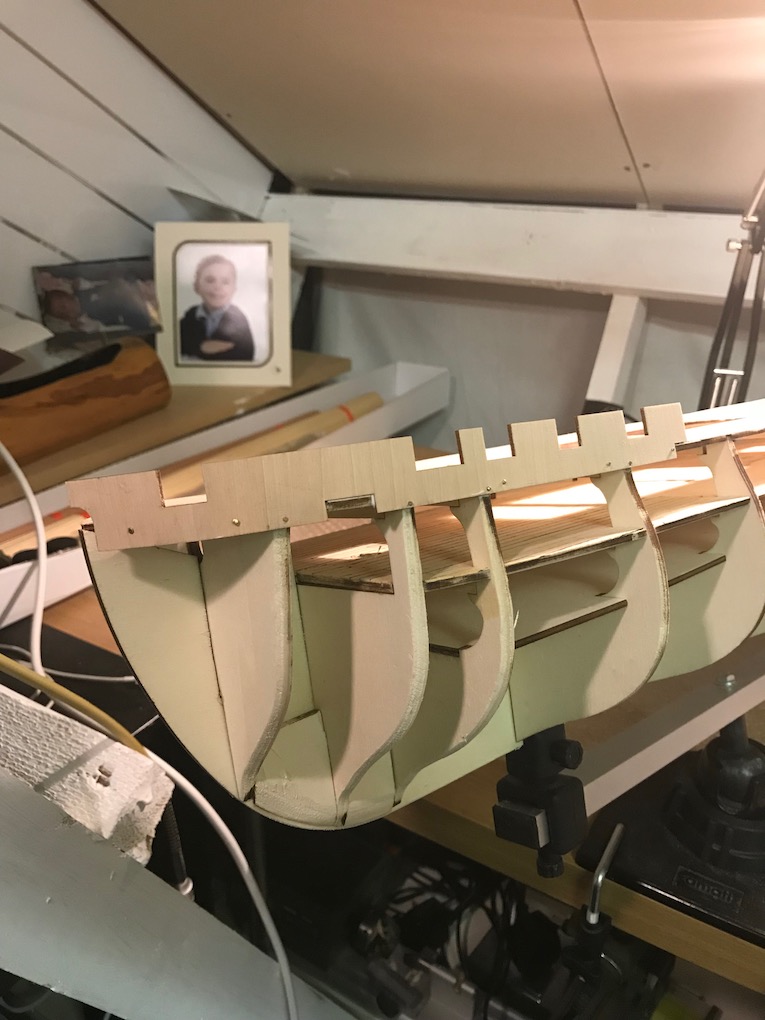

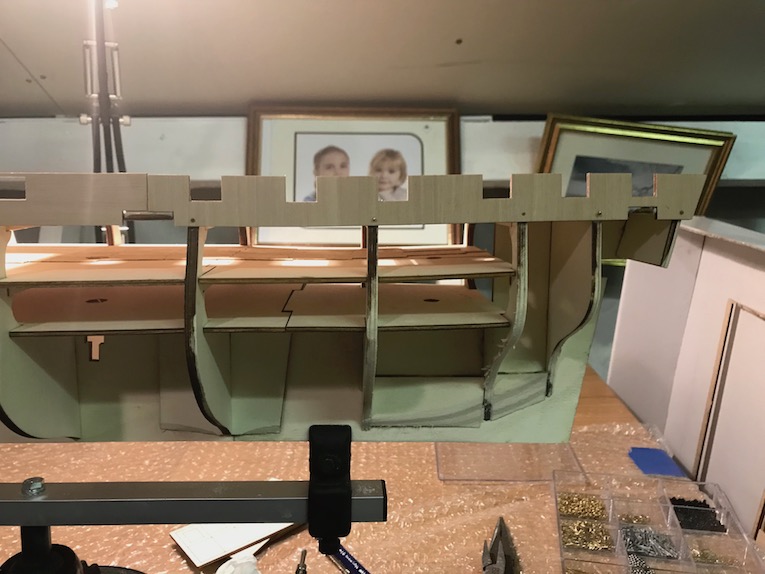

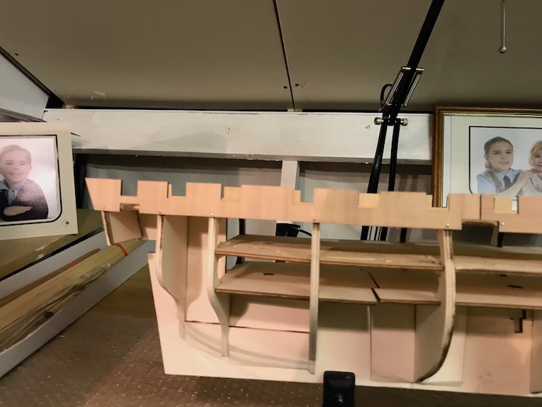

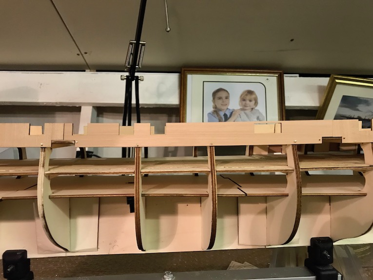

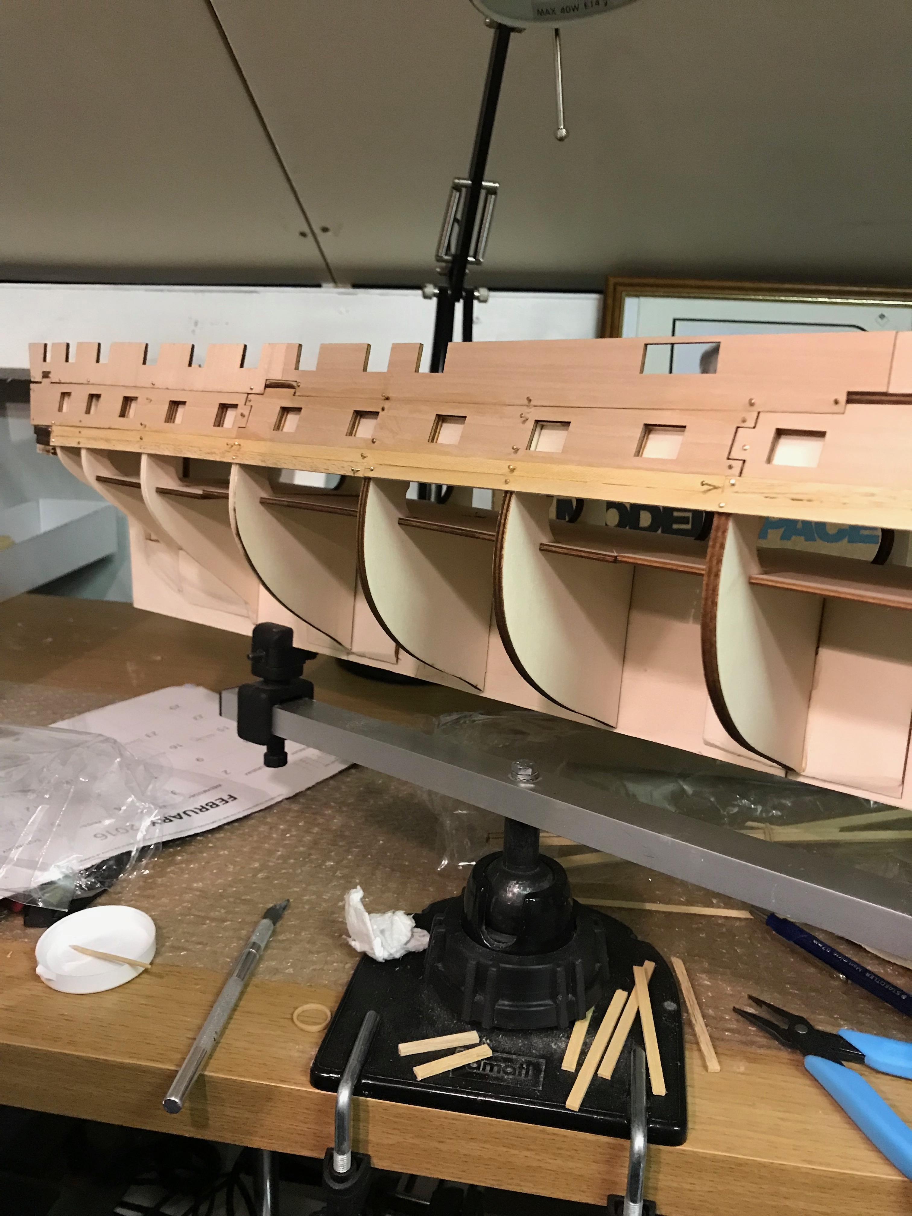

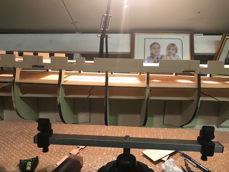

next comes the gun port patterns, the first ones are at the bow and it is easy to set them in the wrong place, care is needed to ensure they are both straight and meet in the middle. mine are off rvr so slightly but fixable when the planking gets underway.
I had a little fit issue with two of them that worried me a bit so went back and re checked all the construction of the ribs was correct, but it was a couple of the gun ports do overlap the ribs ever so slightly resulting in a need for me to chisel a bit out, nothing major though and fit was generally good otherwise.
#46 Posted : 21 October 2017 18:28:15
Hi Jase
Not sure what your referring to with your gun port fit problem as the instructions in pack 3 from page 44 stage 20 clearly point out that there are two gun port mounts per gun port strip that will fowl the frames if not trimmed back as per the instructions.
If any of the other gun port mounts fowled any of the frames not noted to do this I would double check your keel for warps and make sure its true. Another factor could be the inconsistent and variable temperatures in a loft being used for building can effect the wooden structure of a ship build quite easily and something else I would keep an eye on until she is fully planked.
#47 Posted : 21 October 2017 21:00:17
HI Andy,
no its not the blanking plates at the back that is the issues I have done all that to the instructions my gun port hole was part way over the rib so the rib could be seen through the gun port aperture
there is nothing wrong with the alignment of the frame no warping and the loft temperature is stable there is no movement in the kit wood at all. you will see it in the next update

Do you have a picture of the problem with the frame/frames that gave you a problem as I didnt have that happen with my build.

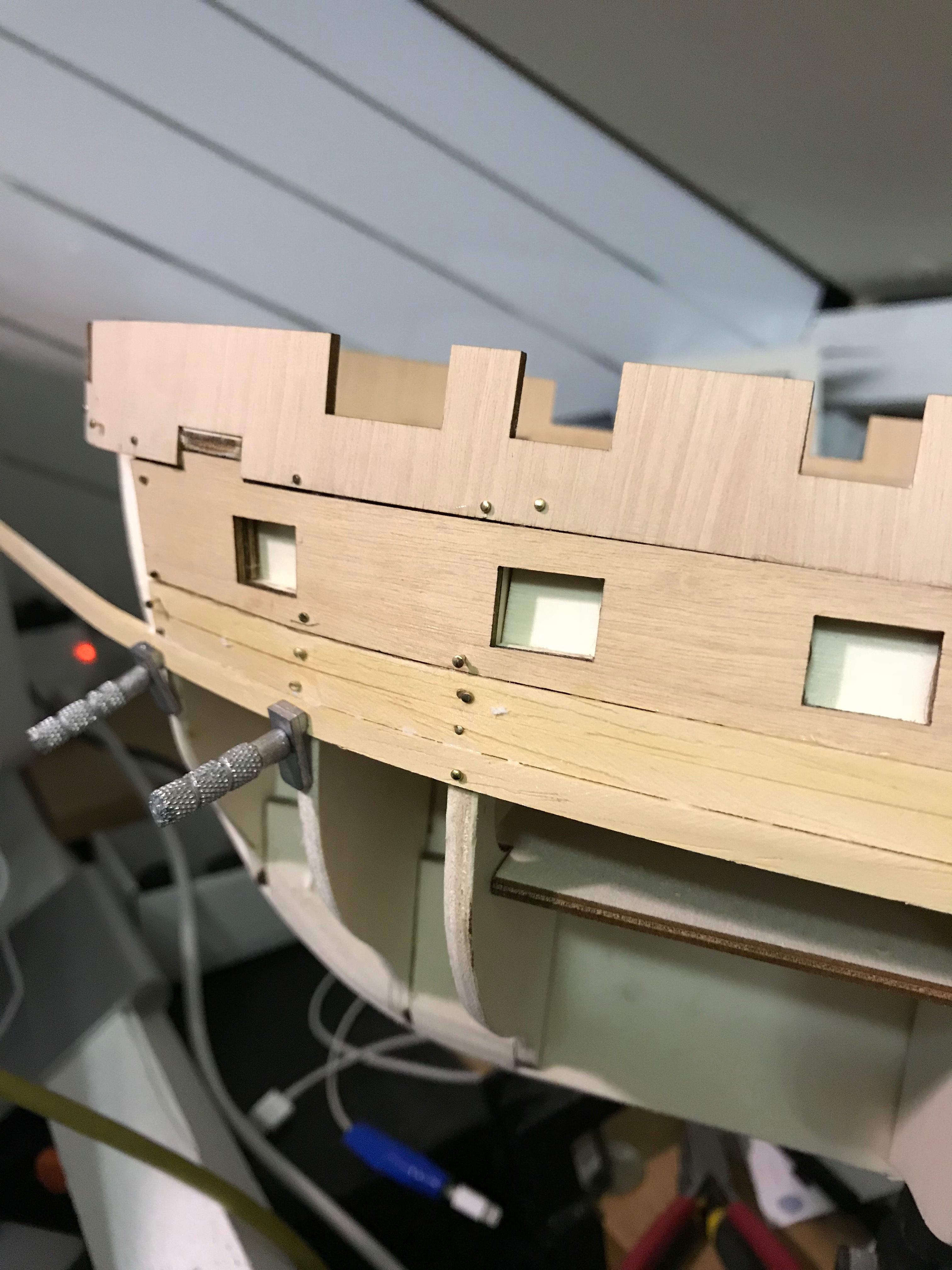

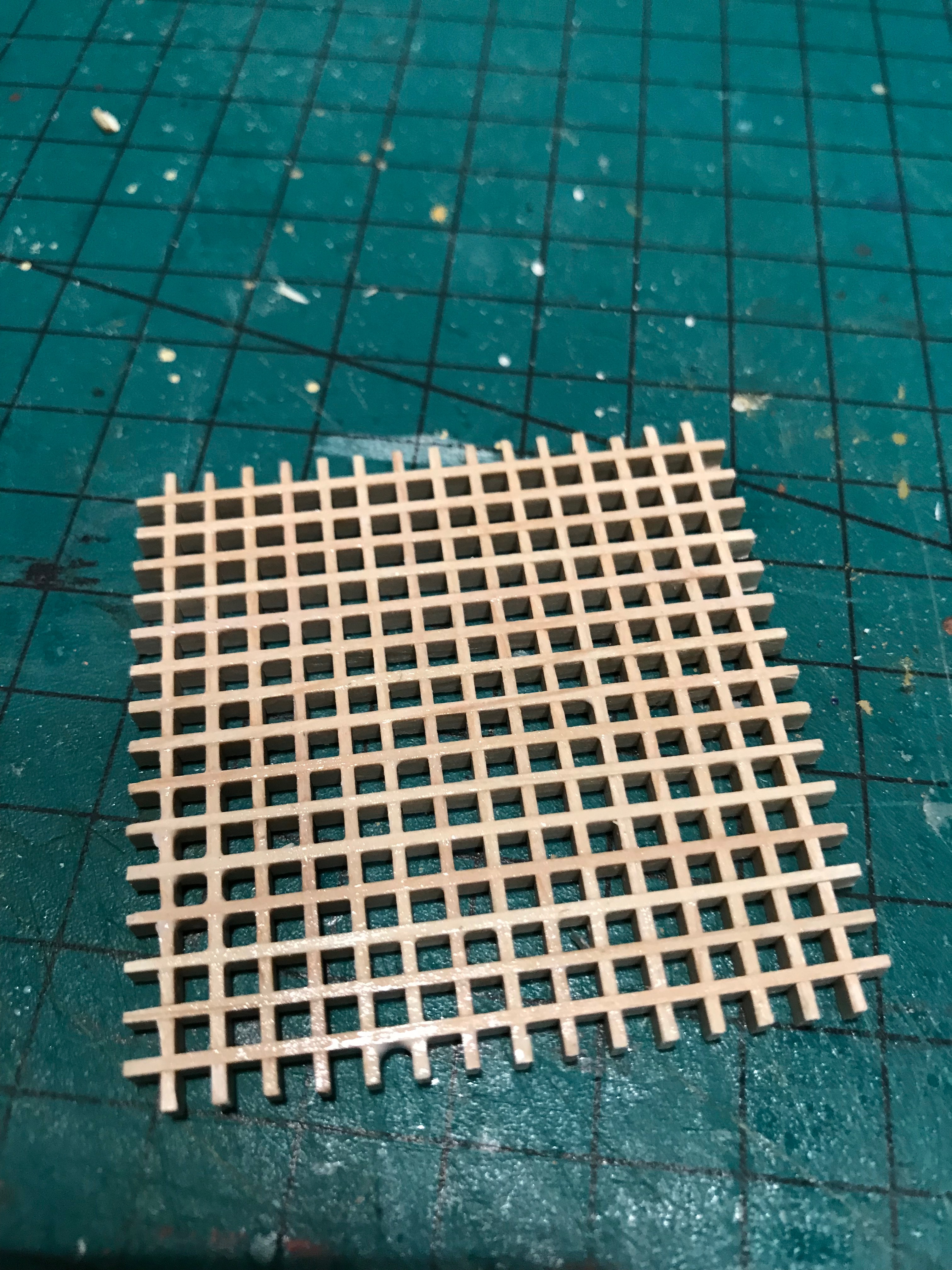

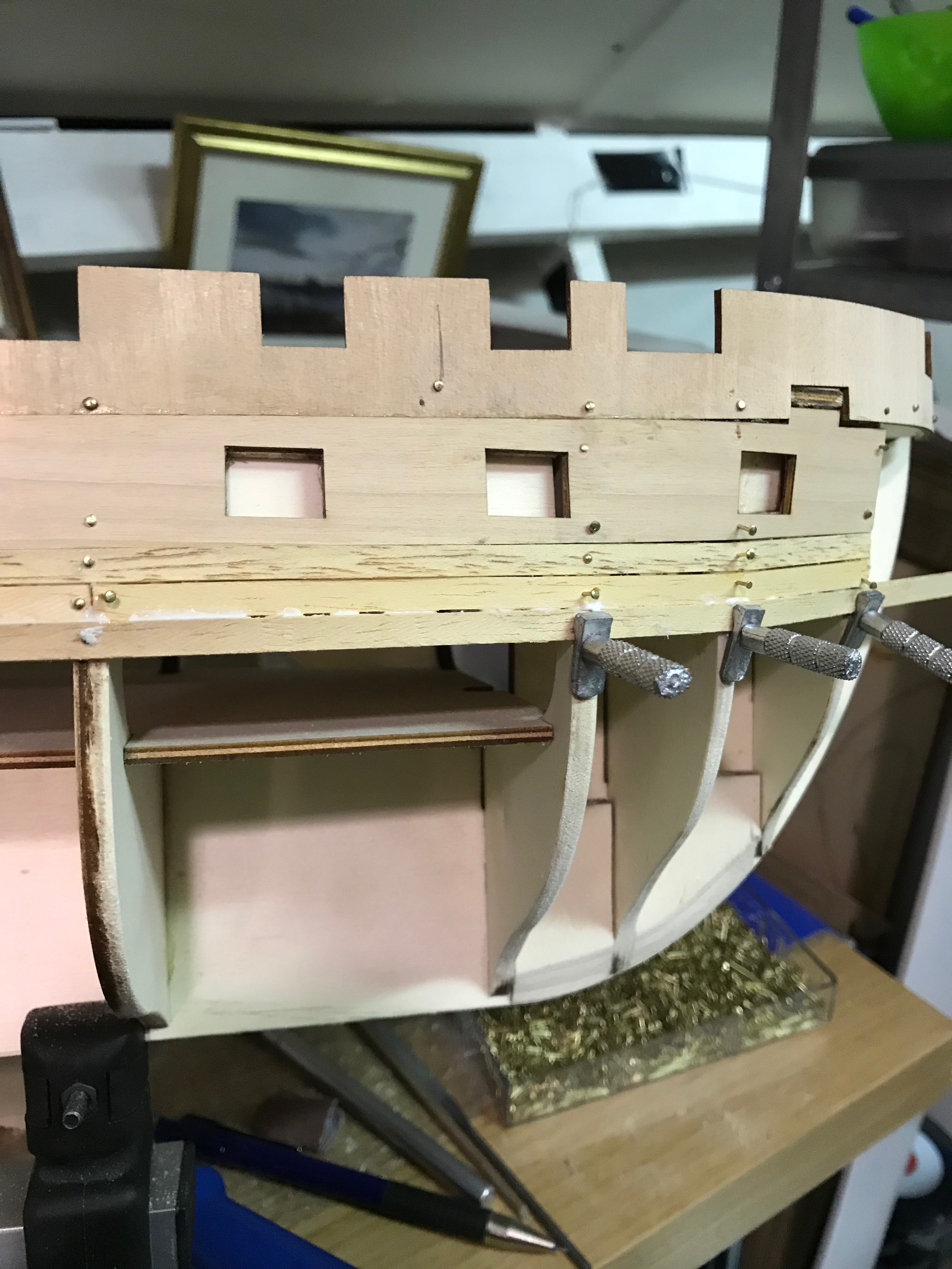

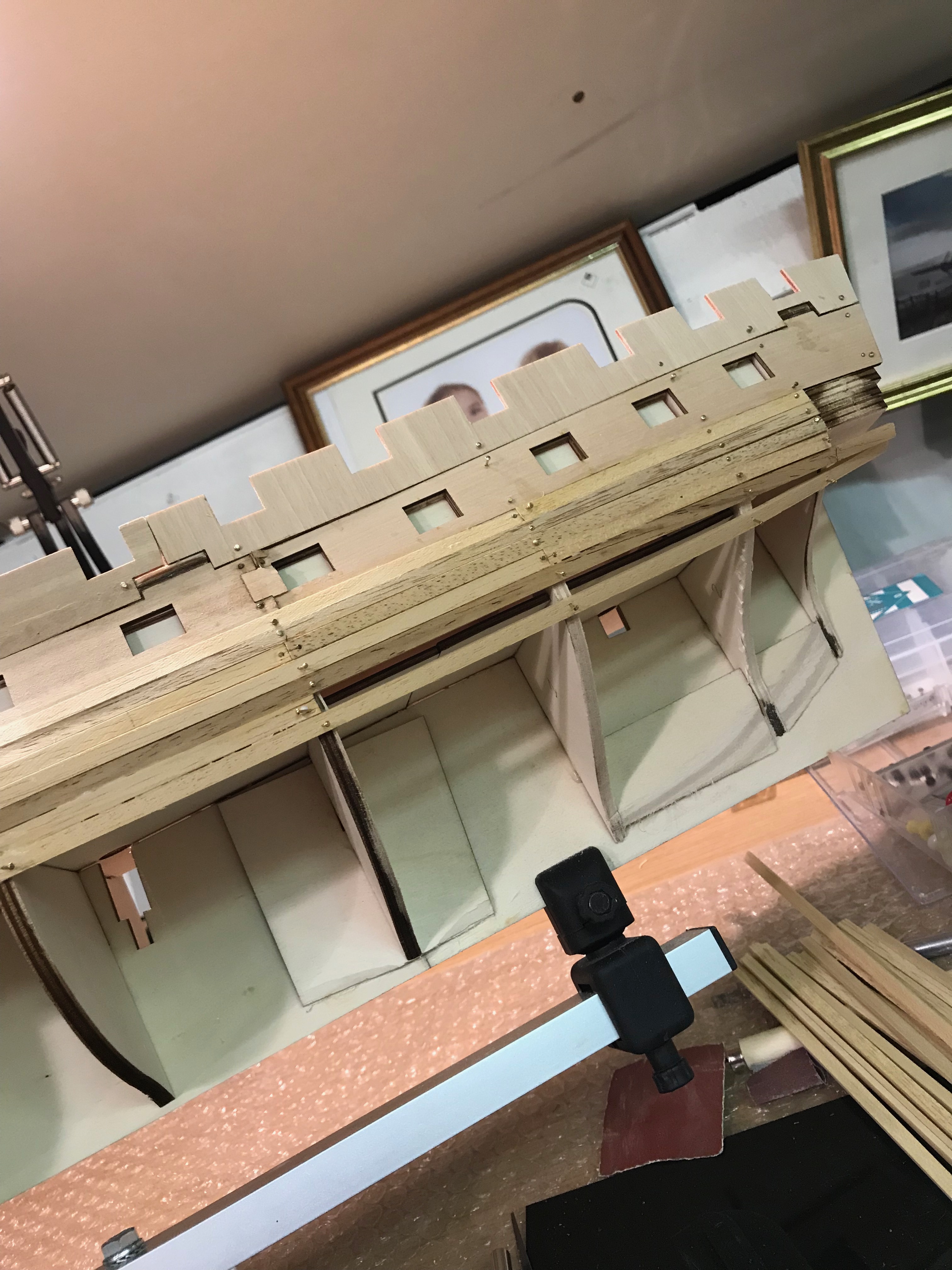

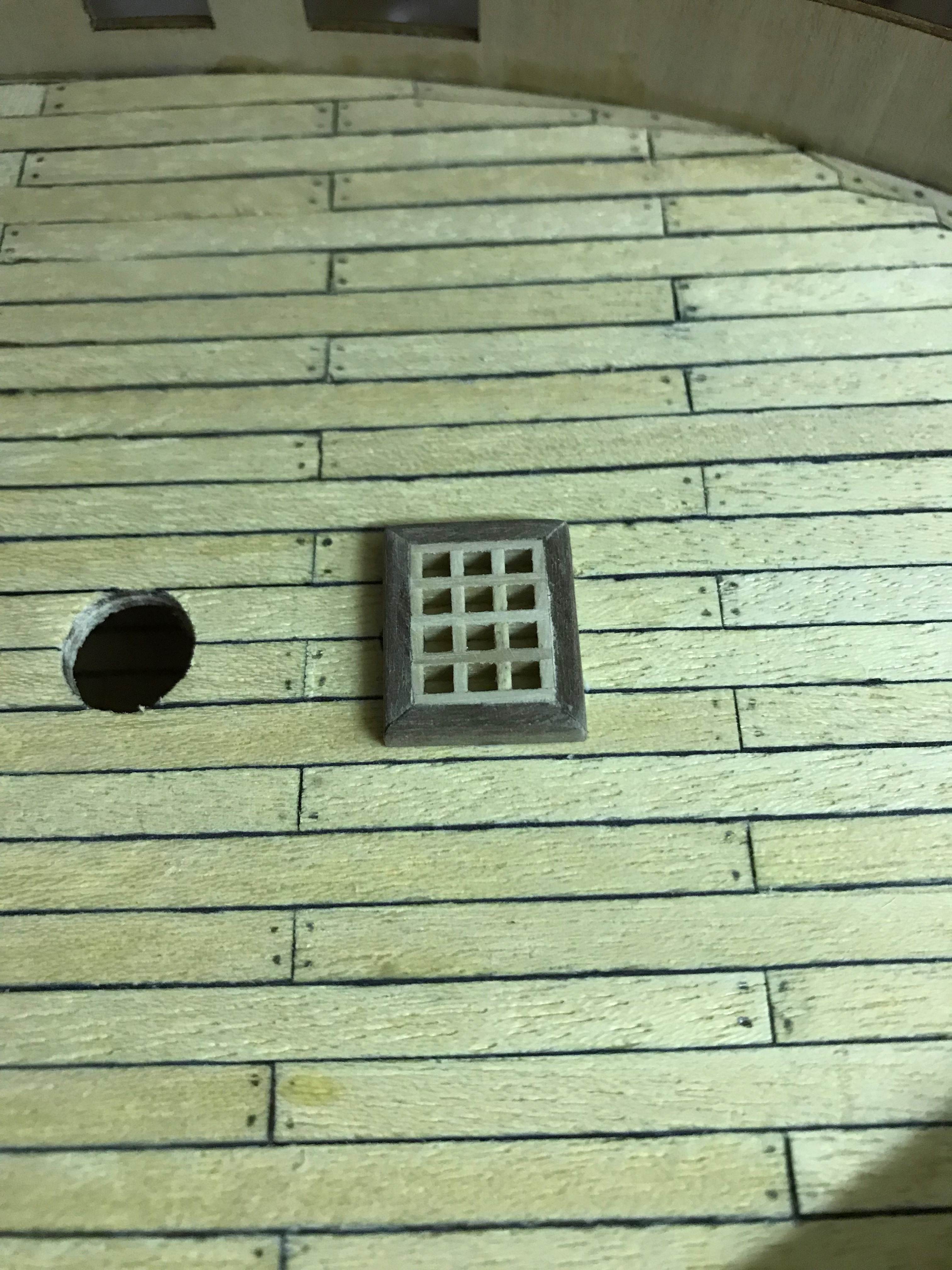

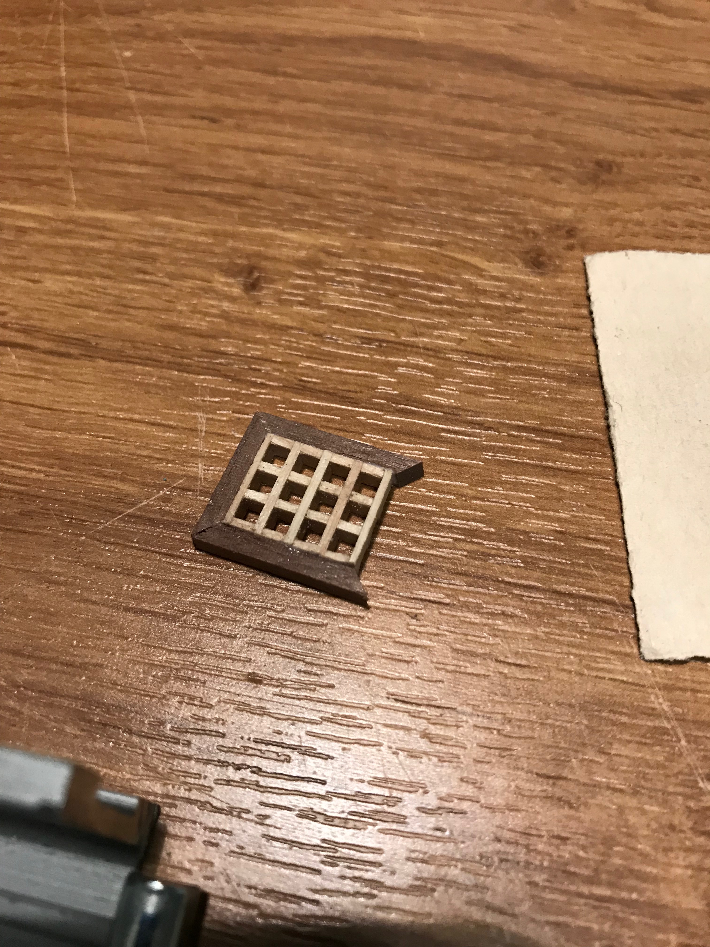

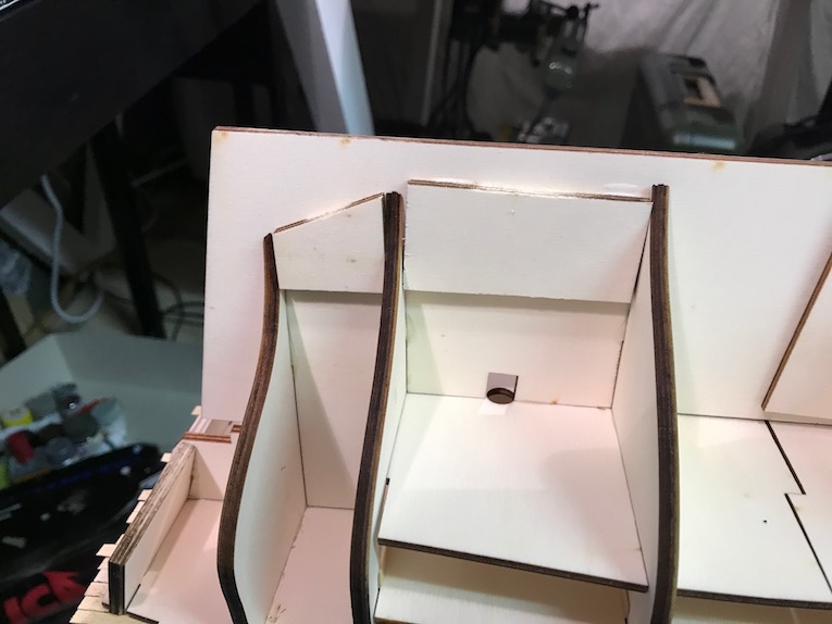

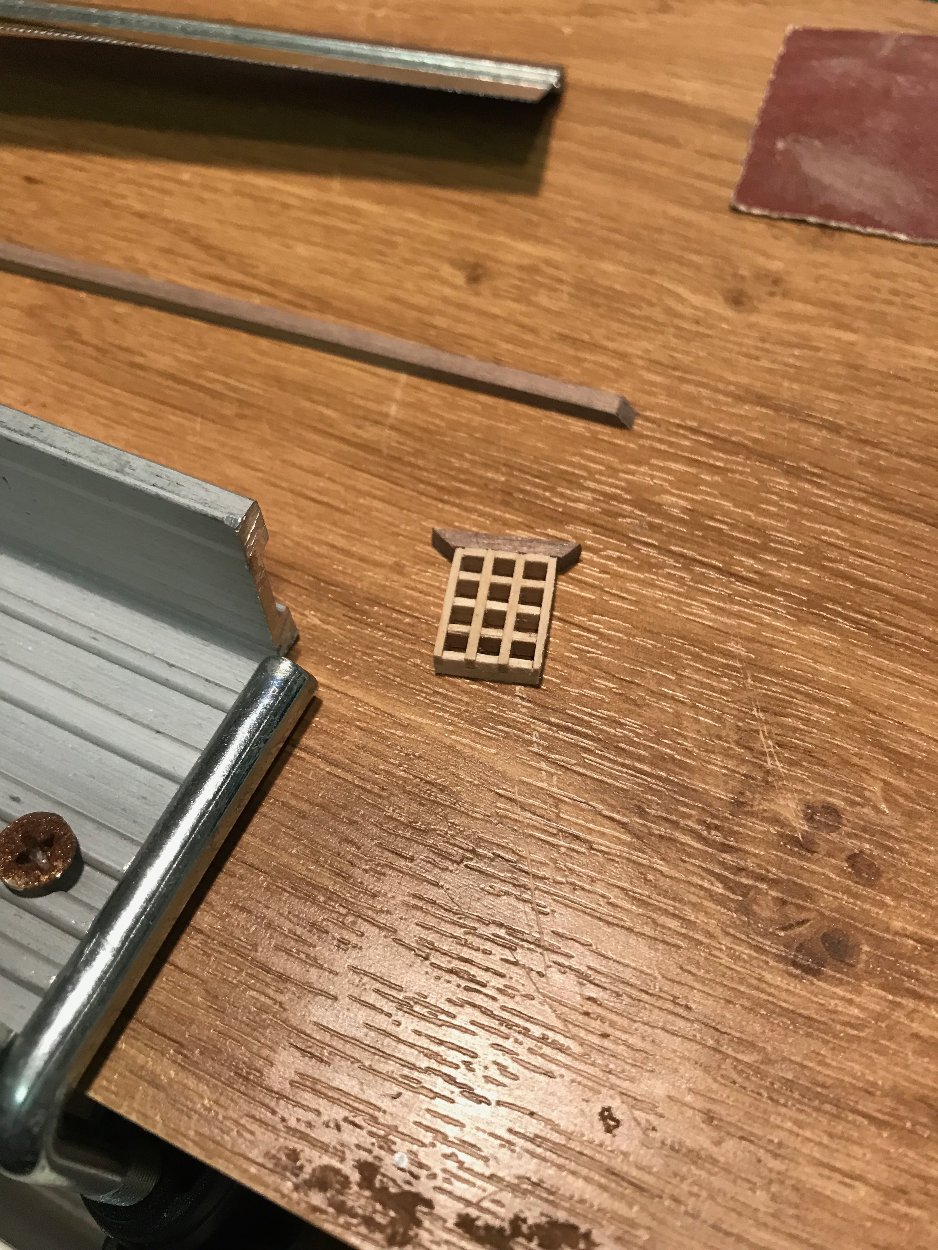

Some more pictures of my progress. I have moved a little out of sequence with the instructions, I tend to do that LOL LOL I prefer to complete the hull planking then go back and do the gratings in one go. That said I have done the first one while waiting for parts
You will see from my pics that have chosen to go the 'knee knockers' (yes thats the slang vernacular honest!!) around the grating slightly differently I have chosen to do a corner joint rather than the square on joint in the instructions, I think it has abetter look personal.
As some of you may have read in 'Scuttlebutt' I really love how easily this is coming together, the use of ply formers at the bow and stern is a really good idea that will save a lot of time and help perfect that shape. before anybody points out I haven't followed the suggested plank fall as per the instructions, I know and it really makes no difference as this is the first layer of planking, as ling as you have staggered the joints it will be fine, that said I am not advocating doing what I do Flapper
fun build so far.
First pic shows the issue previously discussed, I have to remove around 25% of the rib from fowling the gun port. yet everything seems aligned correctly.

Firstly it would be a good idea to resize your pics so they do not need to be downloaded to view them. After looking at your latest pics and it may be the angle of the shots it looks like the lower deck is out of kilter with the next one. just an observation and hopefully will not be a problem later on in your build.
