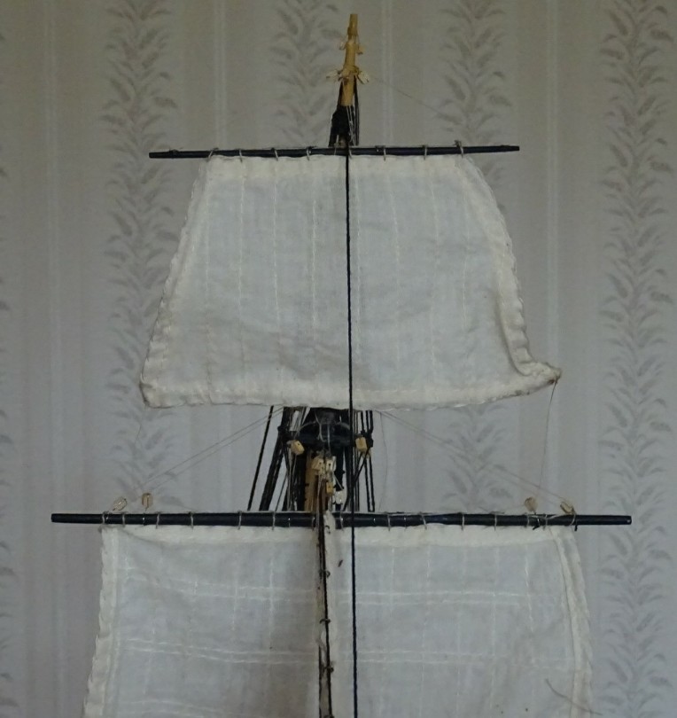

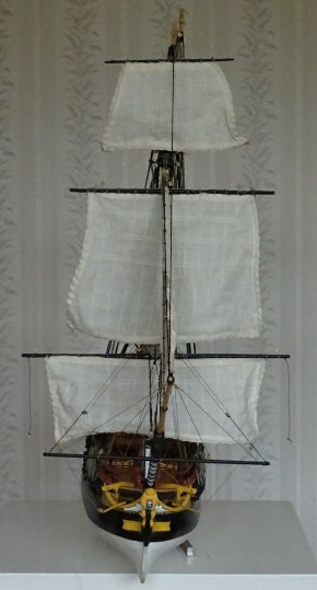

Modifications did not take as long as expected.
Top sail now looks better.
Norman

#28 Posted : 16 September 2018 18:32:40
BigGrin nice fix certainly looks good Cool
Martyn

Well done Norman,
glad you got it sorted out to your satisfaction.
Happy building
David

Well done Norman, great to see the fix has been done....Cool Cool .. Looks a lot better....
