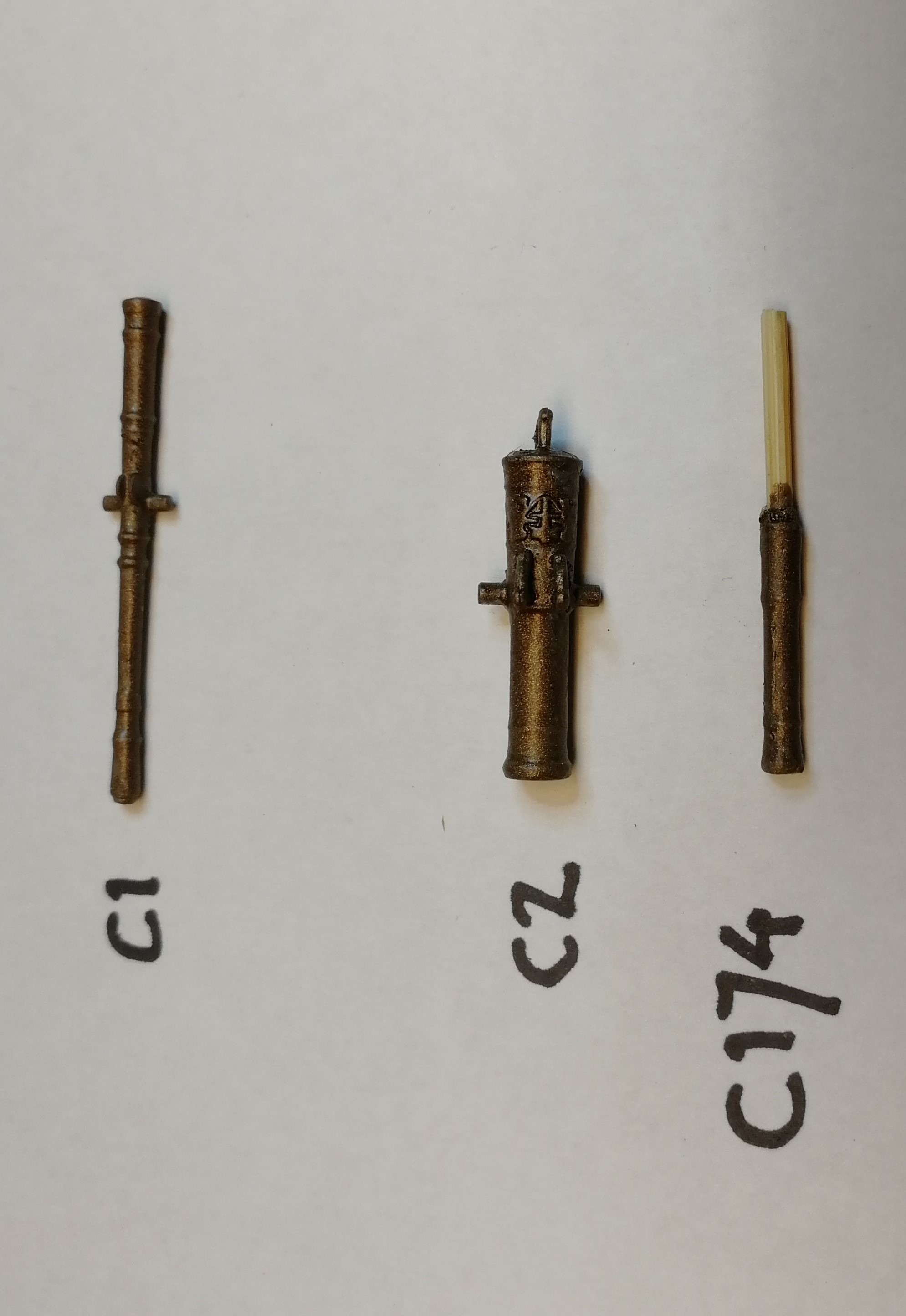

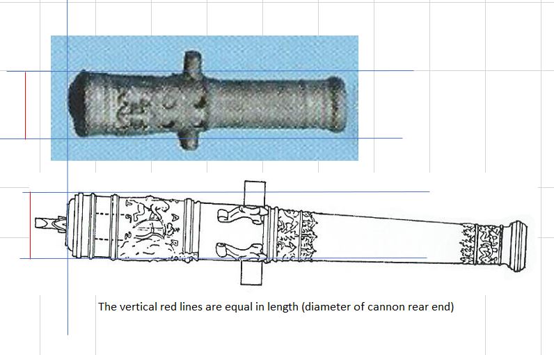

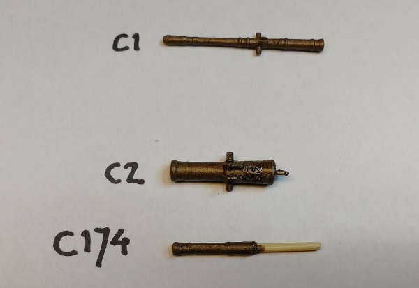

The size of cannons C2 and “half” cannons C174
C2 and C174 are the 24-pounder cannons, so they should be similar in size. As you can see on my pictures the C2 cannon is too short and stubby and the C174 cannon is not much larger than the 3-pounder cannon C1. Actually the C2 cannons barely passes through the hull thickness when put in place (see pictures at stage 123).
What to do about it? The C2 is very special with typical handles and engravings, are there any useable replacements on the market? Suggestions to make them longer?
Build instructions: Stage 2, 48, 68, 81, 93, 100
Fact: The 24-pounder cannon is about 2850 mm in length, so in 1:64 scale it should be about 44 mm in length. The C2 cannon is approx. 25 mm in length.
Fact sources: The book “Vasa I”, page 249/fig. 8-23 (drawing with measure line), the book (Landström) "The Royal Warship Vasa": page 133/ill. 197 (drawing), internet page https://digitaltmuseum.se/011024611375/kanon with some measures.

Something went wrong with my pictures. Now I discovered that there is a maximum size, and most of my own pictures are high resolution. So now I know why I couldn't add pictures to my build diary even when I had them...
Here are my cannon pictures again:
Per Ca attached the following image(s):

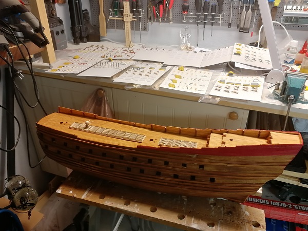

Thank you Martyn. That is what I am trying to do, so I need advice from others building this ship.
As you may remember I am an amateur in building small ships, but that does not mean that I am not trying to make it the best I can. Even the details.
But I make mistakes. I decided to stain the hull, but made it too dark and also didn't realize that even small glue drops on the surface is visible on stained parts. I have to reconsider.
Now I will try to attach a photo....

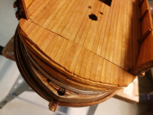

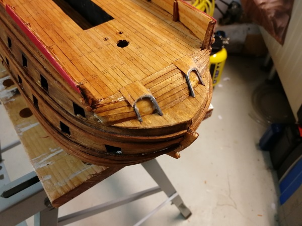

When it comes to the build of the hull I have mainly to things that concerns me. First, the planking of the lower part of the stern, and also the area at the bow in front of the main deck.
Stern planking: I think that the model makers should have used another method, or planking order, at the lower stern. At the original ship the hull side planking passes the rear planking, not the opposite as on the model. I tried to fix it on my model, but my build had advanced too far so the result wasn’t very good. However, I think others will do better, if they wish to do it right.
Build instructions: Stage 43 (but the side planking must not be cut earlier)
Fact: Hull planking ends are visible from the stern.
Fact sources: Landström, "The Royal Warship Vasa": page 82/ill. 100, p.107/i. 150 and "Vasa I": page 48/ill. 1-5. Also several pictures on the internet, although pictures from the Vasa Museum is mostly dark.
The second objection is about the flat small deck in the front of the main deck on the model. I have not found any pictures of the real ship with that deck. All pictures show a rounded construction. I have a couple of pictures showing the original build as instructed, and how it looked when I changed it. Please note that it is very unfinished, no steps or stairs, and no finetuning.
Build instructions: 69, 70 and more
Fact: The area in front of the bow is a rounded construction, not with a flat deck.
Fact sources: Landström, "The Royal Warship Vasa": page 81/ill. 96-97, p.84-85/i.105, p.88/i.111, p.89/i.115, and "Vasa I": page 452/ill. 18-35. Again there are several pictures on the internet, although only a few from the Vasa Museum showing this part of the ship.
