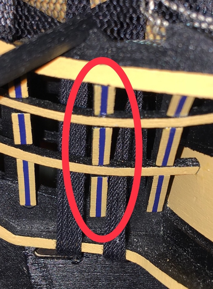

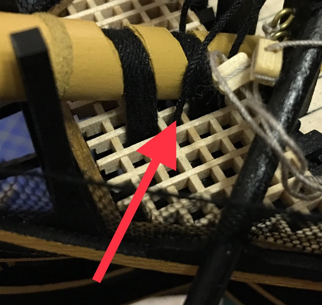

Hi All,
I’m on issue 96, fitting the two heart blocks.
There should be two threads go underneath the bowsprit.
One through the rear gammoning holes, I have no problem with this one.
However the second one, which supposed to be go through the hole between the two gammoning openings, impossible to make. Those holes are fully blocked by the bow frame between the two gammonings.
See photos attached.
There is nothing mentioned in the official build that it can be a problem, also no alternatives offered.
So where should I lead that thread through the grating?
Or shall I drill a hole through the frame?
Thanks in advance
PS sorry how the photos attached, posted from my phone.
Happy building!
Laszlo
gingerale75
#2 Posted : 12 September 2018 20:49:37
Joined: 30/11/2017
Posts: 493
Points: 1,482
Location: South Norfolk
Ok. I made it simple, two holes drilled vertically through the beakhead frame. Cool
