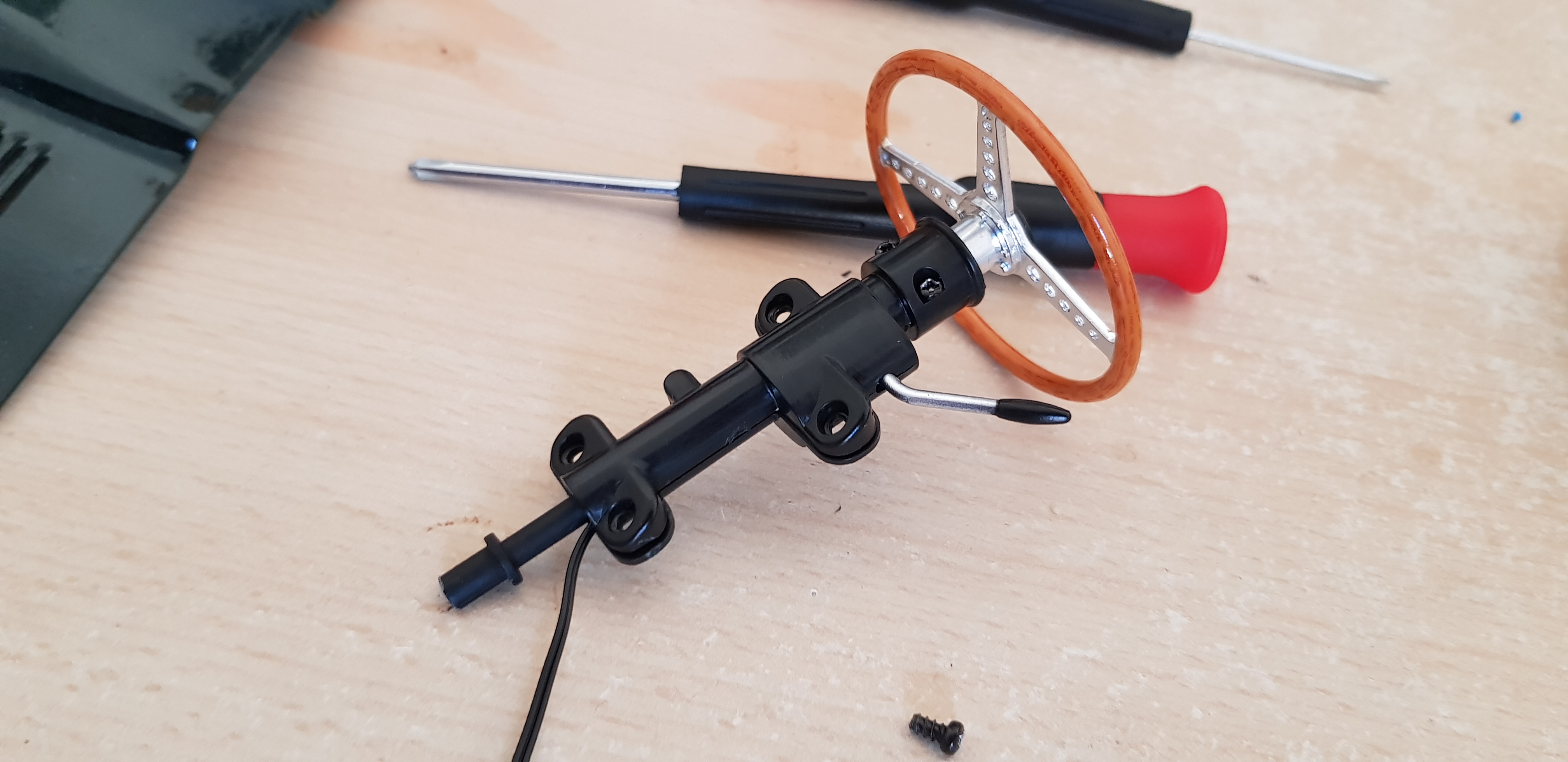

Ok, so its been a number of years since i did any fine detail models so i figured whilst building the jag that i would tweak my model in a way that i felt more comfortable with,
I.E. the electrics / lights
So first of all ill start with the steering column.

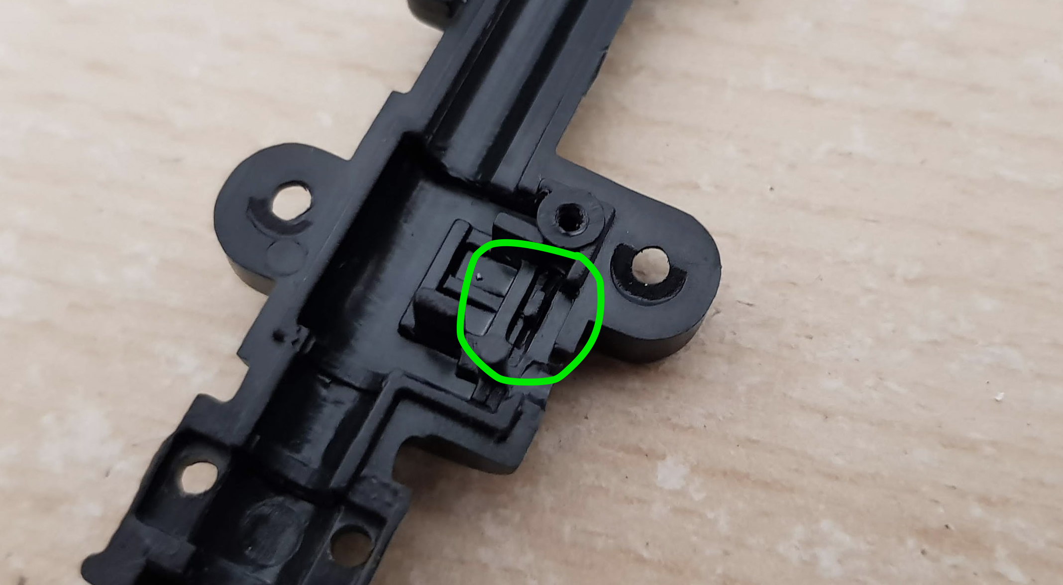

As i said in on of the other rooms i noticed whilst building the jag that there seemed to be space for another switch on the steering column where the indicator / light stalk fits in,

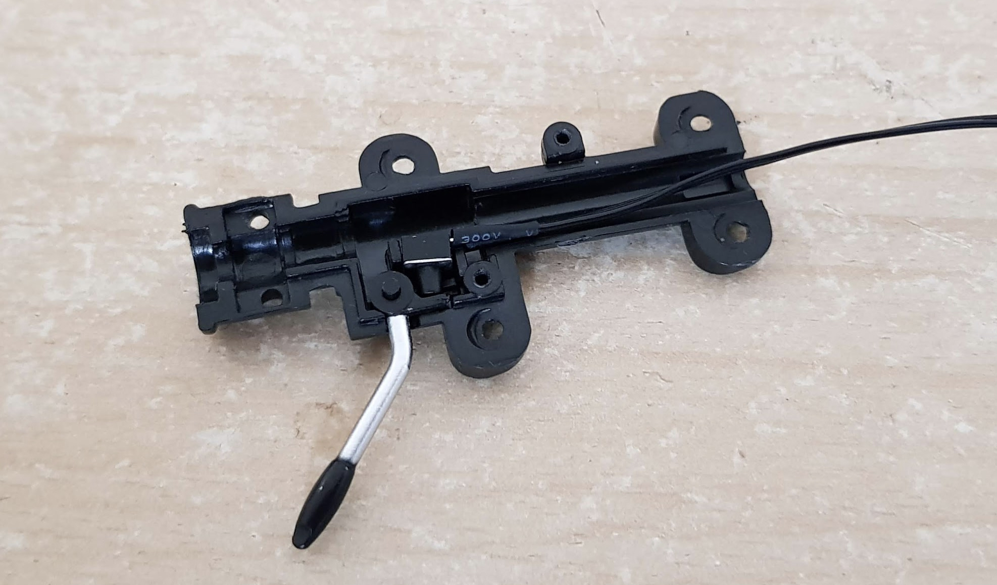

Indeed the indicator stalk its self has an armature on it that lines up perfectly with where the button on the microswitches seem to be.
There was a small nobble that was preventing the switch from fitting in the gap as this kept the switch pushed down when i tried.
This was removed by breaking it off with some needle nosed pliers
This allowed the swtich to fit in and the cable to run down the channel next to the steering shaft.
the whole thing goes together pretty much the same at this point,
So next up ill be doing some more with interior lights. and finding ways of getting a more accurate representation,
Got some SMD LED's on order and ill be keeping you all posted on my progress!

[size=9]Scradge,
So you used the microswitch that went to the right of the instrument cluster? That seems logical to me but why did DeAg not tell us to do it your way - is there a pitfall coming later?

Possibly. The freedom of movement in the steering column is a little less than from the default build. So that could be why.
The lead does scrape on the steering shaft a little. So that's worth baring in mind
And yes I used the switch from issue 64 to poor in there but I ordered a second issue so that i could choose which to use

Scradge,
Yes, and it occurred to me that the stalk might snap off if you were not careful - good to have a backup!
Did you start your build with the steering column??

Hey Slowner,
It doesn't seem that flimsy to me to be honest,
I'm kinda happy that the stalk has some functionality now as well.
