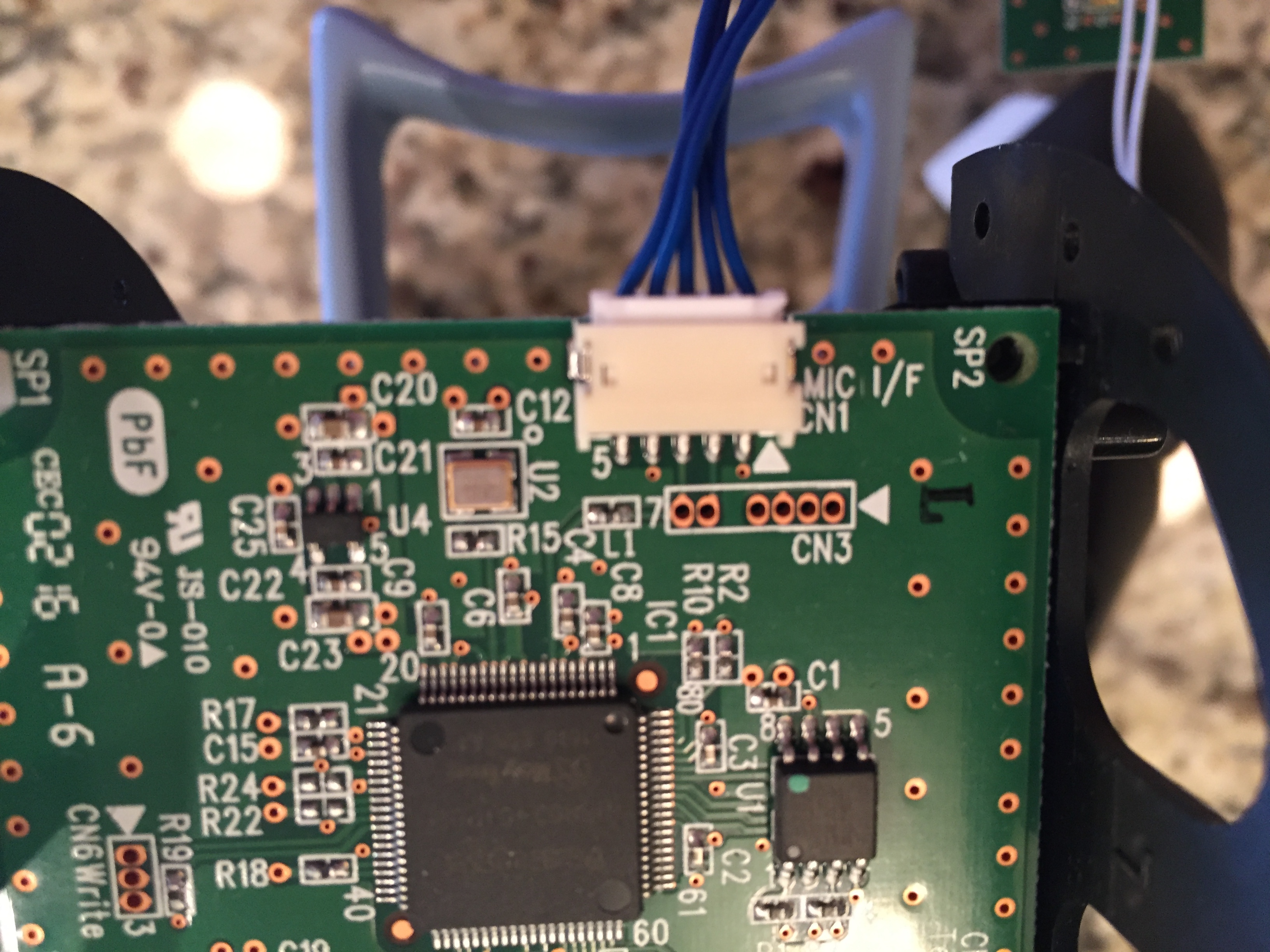

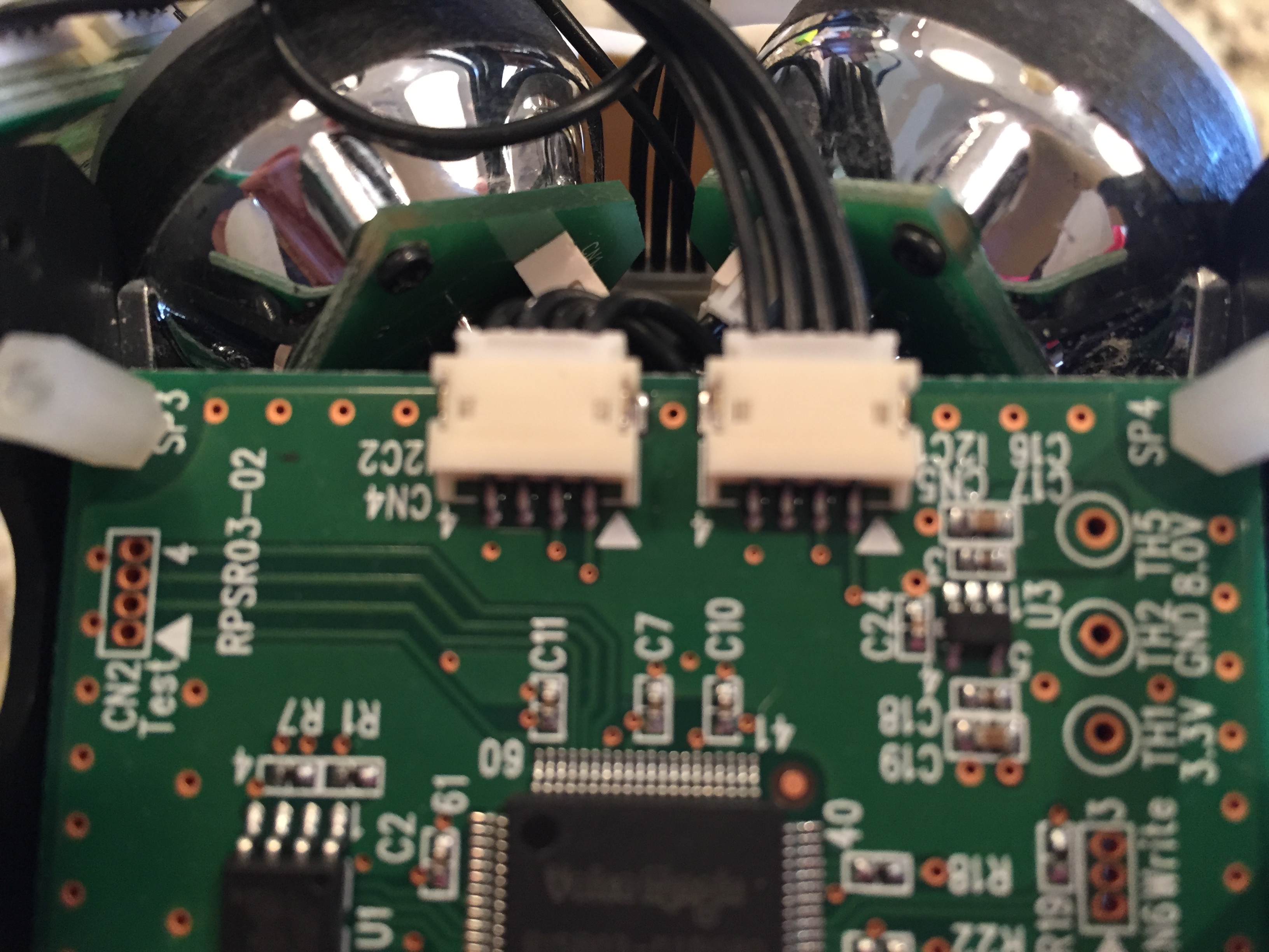

#130 Posted : 26 April 2017 22:45:15
Joined: 16/02/2015
Posts: 76
Points: 80
Location: USA Phoenix
I did receive a new MIC board (img 2222) and same problem of not response after my answer to first question of Yes Robi. I rook of head cover and when I put power on NO blue light and robi awakened and stopped after my reply. I have checked every connection and have attached photos. Can we get a response fro one of the construction engineers as to the meaning of no blue light and loss of responsiveness by Robi as mentioned above. I am open to all suggestions. The only thing I have not replaced is the VR board but I have changed out the blue 5 strand cable.
