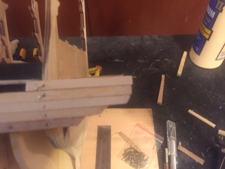

sorry I forgot to mention when I placed a piece of plank simulating plank # 5
at the end of the gallery support the supports brackets sit a tiny fraction above the plank I know I'm suppose to sand down the ends to match the supports

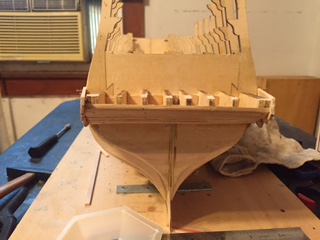

well you will not believe this when I added a piece to the starboard side and look at them the support gallery from the back before I took two photos of it
I notice only the port side is where the plank is off by a sliver the starboard side is correct meaning the piece of plank is sitting a little higher like it suppose to

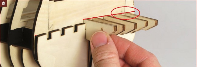

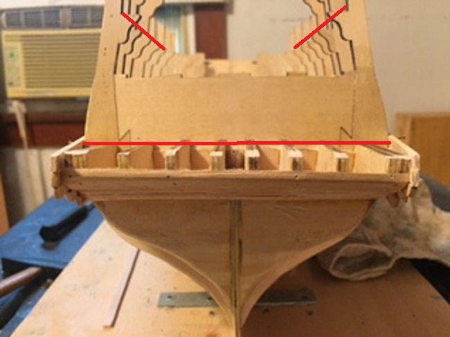

I have a concern that your rib 30 has not been fully seated into its slot in the keel and need you to check this out. Can you lay a strip along the deck supports of your ribs as shown by the two upper red lines on my attached pic.... The strip should lay smoothly between all of the ribs without any sharp turn upwards.
Notice the position of the join on frame 30, (highlighted by the red circle) the position in relation to the gallery supports. Compare this with the pic I've attached from the instructions and also the 8th pic on Stage 18 of the official build. Your rib 30 looks to be a little too high so we need to be sure.
Let me know what you find.

rib # 30 is seated all the way down sir,but I did notice the two end ribs 32 & 33 of the gallery supports will not touch the straight piece of wood I'm using
for a straight edge and the 5 ribs inside do touch the straight edge, also the gap on the left side closes to the end rib is very close what you think sand the
ribs inside to match the outside ribs, thing is I do not see any ribs turning up wards Ronald
