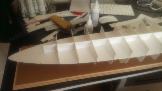

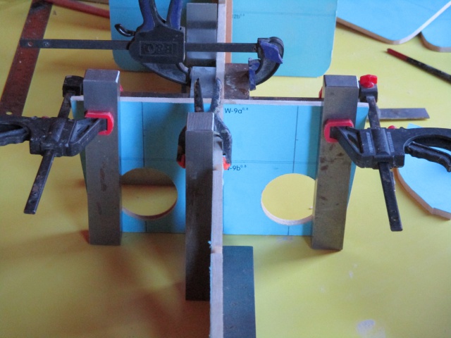

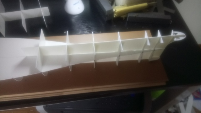

BigGrin Hi Folks

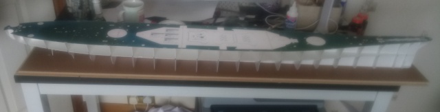

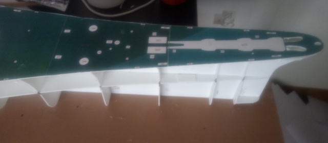

continuing with fitting the upper frames
Wondering if someone can help.....
Looking thru build diaries I am missing a lot of pics as they are not all opening when i load the page, which is a shame and annoying
If I refresh the page different pics may or may not open
Is there something I have to do at my end.
Thanks in advance
budgie attached the following image(s):

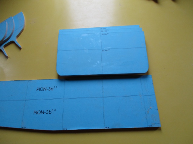

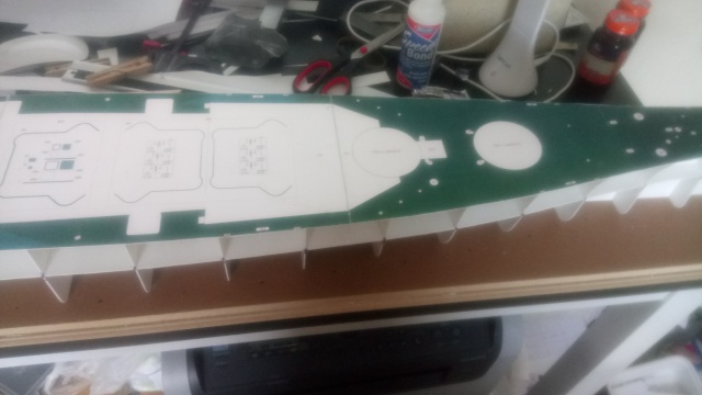

BigGrin Hi Folks
progressing with joining the deck parts together
I have used 0.5mm styrene as I will be laying a layer of planks and don't want the deck to be too high
Extra support for the deck will be underneath when I get round to the inevitable task of fitting formers between the framesCrying Crying
Deck not glued to frames yet
budgie

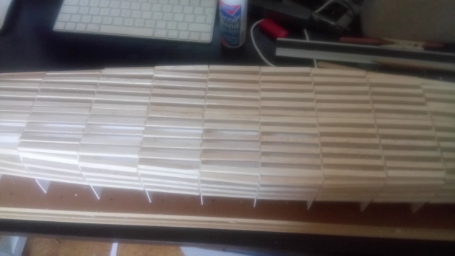

#24 Posted : 26 April 2018 14:02:59
Joined: 20/03/2010
Posts: 1,199
Points: 3,473
Location: Glenrothes

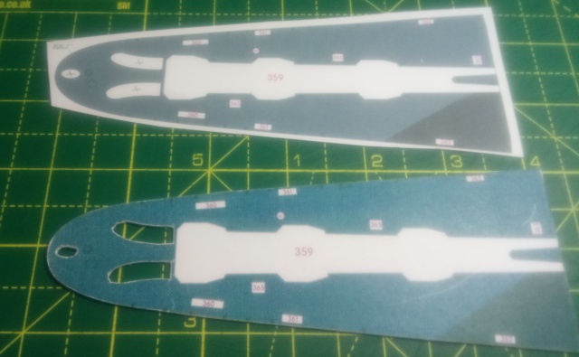

BigGrin Hi Folks
To prevent the card hull plates (I will be using styrene) from sagging between the frames formers have been added
This will give more area for the styrene hull plating parts to stick to and help shape the hull. Crying I think
I have used 6mm* 6mm balsa strips totally due to laziness in my part as using 2mm card will take forever
Blink (3 * longer).
Have completed the lower hull formers but will not start the upper hull until I have sanded those.
CoolMainly as I want to see how well the balsa has stuck to the styrene with the glue I have used (speed bond)when sanding.
Thanks for lookin'

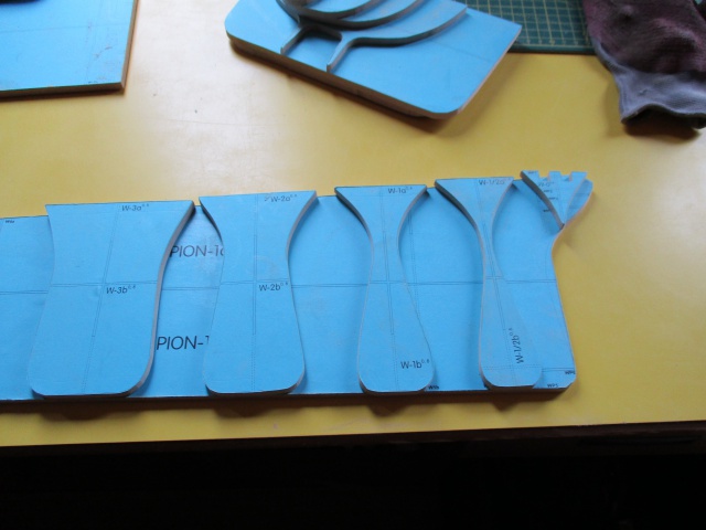

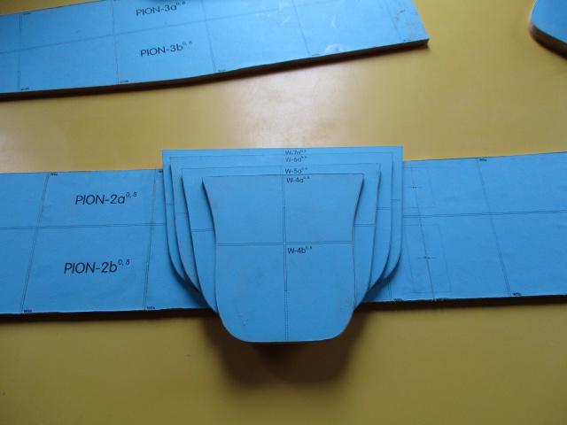

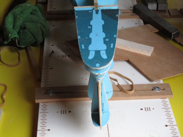

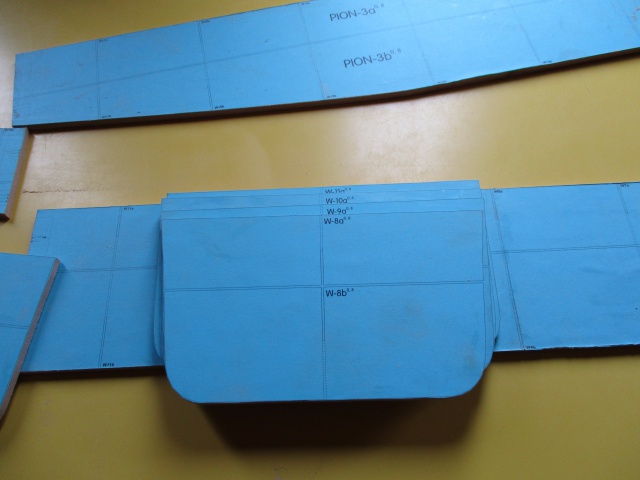

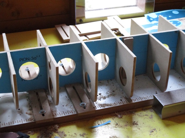

#26 Posted : 03 June 2018 12:56:49
Joined: 20/03/2010
Posts: 1,199
Points: 3,473

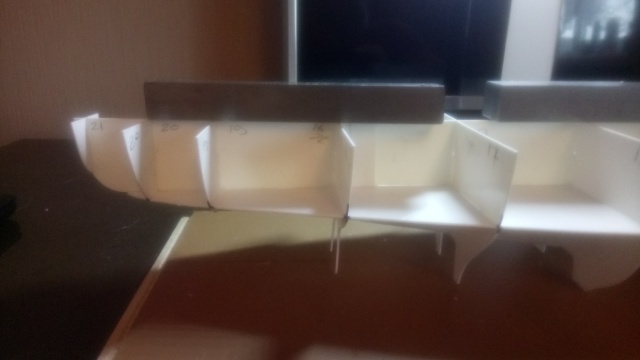

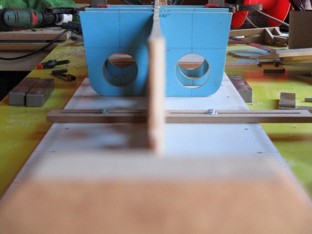

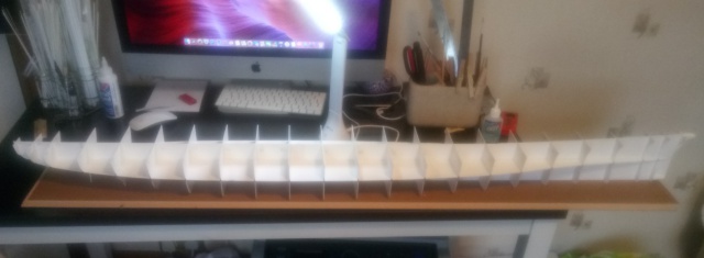

BigGrin Hi Folks
been a while since last post as have decided to restart yet AGAINLOL
Crying I wasn't too happy with the balsa strips glued between the styrene, too many sticks fell off while sandingBlushing
Cool Still it did pass the time while stuck indoorsCool
Drool Now moved into the shed so I am able to make as much mess as I like now
I have enlarged the templates by 141% copying them onto card
These templates were glued on to 6mm thick MFD (cheaper than plyBlink )and cut out using a jigsaw as near to the line as I dared and sanded down.
Will tidy up the shape when ready for assembly
I have a wee issue with Frame 0 at the pointy end and the last frame at the stern as they narrow down to less than the 6mm MDF keel
Decided I will sand those parts of the keel to make thinner so the frames will fit without losing their shape
Pics of progress so far with most of the big sanding complete
Thanks for looking'

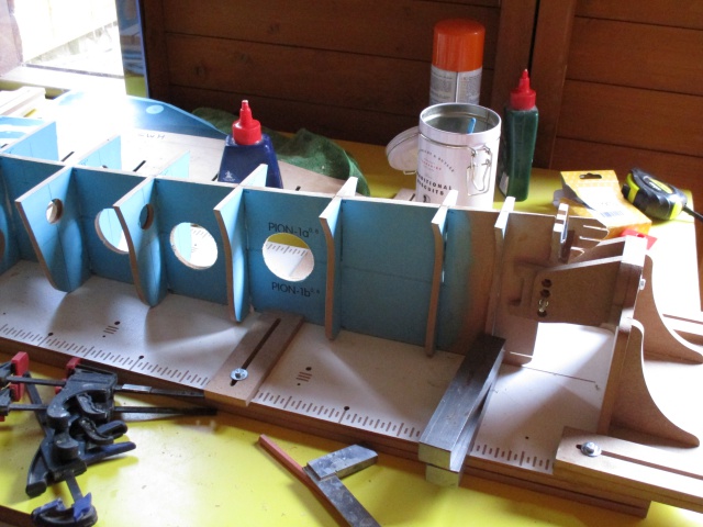

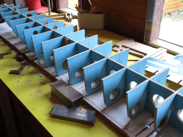

#27 Posted : 08 June 2018 20:11:24
Joined: 20/03/2010
Posts: 1,199
Points: 3,473

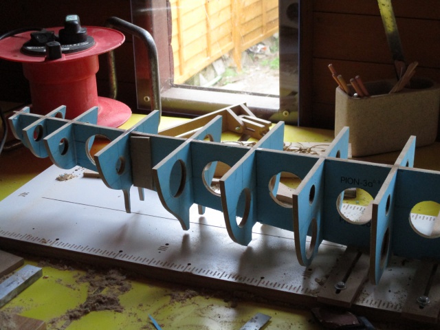

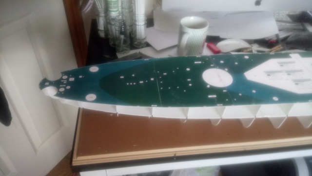

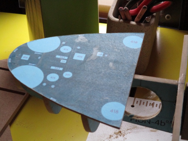

BigGrin Evenin' Folks

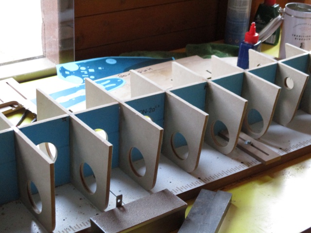

Made a start on putting the keel and frames together
Decided to cut some holes in keel and frames incase I decide to go r/c so will make it easier to cut bigger chunks out of her for access later onLOL
But mainly because it makes her look more interestingLOL LOL
The keel slopes fwd to aft but there is virtually no camber on any of the frames port to stbd
I have managed to sand the pointy end to make her thinner but broke a bit off
(Laugh heavy handed clumsinessLaugh )that will be stuck back on later when adding balsa to the area to try and get a nice shape
Anyhoos pics of progress
Cool Thanks for lookin'
budgie

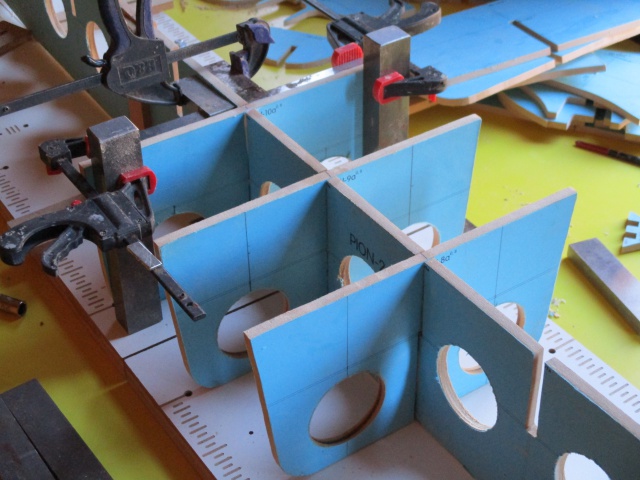

#28 Posted : 09 June 2018 19:12:14
Joined: 20/03/2010
Posts: 1,199
Points: 3,473

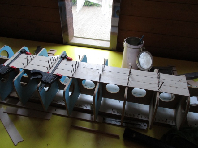

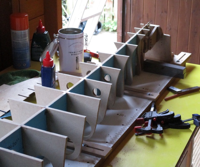

BigGrin Hi Folks
Mellow finished drilling holes for the mouse's to run thru and bunged the frames on the keel.
Crying Almost ready to start plankingCrying
SWMBO has finally taken down the blackout curtains from the windows and I have had the pleasure of fitting wooden venetian blinds in their place.
(How do u make a venetian blind?? Poke em in the eye)
As these are purchased off the shelf and not made to measure there are quite a few slats not required and they are only 3mm thick. Blink Mmmmmmm big ship bigger planks???

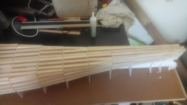

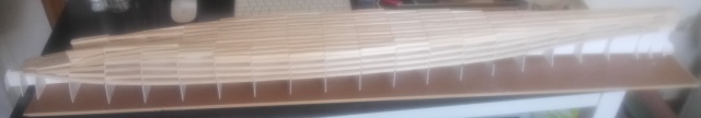

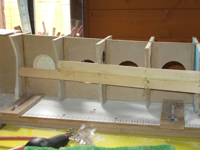

#34 Posted : 17 June 2018 10:00:21
Joined: 20/03/2010
Posts: 1,199
Points: 3,473

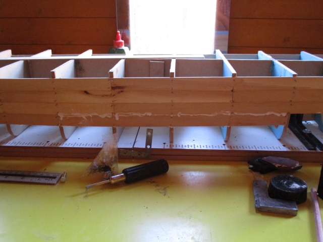

BigGrin Morning' Folks

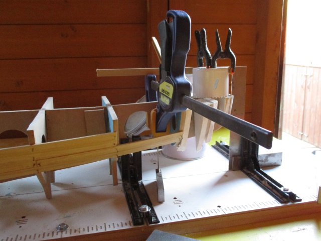

Went out to the shed the next day and pulled the "blinds" down
They pulled away from the frames with little effort, should have sanded the paint of them first???
Decided to put hand in pocket and purchased some 2mm thick lime strips
20mm and 15mm wide for straight areas and 10mm for bending and filling tighter areas
Put some balsa between some frames to help shape them and give a larger area to glue planks on the curves
Pics of progress (slow)

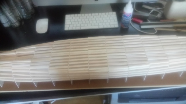

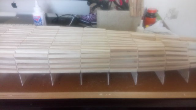

#36 Posted : 22 June 2018 22:12:30
BigGrin looking goodCool
budgie

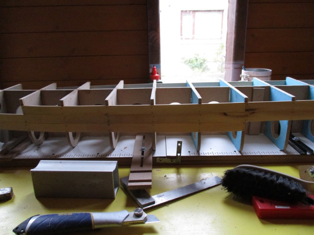

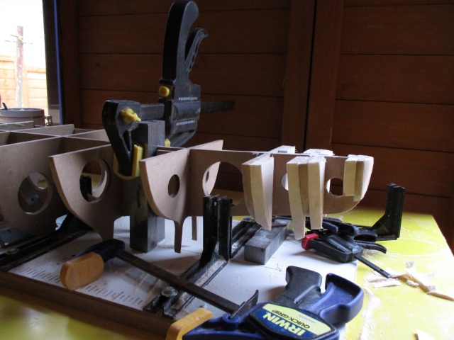

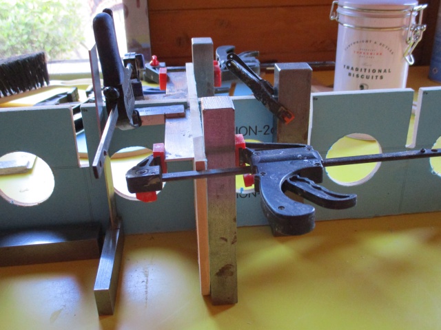

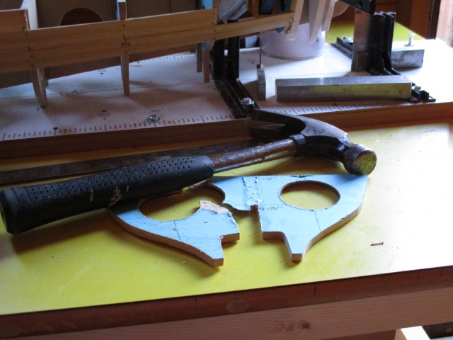

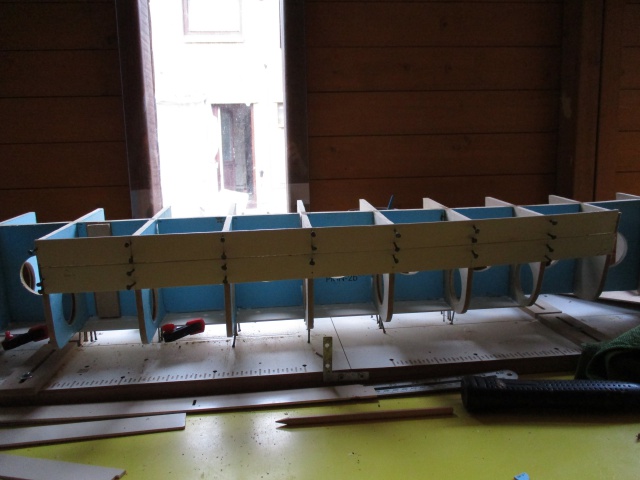

#37 Posted : 27 June 2018 20:20:22
Joined: 20/03/2010
Posts: 1,199
Points: 3,473
BigGrin Evening Folks
Slow progress with the good weatherCool
Had to redo frame 17...square to the keel at the top horizontally but it was squint on the vertical by a jolly good amountBlushing Blushing
I did not want to soak the join to remove the frame as I am using MDF and I have found on previous attempts to my embarrassment that if left, the moisture gets absorbed and swells the MDFCrying Crying
LOL So I just hit it with a big hammerLOL LOL
Coming up for the stern so I am soaking some planks for bending
Keeping a magnet beside the pins stops me having to pick them off the floor every 2 minutes LOL
Thanks for looking' (no GBored listenin' to radio2 too much)
