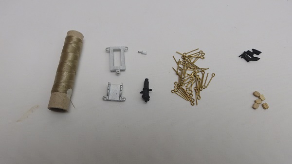

U S S Constitution Pack 10- Stages 91-100

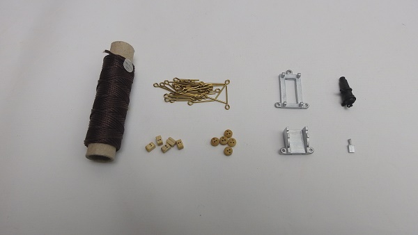

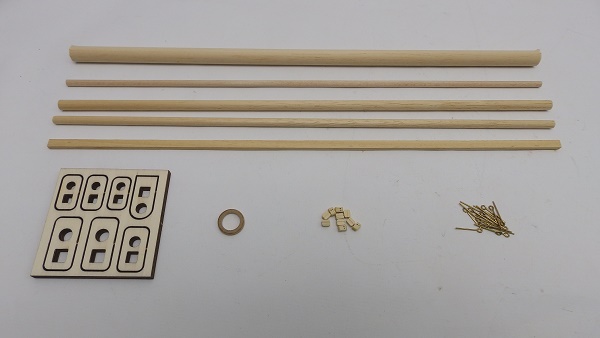

Stage 91 contents:-Carronade parts x 2, thread, eyepins, blocks and pins.

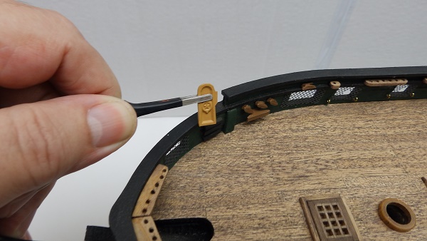

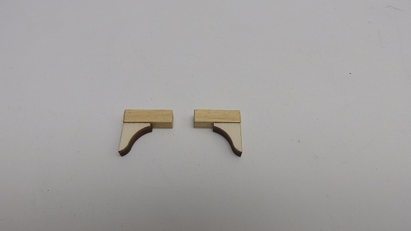

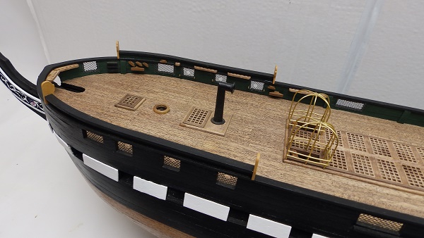

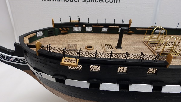

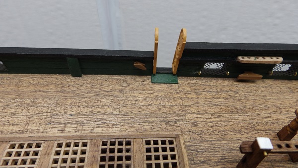

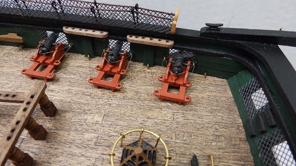

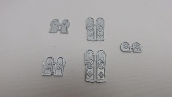

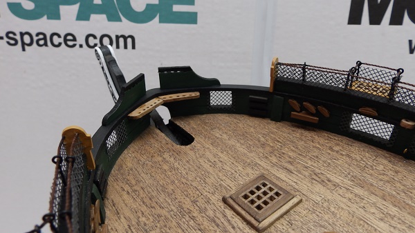

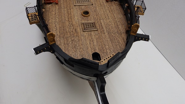

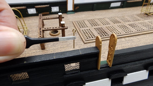

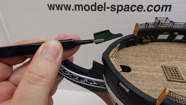

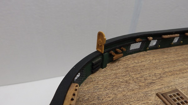

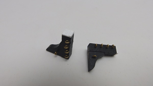

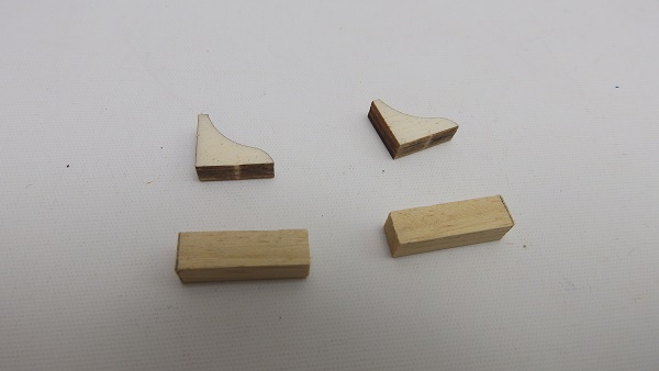

From stages 87,88 and 89 retrieve the bulwark end castings you should have a short pair two long pairs and four medium pairs, one medium pair has a bend. Keeping each set as a pair remove the casting burs and flash from all the parts then undercoat and finally paint all of them yellow ochre.
Take the four medium sets and add the straight pair to the bulwarks at the bow the second bent pair are added to the other end of the bow bulwark making sure the projections on the sides are pointing toward the deck. Next take the four long bulwark ends and glue each pair into the entry ports then add the last two to the stern gunwale making sure both are aligned with each other.

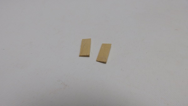

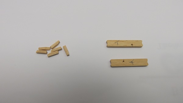

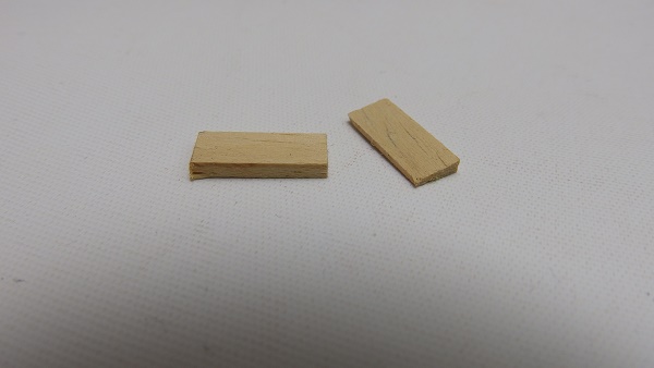

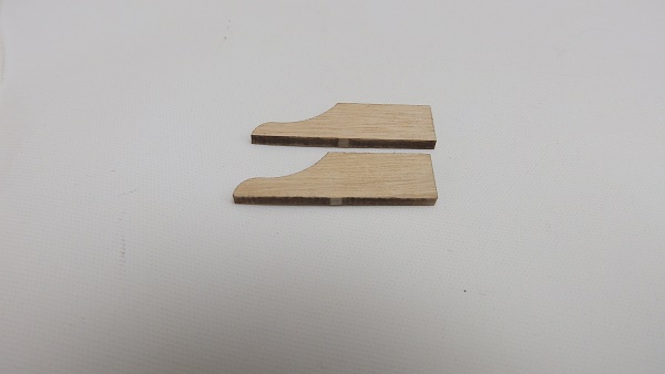

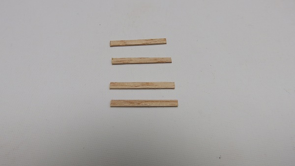

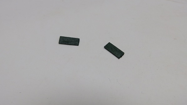

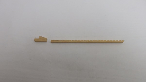

Take a 2 x 6 x 300 ramin strip and cut two pieces from it each 15mm long. Shape both parts into a wedge shape and then paint them with the same green you used on the inner bulwarks. Glue each wedge against the bulwarks below the the entry port.

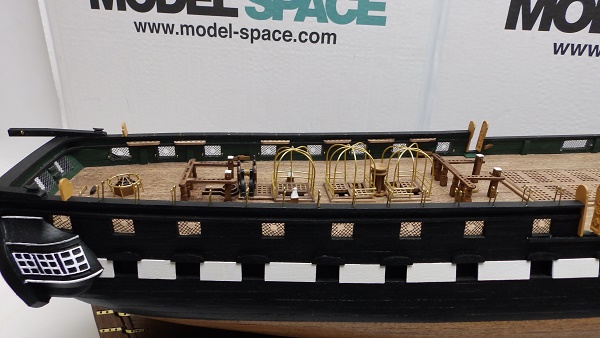

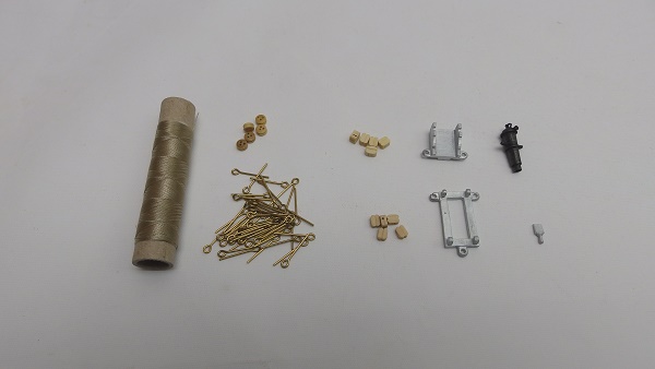

#2 Posted : 18 June 2018 12:27:00

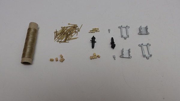

Stage 92
Stage 92 contents:- Carronade parts, thread, eyepins, blocks and cleats.

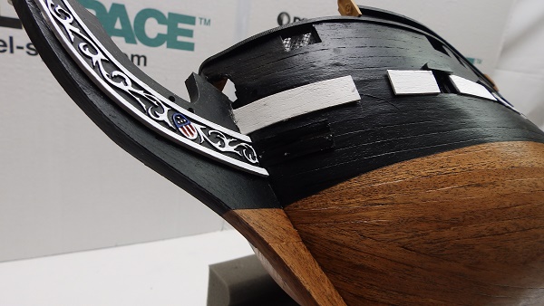

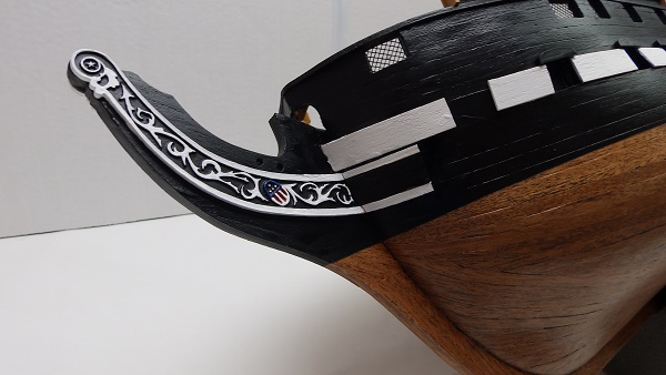

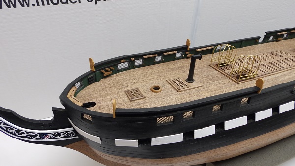

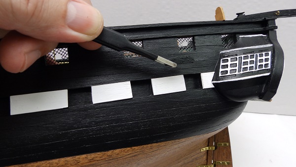

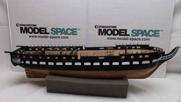

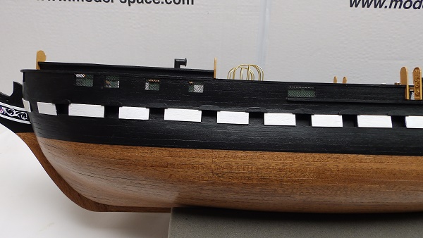

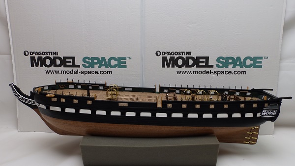

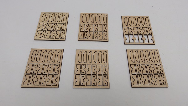

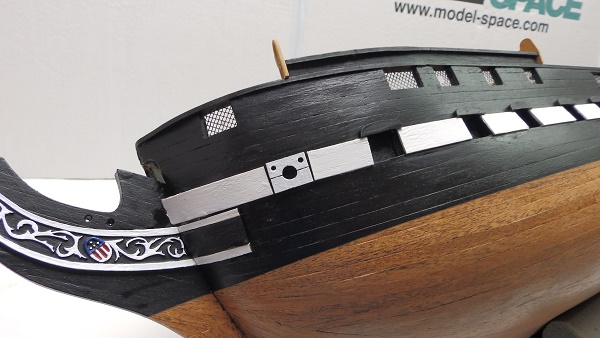

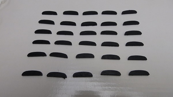

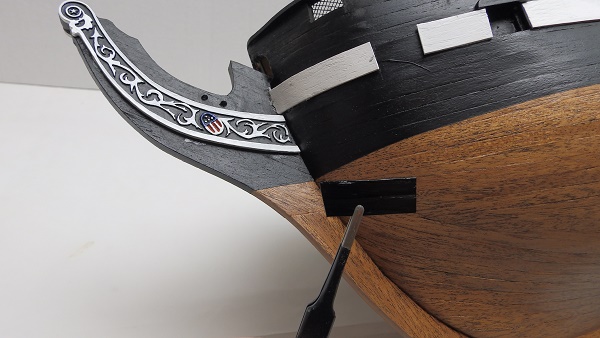

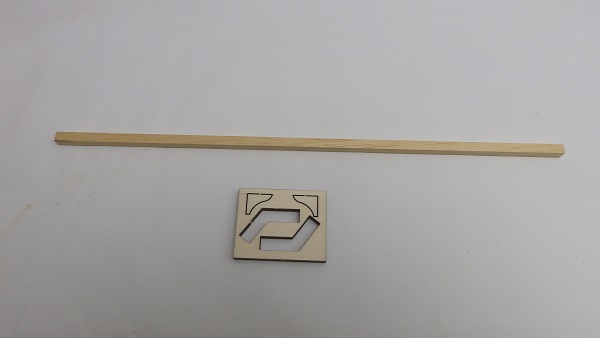

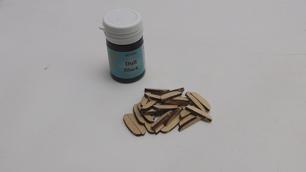

Take the six gun port frets you have saved and remove 30 of the crescent shaped pieces. Sand them all smooth then paint them black. When they are dry start gluing each one above a gun port, starting at the stern and working your way forward attaching 15 per side.

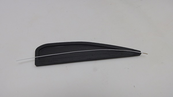

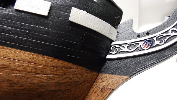

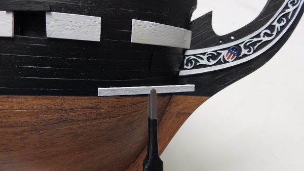

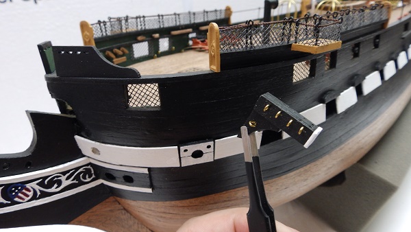

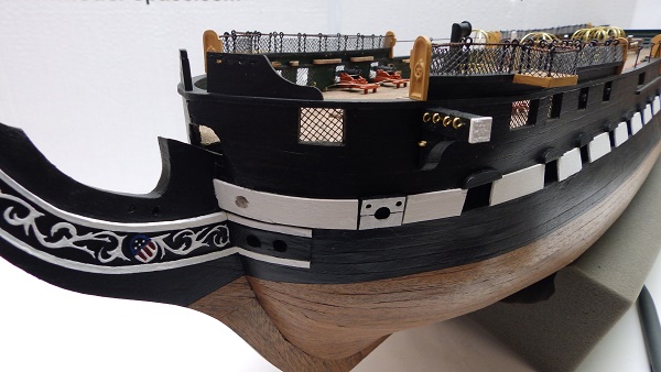

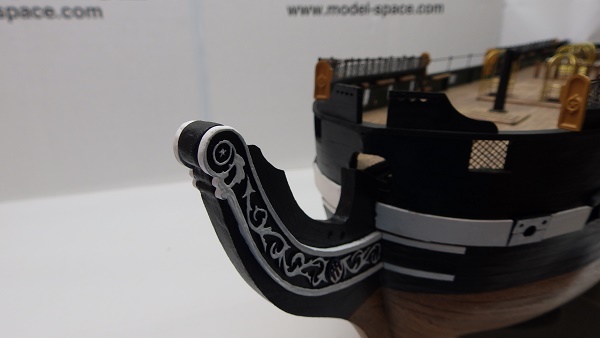

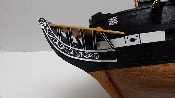

Next cut two 28mm lengths from a 1 x 11 x 300mm ramin strip. Test fit it so its in line with the stem decoration and the the upper white whale when you are happy with the fit paint them black and glue both parts in position on the bow. Now cut four 28mm lengths of 1 x 3 x 300mm ramin sand the pieces and paint them white. Glue each strip to the top and bottom of the strip you just fixed in position making sure everything lines up.
Remove two sets of gun port lids from a fret, sand them then paint them black. When dry paint the outer of each white and then glue them in the closed position in the gap of the white wale at the bow.
Stage complete.
Store any unused parts in a labelled bag for future use .

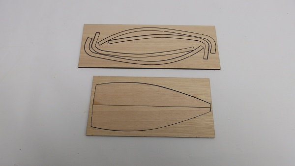

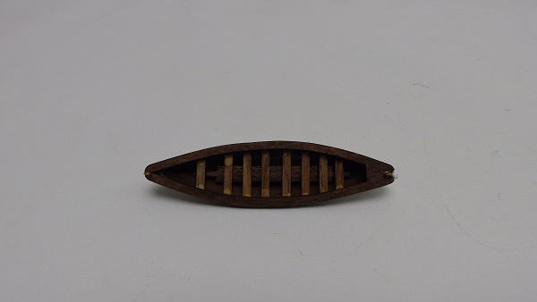

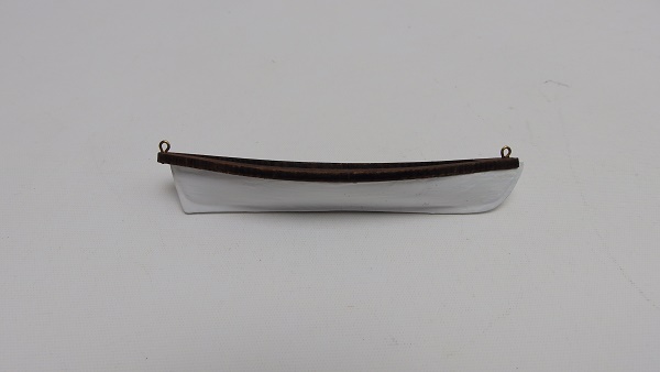

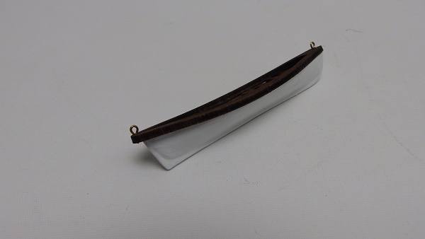

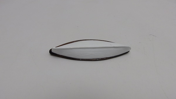

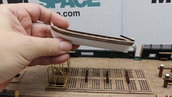

From stage 78 take the gig parts,paint the hull outside white then the inside brown. Next assemble the wooden parts of the gig in the same way you made the other boats in stages 58 and 60 of pack 6.
Stage complete.

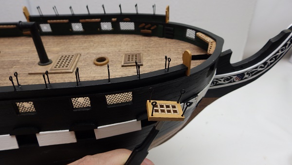

#4 Posted : 19 June 2018 17:33:18
Stage 94
Stage 94 contents:- Carronade parts, eyepins, blocks, deadeyes and thread.

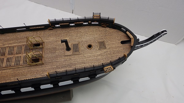

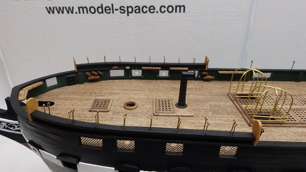

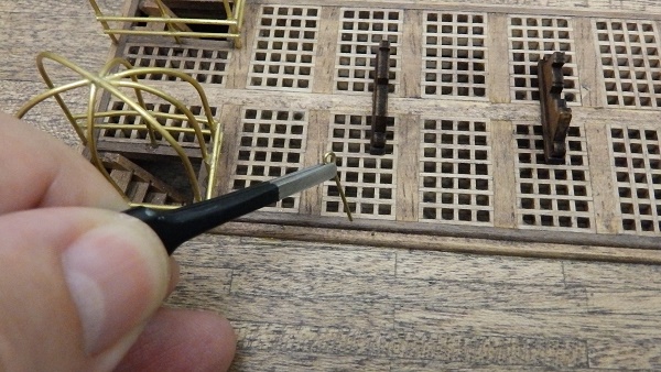

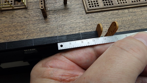

At the stern of the ship between the the bulwark ends drill 14 pairs of holes with a 0.75 drill bit the holes closest to the bulwark ends should both be placed 15mm away the other holes should be drilled 20mm apart. Paint 28 eyepins black and then fit them to the holes you just drilled making sure the eyes are in line with the bulwark ends. Now repeat the above on the other side of the ship.
Next at midships drill 4 holes in a central line and spaced evenly apart along the bulwarks on either side of the ship. Paint 8 eyepins black and then glue them into the holes just drilled.
At the bow gunwale drill 8 pairs of holes on either side of the ship. The holes closest to each of the bulwark ends should be 15mm away and the others 20mm apart. Paint 34 eyepins black and fit them in the same way you placed the stern eyepins.

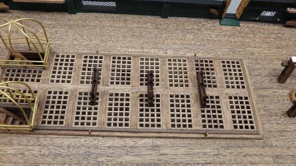

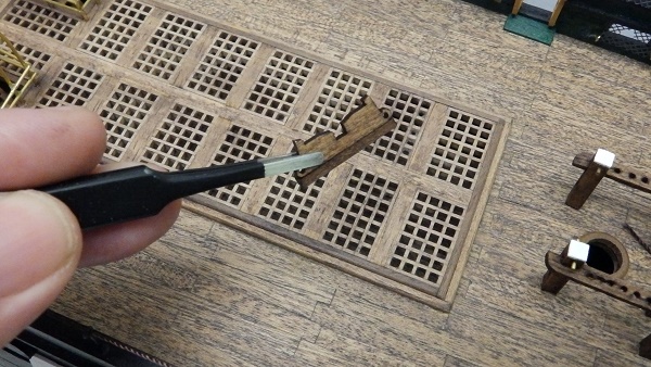

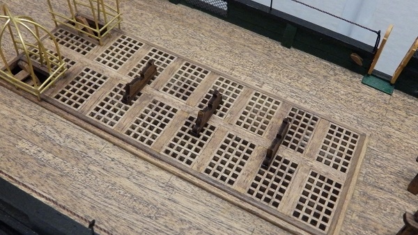

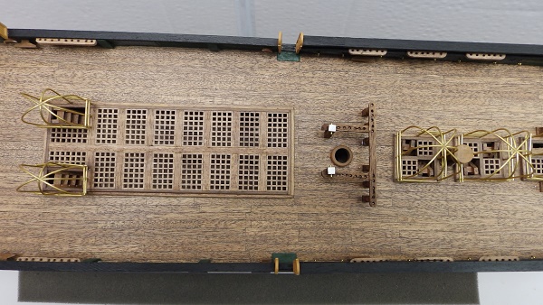

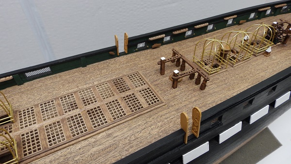

Take a grating that's already been made up or make one up and cut two sections 2 x 4 each then cut eight lengths of 2 x 3 x 300mm strip to frame the gratings. Paint the strips yellow ochre and fit them to the gratings. Next drill four holes in each frame with a 0.75 bit then paint 8 eyepins black and fit them to the gratings. Then glue the two finished gratings between the second and third row of gunwale eyepins at the bow.
Stage complete.

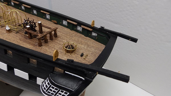

#5 Posted : 20 June 2018 17:05:18
Stage 95
Stage 95 contents:- Bowsprit parts, mast caps, yards, jibboom, eyepins, blocks and bowsprit plan.

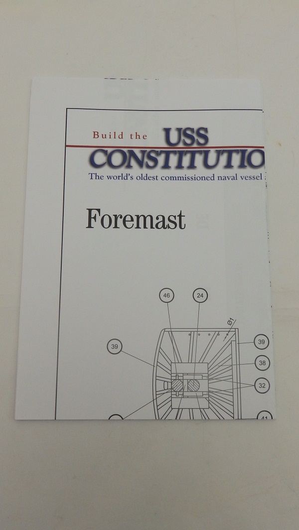

Important Notice
From this stage forward, the numbers in the parts photos in the Stage PDF's refer to those listed on the supplied plans from Stages 95, 97, 101, 105. The diagrams will also be referred to in the steps. All details for parts needed are also listed on the plans.

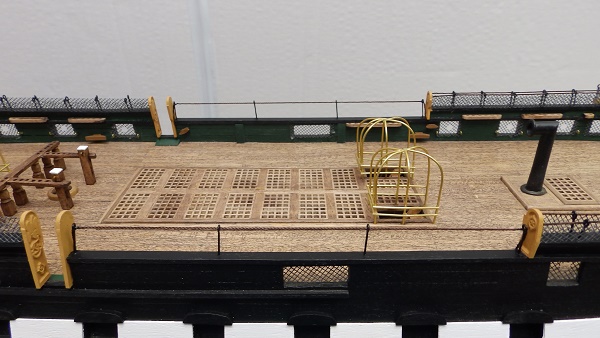

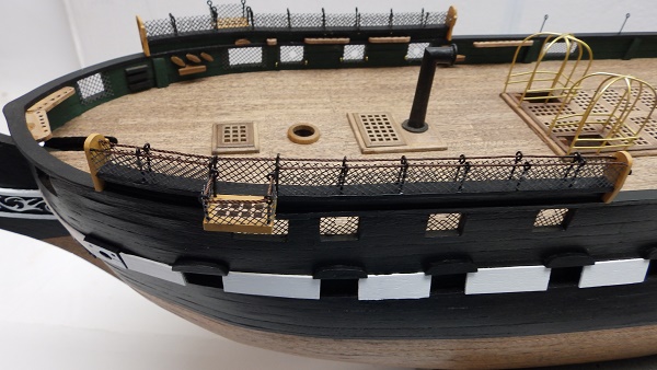

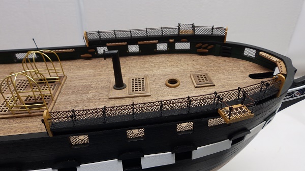

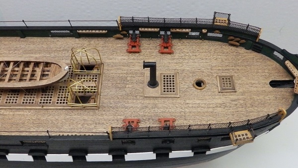

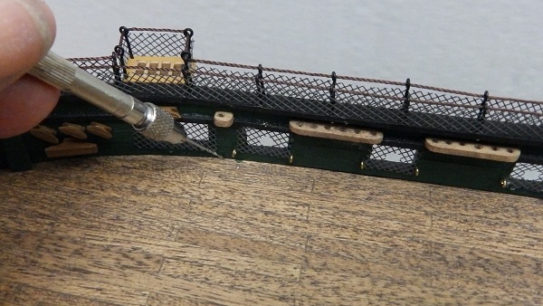

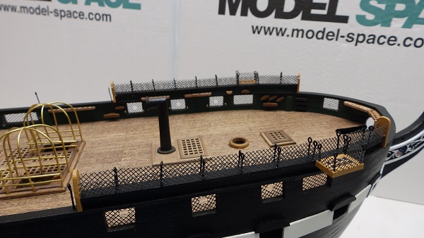

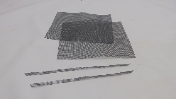

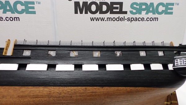

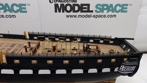

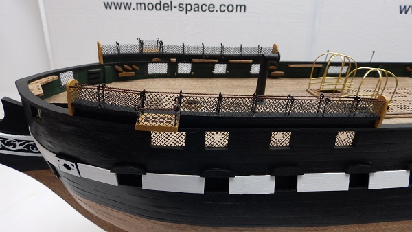

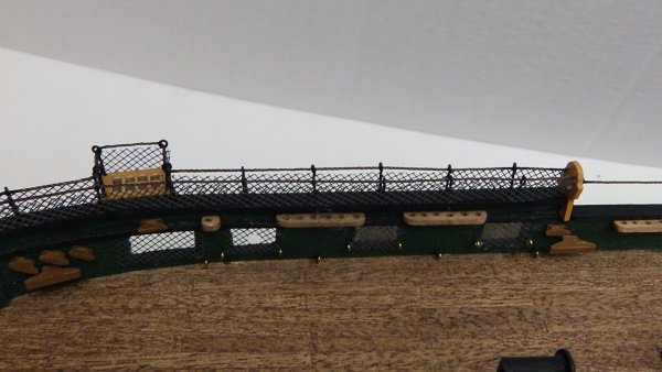

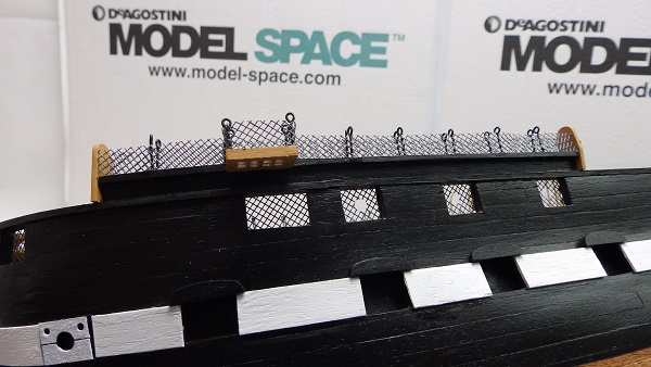

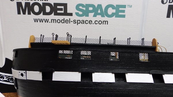

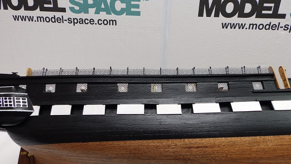

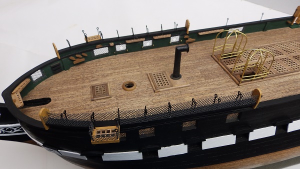

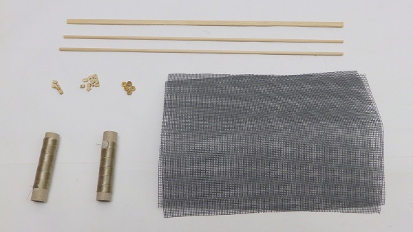

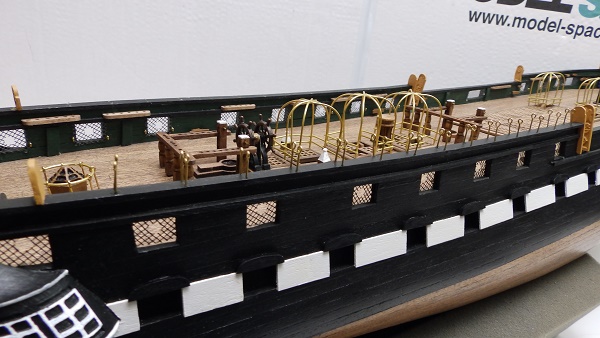

Take the netting previously supplied and cut strips 7mm wide. Measure the front and rear bulwarks to obtain the lengths needed. Note for the stern nets you will need to cut four pieces per ships side. Starting at the bow glue the netting to the bulwark ends and the pins in between. The insides will take a single strip and the outers will be made of three parts one around the platform, one forward and one aft of the platform. Repeat the above on the other side of the ship.

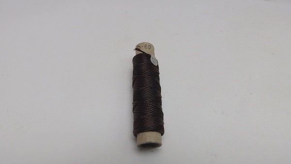

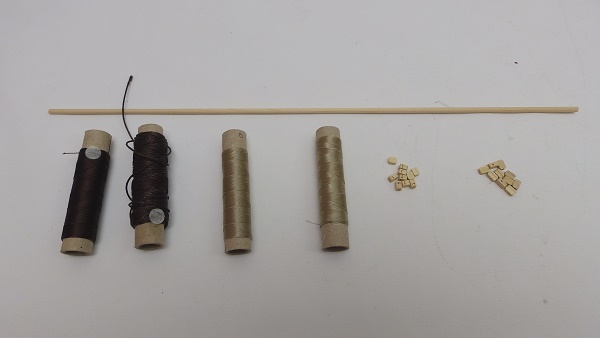

Cut more lengths of net 7mm wide and fit it to both sides of the stern bulwarks in the same way you fitted the bow nets. Next take some 0.80 brown thread and pass four lengths through the eyepins at the bow bulwarks gluing the ends to the bulwark ends. Repeat this for the stern nets.
Now cut two more lengths of brown thread to go through the four midships eyepins gluing the thread ends to the inner bulwarks.

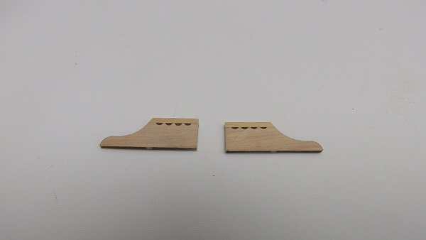

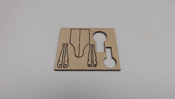

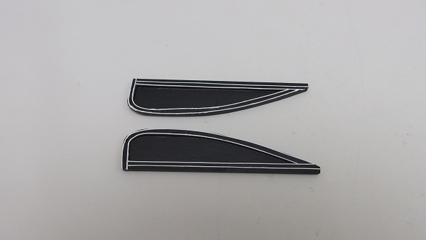

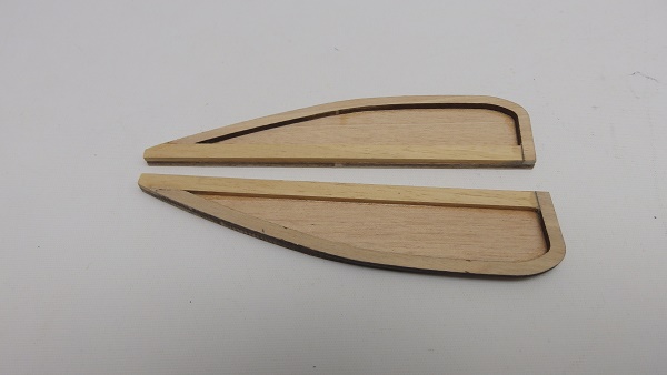

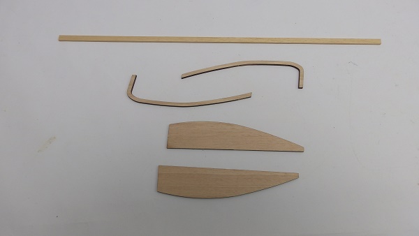

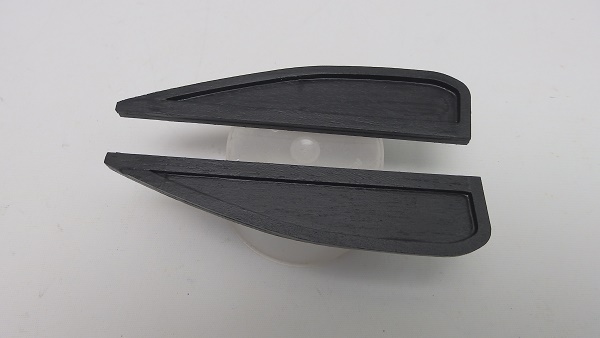

From Stage 74 remove the two bow parts from the fret and sand them smooth then file four grooves along the top of each part then add a piece of 2 x 2 x 300 strip along the top edge. Shape the strip to fit then paint the insides with the green you have used on the inner bulwarks and the outsides black. Glue both parts when dry to the bow gunwale with the ends half way across the forward port.
Stage complete.

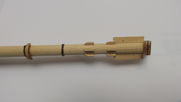

#6 Posted : 21 June 2018 14:41:22
Stage 96
Stage 96 contents:- Strapping, bracing line, netting, blocks, deadeyes, bees, jibboom, martingales and studdingsail booms.

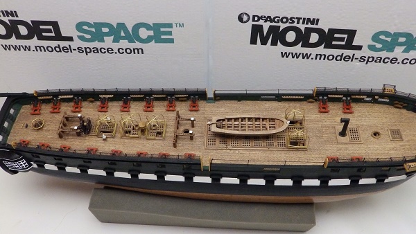

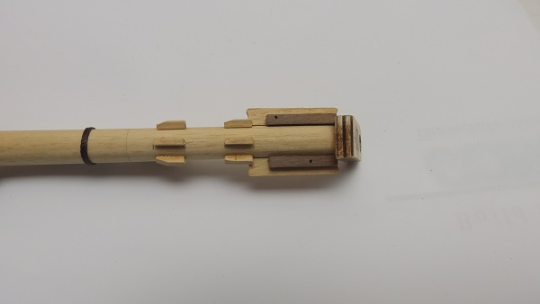

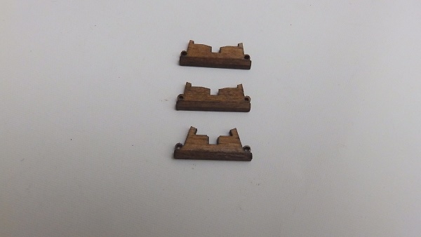

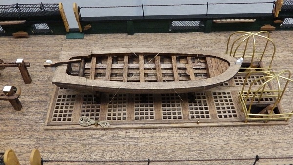

Take the fret from Stage 68 and remove the three chocks and sand them smooth. Next cut three pieces of 2 x 3 x 300 strip to fit along the bottom of the chocks, glue the strips in place then stain the parts. Glue the three finished chocks along the centre of the midships grating. With a 0.75 bit drill four holes in the grating frame in line with the two end chocks. Glue an eyepin into each hole.
Retrieve the launch and place it onto the chocks then using thread tie the launch in place using the eyepins to retain the thread.

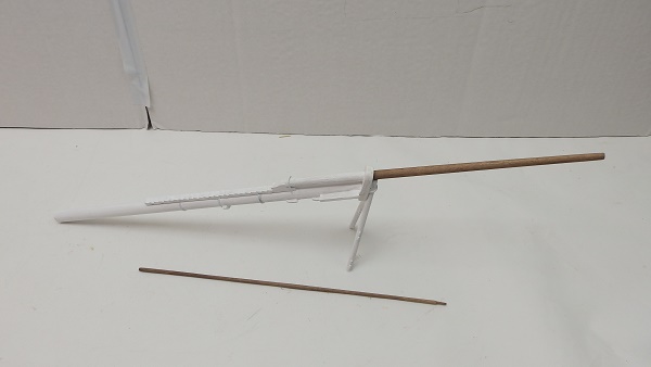

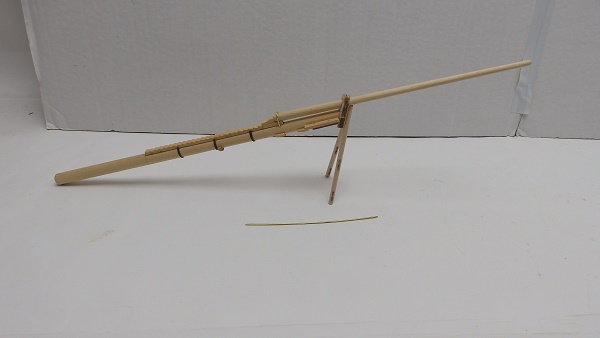

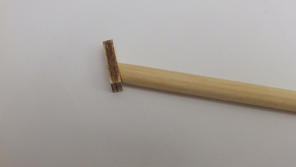

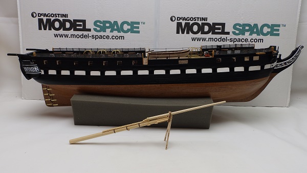

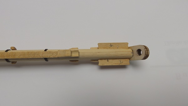

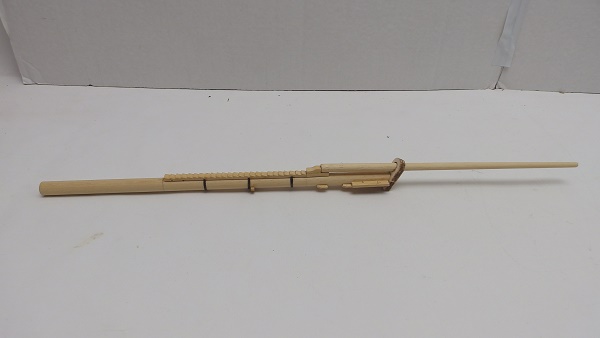

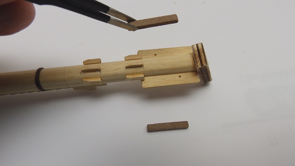

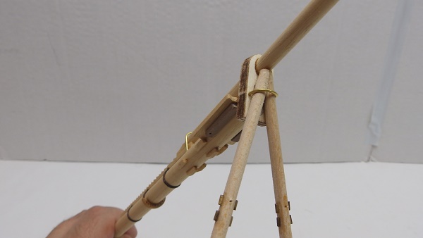

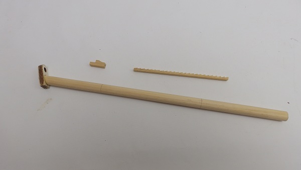

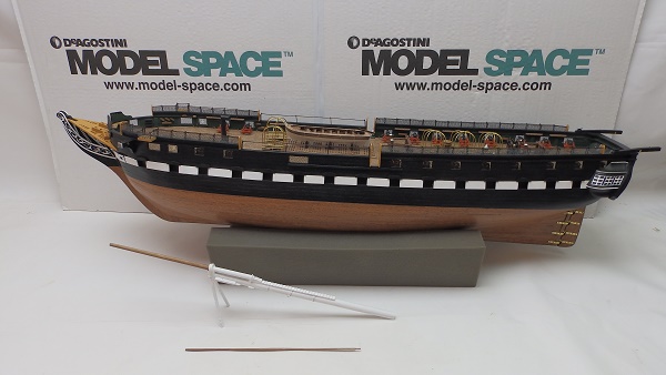

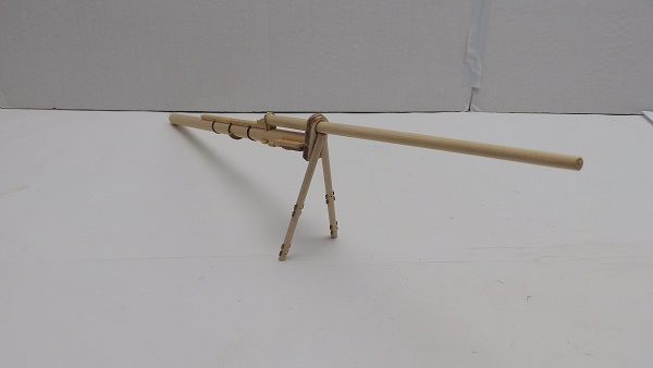

Open the bowsprit plans and lay the bowsprit over them and mark the angle where the cap will fit and then cut it to length. Shape the upper end of the bowsprit so there is a square block that will fit into the cap. Next taper the bowsprit so its 10mm at the base and 9mm at the angled end then glue the cap in place.
Stage complete.

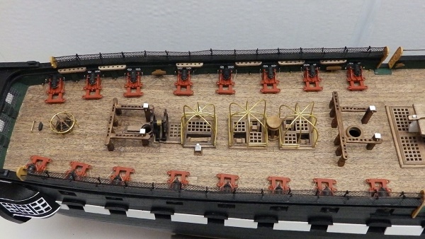

Using a 0.75 drill drill holes in the bulwarks at the midpoint between the gun ports then insert shortened eyepins into each hole do this on both sides of the bulwarks. Next make up three carronades so you have twenty in all. Cut enough 150mm lengths of 0.15 thread to service all the carronades then fit them to the gun ports starting at the stern and working forward. You should have 10 carronades on either side of the ship with a single gun port on both sides free at the bow.

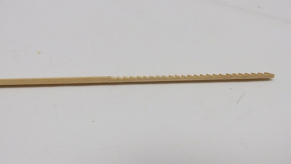

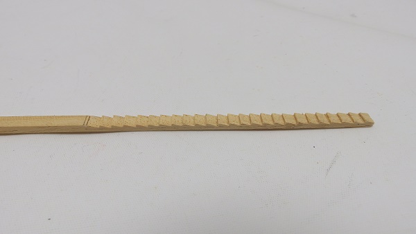

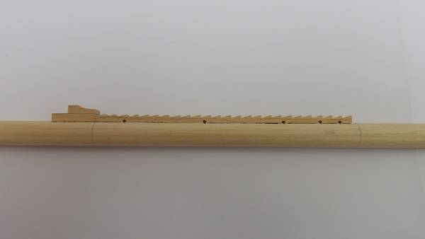

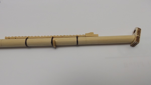

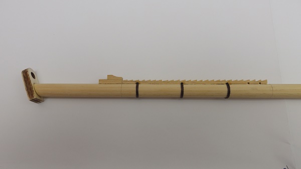

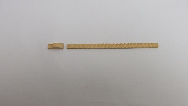

Next take the 3 x 5 x 300 ramin strip from Stage 95 and using the bowsprit plan mark on the strip the length and the position of the steps. Proceed to cut the steps along the strip using the plan as a guide then when it is finished glue it in position on the bowsprit. Using the same strip of ramin make up the knee and again using the bowsprit plan cut and shape it to size and then glue it in position.
Next using the plan mark the 5 holes below the steps on the bowsprit and then use a 1.5mm bit to drill each hole. Smooth the steps and then use 0.80mm brown thread to create the bindings on the forward three holes.

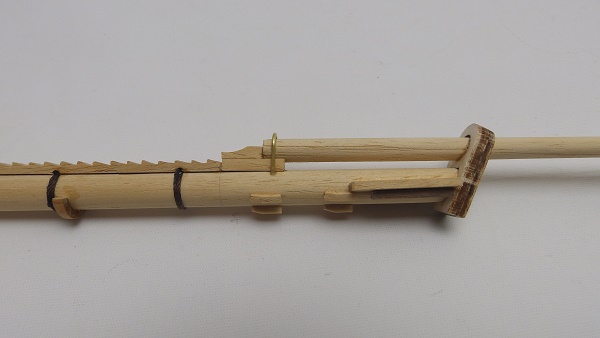

#8 Posted : 24 June 2018 17:51:26
Stage 98
Stage 98 contents:- Foremast yard parts, Wire, crosstrees, deadeyes and blocks.

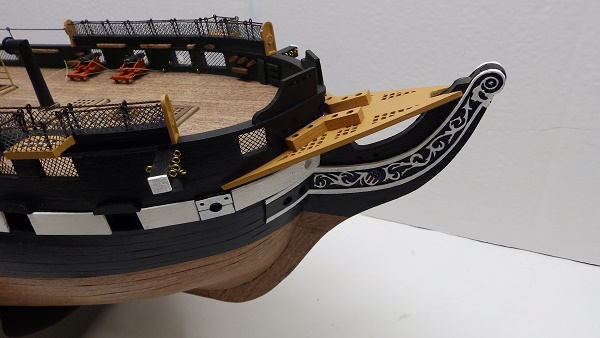

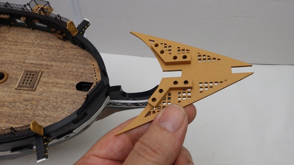

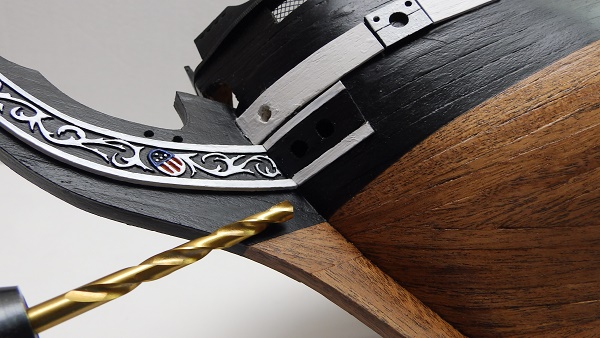

With a 5mm bit drill two holes one centrally in the white bow ribbon 10mm away from the stem and then drill one directly below it centrally in the black ribbon. Measure 10mm across from the lower hole just drilled to make three holes at the bow. Repeat the above on the other side of the bow.
Next take the frets saved from Stages 62 and 69 remove the parts and sand them smooth. Assemble the rails to the bulwarks making a left and right hand and then add a strip across the top using lengths of 2 x 5 x 300 strip. Paint all the assembled parts black and store then until there needed.

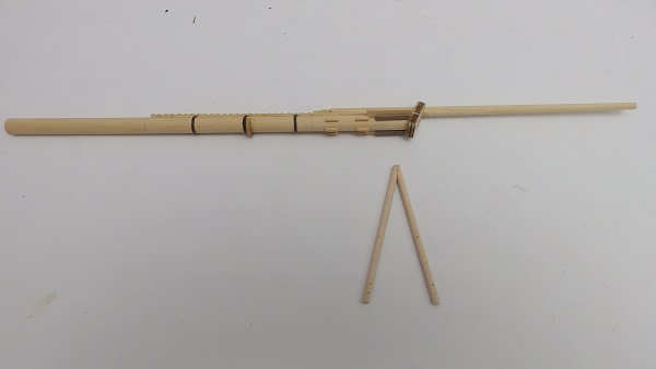

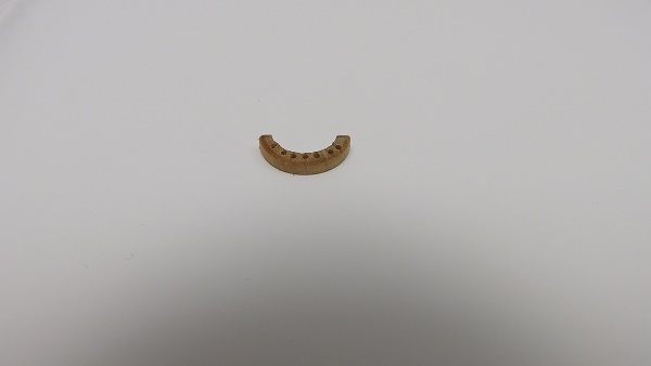

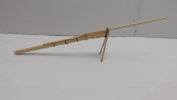

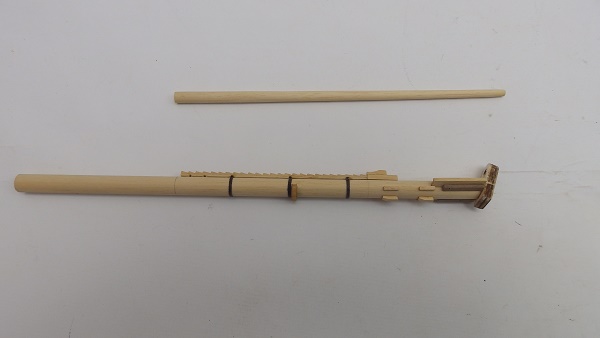

Take the fairlead from Stage 95 and cut it in half then using the bowsprit plan mark off the positions of the seven holes and then drill all seven using a 1mm bit. Glue the prepared fairlead to the bowsprit. Next cut six lengths of 2 x 2 mm strip and make the cleats then make up the bee blocks and bee's. Mark there positions and glue all the assembled parts in place on the bowsprit.

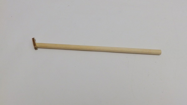

Next use the 6mm ramin dowel the make the jib boom, using the bowsprit plan cut and shape the boom until they both match. You will next need to shape the upper hole in the bit to the correct angle so the jib boom can pass through it. When everything fits glue the jib boom to the bowsprit assembly. Now cut and shape the martingales to match the plan and glue them together at the top.
Stage complete.

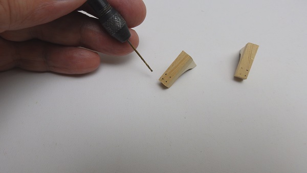

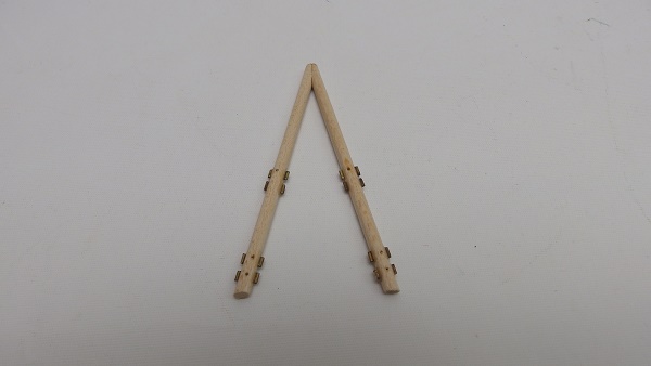

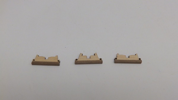

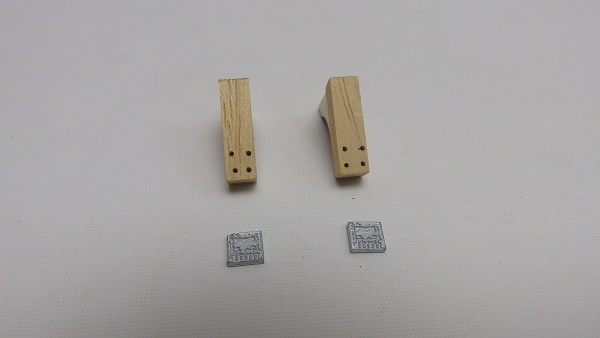

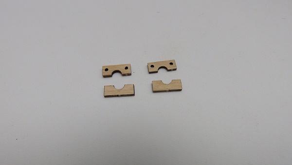

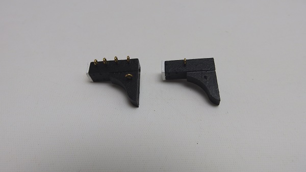

From Stage 65 take the fret and remove the two knees then cut two 20mm long pieces from a 6 x 6 x 300 strip. Glue these to the knees to make the catheads then with a 1mm bit drill four evenly spaced holes in the ends of the catheads and paint them black. Next drill four holes in the front face of the cathead and one below in the knee then glue 5 eyepins in place then add one more eyepin to the rear facing cathead side.
From Stage 69 clean up the ornaments and paint them white. When dry glue them to the cathead ends. Glue the catheads just below the bulwark rail and just behind the forward bulwark ends.

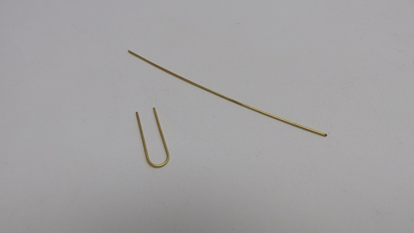

Take the Martingales assembled in the last stage and using the plan mark and drill the six holes then cut sixteen 4mm long pieces of 1mm brass rod and glue them in the indicated positions on the martingales as per the plans.
Next take some 1mm brass rod and make a boom iron to fit over the jib boom, when it is shaped correctly glue it in possition. Centre the martingale on the front face of the bowsprit cap and glue it in place then form a strap from 1mm brass rod and glue it over the martingale to hold it in position.

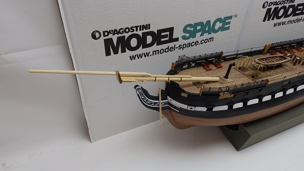

#10 Posted : 27 June 2018 16:48:09
Stage 100
Stage 100 contents:- Main studdingsail booms, thread and blocks.

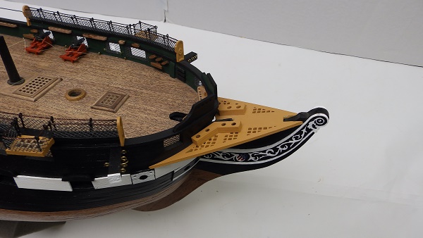

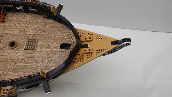

Take the beakhead assembly from Stage 77 and test fit it in place with the bow bulwarks from Stage 98, adjust the fit and glue the beakhead in place. Start to cut the struts under the beakhead to size and then paint them black. Next take the 0.5mm wire and cut it to length and then paint the wire white. When the paint is dry cut the wire to length and add a wire to each side of the strut then glue them in place. Do this for both sides of the beakhead.
Take the side bulwarks from Stage 98 then cut more 0.5mm wire to size and paint it white when the paint is dry glue the wire to the bulwarks, repeat the above for the other bulwark.

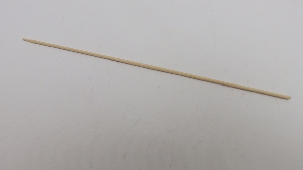

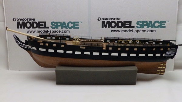

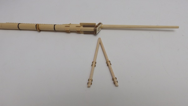

Using the bowsprit plan cut the flying jibboom to size and then shape it as indicated on the plan making sure you place the step at its front end. Next stain the flying jibboom and the jibboom forward of the cap with stain and allow to dry. Then paint the rest of the bowsprit white.
