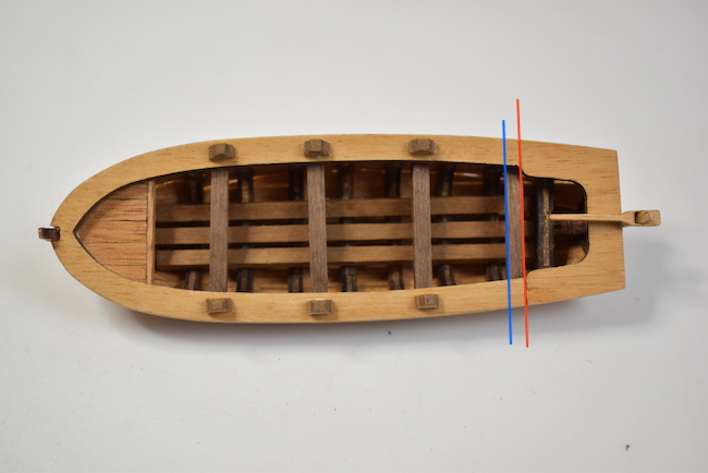

Thanks guys. Here's a pic. Excuse the state of it, I've been pulling it about a bit so it needs some finishing lol. Anyway, the gap is actually 5mm. I've placed the stern gunwale level with the stern. I'm using the smaller gunwale and have definitely built the smaller launch, but you can see that anyway.i can see from this pic that the gunwale doesn’t seem to extend as far as the ones in the official build.
Thanks for your help BigGrin
#5 Posted : 20 June 2018 20:03:00
Hiya Rob,
Looking at it, it looks like the front section of the whale is to far forward. On my picture below, the blue line is where yous is the red where mine is.. The rear section is spot on as it stops in the same position as mine.
Can you do a side on view of the whole of the launch and one from above again but showing all of the launch.

Cheers Chris. Unfortunately mate I jumped the gun and removed the gunwhale as I wanted to get it off before it set too hard. Bloody thing broke getting it off so is now beggared. I can try to repair it or just get another one from Modelspace. Looking at your picture, I think it was too far forward.

The size of the whale from the front notch to the rear is 81mm.
#8 Posted : 21 June 2018 07:37:34
Hi Rob,
The small launch gunwhale is 85mm long from the tip (83mm from notch) and the large is 100mm long (98mm from notch). I can't understand why your was 81mm.
You need to test fit, check and check again before glueing, that way you don't need to pull it apart if incorrect. Hopefully you get it sorted soon.
