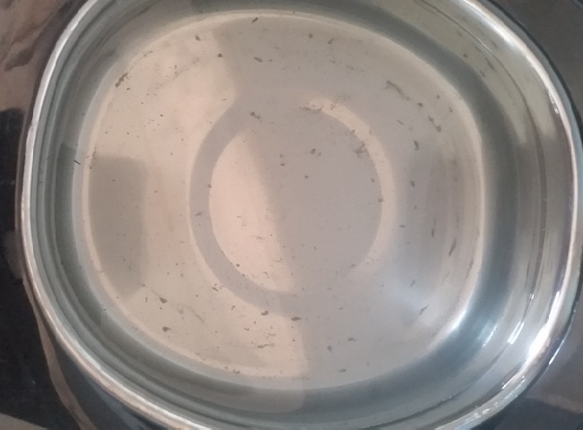

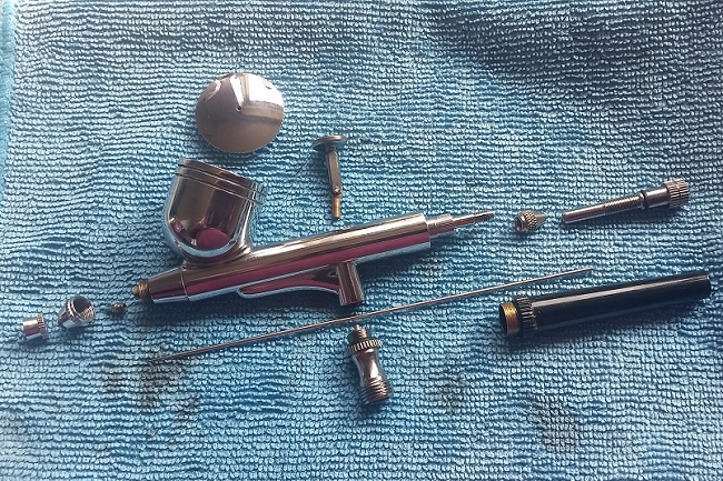

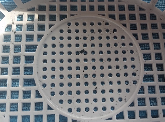

Below I have attached three pictures:
First, I removed the inner tray of the ultrasonic cleaner and this is the residue left on it.
Second, with everything removed from the ultrasonic cleaner the residue is amazing. The inside surface of the ultrasonic cleaner is in as new condition so every black mark is residue from my airbrush. Add that to what was left on the internal tray and you can see what has "NOT" been cleaned out before.
Third, my airbrush now really clean prior to reassembly.

Be careful using an ultrasonic cleaner on your airbrush for too long.
The more expensive airbrushes have a PTFE seal and other rubber seals inside them that many novice airbrush users do not know are there.
Overlong ultrasonic cleaning will destroy those seals and some of that black stuff in the bottom of your bath could be a destroyed rubber ring.
Of course if you know where the hidden seals are and have the special tools needed to remove and replace them before and after immersion in an ultrasonic bath then ultrasound away to your hearts content.
