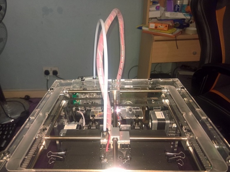

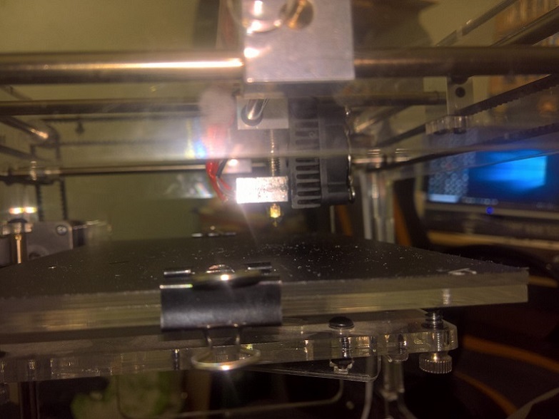

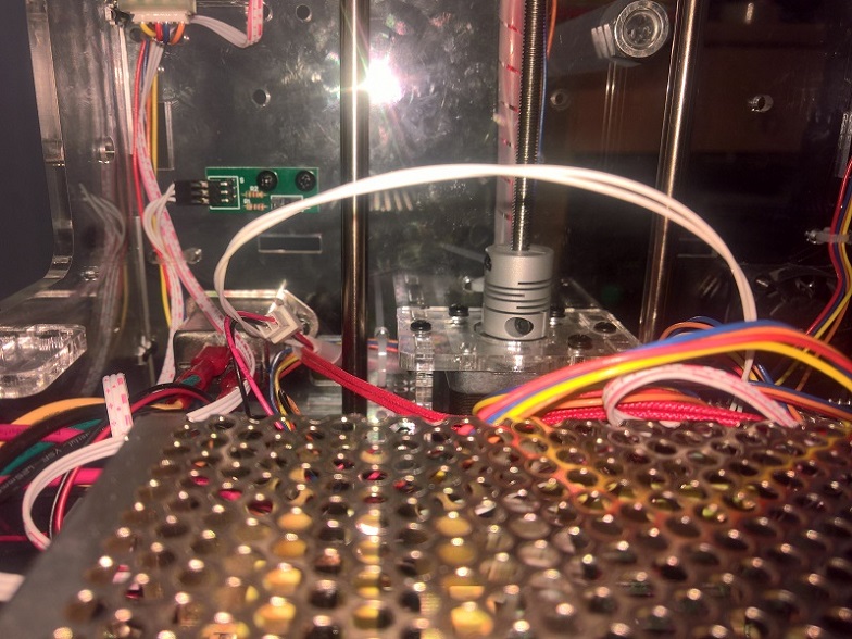

ncall1976 attached the following image(s):
#22 Posted : 08 May 2018 09:24:12
From your pictures I cant see anything obviously wrong with the build but as you have said you cant get the bed high enough to calibrate it to the nozzle then there is an assembly problem.
On Page 292 of the Pack 11 instruction book in the 'Hint' bubble it says:-
If you cannot get the distance between the table and the nozzle level across the table surface using the adjustment available from operating the knurled nuts, it may be that something went wrong during assembly. The most likely place is when you added the table to the housing in Stage 47. Go back and check that the procedure was undertaken correctly.
Could you recheck this part of the assembly and then recalibrate the table.

Bed now able to config, however one corner of bed is fully tightened by knurled nut, other three are almost tight.
Used business card to config but still not perfect.
big blobs of plastic throughout print and causing printer to stagger axis and not print in same area.
if I don't use the second bed, and use the pad on first layer, I can better config knurled nuts to accommodate print. Would that be ok??
#24 Posted : 16 May 2018 08:06:54
That should be fine on the table but I would also add a layer of tape to protect the lower table. You could try lowering the filament temp by 5 degrees to make it flow more slowly.
