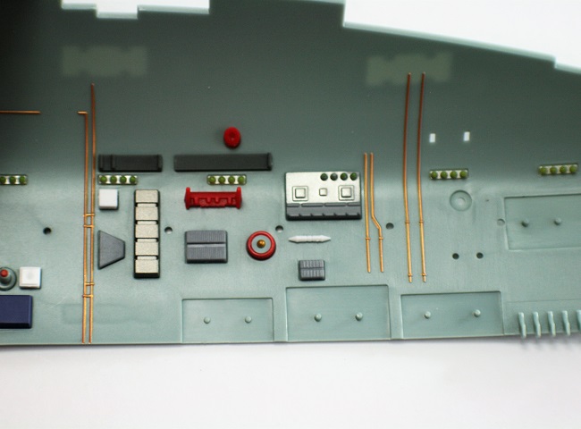

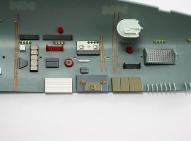

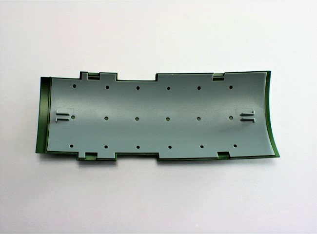

#1 Posted : 11 May 2018 06:43:04

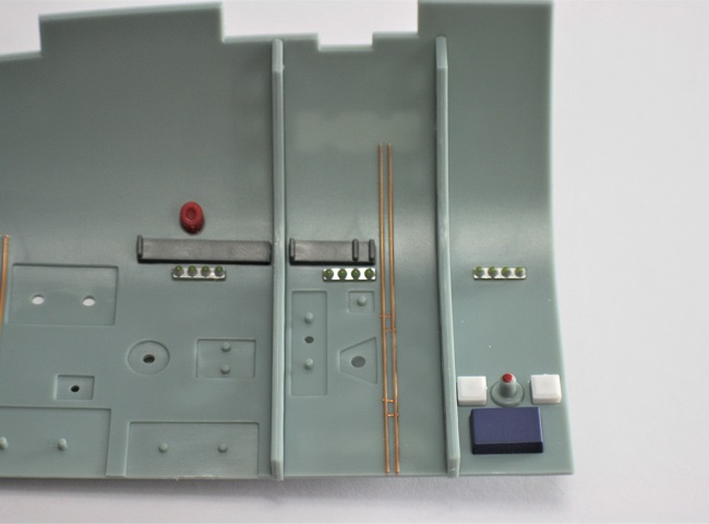

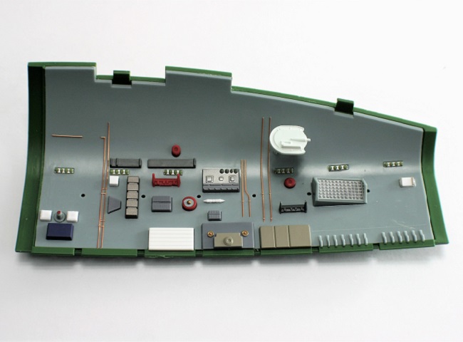

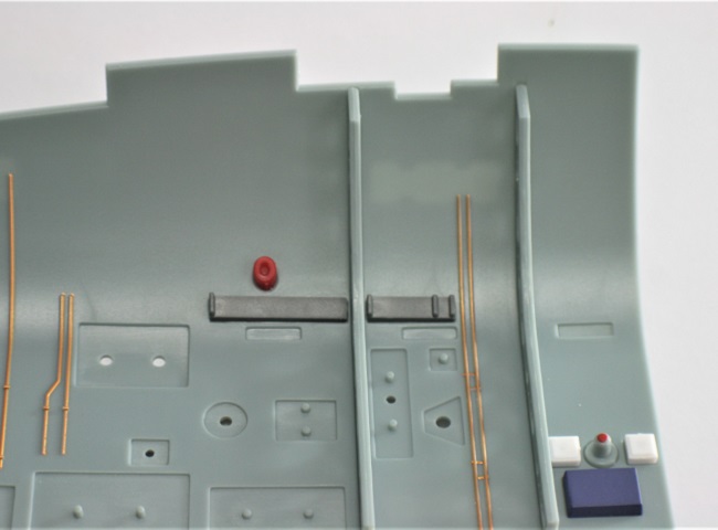

Stage 60
Thunderbird 2
Parts supplied:
Details 7 - 24
Using a little glue fix details 7, 9, 10, 19 and 13 to the right inner wall making sure that the parts are orientated correctly.
Follow on by fitting details 12, 11, 8 and 15.
Next fit details 16, 18, 14 and 17. Then fit detail 20 into detail 21 and fix the part in place making sure it is orientated correctly.
Finally fiit details 22, 23 and 24 along the bottom edge of the wall carefully checking the orientation as these parts will form the ledge to connect the bottom of the wall to the floor.

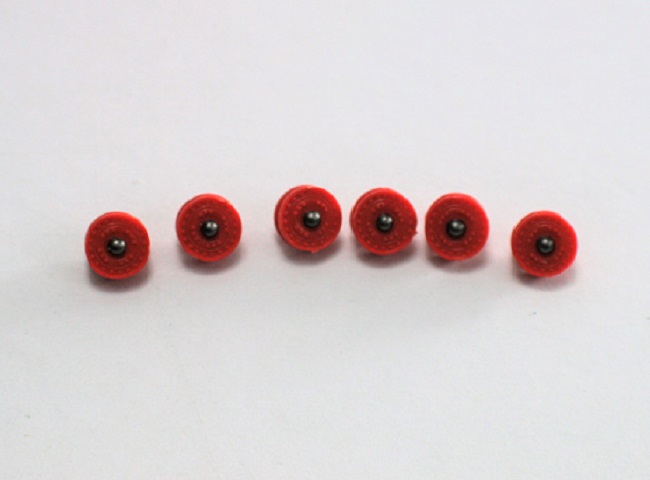

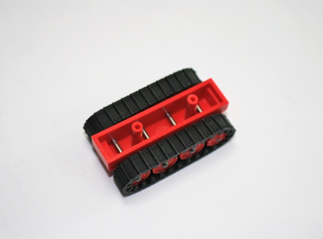

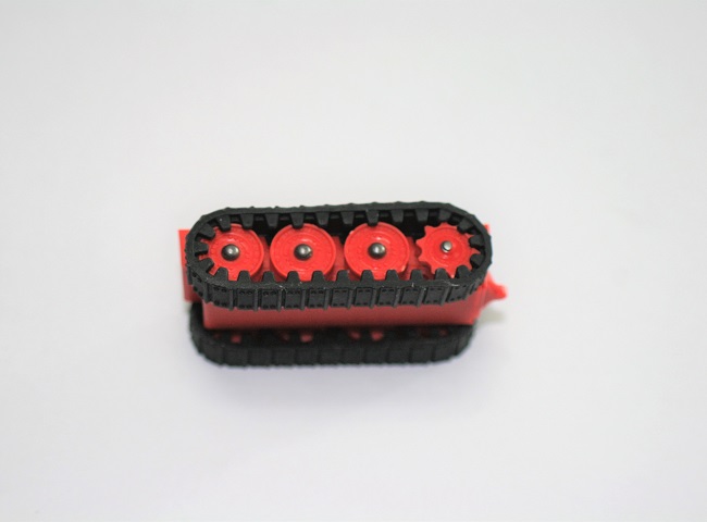

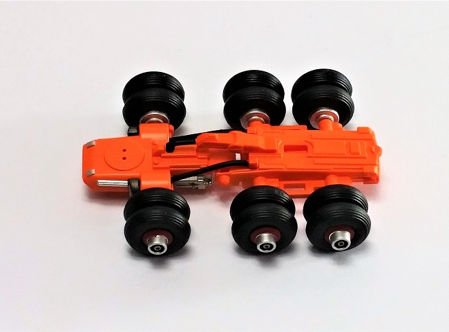

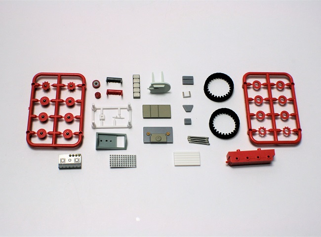

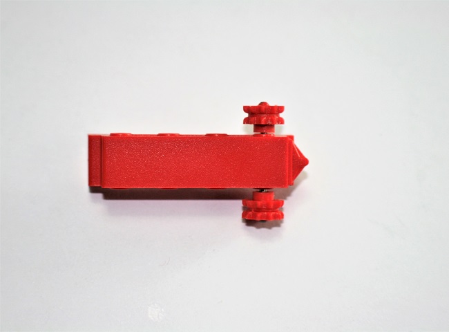

Fire Truck

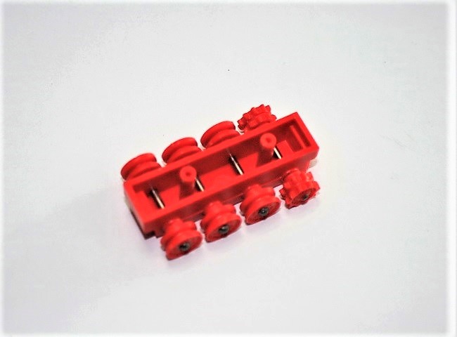

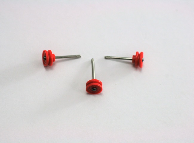

Parts supplied:
Main chassis, Wheels A (on a fret), Wheels B (on a fret), Axles x4, Tracks x2.

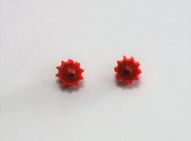

Join the drive wheels A and B as you have done previously to make two drive wheels and then repeat for the wheels A and B to complete six wheels.
Fit the first axle with a drive wheel set then feed the axle through the rear hole of the chassis and fit the second drive wheel. Now fit a wheel set to each of the remaining three axles and then fit them to the chassis and attach a wheel to each one.
Finally pull both sets of tracks over the wheels starting from the drive wheels and make sure that the tracks are fully engaged with all the wheels.

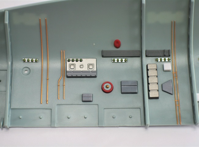

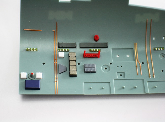

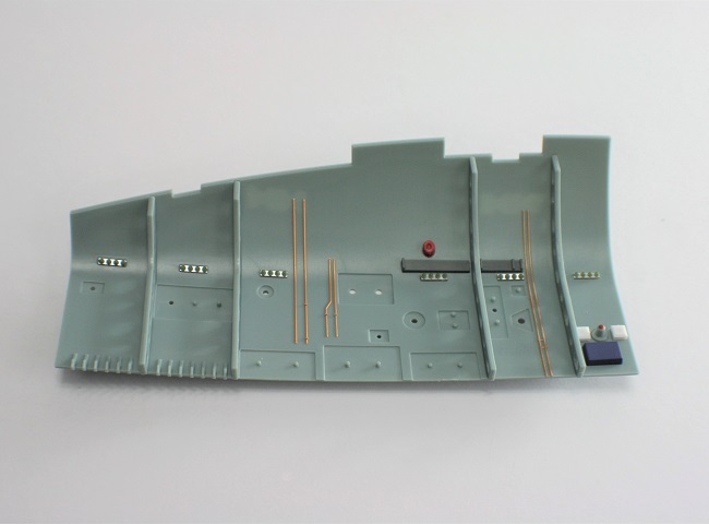

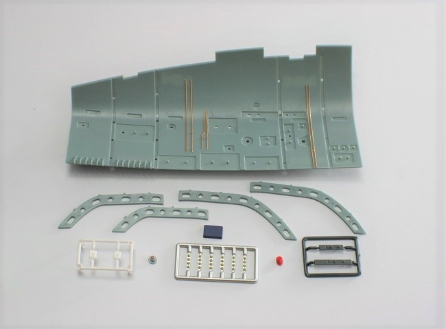

#2 Posted : 11 May 2018 06:50:09

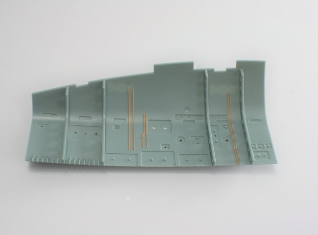

Stage 61
Thunderbird 2

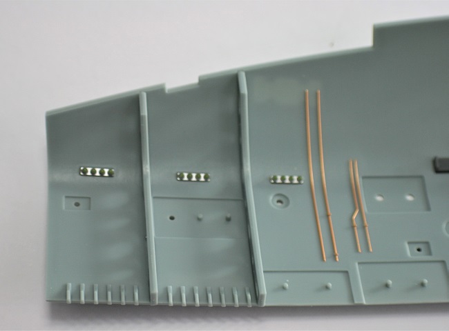

Parts supplied:

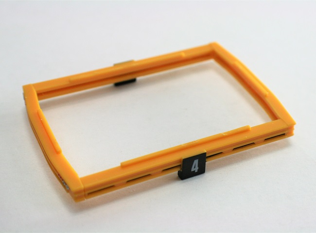

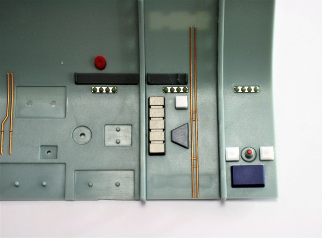

Left inner wall, Frames 1 - 4, Detail 1, Detail 2 x2 (on fret), Detail 3, Detail 4, Details 5 + 6 (on fret), Lights x6 (on fret)
Identify frame 1 and glue it into the slot at the front of the left inner wall making sure it is perpendicular to the wall as the glue dries and all the locating pins are fully engaged. Now repeat this procedure for frames 2 - 4 again making sure all frames are perpendicular to the wall and fully engaged.
Glue detail 1 in place with a detail 2 on either side and detail 3 below. Next glue detail 4 in place making sure that it is orientated to match the contour of the wall and then fix details 5+6 just below.
Finally separate the lights from the fret and fit three in position in the front of the wall and the final three to the rear.

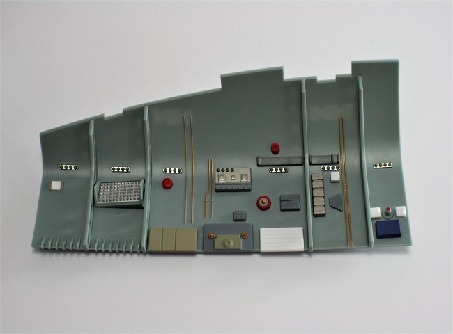

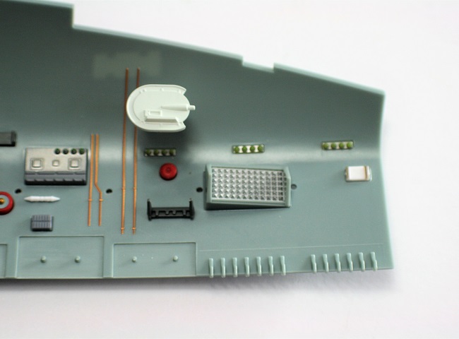

#3 Posted : 11 May 2018 06:57:56
Stage 62
Thunderbird 2
Parts supplied:
Details 7 - 20

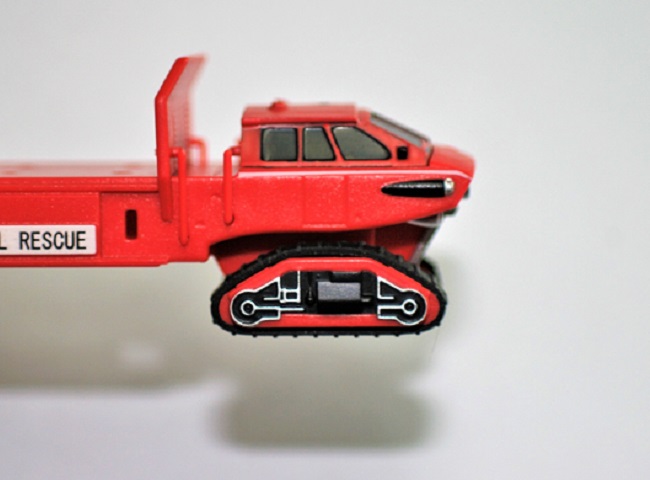

Glue details 7, 8 and 9 into position checking you have them orientated correctly. Follow on by fixing details 10, 11, 12 and 13 in place. Next fit detail 14 into detail 15 and fix the assembly along with details 16 and 17 to the wall. Finally fit detail 18, 19, and 20 with their stepped edges toward the bottom of the wall.

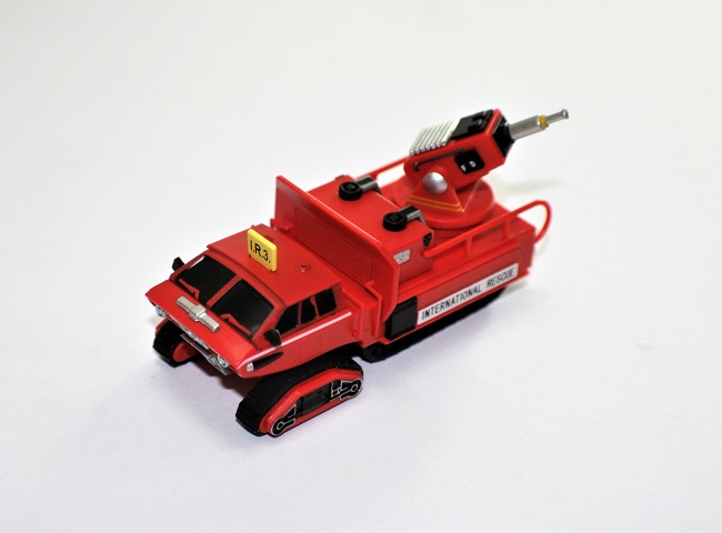

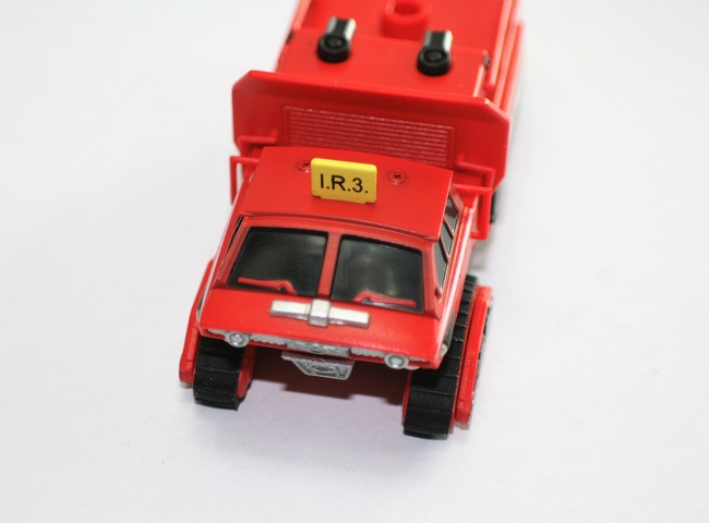

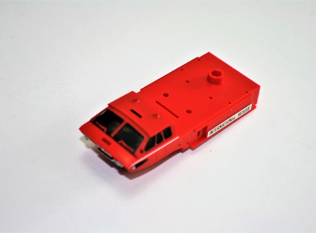

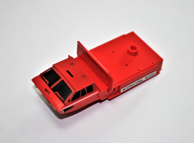

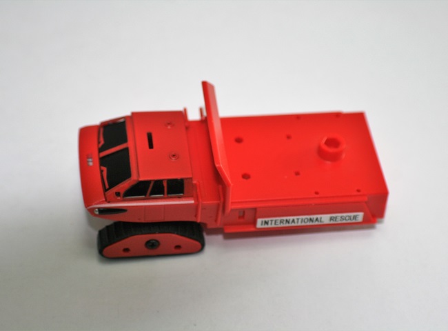

Fire Truck

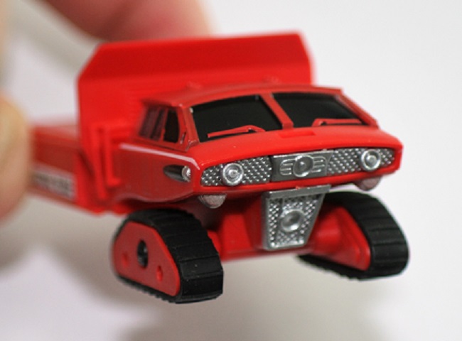

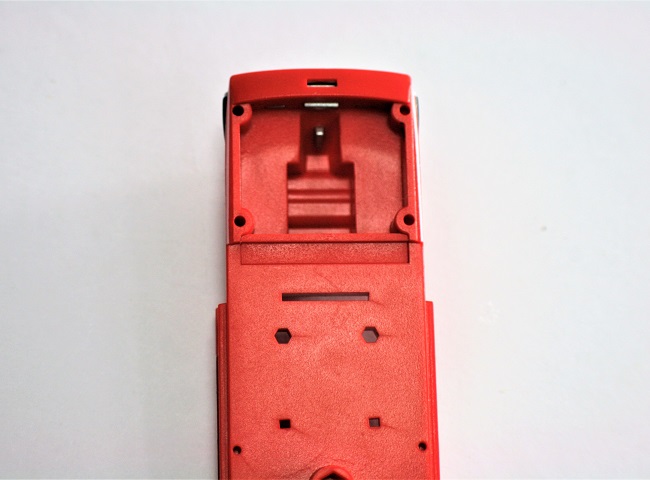

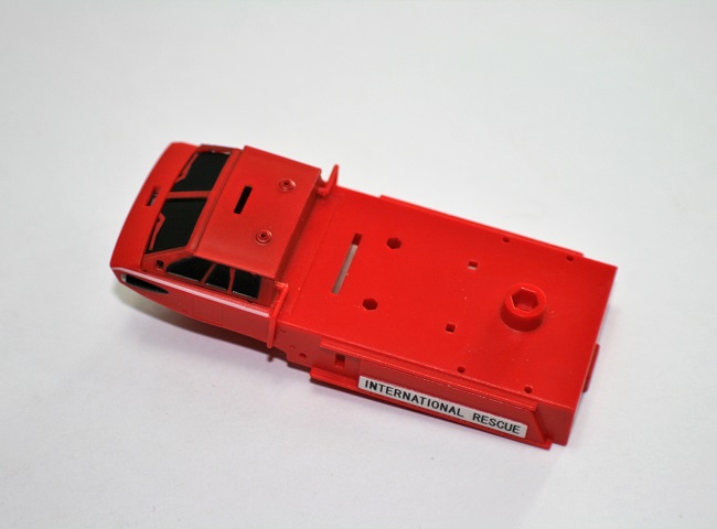

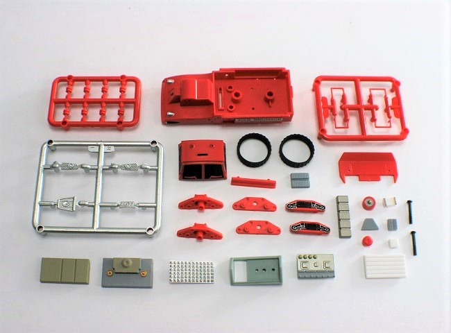

Parts supplied:

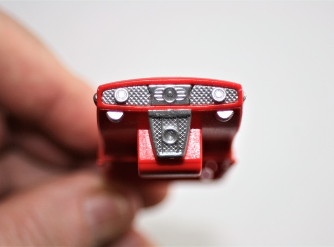

Cockpit, Cockpit rear panel, Bulkhead, Main body, Grille - Air intake - Headlights x2 (on a fret), Handrails x4 (on a fret), Front wheels x8 (on a fret), Front track covers L+R, Front tracks inner x2, Front tracks outer x2, Front tracks x2, Screws x2.

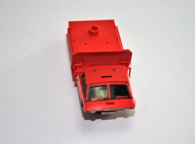

Glue the front grille to the main body with a headlight either side and the air intake below. Now fit the cockpit rear panel into its post holes in the main body and then the cockpit itself in front of it into the four remaining posts.
Fix the right and left front handrails between the cockpit and the main body checking that both are set vertically and are level to one another. Next fit the bulkhead into its slot and the rear handrails between the bulkhead and the main body checking they are also vertical and level with each other.

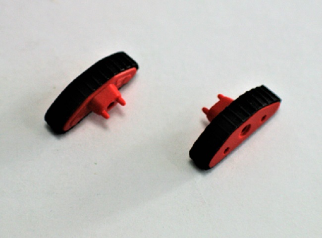

Separate the wheels from the sprue making sure that you leave the wheels pins intact.
Then without glue fit four wheels into the recesses on one of the front track inner parts and then glue a front track outer to the inner part’s posts making sure the glue doesn’t spill onto the wheels. Pull one of the tracks over the track/wheel set and then repeat for the other track parts.
Glue the track sets into the holes on the main body and using this stage’s screws secure them taking care not to overtighten the screws. Now glue the front track covers in place noting they are stamped with an R and L to help you orientate them correctly.
Finally fit the main chassis to the underside of the main body.

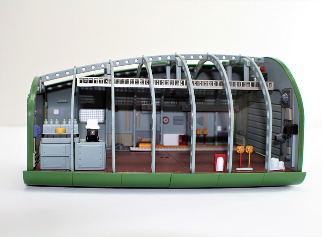

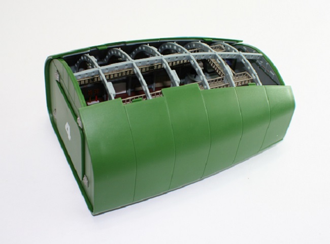

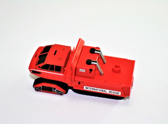

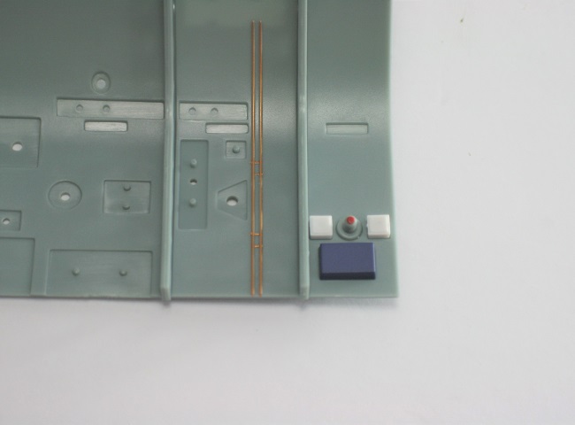

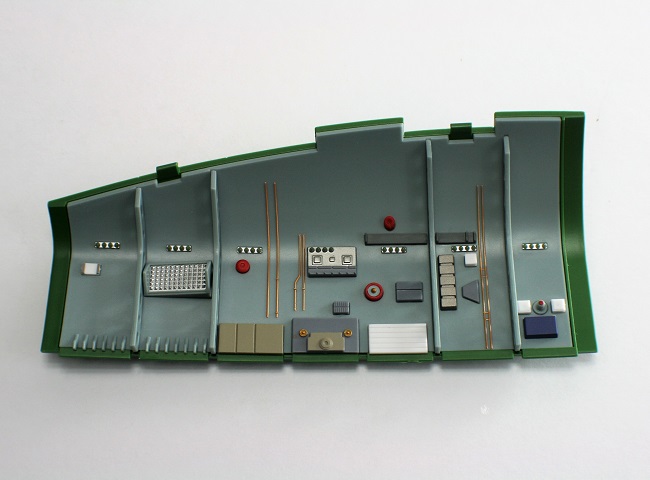

#4 Posted : 11 May 2018 07:11:51

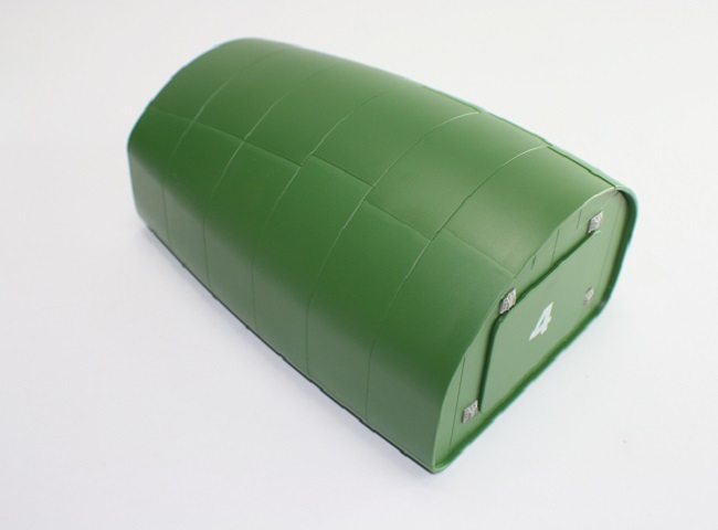

Stage 63
Thunderbird 2
Parts supplied:
Right outer panel
Glue the outer panel to the right inner wall with the locating pins making sure it’s placed correctly and then press the parts together until they are securely joined.
Fit the wall assembly to the right side of the pod without glue seating its bottom edge into the groove of the floors edge to locate it. The pins on the outer edges of the frames will fit into matching holes on the inner wall.

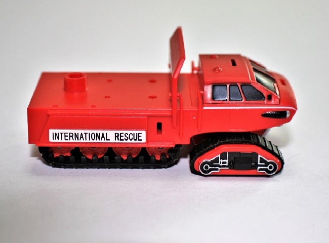

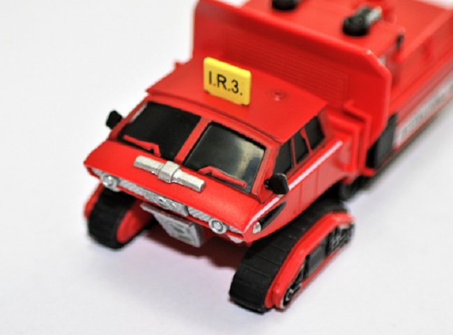

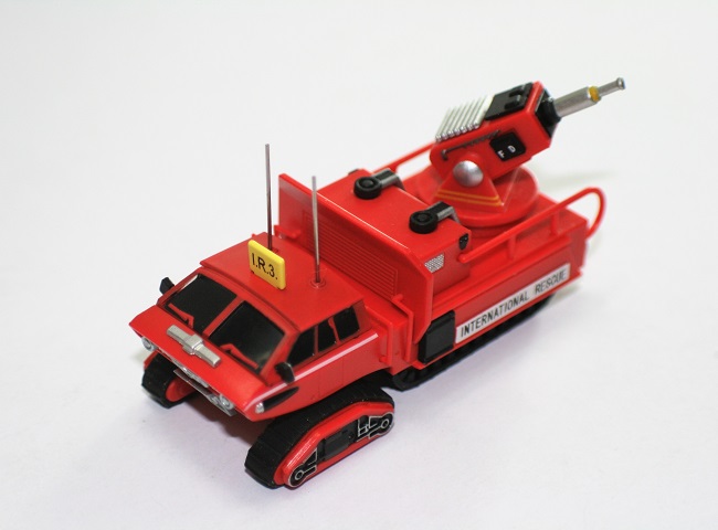

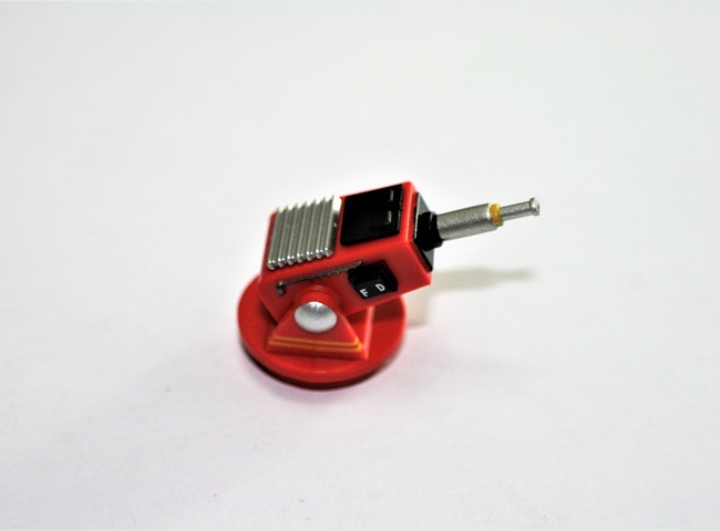

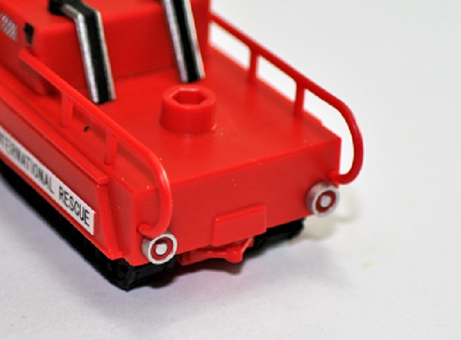

Fire Truck

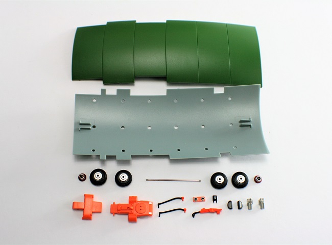

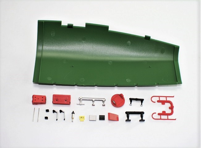

Parts supplied:
Water tank, Handrails L+R, Turret base, Tail lamps x2 - Bonnet detail (on a fret), Pump unit, Pump base, Battery covers x2 (on a fret), Mirrors x2 (on a fret), Name plate, Hoses x2, Side blocks x2, Details A+B, Nozzle, Ariels x2.
Glue the water tank into the holes in the main body and the two hoses between the water tank and the main body pressing them down gently from above to fit them. Now fit the battery covers to each side of the main body making sure they are orientated correctly.
The handrails are marked L and R to show you which is which and these are attached by fitting the curved tips into the holes in the back end of the main body, then moving forward fit the two pins into the top of the main body and the end pins into the water tank. Next fit the two tail lamps to the back end of the main body

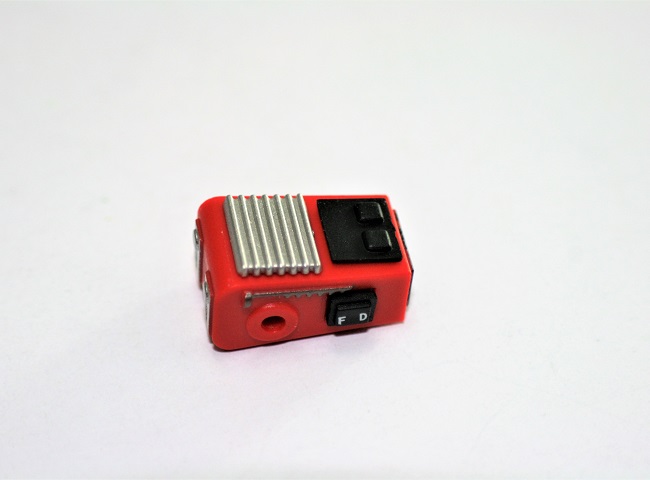

Join the pump unit to its base and then the side blocks to the pump unit making sure their orientation is correct. Next fix the details A+B to the top of the pump unit and without glue fit the pump assembly to the turret via the pins/holes. To complete the pump unit glue the nozzle into place.
Matching the slope of the bonnet glue the bonnet detail into its slot and the name plate onto the roof of the cockpit. Then fit the side mirrors into their slots with the mirrored surfaces facing backwards and checking they are level with each other.
Without glue place the pump/turret assembly onto its post checking that the pump/nozzle and the turret on which it sits can rotate and turn freely.
Finally glue the two aerials into place on the cockpit roof.

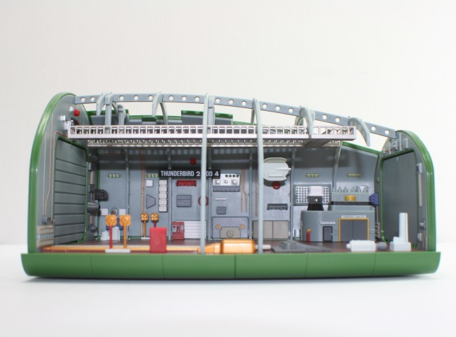

#5 Posted : 11 May 2018 07:18:46
Stage 64
Thunderbird 2
Parts supplied:
Left outer panel
Glue the left outer panel to the inner wall as you did for the right pressing the parts together to seal them.
Dry fit the wall to your Pod 4 assembly again seating the bottom lip in the groove of the floors edge. Carefully bring the panel inwards so it locates on the pins of the frames.

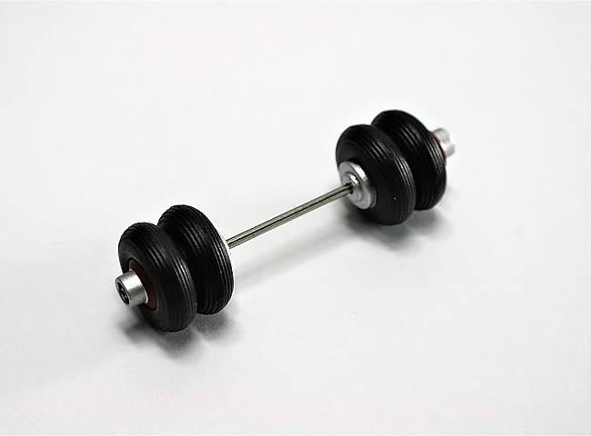

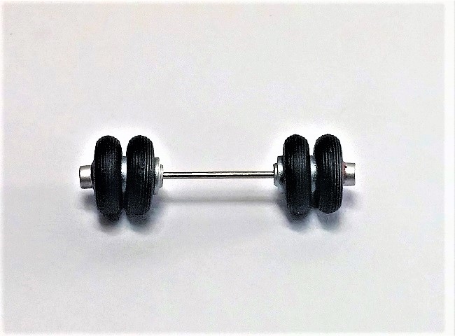

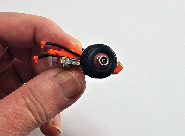

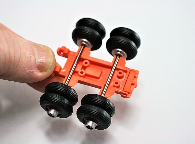

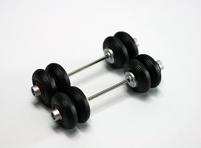

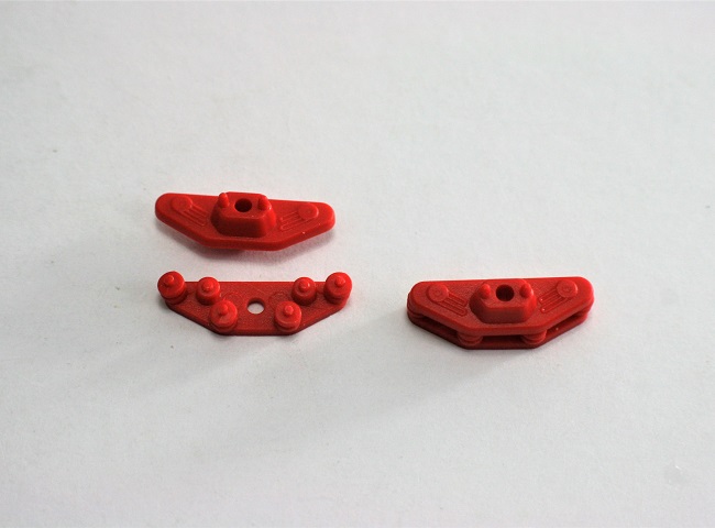

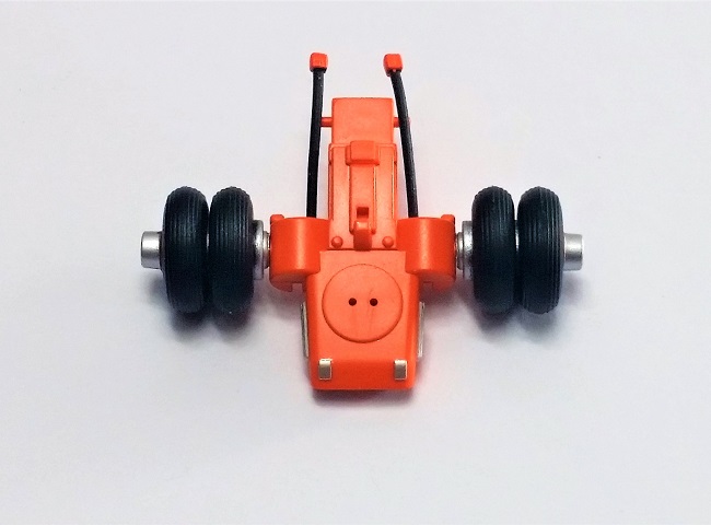

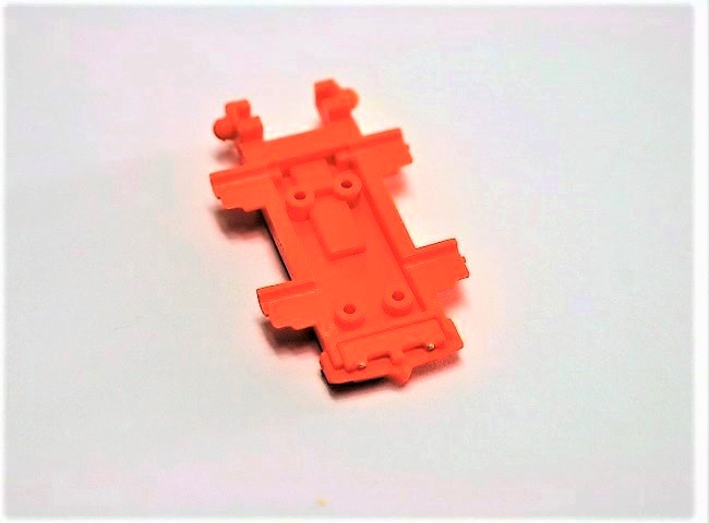

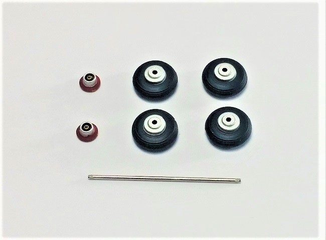

Elevator Car 4
Parts supplied:

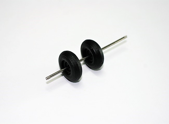

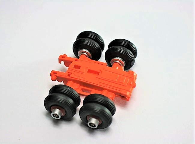

Rear wheels x8, Rear hubcaps x4, Rear axles x2, Upper rear chassis, Lower rear chassis, Rear buffer.
Slide two wheels over the tip of one of the axles, silver side first so that the side with the central recess faces out and retain them by pushing a hubcap onto the ribbed end of the axle. Now slide the wheels back up the axle until they rest against the hubcap. Fit two more wheels and a hubcap to the other end of the axle making sure both pairs of wheels fit together snugly and are pushed up against the hubcaps. Repeat these steps to fit another set of wheels and hubcaps to the second axle.
Glue the rear buffer to the rear upper chassis and then fit the wheel/axle sets to the lower chassis, without glue. Finally glue the upper chassis to the lower chassis via its locating pins encasing the two axles.

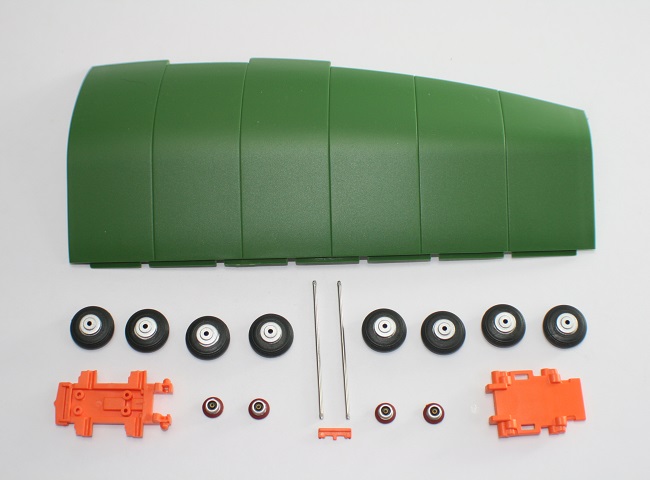

#6 Posted : 11 May 2018 07:25:08
Stage 65
Thunderbird 2
Parts supplied:
Roof panel outer, Roof panel inner.
Glue the roof panel outer to the inner and press the parts together so they fit neatly to each other’s shapes. The roof will sit neatly into the space between the two side panels locking them in place without the need for glue.

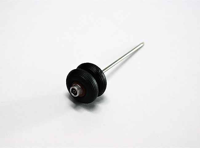

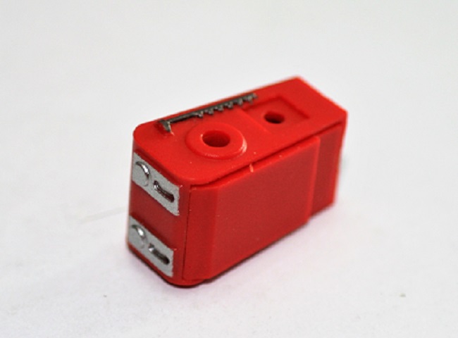

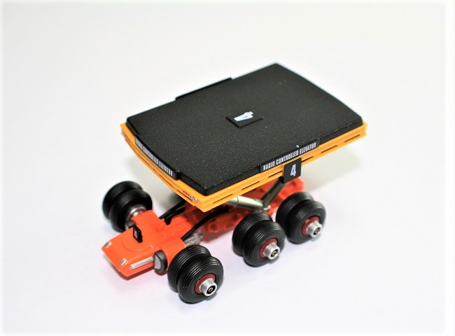

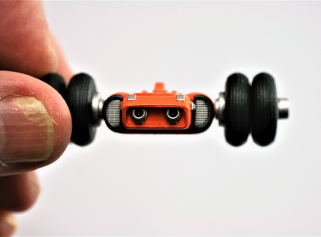

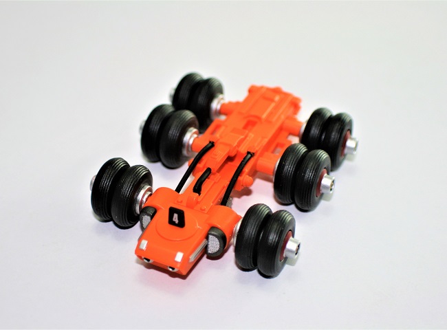

Elevator Car 4
Parts supplied:

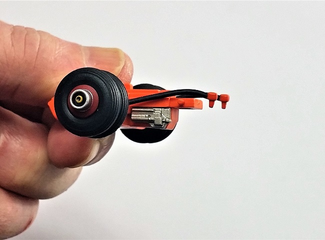

Front wheels x4, Hubcaps x2, Axle, Side blocks L+R, Air intakes L+R, Front chassis upper and lower, Front nozzles, Number plate, Transmission cables x2, Suspension damper.
Assemble the front wheels and their hubcaps on the axle, in the same way as previous wheel sets.

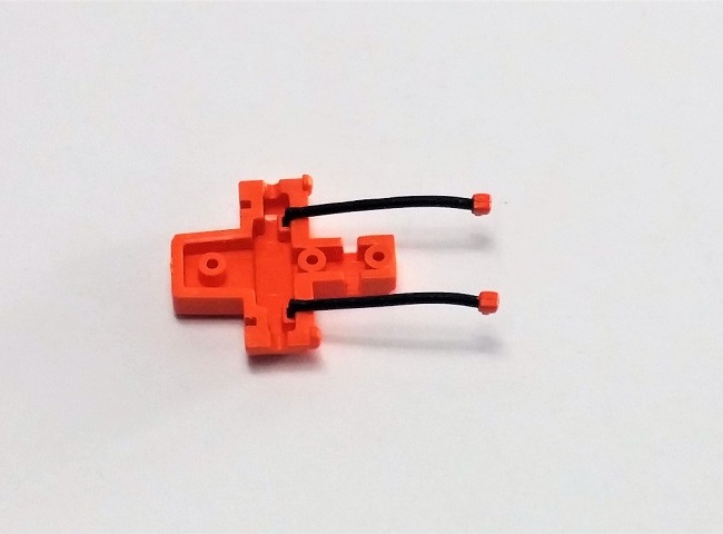

Glue the nozzles to the upper front chassis checking its orientation and then dry fit the transmission cables to the lower chassis. Then seat the axle into its slots and seal it in by joining the upper and lower chassis carefully using glue only on the connecting pins. Fit the R+L side blocks into their corresponding slots and then the R+L air intakes to their slots.
Now connect the front chassis section to the rear chassis via tabs and slots. Link the transmission cables to the holes in the rear chassis and now glue the suspension damper into its position. Finally fit the number plate.

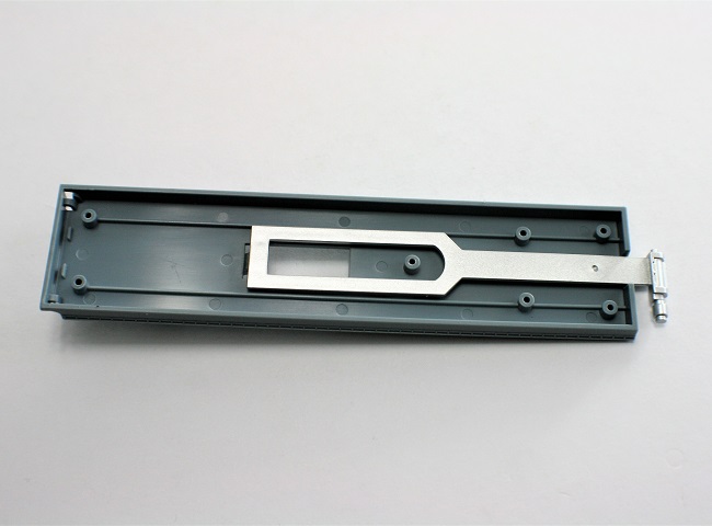

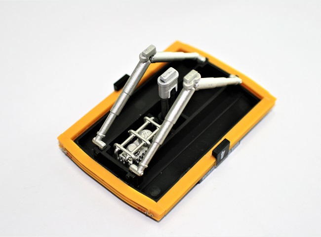

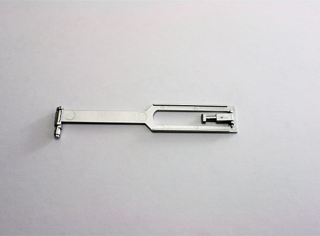

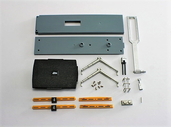

#7 Posted : 11 May 2018 07:32:38
Stage 66
Thunderbird 2
Parts supplied:

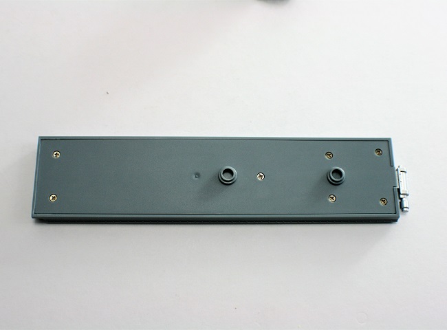

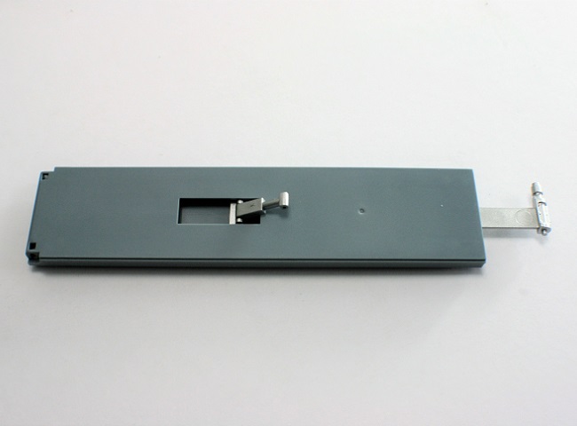

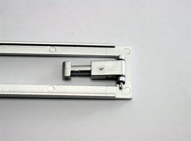

Ramp base upper and lower, Slide plate, Slide bar, Shaft, Screws x8.
Line up the slide bar to the two hinge points on the slide plate and push the shaft smooth tip first into the hole. Then push the ribbed tip of the shaft into the hinge to secure it and totally conceal the shaft.
Lower the slide plate onto the ramp base upper so the shaft fits through its rectangular hole making sure the parts are orientated oriented correctly. Keeping the plate in place, join the upper base part to the lower one using seven screws to secure them together.
Lastly check the slide plate and shaft can move back and forth from within the ramp base assembly.

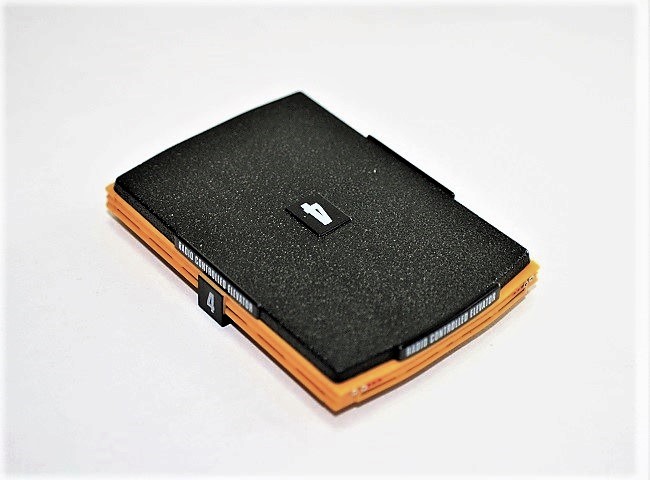

Elevator Car 4

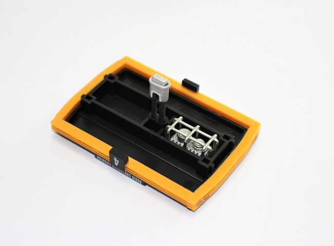

Parts supplied:
Platform, Platform frames short x2, Platform frames long x2, Suspension arms x2, Compressor, Compressor cage, Hydraulic jack.
Take all the platform frames and glue their ends together via the square tabs and matching holes making sure the parts are in the correct orientation. Once the glue has dried place the frame over the raised ridge on the underside of the platform and fix with a small amount of glue.
Next fit the compressor to the platform underside and fix the cage over the compressor. Now fit the hydraulic jack in place with its thinner and thicker pins in the correspondingly sized holes. Glue the suspension arms into their holes on the platform underside making sure they are orientated correctly.
Finally lower the platform onto the chassis and glue the tabs on its suspension arms and hydraulic jack fit into the slots on the chassis rear section.
Pack complete, carefully store any remaining parts in a stage labelled bag.
