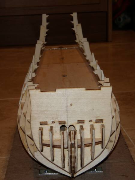

Thank you very much for your quick reply. Sorry for not getting back sooner but I needed to charge the camera up.
Please find an image of straight down the ship from the bow.
I am up to approximately magazine 16, pane 11 or so. I've also added the next set of stringers as I thought they might help strengthen the ribs.

Hi Chris, thanks for putting the picture up it does help. Looking at it then I'd say it doesn't look too bad however, the fact that the pic as been taken at a slight angle and not at deck level makes it difficult to be certain.
You say in measuring you are only 1mm out and there is no obvious twist in the keel. The 1mm difference can also be caused by ribs not being set perfectly horizontal to the keel, ie there is has been a little lateral movement when gluing the ribs in place or when fitting the deck, making one side a little higher than the other. The tops of the ribs where the deck sits, needs to be perfectly level in relation to the keel so I would suggest you double check here. If your checks show everying set correctly then there must be a slight twist on the keel itself.
Let me know what you find after your checks.
