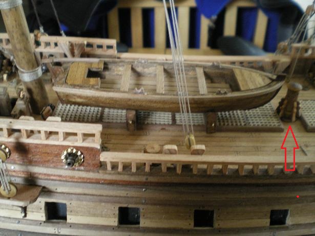

Thanks for the info. As you say, the Sergal/Mantua and Billings kits don't include boats but it looks as though the Corel kit does. Photos of the model show a boat lashed to the deck, but the shape is totally different to the longboat in the Vasa Museum.
The Revell 1:150 Vasa kit does include two boats of approximately the right design, but to display them correctly it would be necessary to alter the kit to a waterline model.
#7 Posted : 06 April 2018 09:26:56
Indeed the Corel kit does, but as can be seen from Martyns build photo copied below, the longboat supplied in the Corel kit does fit between the foremast and mainmast, but as can also be seen, the jeer capstan cannot then be used and is why the longboat was not stored on deck., unless perhaps the ship was in dock.
Our Vasa information is supplied by Fred Hocker - "there is no evidence to support that the Vasa ships boats were ever stored on deck"., your right to say that to display correctly, the longboat would need to be waterline/towed alongside rather than astern to reflect how it looked just before Vasa sank.
#8 Posted : 06 April 2018 19:29:18
Confused Hi Dave the ships boat is well over sized in the Corel kit and is produced in cast metal so I decided not to use it Crying I spent a lot of time covering it in wood but gave up on it as like you said it's totally wrong in shape and size Confused . The thinking is the boat was towed along side towards the stern quarter Cool
Hope this helps
Martyn
