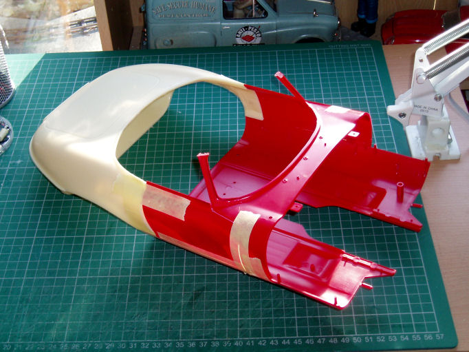

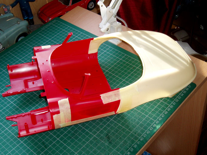

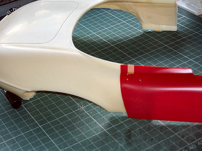

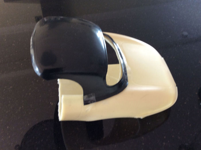

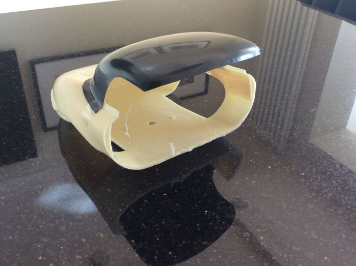

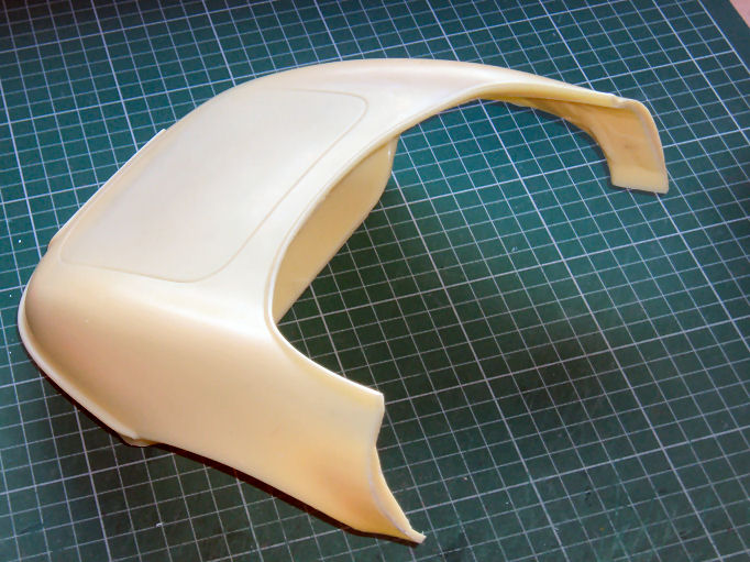

I'm 3/4 of the way through developing a roadster and hard top conversion kit but it's on the back burner for now as the Revell kit isn't about enough to warrant the work and cost.

I might get back to it at some stage but with the actual Revell kit now being 'hens teeth' there's little point.
