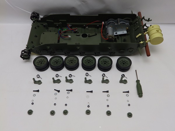

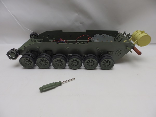

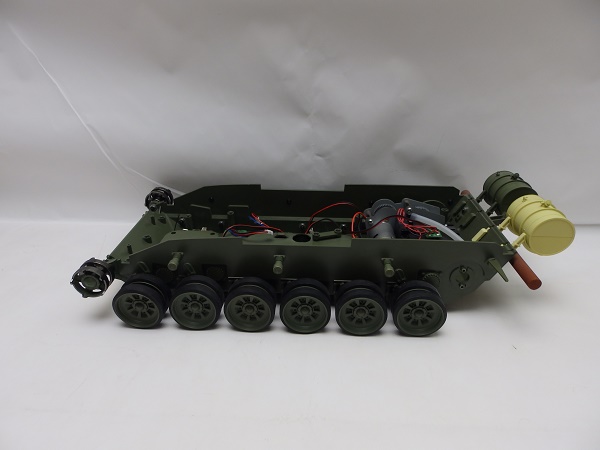

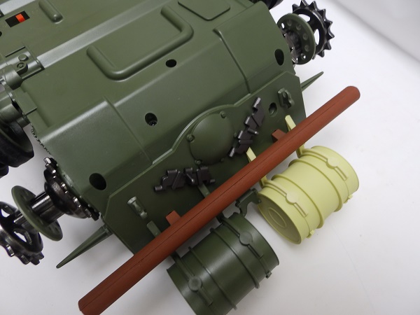

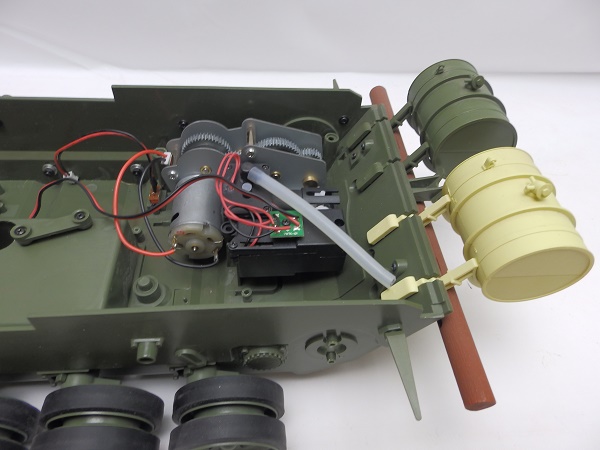

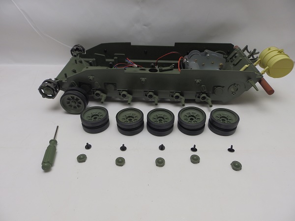

Stage 61

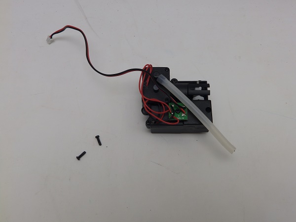

Contents: The smoke generator & screws.

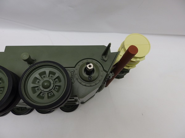

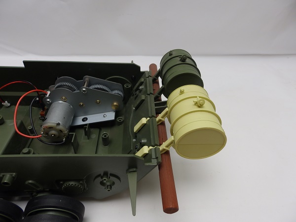

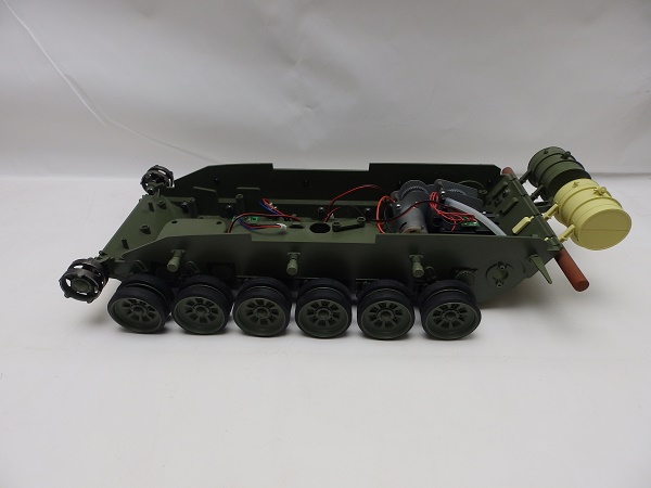

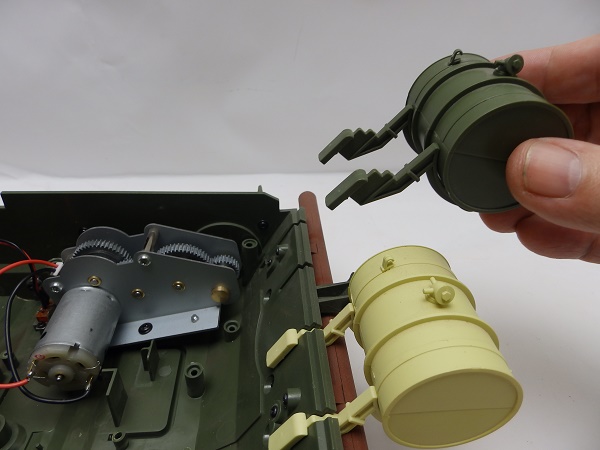

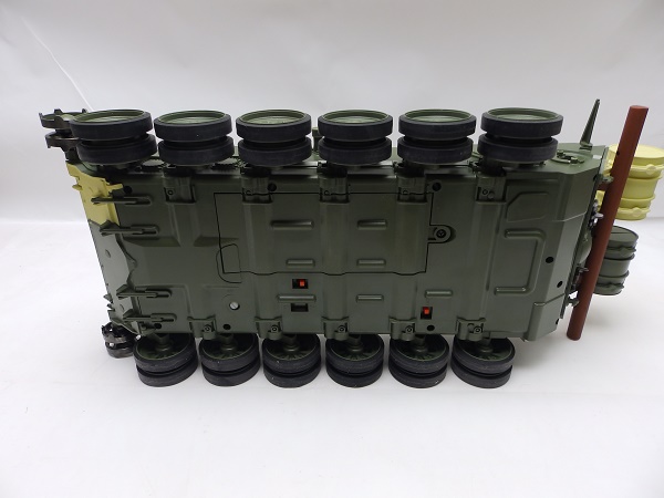

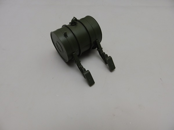

The smoke generator will be fitted in this stage. Details on its use will be in the running guide. For this stage you will need all the remaining 6 road wheel sets [Stages 24,26,28,30,32,34], the green fuel tank, the lower body and the smoke generator.

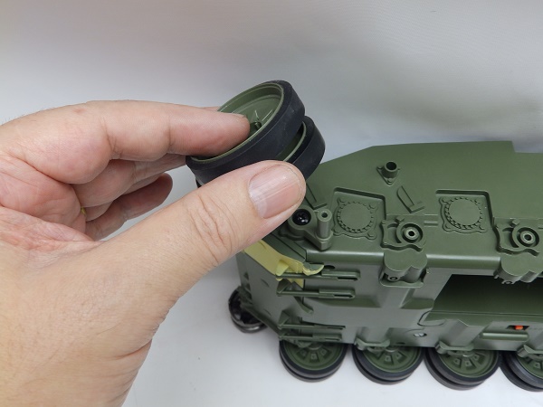

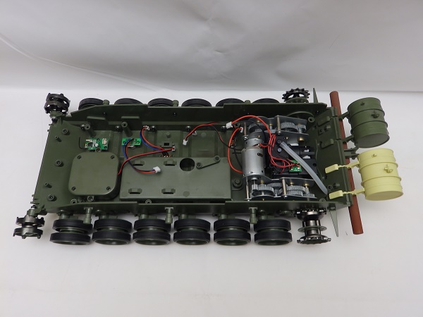

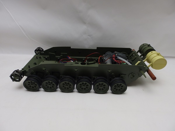

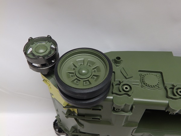

Fit all six road wheels in the same way you fitted them to the other side of the lower hull making sure the insert is present in the wheel centres Now add the brackets to the remaining fuel tank and slide the brackets into the slots at the rear of the tank. Next take the smoke generator and line it up over it two mounting posts. You can choose to screw it in position now or fit it after the other drive motor is fixed in position. Remember to place the exhaust tube from the smoke generator through the hole in the rear chassis plate.
This stage is now complete. Store the assembly and any remaining parts in a Stage labelled bag.

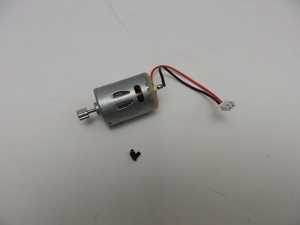

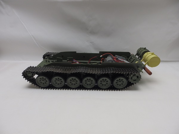

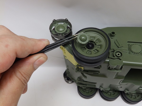

Stage 62
Contents: Motor and screws.

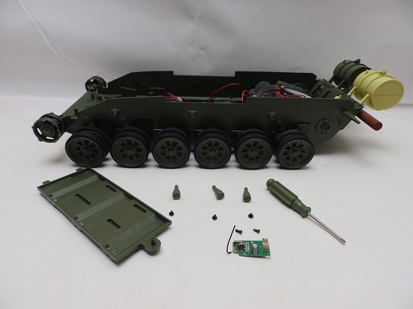

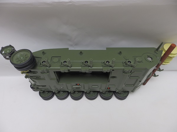

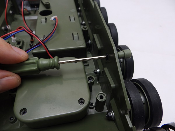

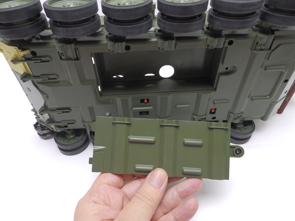

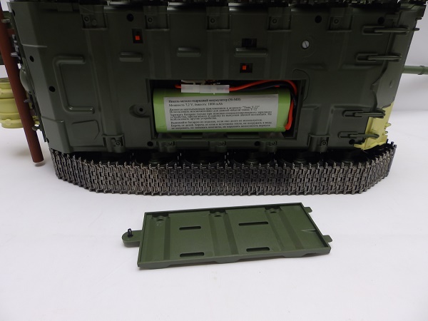

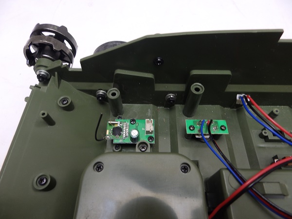

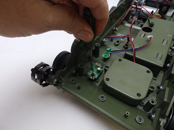

For this stage you will need the lower chassis, the rollers[stage 29],The IR receiver board [stage 38] and the battery compartment cover [stage 46].
Fit the three track rollers in the same way that they were fitted for the other side of the tank. Take the IR receiver and fit it onto the two posts next to the speaker using the two screws provided with the board. Next turn the chassis over and then line the two lugs on the battery cover with the holes in the lower hull once inserted tighten up the screw at the other end to hold it in position.

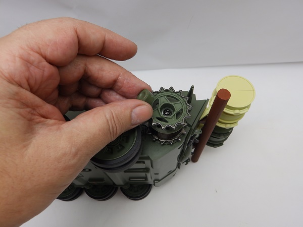

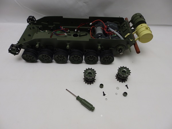

Stage 63

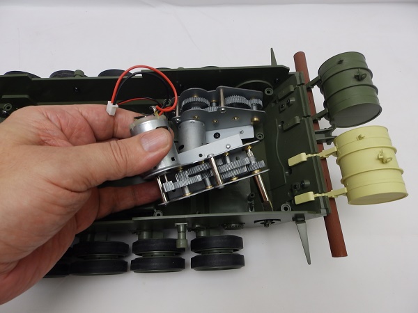

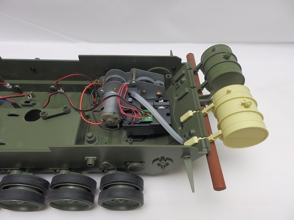

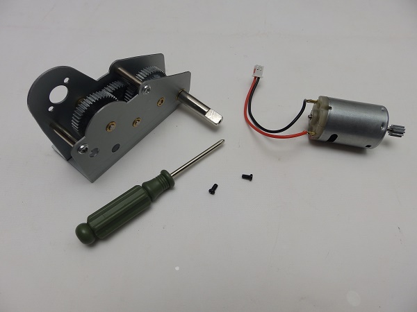

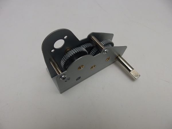

Contents: Transmission and screws.

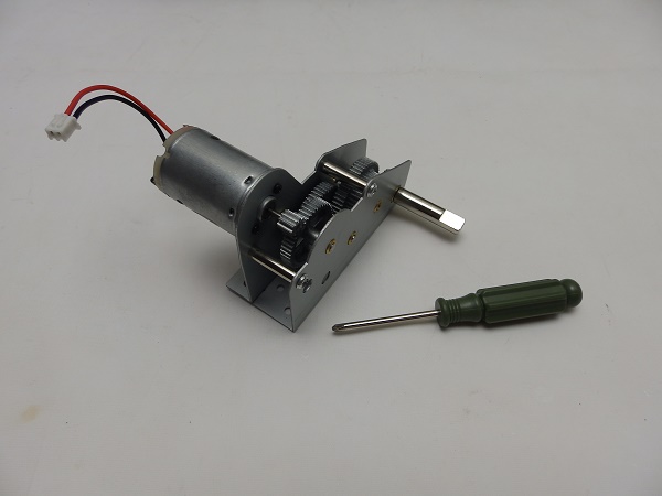

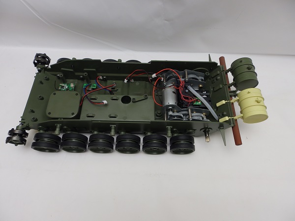

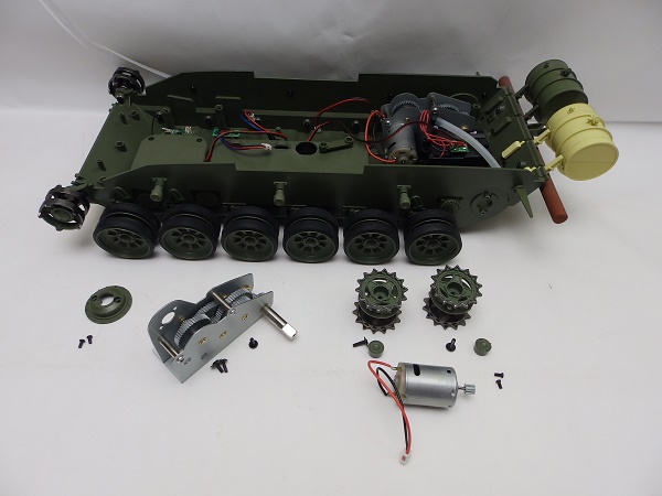

For this stage you will need the lower hull. The two drive wheels [Stages 4 and 25], the second motor[Stage 62].

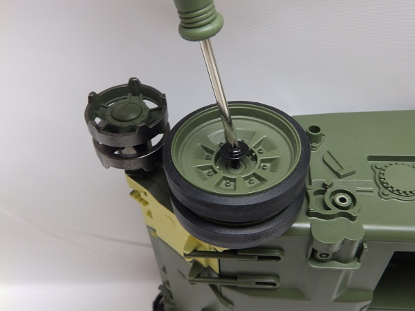

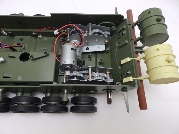

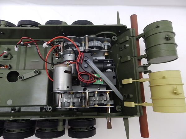

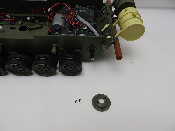

If you have already screwed the smoke generator in position it will need to be removed and then replaced after the motor and transmission are fitted. Take the motor and line it up with the transmission and fix it in place with the two screws. Line up the drive shaft of the transmission with the hole in the lower hull and lower it into position, then fix it in place using the three screws. Once it is secure replace or fix the smoke generator in position.

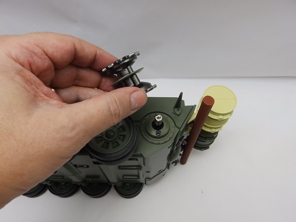

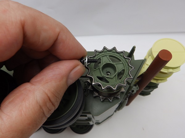

Next place the drive wheel cover in position and use the two screws to fix it in place, now line up the drive wheel with the notch on the drive shaft and fix it in place with the bolt, spring washer and washer once tight fit the cap in place. Fit the other drive wheel in the same way.

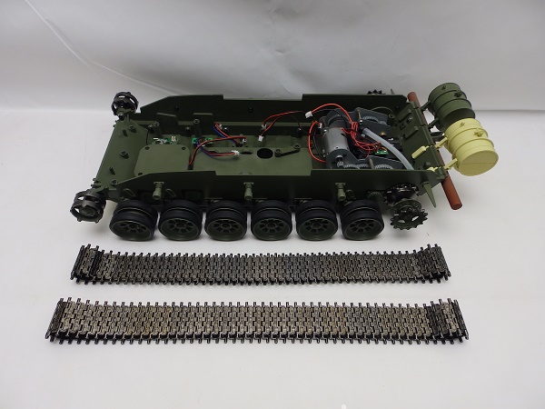

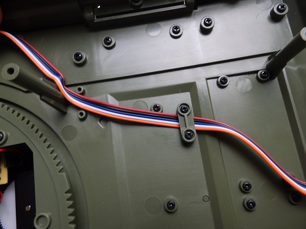

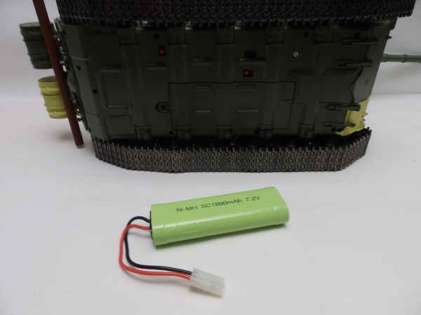

Stage 64
Contents:
7.2 V battery.

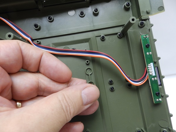

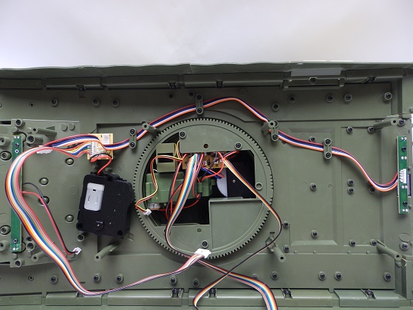

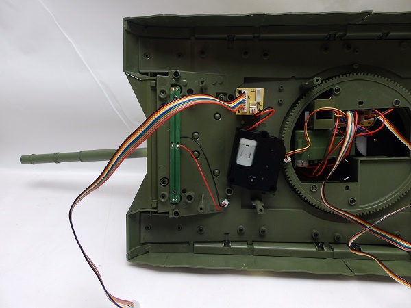

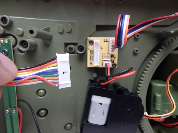

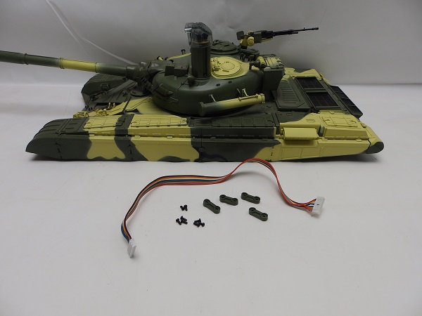

For this stage you will need the upper hull, the floodlight bracket[stage 31], the 'L' cable[stage 40] ,screws, tabs and hooks [ stage 60].

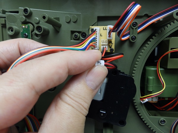

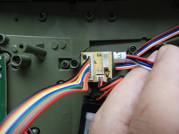

If you already have not done so place your battery on charge with the charger provided. Next take the ' L 'cable and insert one end into the socket marked ' L ' on the circuit board next to the turret motor. Now at the rear of the upper hull take the LED board wire and locate the two lugs, lay the cable flat and fix a tab over it with screws to hold it in position do the same for the remaining three tab holders. Once all the tabs are in place fit the end of the ' LL 'cable into its slot on the circuit board then fit the ' PL ' cable into its socket on the same board.

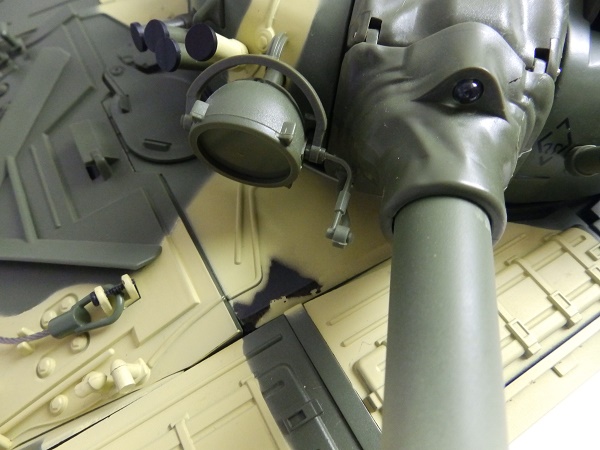

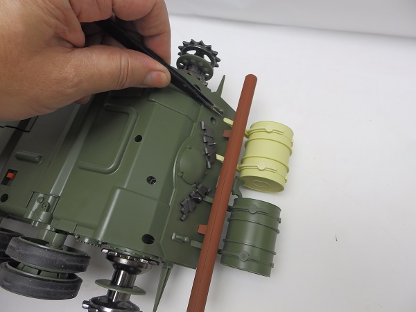

Take the floodlight bracket and insert the bracket ends into the gun mantle and floodlight , you may need to glue it in place. Next glue the two towing hooks into there slots at the rear of the tank lower chassis.

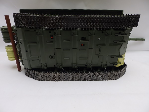

Take your track assemblies and with the hull turned on its upper surface fold a track assembly around the wheels making sure the central ridges are inserted into the center of the wheels. Use a pin to hold the tracks together then turn the assembly on its side and use a wooden block and hammer to drive the pin home. Do the same for the other track.

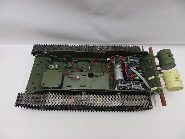

#5 Posted : 08 February 2018 14:29:01

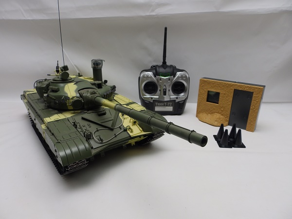

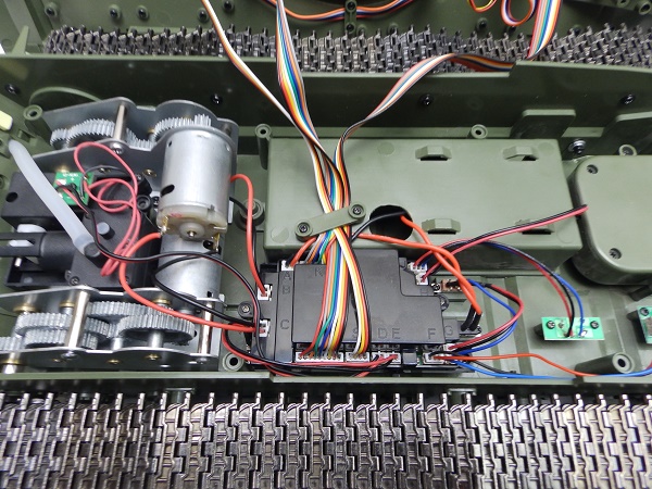

Stage 65
Contents: Control unit, ' Q ' cable, transmitter and screws.
The ' Q ' cable is used with the optional Wi-Fi camera system details of its use will be in the running guide.
For this stage you will need the parts from stage 65, upper and lower hulls, fuel hoses, transmitter and screws.

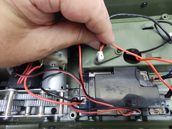

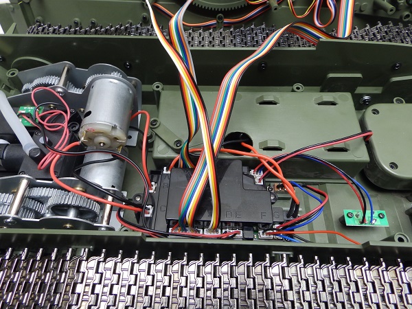

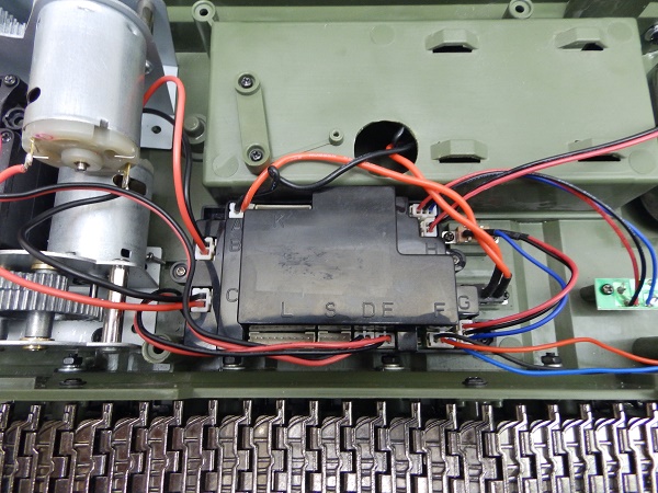

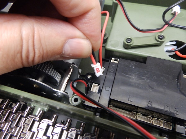

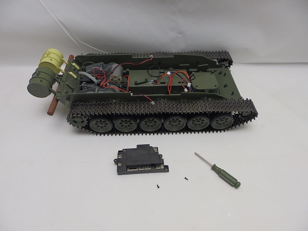

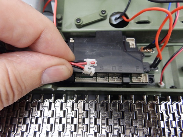

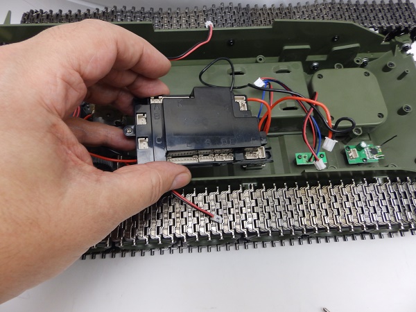

Firstly check all the cables to see that the switches are in the correct positions if they are not then simply readjust and refit. Next looking at the hull base make sure the on/off switch is at the off position and the connectivity switch is on the ' 2.4 G ' side, all other switches should be set at the off position as well. Use two screws to fix the control unit to the lower hull. Now take the motor connectors and put the cable with the letter ' B ' printed on it into socket ' B ' and ' C ' into its socket. Do the same with cables A, D, E, and F plugging them into the control board.
Now plug cables H, J and G into there slots,then the three cables from the upper hull into sockets K, L and S. Next use the large tab to fix cables K, L and S between the two posts. Connect the battery cable to the last open socket on the control panel and then connect your charged battery to the socket and replace the battery cover.

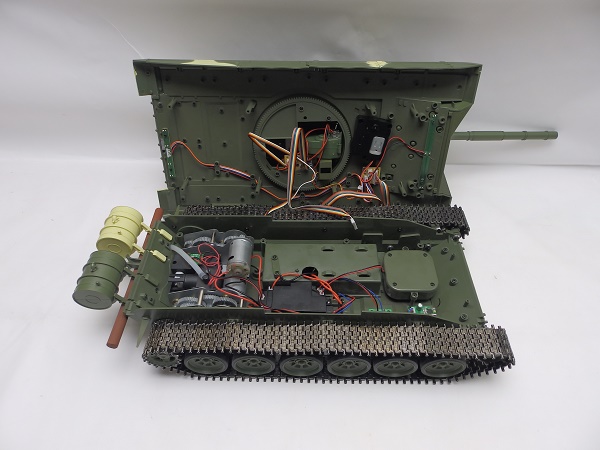

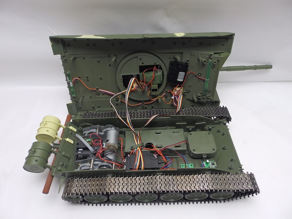

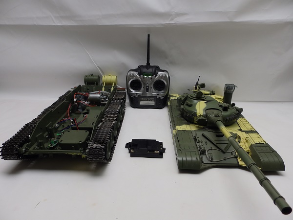

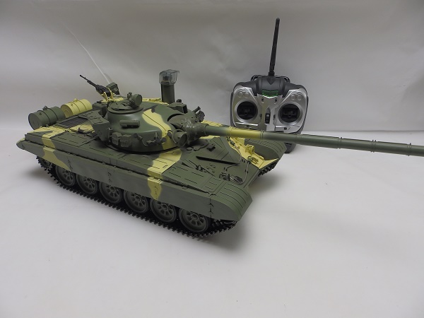

Place the upper hull onto the lower hull but do not fix it together with screws yet as we will be testing the operating system. Make sure the connectivity switch on the tank is set to ' 2.4 G ' then turn on the transmitter the red light above the switch should be flashing very fast the turn the tank to the 'ON' position the tank will beep twice and then should connect to the transmitter and the light above the switch go a steady red colour without flashing. The headlights on the tank will be flashing slowly at this stage. On the lower left of the transmitter there are three buttons press the lowest button and you will hear the engine start and the headlights will show a steady beam. Try a few simply commands to check all is well then switch the tank and then the transmitter off.

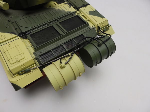

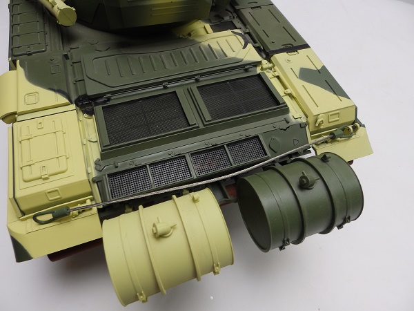

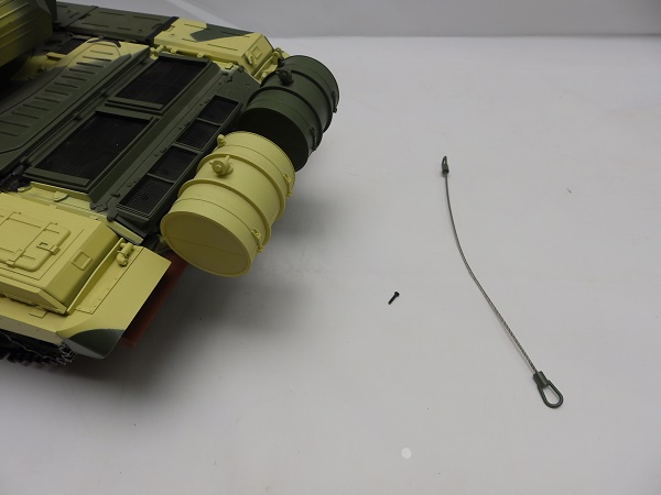

Line up the upper hull with the posts on the lower hull and use 8 silver screws to fix them together then put the tank on its tracks. At the rear of the tank fix the tow cable to its bracket with a screw then add the three black fuel tubes to the fuel tanks and rear body.
Remember to download and follow the operating guide for R/C operation.
Congratulations your T-72 tank is now complete.
