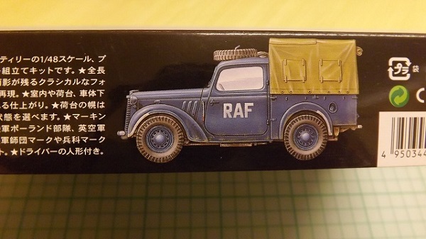

Also, when I bid for the Airfix kit on eBay it came with the Tamiya Utility Car you can see in these pictures. So as that gives the options to finish that kit in RAF colours the ideas are beginning to flow.
So, parts that may or may not end up being used depending on what time I have to make up a display are:
1:48 Tamiya British Light Utility Car

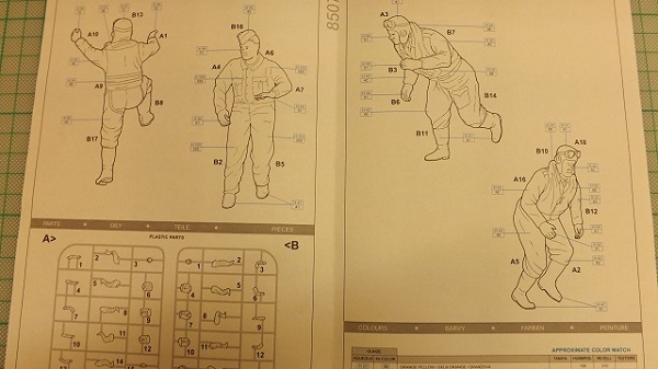

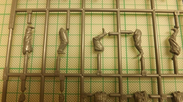

1:48 Eduard RAF Fighter Crew 1940. Quite interesting these because what you get in the box do not make 100% replicas of the stance each of the figures have on the box top.
The instructions for this set are drawn as outline figures and while there is nothing majorly wrong with this (i.e. we all know were arms and legs should be glued) the ICM instructions are very nicely drawn.
The Eduard offerings are moulded in Mid grey plastic.
Also, when I compared these with the set from ICM I would have to say the ICM kit is slightly sharper in the details than on the Eduard sets.

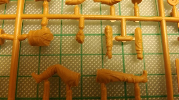

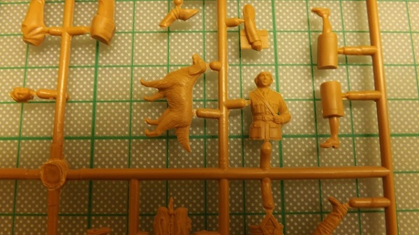

1:48 Eduard RAF WWII Personnel. Again, same comments apply as regards the stance of the figures on the box top to what you get in the box.
1:48 ICM RAF Pilots and Ground Personnel. These figures do match the figures as drawn on the box top so what you make from the kit matches exactly those shown on the box artwork.
The ICM offering is moulded in a sort of tan coloured plastic and to my eye appear to be slightly sharper in the detailing.

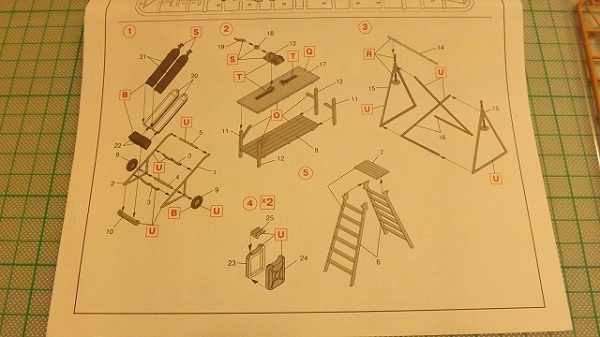

Also within this set you get a few ground equipment items from a couple of gas cylinders on a trolley to a nice work bench with an ammo loading tool in place.

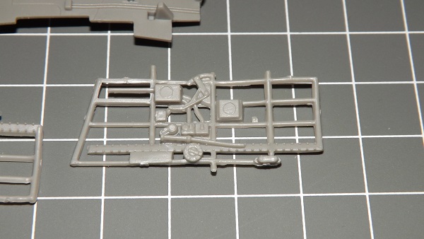

SUNDAY 21st January 2018 1:48 Airfix Tomahawk
Now that I have all of the bits and pieces I am hoping to add to this kit along with my paints its time to make a start.

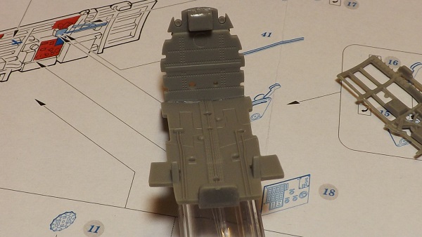

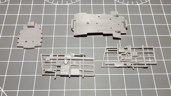

The first 12 of the 51 steps in the Airfix instructions are all for the building of the cockpit which makes up into a small module that will later be added to the fuselage.

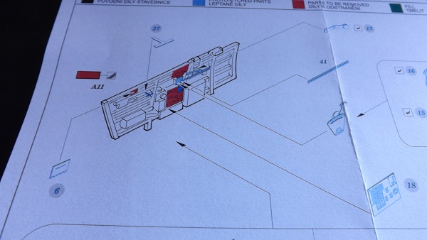

As the intention is to try (try because some of the parts are so, so small) and use the Eduard etch set in this build I need to cross reference the Eduard instructions with the Airfix to see what parts need to be removed from the kit ready for the addition of the etch parts.

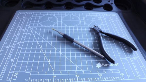

At this stage its just the most basic of tools needed in the form of a pair of cutters and a small chisel to remove some of the surface detail.
The kit sidewall parts do need a little bit of attention because some of the very small spaces between some of the ribbing are flashed over so some careful work later to unblock these.

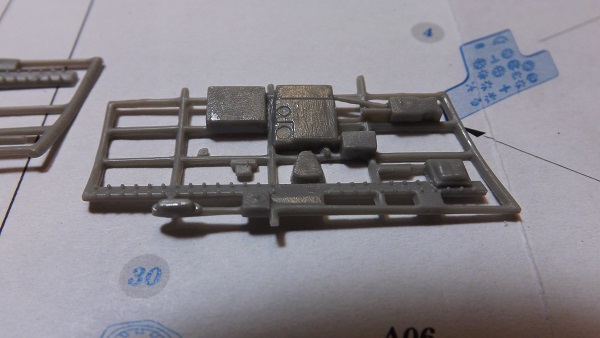

PICTURE 1
Well what I have found today is that I need to get myself off to the opticians soon as some of this kit is so small I have had to pull out the magnifying visor to make things a little easier to see.
PICTURES 2 Through 3

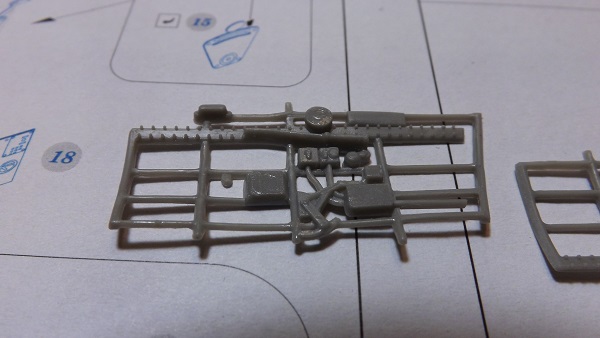

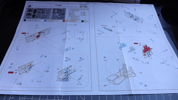

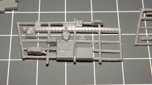

Here we have the 2 cockpit sidewalls and the instrument panel.
Its important to follow the Eduard instructions as a number of parts have to be removed and in other cases the moulded-on detail has to be removed.
I was quite surprised that there is some minor flash on the parts with some of the (very small) holes filled in completely. This is what’s taken most of my afternoon cleaning up all of the parts and opening up holes in the frames. It’s one of those jobs you wonder if there is actually any need to do as when this is all closed up chances are it will not even notice.

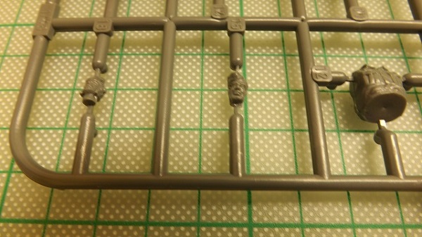

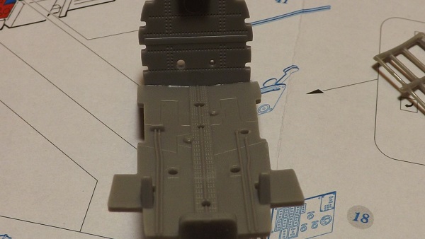

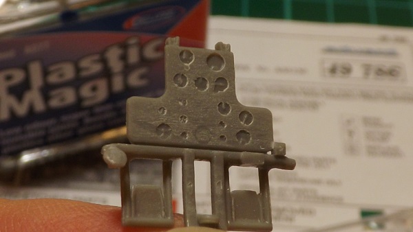

PICTURES 5 & 6

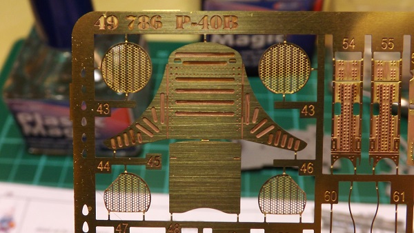

“Yippee” first 2 parts glued together. Cannot find my usual plastic glue so pulled out one that I saw good reports about. Its “PLASTIC MAGIC” by Deluxe Materials. It seems good and forms a nice clean join in next to no time.
PICTURE 7

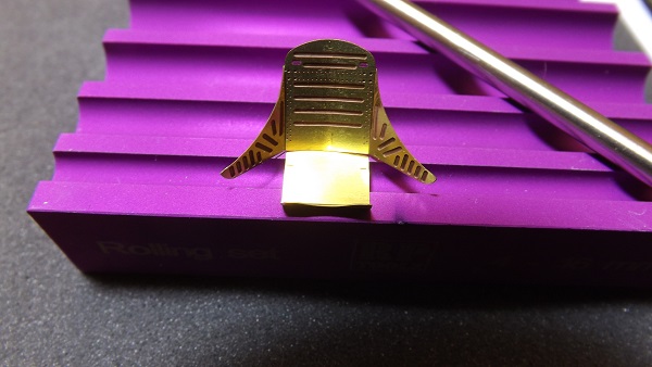

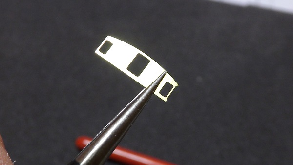

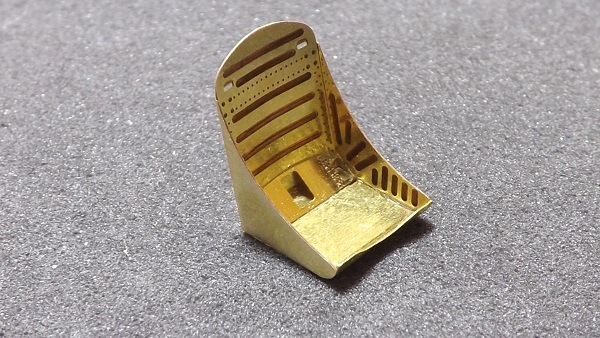

As time is against me today to do any priming I was looking for something to do that would be fairly quick so opted to have a bash with the etched seat from the Eduard set.
I was pleasantly surprised in that the connections to the fret are very thin and were very easy to cut through. Not used Eduard for some time so hoping this is something they are doing with of their sets as it makes cutting them out so much easier.
PICTURES 8 Through 10

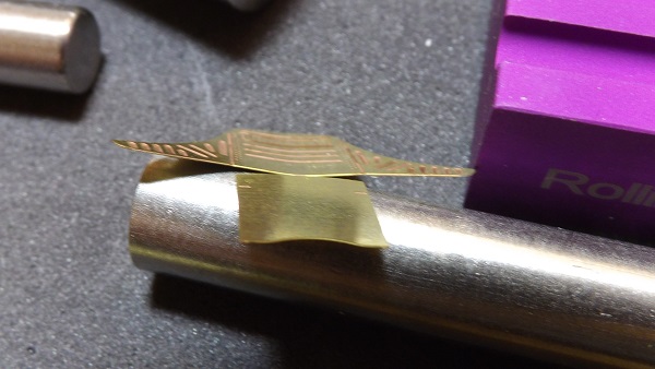

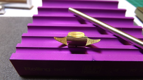

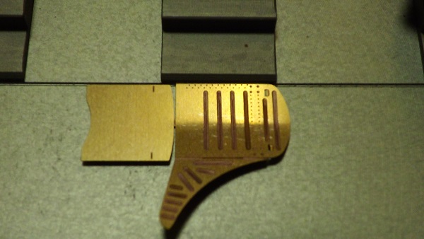

The back of the seat has to have a very gentle curve added to match the shape of the back of the seat base.
I found the easiest way to do this was use one of the roll bars from my etch rolling set. You could do the same using the handle of a craft knife to be honest.
What you then have to do is curve the front edge of the seat and for this I used my rolling set.
This seat is not designed to get a second chance at folding. The seat base is attached to the back with the smallest etch tab I have ever seen so its “guaranteed” to break if you twist it too much.
PICTURE 11
Into the folding tool just to ensure the seat sides get bent into shape correctly.
PICTURE 12
This small piece fits into the seat at an angle between seat base and seat back.
Luckily had some new superglue un-opened as my three bottle I have had for a while from Cornwall model boats had all set solid in their pots. Really annoyed about that because they had hardly been used. Stored in what I thought was a dry cupboard but I guess the damp got to them and set them off.
PICTURE 13
And here is the finished (apart from paint and belts) seat.
Quite pleased with my efforts.
There is an good build article in this months Airfix Model World Magazine and the builder mentions that for the Tomahawk the seat back in the Eduard set is incorrect in that it should have a flat top to the back rather than rounded.
Its interesting that in the Airfix kit you do get both versions of the seat.
The Airfix builder got around the issue by bending over the top section of his seat.
I may do that or just leave it as is because after all its only going to be noticed by aircraft experts.
