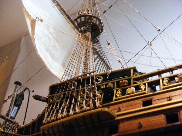

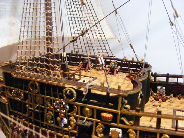

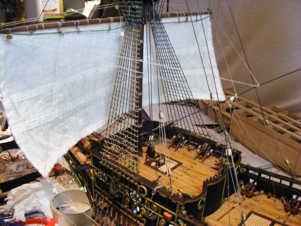

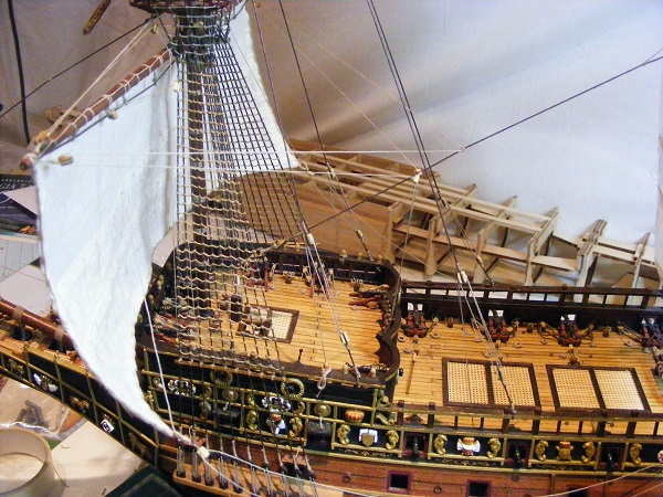

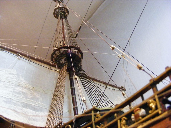

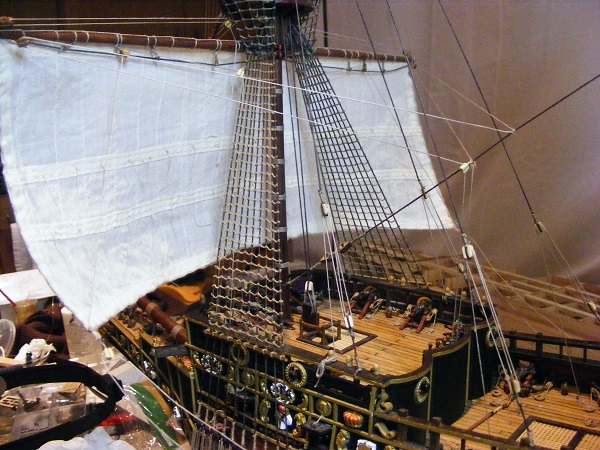

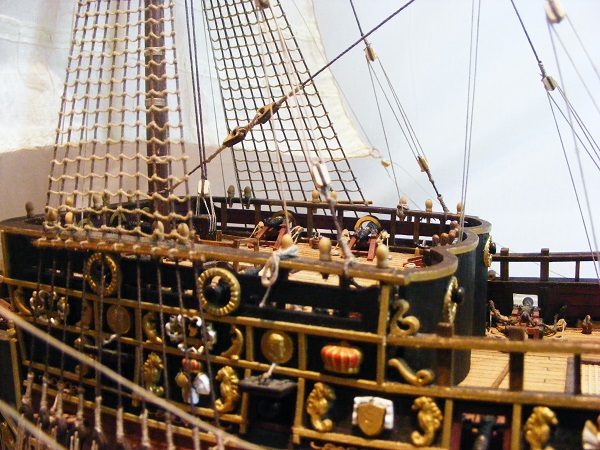

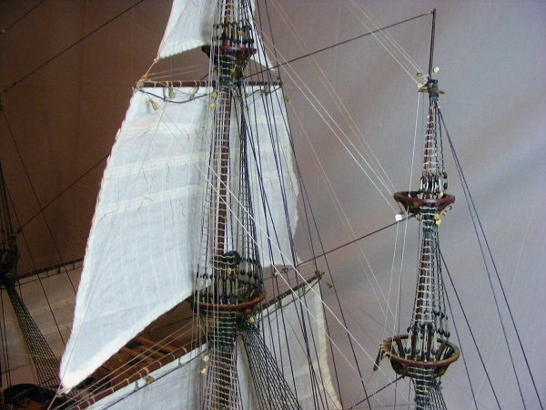

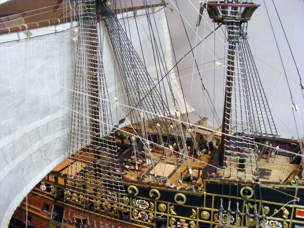

Hi all, finally managed to finish issue 126 and this issue turned out to be a fairly long session, mainly due to working in confined or awkward areas. Space now to work in around the ship is starting to get very cramped and it is so easy to catch or break something if care is not taken, key here is to take your time and work gently.Cool Cool
Started with the fitting of Main Royal Yard and Sail. Fitting and rigging this small sail on top of the main mast was pretty straight forward, except for when it came to attaching lines in and around the deck area. The Halyards were fitted, securing these to the yard and to cleats on the main deck. Next was the fitting of the lifts, again straight forward and securing these to the pin rack in front of the main mast. Fitting the sheets was next to be done including the fitting of blocks to the shrouds, would recommend these blocks are fitted prior to starting any of the rigging while you have the space to work in. The sheets were secured to belay pins on the bulwarks. Finally for this sail was the fitting of the braces, the braces run to the top of the mizzen mast and secured to belay pins on the quarterdeck bulwarks.
Next on the list was to fit the foresail, this was done in much the same way. Started by securing the sail to the yard, making up the parrels and securing the yard to the foremast. Halfyards were secured to the bitt in front of the mast, again very fiddly due to lack of space. Sail rigging lines were fitted in the same way as the other sails. The braces are attached to the lower mainstay, these should be secured with a drop of CA.
That concludes another issue and issue 127 gets underway… Will update again soon so until then happy modelling…Cool Cool
