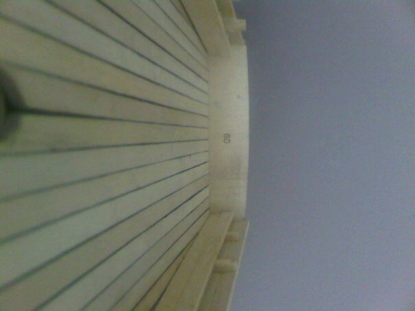

Hi,
Ive a problem with the cuttin the incline of the poop deck allong the bulwark!
the measurements have for the cut dont add up Bored
ok looking from bow to stern i have 12mil one (L) side 17 the other(R) and 5 an a half mil(L) and 7 an a half the other (R)
can someone try and help me out because i dont want to cut it lol
thnx.....

Sounds like you have one side of the hull at the poop higher than the other, can you post a photo of both sides?

Yes i can but aill have to wait for missus to come in with the blackbury coz i dont know how to transfer photos of my iphone lol
Ya cant really see ant sort of over/undersizing, it looks pretty lvl but obviously its not.
anyhow ill post soon as she gets in and thanks tomick...

#6 Posted : 26 May 2011 10:00:01
Looks like the left (starboard) side need another row of planking, then re-take the measurements and the cut line should then be equal.
Son of Bulwark
#7 Posted : 26 May 2011 10:21:15
Hi bountyhunter_04! Cool
Sorry Tomick! No Extra Plank Needed, from the pictures it shows that the inside planks are below the outside planking YES?. So you don't need to add more planks as you cut the planks off above the inside planking slopping down to the beam at the front of the poop deck.
So don't worry about that as you take the measurements from the 2 planks on the inside of the hull on your starboard side you have 12mm from the deck to the top of the outer hull but that means that it is only 2mm above the top of the inner planks, mark 2mm on the outside hull at the stern. Port side is 17mm from the deck to the top of the outer hull but that means that it is only 7mm above the top of the inner planks, mark 7mm on the outside hull at the stern.
As Tomick said "re-take the measurements and the cut the line".
The reason for the difference is the way you have shaped the planks lower down then hull sides. follow the instructions in the magazine and you should be OK!
#8 Posted : 26 May 2011 10:29:02
The inside planking on each side does does not appear to be the same height on each side, if you look at the height against the top of the inside planking and top of gallery wall, the right side is higher than the left.
