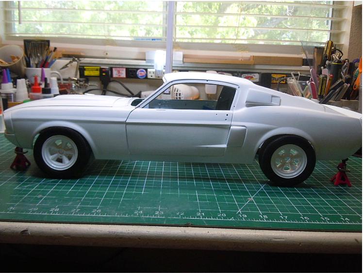

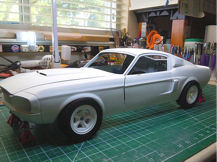

First mock-up. I'm liking the wheels. Much work still to go.

#44 Posted : 24 July 2017 18:56:42
Quite a modification to the body work so far, I'm loving.
While watching a 'Fired Up Garage', I think they were doing a Cuda off the top of my head, I heard them mention that black is a difficult colour to do as it shows every little defect. It would certainly show off your prep if you went with this colour Drool

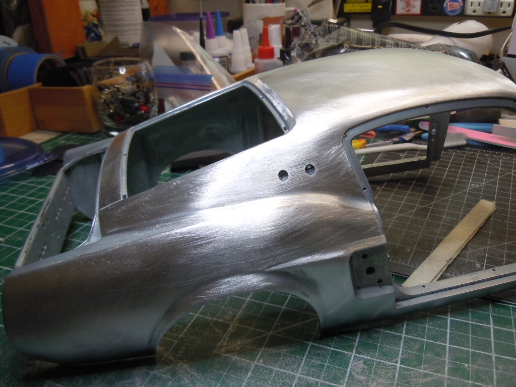

StevieDisco wrote:
I'm also going to repaint the body. I use a paint stripper and a wire brush and steel wool to remove the paint followed by soaking the parts in Castrol Super Clean (de-greaser). The kit body parts are very nicely tooled pieces but still needed some TLC. Flat sanding from course (in places) followed by medium and fine (600 grit). I then sprayed on several coats of Tamiya Fine Primer. Next step will be to wet sand a spray on more primer. I'll then store the parts until I receive the remaining body parts and give them the same treatment. I'd prefer to paint all of the body parts at the same time for consistency.

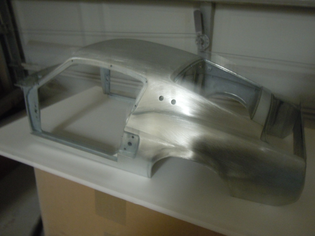

#46 Posted : 25 July 2017 17:07:27
Joined: 09/01/2017
Posts: 50
Points: 150

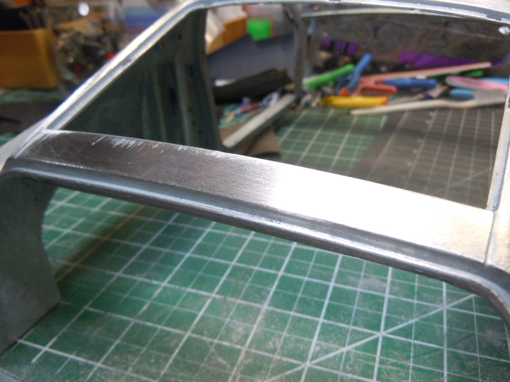

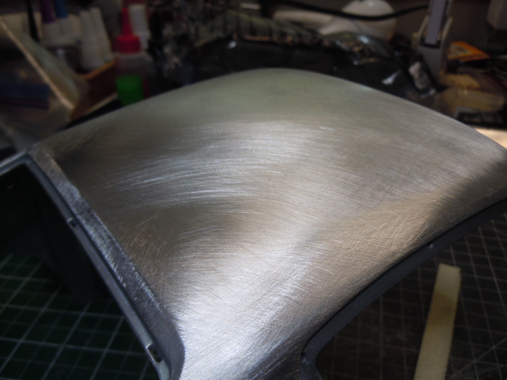

Here's what the body looks like after it's been stripped and rough sanded. It looks worse than it really is.

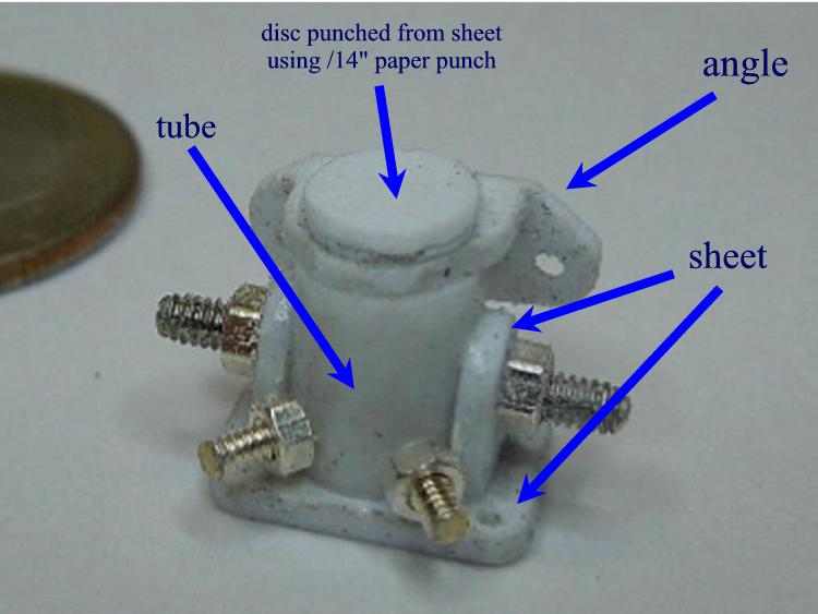

Here is my prototype starter relay (solenoid) for the Shelby. I used 1/4" Evergreen angle stock, 3/16" round tube, .040" sheet, 0-80 and 00-90 screws & nuts. I need to tweak it a bit but overall it looks to be both functional and visually acceptable. I'd appreciate any comments and/or suggestions as well as maybe photos of other members versions. I'm also making a voltage regulator.
On another note, I had to re-do my front brake calipers after inadvertently putting the brake line fitting on the wrong side. That's what happens when you work in the shop until the wee hours of the morning. Oh well. It gave me a chance to re-paint it bright red instead of Italian red which just didn't look right. I should have those done by this weekend and will post pictures.
Thanks again for all comments and suggestions.
Stevie, thi is super and amazing detail. Thanks for sharing with us all.
What is 1/4" Evergreen angle stock, and did you use metal or wood 3/16" round tube? Also, what is .040" sheet?
Can you post a few photos of seperate items here to clarify? I'm in the US and I've never heard of evergreen angle.
Rich

Hi Rich,

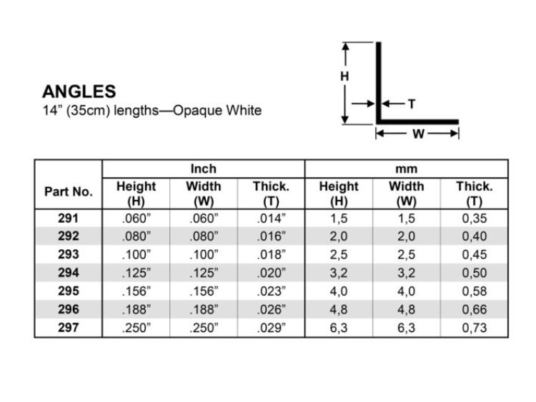

Evergreen plastic products are sold in many hobby shops or you can buy direct at EvergreenScaleModels.com. They offer styrene plastic products for scratch builders in many different shapes including the angle and tubes I referenced. I would highly recommend getting their book "Basic & Advanced Tips and Techniques for Styrene Modeling".
Once you get into scratch building with the various shapes they offer you will look at things differently. Almost every part you are looking to replicate can be broken down to a group of individual unique shapes. In addition to the angles, Evergreen also offers quarter-round, half-round, channel, etc.
The .040 sheet is the thickness of the styrene sheet they sell. They offer sheet styrene in many thicknesses.
I hope this helps,
FYI, the paper punch I used was a standard 1/4" and not 14" like the photo says.
