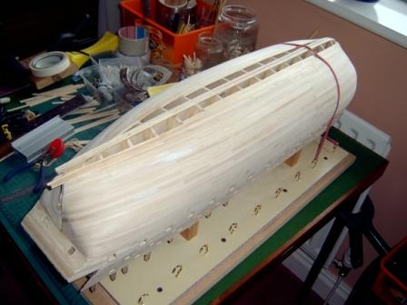

#12 Posted : 10 May 2011 11:23:05
Joined: 23/03/2010
Posts: 205
Points: 598
Location: West Midlands
Dont give up, when you have sanded down the planks you will have a superb model, attached is my build after a good sanding. Believe me there were times when I did not think I could complete the planking but perservere, it is worth the effort.
Happy building
CMB attached the following image(s):
