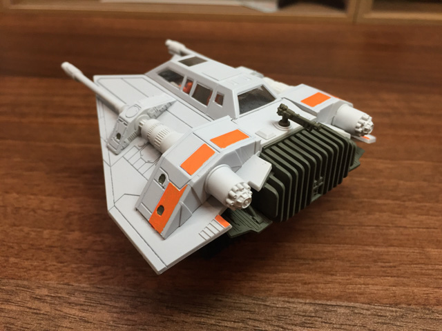

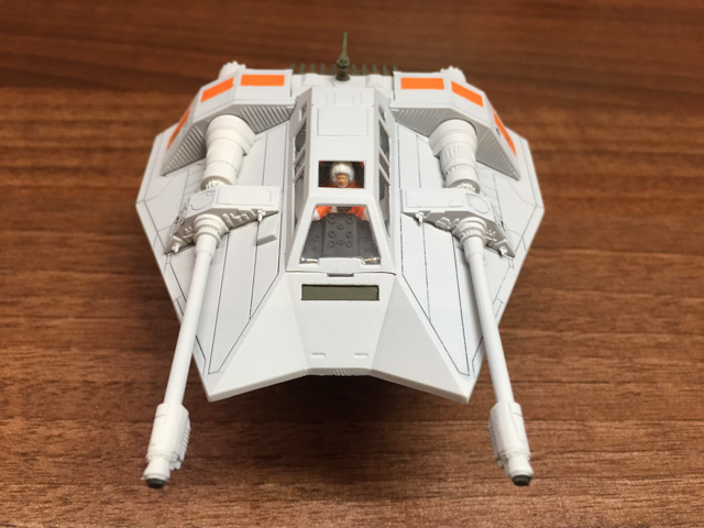

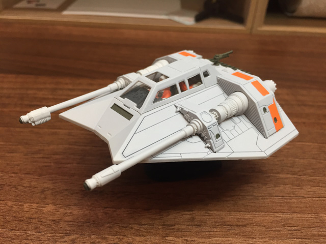

I have never completed a plastic model kit before, I made them as a kid but the finish was just a very sloppy coating of the paints that came with them.
I have a few good models stashed up but before I wreck them with sloppy skills I bought a few cheap kits to practice on.
This small snow speeder is my first attempt at painting a model and applying decals so I haven't tried anything fancy. reading through the how too's I have learned I need to spray the model in gloss to give the decals a better surface.
but what I can't find out is should I have the clear parts of the model covered so they don't get gloss on them, have I jumped the gun by removing the masking I put on for painting?
Thanks
Barry

You will need to cover the glass areas, as they will become frosted with the varnish. You have done an excellent job so far, I would probably go for a matt varnish or a satin varnish as gloss will be too shiny for the model unless you intend to dull it down afterwards.

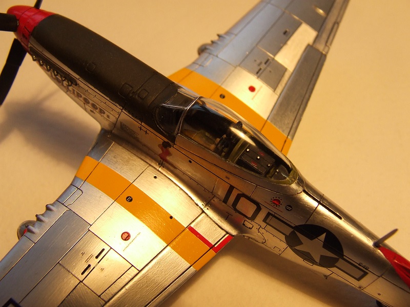

#7 Posted : 14 October 2017 13:44:15
Tomick wrote:
Also some clear coats slide off clear parts, personally I would no go there unless it was to use Future to improve the clarity.
A valid point Tom, as you say, not all clear coats are the same and Johnsons Klear is always better in my opinion. Cool ThumpUp
roymattblack wrote:
... and dries satin unless you apply heavy or several coats. Then it's a real gloss ...
I usually polish the transparency to a good shine first using 'Micro-Mesh' up to 12000 grit then wipe clean and apply just two thin coats of Johnsons Klear by brush, buffing with a lint free cloth after each coat. You are right Roy, it will dry fairly satin if you don't buff it but being a polish it will come up to a good shine and dramatically increases the clarity of the transparency if buffed up properly. As you say Roy, a great product and great value too!
You can see the shine and clarity in the photo below of my Airfix 1:72 Mustang P-51D.
ModelMania attached the following image(s):
