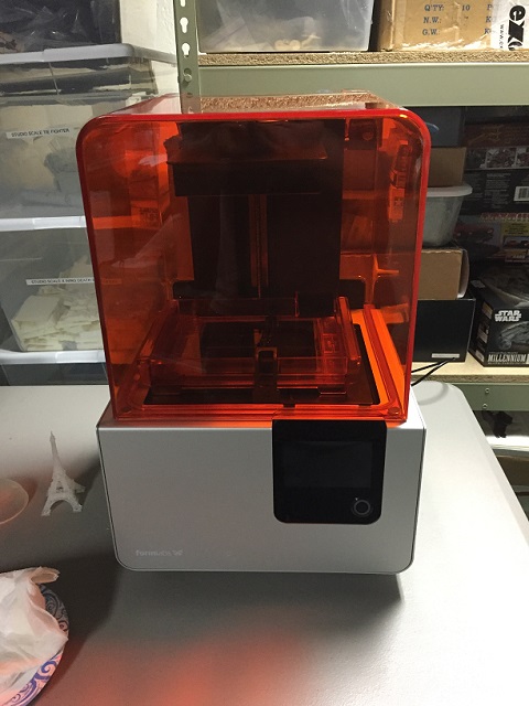

Here are some pics and a video of the Form2 SLA 3D printer.This printer is very different from the extruded filament printer that is the most popular 3d printer at the moment. SLA printers use a laser to "draw" a pattern in a pool of liquid resin .The resin has photometric properties and when exposed to the lasers light beam it turns into a solid.The print is laid down layer by later just like an extruded filament printer.The part is printed upside down.
The print based is lowered into the tank of resin.The laser beam draws the layer of the print on the floor of the tank.The tank then slides sideways to peel the layer of cured resin off the tank and then the print bed raises the part out of the resin. A slider wipes across the tank to redistribute the resin and then the print bed is lowered back into the resin for the next layer to be printed.
The major benefit of these printers over extruded filament printers is they can produce very high resolution parts with very fine detail and overhangs.
The drawbacks of these printers is they are much more expensive than filament printers, they print quite slowly compared to filament printers and the resin is pretty expensive to buy ($150 for 2 l of resin ).

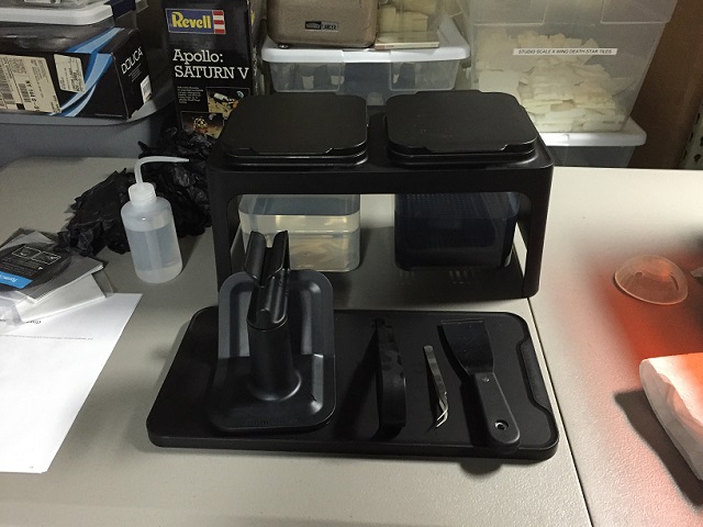

The other drawback is the printed parts need some post print processing to be usable.Right out of the printer the parts are covered in uncured resin so they are very sticky to the touch.In fact you really shouldnt touch them at all. You have to soak the parts in isopropyl alcohol baths to remove the excess resin.

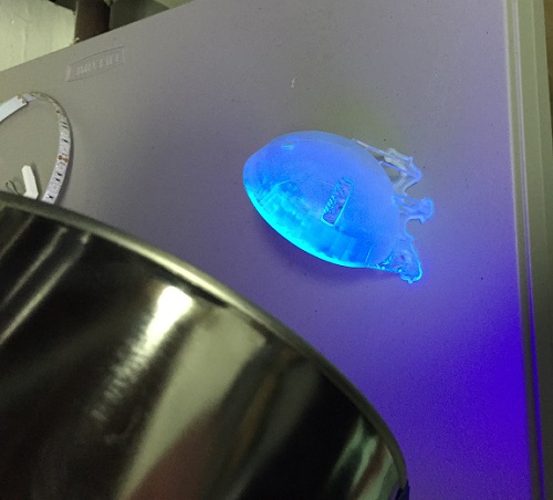

Once the parts are dry you also need to expose them to UV light for the resin to completely cure.You can put the parts outside for an hour or use a curing oven.I made my own curing oven for less than $50.

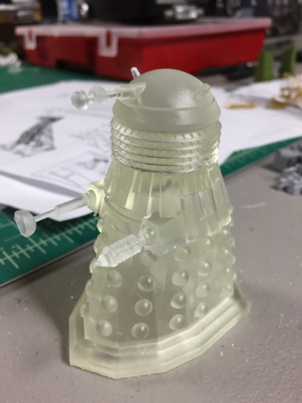

The Form2 is one of the best SLA printers available for the home market.It can produce parts similar to SLA printers costing tens and even hundreds of thousands of dollars. It has a small build volume 6 inches by 6 inches by 7 inches) but the quality of the parts is just amazing.
Here is a video showing the Form2 in action.It is printing the head of a large scale Dalek that I am building.There are also some pictures of the lights that go on the Daleks head that I printed and a full Dalek model. For reference the full Dalek model is about 3 inches tall and took 7 hours to print.

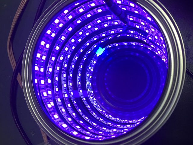

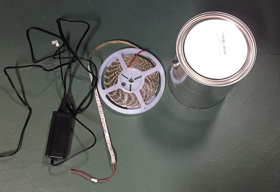

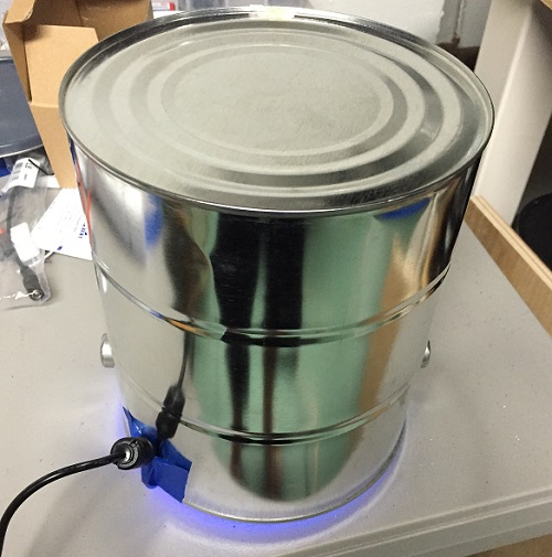

Since the resin requires UV light to fully cure ideally you should use a curing oven to expose the print to UV light.Putting the part in sunlight would work, but in my part of the world it gets pretty cold in the winter so I figure a curing oven would be a good idea.Formlabs makes one, but it is really expensive.Some people use curing stations that are used on nail salons, but these are pretty small. I found a blog where a guy made his own curing oven.So I gave it a try and for $50 I made my own curing oven.
Here are some pictures

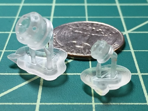

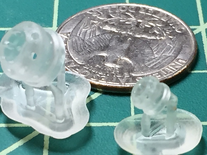

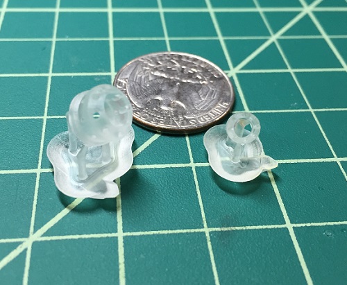

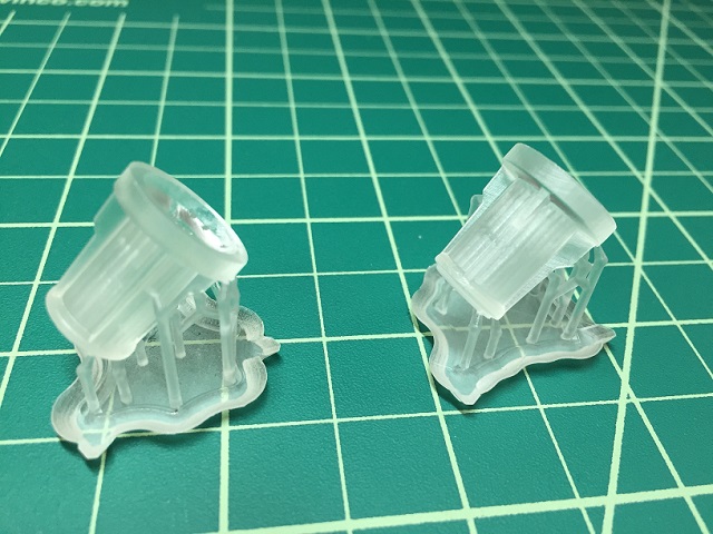

So the Form2 continues to amaze me with its printing ability.Here are some parts for a Dalek gun that I am printing.These parts are TINY and are perfectly printed.Just jaw dropping.
