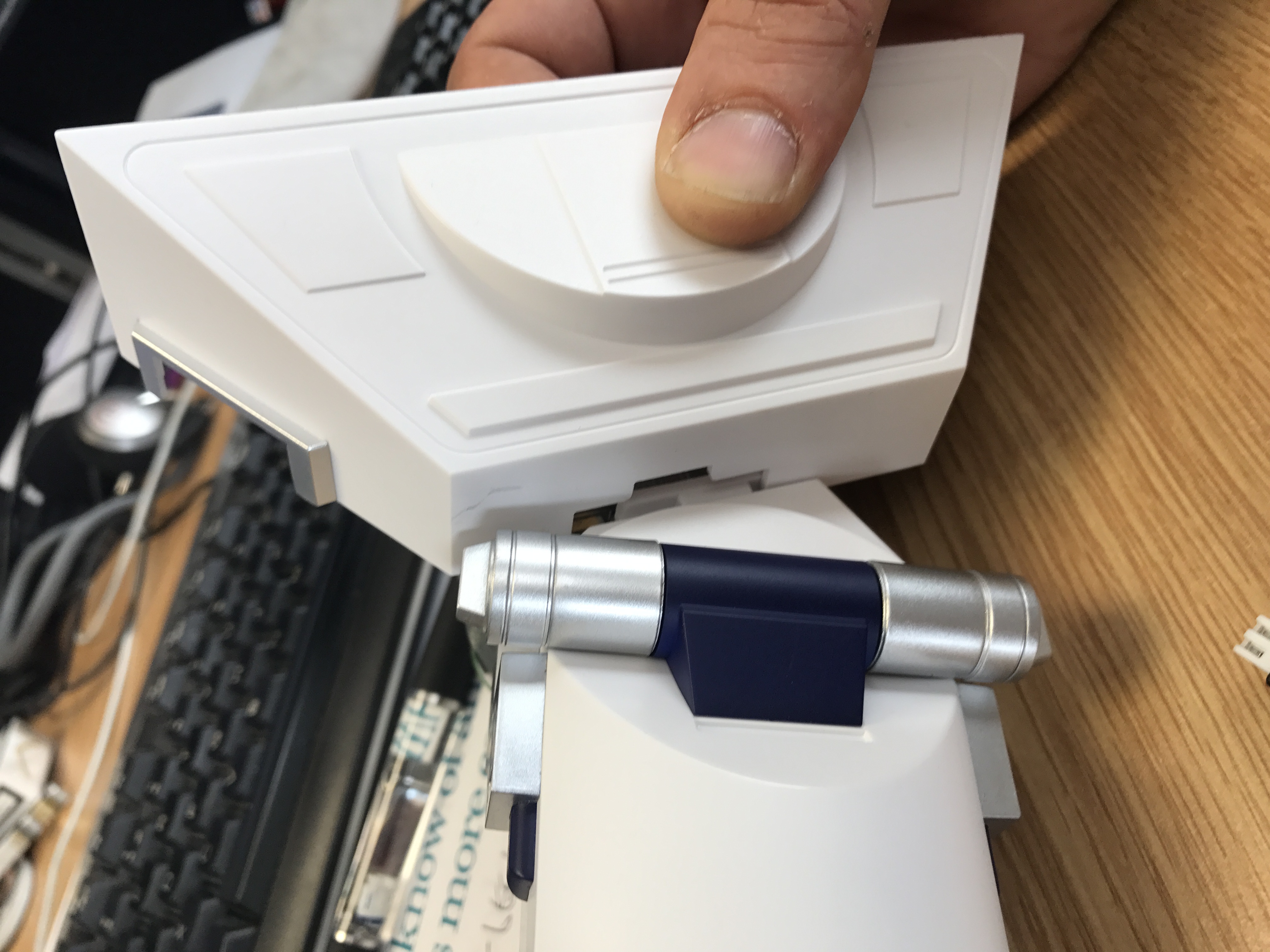

I have been trying for a couple of hours now, but the foot casing I got in Issue 31 doesn't fit the leg!
have I been sent the wrong part?

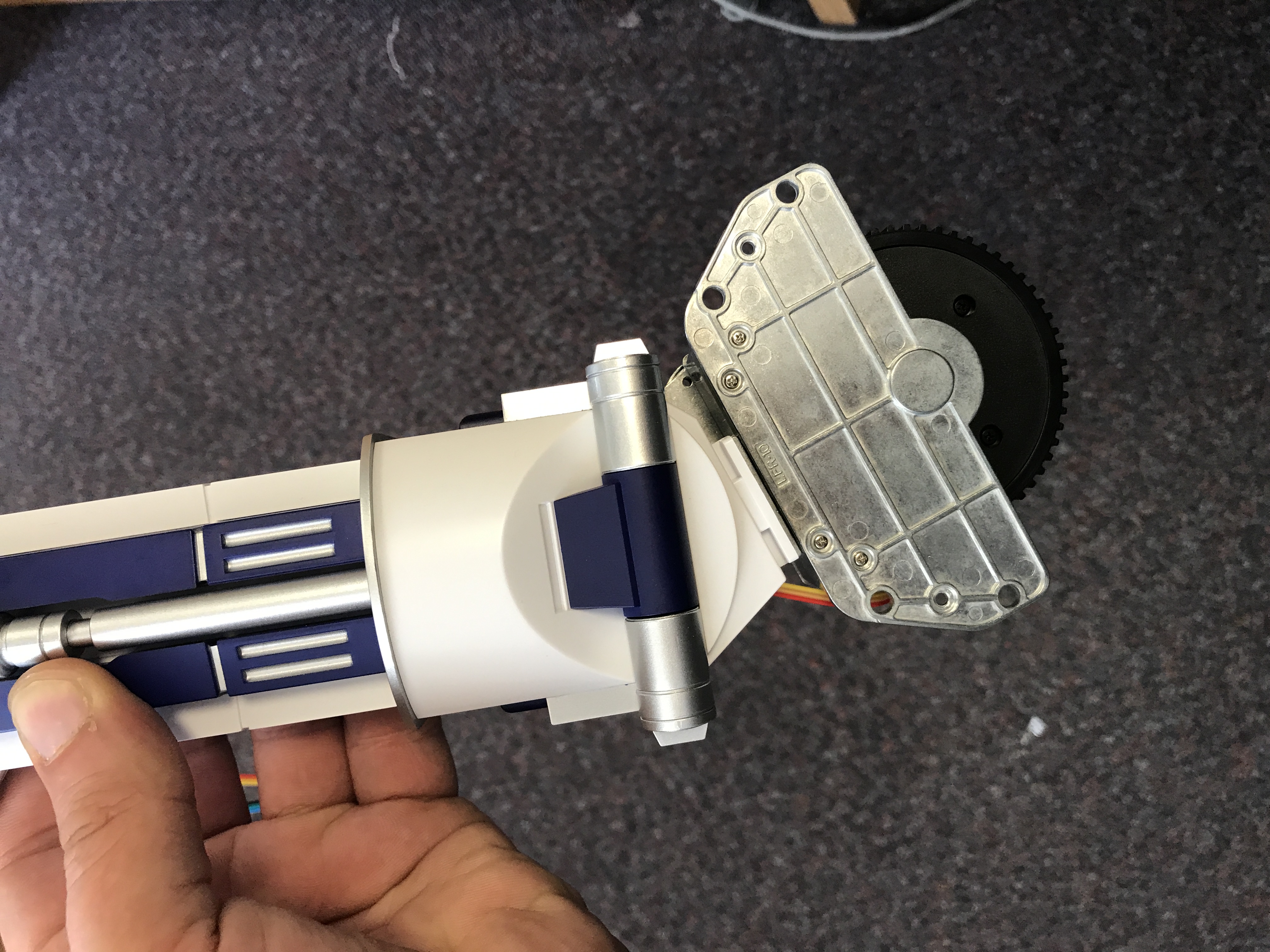

#3 Posted : 22 August 2017 14:54:43
Rank: Beginner Level 1
Joined: 22/08/2017
Posts: 9
Points: 33
Location: Jersey, Channel Islands
please see attached picture
#4 Posted : 22 August 2017 15:20:28
I have checked your parts with mine, and they are exactly the same.
Please refer to the official build diary, and see if that helps.
http://forum.model-space...spx?g=posts&t=23476
Let me know how you get on

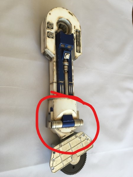

#6 Posted : 22 August 2017 15:28:35
Joined: 22/08/2017
Posts: 9
Points: 33
well it's not fitting for me and I have checked the video
see the attached picture
wrong case.jpg (2,469kb) downloaded 64 time(s).

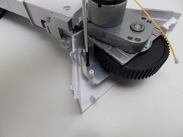

#7 Posted : 22 August 2017 15:32:26
The 4 lugs fit into the metal frame.
Please see picture

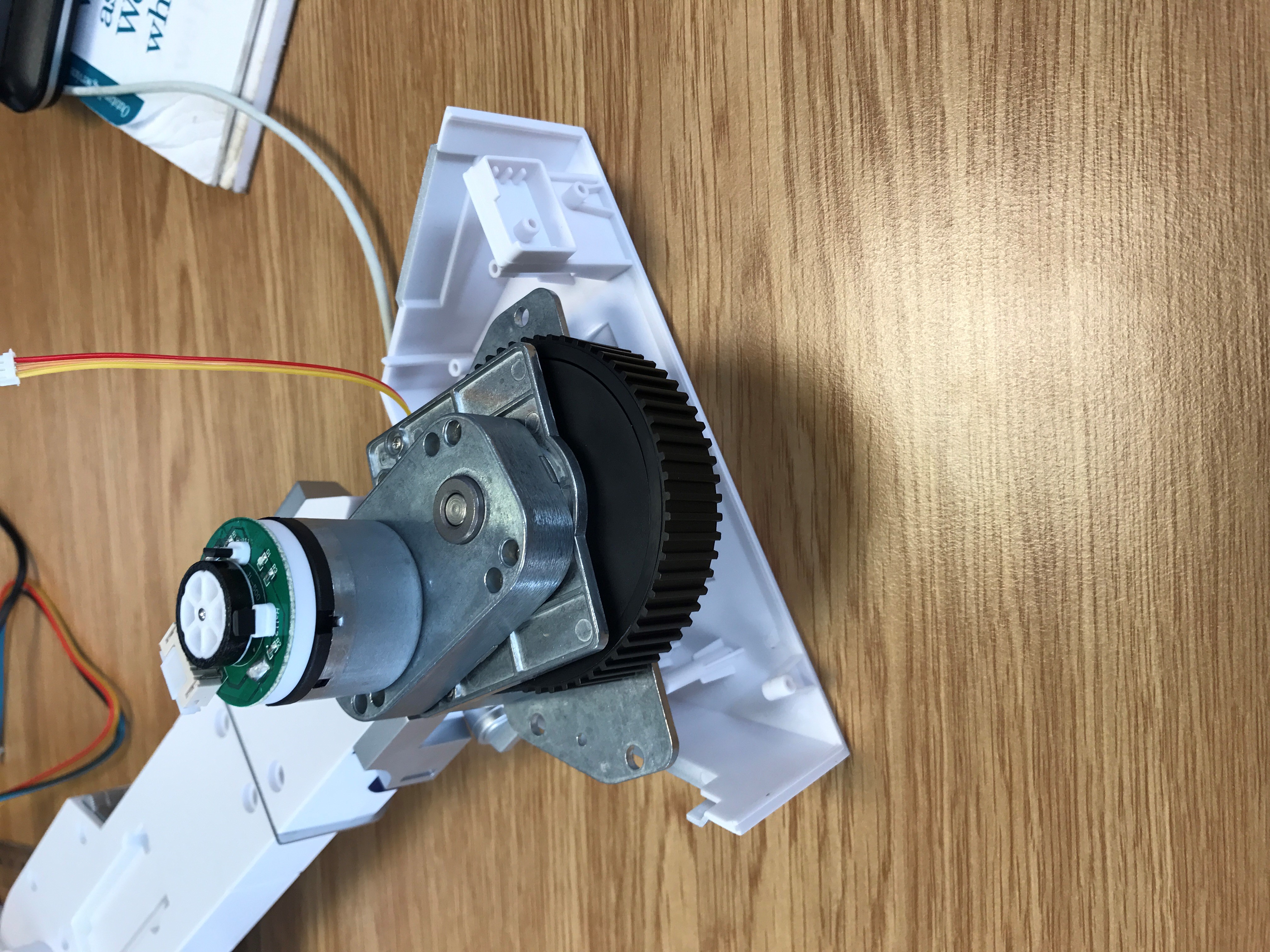

#8 Posted : 22 August 2017 15:39:16
Joined: 22/08/2017
Posts: 9
Points: 33
if I line up the lugs this is what happens (in picture)

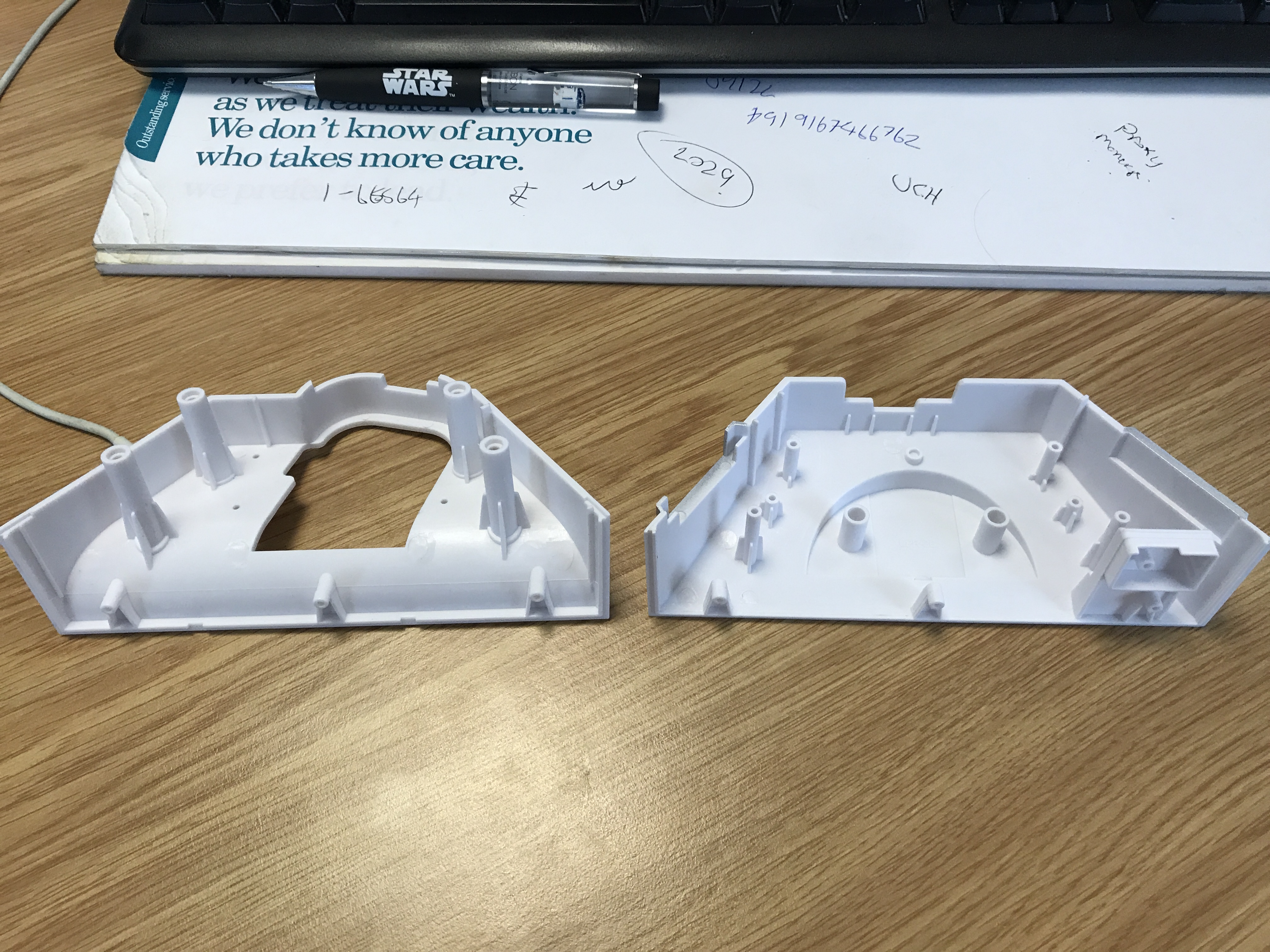

#10 Posted : 22 August 2017 15:51:02
Joined: 22/08/2017
Posts: 9
Points: 33
there are part numbers inside the casings LPR-34 & LPR-36, I wonder if I have been sent the other legs casings

#14 Posted : 22 August 2017 16:09:23
Okay, that looks the same too.
When you fit the foot piece in place, is it the bottom section of the let that doesn't clip in?
PirateZebedee
#15 Posted : 22 August 2017 16:16:20
Joined: 22/08/2017
Posts: 9
Points: 33
Correct and the clip area is off to the side

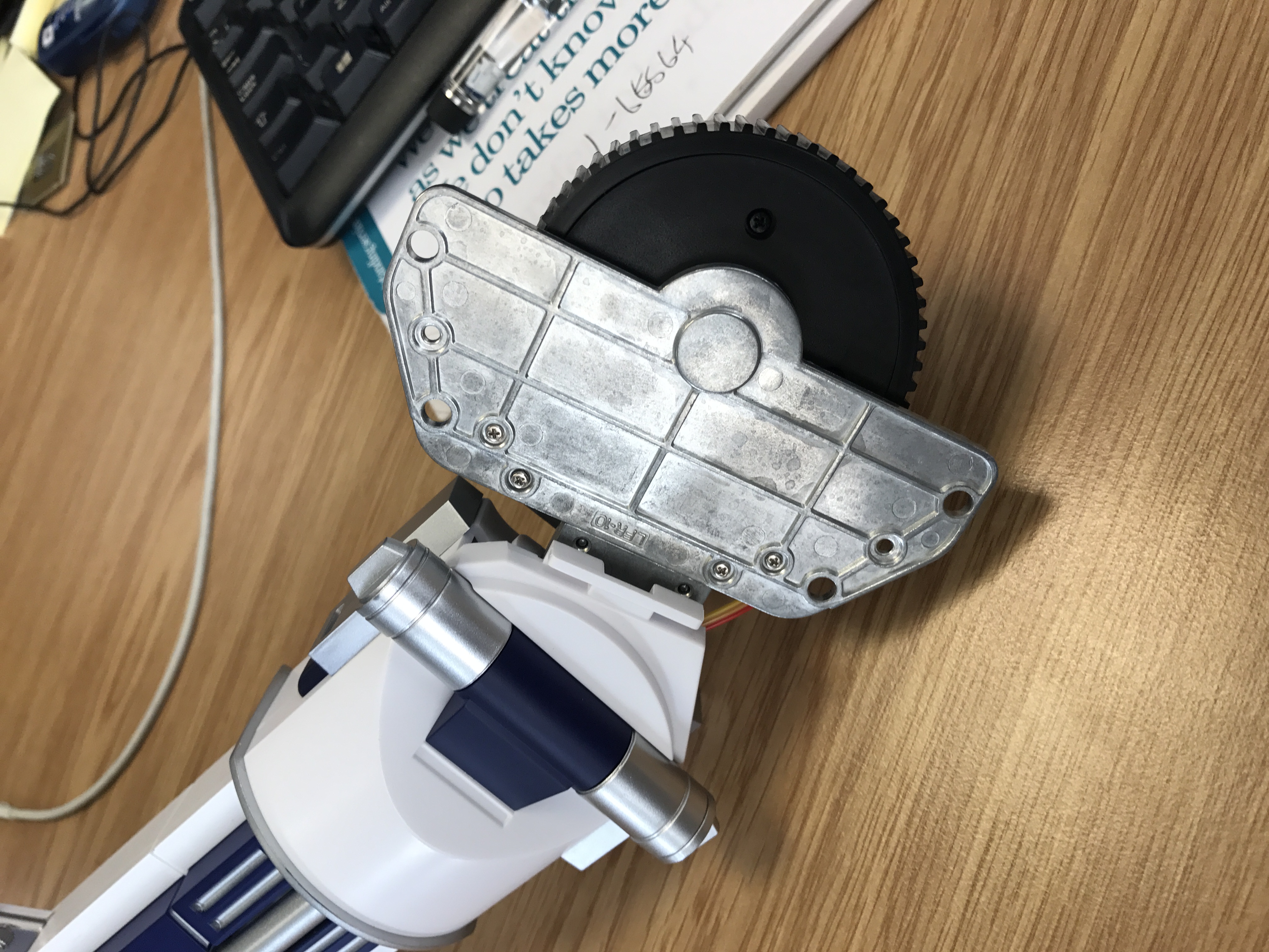

#16 Posted : 22 August 2017 16:27:34
Can you unscrew the metal plate off and see whether that could be the problem (LFR 10) and see if it can align differently?
Looking at your picture, the plate seems to be to the right more, rather than the left.
If you look at my picture you will see what I mean.
#17 Posted : 22 August 2017 19:29:22
Hi
Having looked at your pictures more closely, the metal support plate is sitting too far to the right. It maybe that you have installed the mounting plate the wrong way round in issue 21, this would push the support plate too far to the right.

#18 Posted : 23 August 2017 09:30:07
Joined: 22/08/2017
Posts: 9
Points: 33
I had part LFR-05 located on the wrong side of the leg strut, I have swapped it all around and everything is good, thanks for the help
