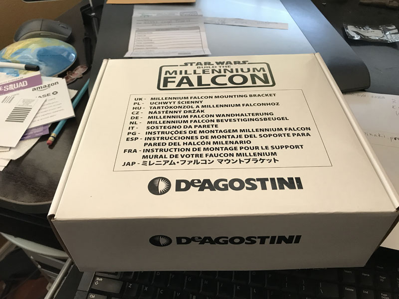

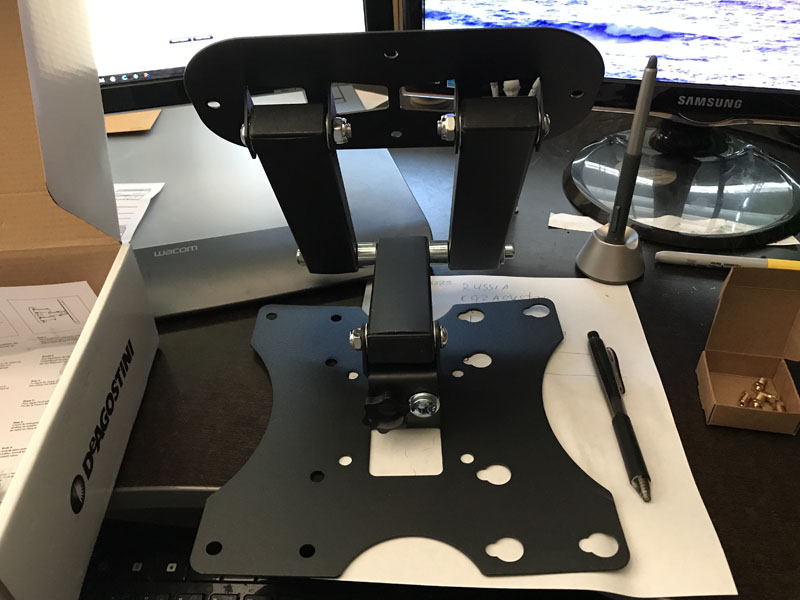

wish i knew more about what the wall mount does - is is adjustable ?
i have some vesa monitor mounts that can move around, if this wall mount is only to "hang it on the wall" i might see if i can modify it some....

figuerres wrote:
well i think i now have the fiber and led lights all ordered ....
next month i have to start ordering the shapeways parts to upgrade the cockpit, main cabin and the engine area....
i like the look of the falcon3dparts.com engine grills , but some of the other addons at shapeways are harder to pick, i think 308 bits has some complete sets of stuff....
the mod that i saw here for the ramp looks really nice also...
I will try to take some photos this evening of the mount so you can see what it looks like.
Make things as simple as possible but not simpler... - Albert Einstein

Ok so here a the photos that I said I would take, sorry I took so long.
Bill-Devine attached the following image(s):
