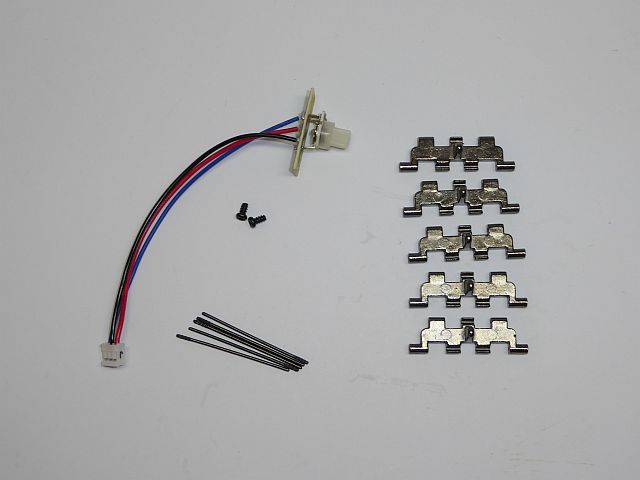

Stage 45
Contains: Volume Control, Screws, Treads, Pins
For this stage, you will need all the parts received, as well as the lower hull, and the track.
The volume control will fit to the lower hull, which you will receive with Stage 60, so keep these parts to one side for the moment, and refer back to this stage when you fit them.
The switches, volume control and speaker will be housed inside the lower hull.
Place the volume control onto the two posts in the hull. Tighten one of the screws into one hole. Tighten the second screw into the other hole. Remember that circuit boards are fragile, so be very careful and do not over tighten the screws.
To adjust the volume, insert a flat-head screwdriver into the groove in the control, visible from the outside of the lower hull. Turn the control to the left and right to adjust.

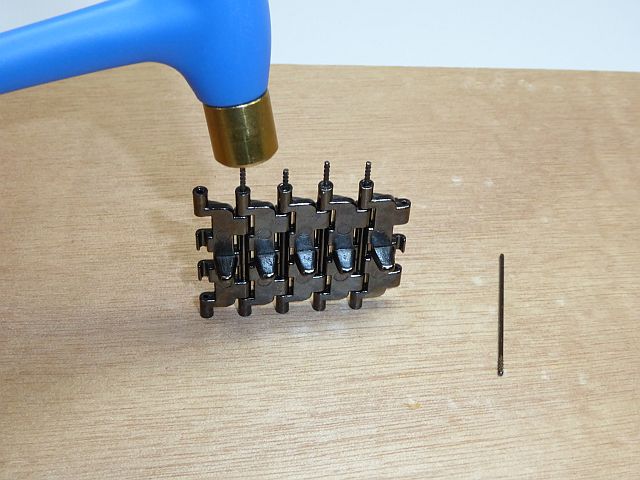

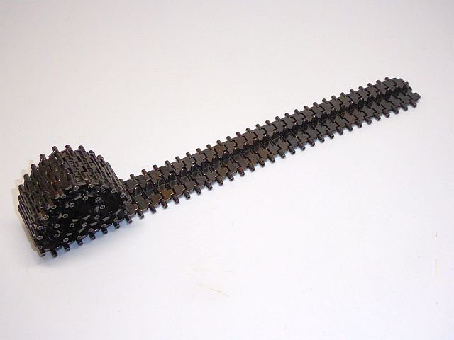

Engage one of the treads with the end of your track assembly. Push a pin into the aligned holes. Place the track on its side, and hammer the pin into place. Then repeat for the rest of the treads.
This stage is now complete. Store the assembly and any remaining parts in a Stage labelled bag.

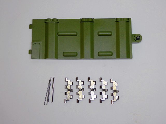

Stage 46
Contains: Battery Compartment Panel, Treads, PINs
For this stage, you will need all the parts received, as well as the lower hull and your track assembly.
The battery compartment panel will fit to the lower hull, which you will receive with Stage 60, so keep these parts to one side for the moment, and refer back to this stage when you fit them.
Locate the battery box compartment on the underside of the lower hull, and test-fit the battery compartment panel in it.
At one end of the panel are two hinge tabs and at the other end is a tab with a fixing screw. Insert the two hinge tabs into the two holes in the hull.
Lower the other end of the panel into place and push the screw through the hole.
Then turn the lower hull over and insert the nut into the hexagonal recess. Hold the nut in place and tighten the screw.

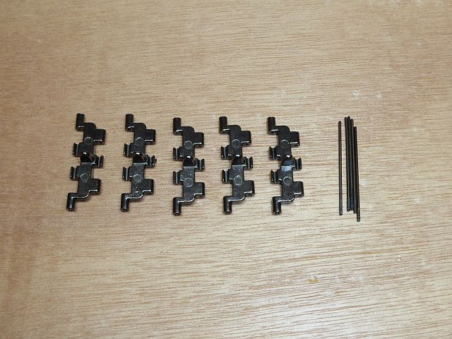

Engage one of the new treads with the end of your track assembly. Push a pin through the aligned holes. Place the track on its side on your wooden board and hammer the pin into place. Attach the rest of the treads in the same way.

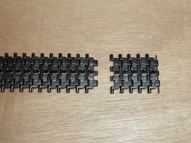

Combine the five new treads and secure with pins. Connect the new section with the rest of the track. Turn the track on its side and hammer all of the pins into place.

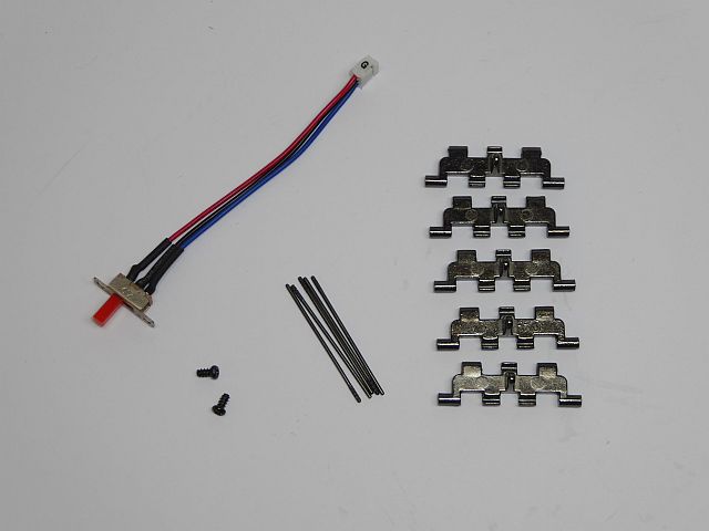

Stage 48

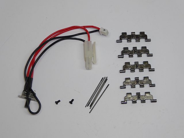

Contains: Power Switch, Screws, Treads, PINs
For this stage, you will need all the parts received, as well as the lower hull, and your track assembly.
The power switch will fit to the lower hull, which you will receive with Stage 60, so keep these parts to one side for the moment, and refer back to this stage when you fit them.
Insert the power switch into the slot located next to the Wi-Fi control switch. Insert one of the screws into the hole at the side of the switch. Carefully half-tighten the screw into place. Insert the second screw into the other hole. Tighten the screw into place, then go back and tighten the first screw fully.
Pass the connector into the hole in the battery box.
Combine the treads received with this stage. Take the new section and engage it with the end of your existing track. Place the track on its side and hammer the pins into place.

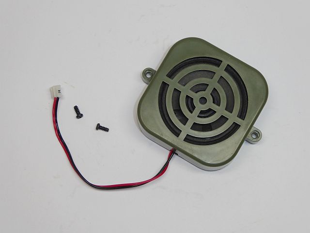

Contains: Speaker, Screws
For this stage, you will need the parts received, some unassembled treads and pins, as well as the lower hull and the track.
The speaker will fit to the lower hull, which you will receive with Stage 60, so keep these parts to one side for the moment, and refer back to this stage when you fit them.
Fit the two holes at the sides of the speaker onto the two posts on the lower hull. Insert one of the screws into the hole. Half-tighten the screw into the hole. Insert the second screw into the hole on the other side of the speaker. Tighten the screw into place, then go back and tighten the first one fully.
Combine the five treads and pins to create a new section of track. Engage the new section with the rest of the track, and then pass a pin through the aligned holes. Place the track on its side, and hammer the pins into place.
