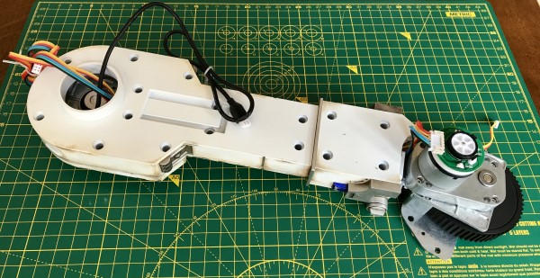

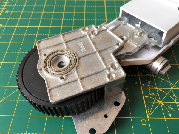

Here, I have fixed the wheel on R2 leg with the back assembly plate.

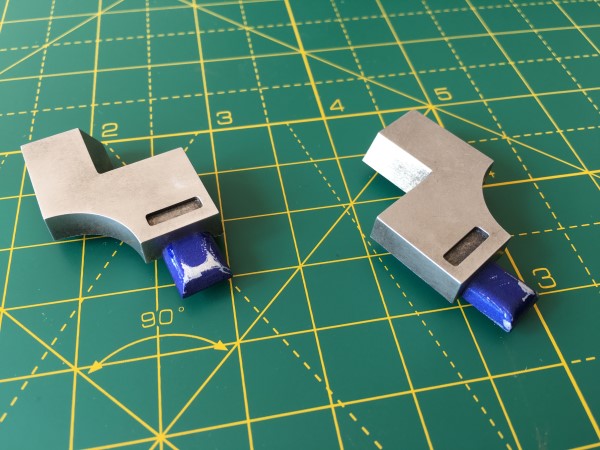

#2 Posted : 02 July 2017 13:04:31

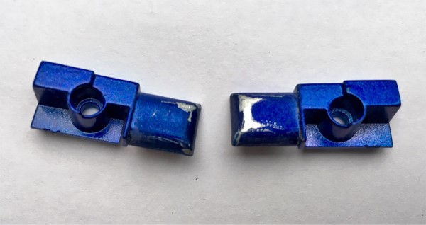

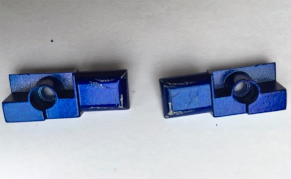

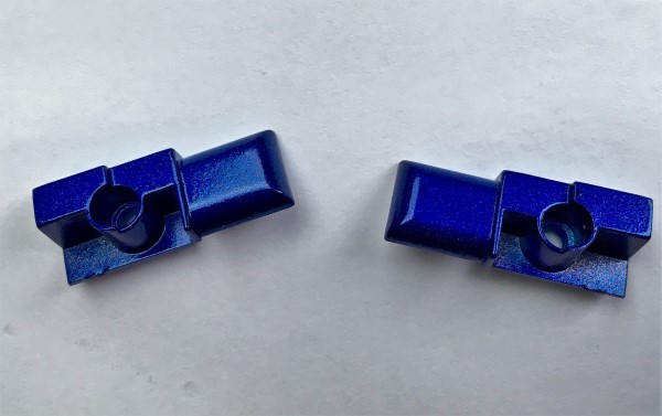

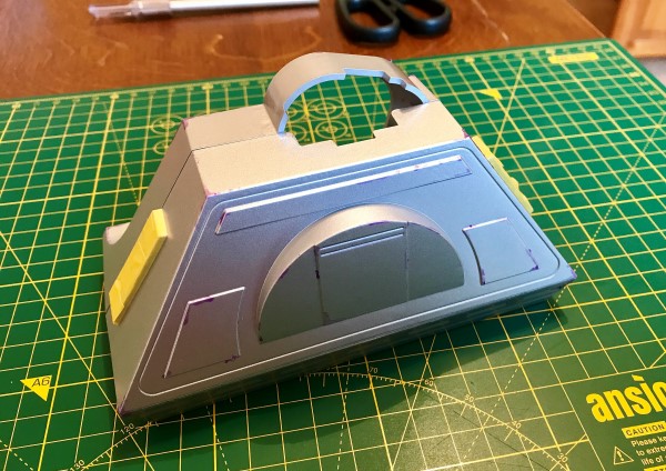

Next, I have scraped the blue paint in the leg side pieces to weather them. Then I used wet and dry sand paper to dull the overall gloss down and then fitted them to the silver parts.

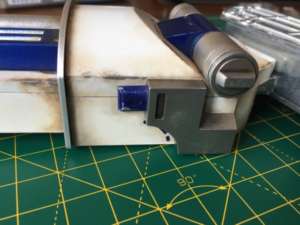

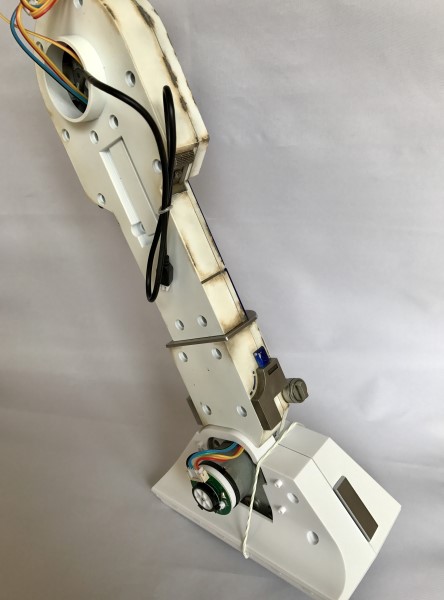

#4 Posted : 02 July 2017 13:10:48

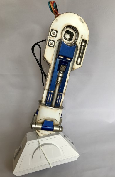

And here it is all temporary assembled to give you an idea of how it all looks and beginning to take shape.

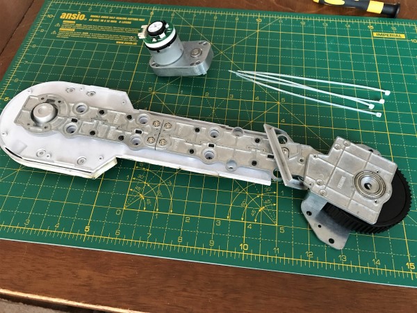

#6 Posted : 30 July 2017 10:24:22

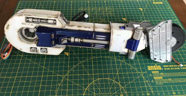

Here, you can see that I have dissembled the leg parts so I can fit the motor and attach the cables through the center of the leg. The last pictures shows the leg assembly screwed together with all parts in place. Note. When connecting the cable to the motor, leave enough slack at that end, as when you assemble the lower leg parts it will pull down the cable.

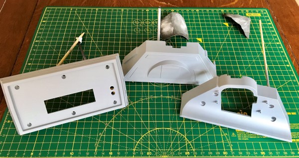

#7 Posted : 30 July 2017 10:29:42
Next, was the bottom leg assembly. As you can see here, I have dry fitted this part to give some idea how it will look.

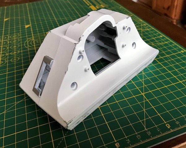

#8 Posted : 30 July 2017 10:34:46

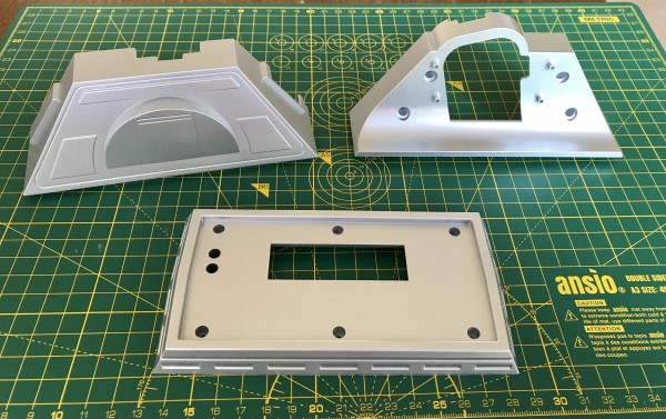

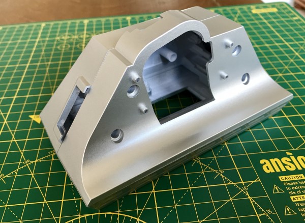

Now to start the painting and weathering process. This area will be heavily weathered around the lower section. First, as shown in these pictures I have lightly sanded the parts and then primed. This will be left for a time to fully harden before applying the silver paint.

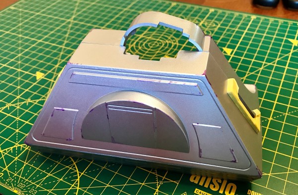

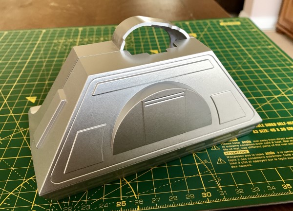

#9 Posted : 30 July 2017 20:42:52
Now the primer has had enough time to dry fully, I have now painted it silver. Here, you can see it after a couple of hours drying, enough to handle, but I will now leave this for at least 48 hours before masking areas off and using Maskol.

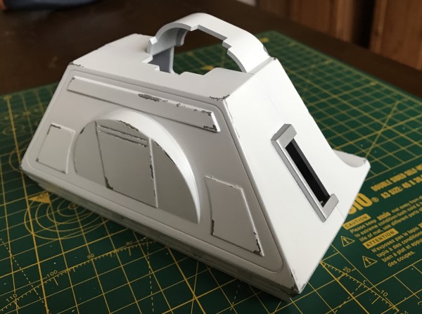

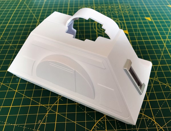

#10 Posted : 02 August 2017 22:28:43
Now that the silver paint has fully dried, the next stage is to mask off the areas I want to stay silver and lightly bush on some Humbrol Maskol for the chipped effects. Once this has been done I will then paint it with the satin white as with previous parts.

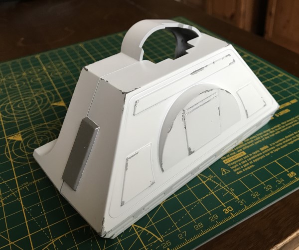

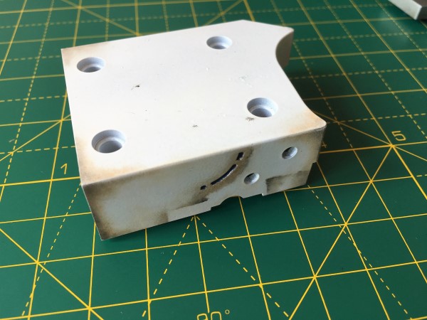

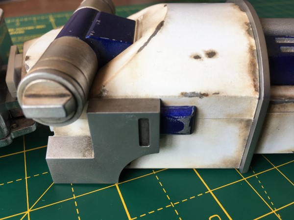

#11 Posted : 02 August 2017 22:33:40

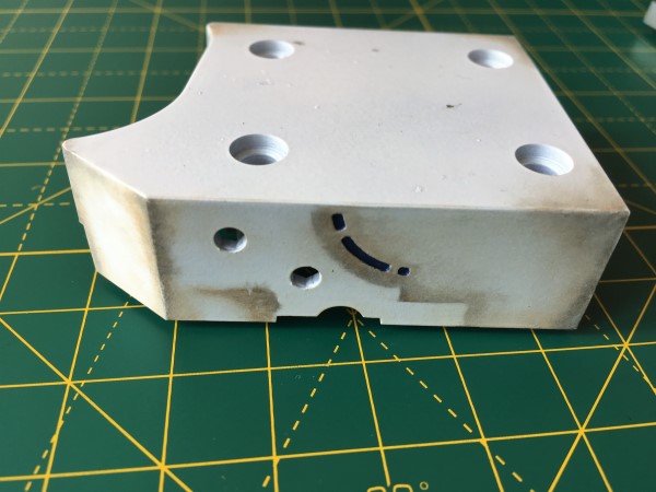

Here, you can see the parts painted white and the maskol rubbed off to give the worn chipped effect in certain areas.
Next, I will be weathering this part with oils, once I have the complete foot assembly.
