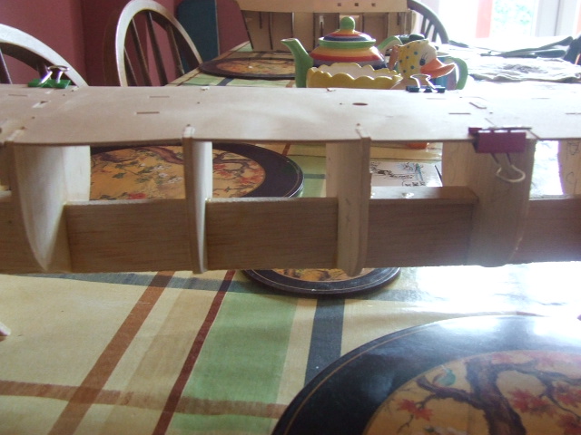

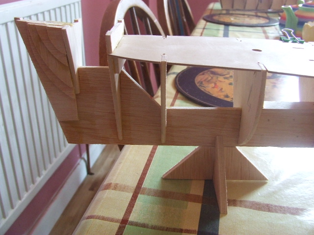

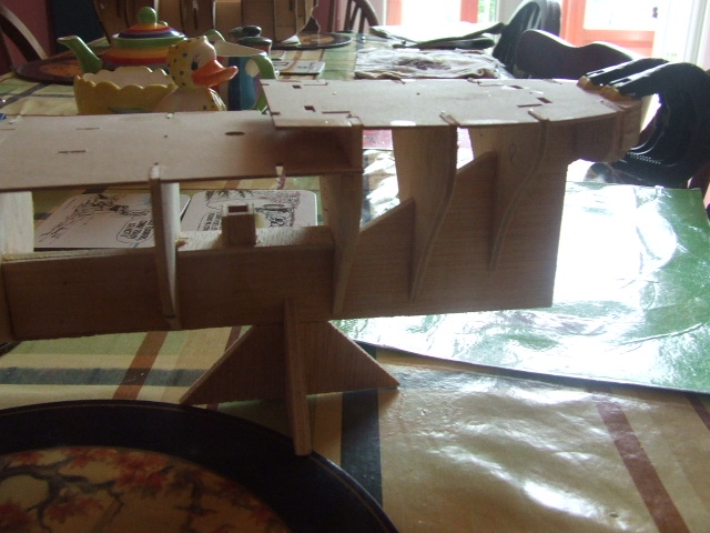

Here are the initial pictures, just the basic framework.
saintsman123 attached the following image(s):

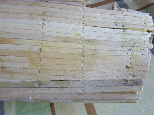

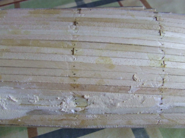

Attached are some pics of the awful planking I've done.
I know that you should not blame your tools, but the wood is really bad.

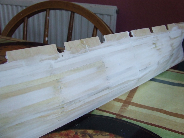

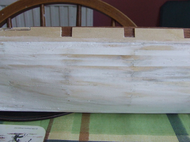

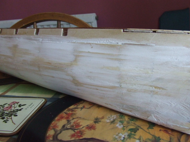

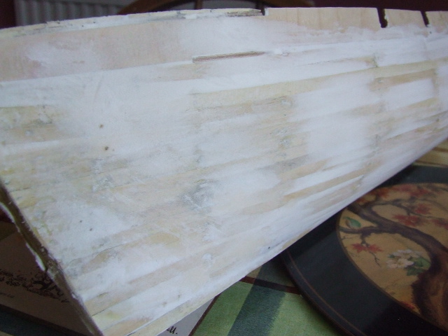

After filling and sanding, the hull does not look too bad now, I found it very difficult to sand as the wood was so flexible between the ribs so some areas were starting to get too thin while the flexible pieces were not sanded at all.
I came up with a solution, no doubt the experts could have helped, but wanted to try something myself. I used diluted PVA tocover the whole hull, left it to dry, then covered the hull with very fine filler, once that was dry the whole boat felt much firmer, so that allowed me to sand it down much better. As can be seen in the pictures.

The pics show the hull having been roughly sanded, the fine sanding worked really well.
I then put the veneer on the top half, using a fast setting white glue that I got from CMB, this worked well if you allowed it to go tacky before putting on the thin planks, they did not curl up, and allowed me just to wash any excess of both my hands and the model without leaving any residue.
