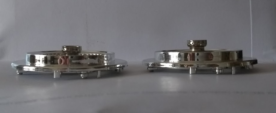

I haven't received Issue 5 yet but after Issue 4 there is a big difference between the position of the hub and the rim with 2 and 3 spoke crossover. I know this because I built the wheel with 2 crossovers and then went to Tesco and bought another copy of Issue 4 and finally, after much aggro and frustration, managed to build it correctly. So I can now compare a right and a wrong wheel side-by-side. Apart from strength issues there could be problems in store with the wheel offset being wrong, i.e. rubbing or touching where it's not supposed to. The model could end up looking very wrong. This assumes you will be able to get the final layer of spokes to fit correctly in between the first two layers if you don't have the spoke positions correct.

From what I've now been able to see of my own wheel, the problem will actually be one of fit.
With issue 4 done as in the magazine - 3 crossing points - the spokes from issue 5 go through the diamond pattern in the middle.
If you have settled on the 2 crossing points in issue 4, then the pattern of spokes from issue 5 will not settle correctly either.
From the troubles I had, the 2 crossing points configuration means the hub had quite a bit of lateral (sideways) movement to it. I don't know if this will 'help' or not in the fitting of the issue 5 spokes, but I don't think it's a good idea to carry on working on the wheel if you can't get the correct 3-point cross required. However, the 3 cross spoke pattern holds the hub rigid. (I still had problems with issue 5 due to the part of the hub the issue 5 spokes go through being able to turn 360° on the rest of the hub - which hole do I start on, and I kept choosing the wrong one!)
The problem I had seemed to be the final angle in the spokes. The one where I noticed the problem, the spoke was digging into the plastic because it was only making contact at the very end of the spoke. The bend where it went through the plastic was being pulled further away from the hub by the angle of the bend.
I used a pair of pliers to make the angle of the final bend (the one you push through the hub FIRST and holds the spoke against the outer wheel) closer to 90°. At this point the hub was not pulled as far off-centre, and I was able to get the opposite spoke - also having had the angle changed - into where it was supposed to be. Then I could work half way between these two points and do the same. Once all 4 directions were attached, the rest just fell into place as I got into the rhythm of adjusting the angles, then installing the spoke. Adjusting the next one and installing it, until I had finished.

Further to my last message, below are incorrect (left) and correct (right) wheels.
A big difference which could bite later on in the model...
Paul

Thanks Paul. It is clear to me that the incorrect one, sitting 'lower' as it does, means that even if you can get the issue 5 spokes through, they will not stay there. With the issue 4 components in the correct place, the issue 5 spokes are a tight fit. There for I believe an incorrect issue 4 will bite sooner, rather than later.
