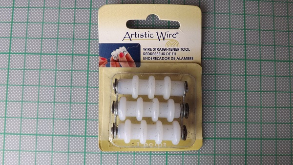

While looking through eBay recently I came across an item in the craft tools section called “Wire Straightener Tool “by Artistic Wire.
Always being one for a gadget I sent off for one to see what benefits it might give me.
What was interesting is that the item is stamped up “made in India” but mine came all the way from China – quite amazing to think how small the world has now become, and how international trade now is.

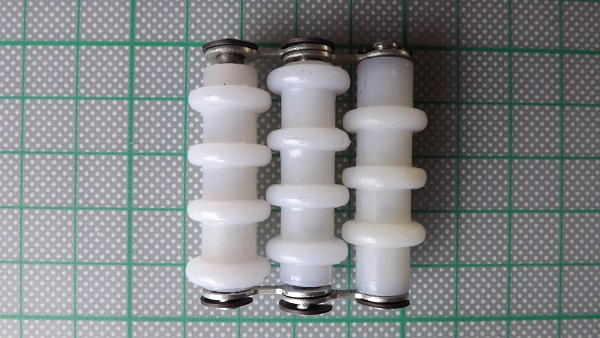

The tool is listed as being made of Nylon and I was not convinced that would be a strong enough plastic to work with wire. However, on receiving the item I thought at first the plastic parts might in fact be made of white glass as they are extremely hard and have that look and feel of white glass.
They are in fact plastic but a very, very hard type.

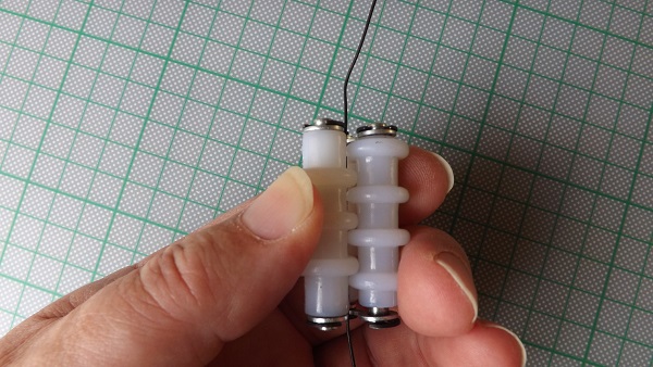

The tool is hinged and forms a triangle shape that you clamp the wire between before pulling it through and straightening it.

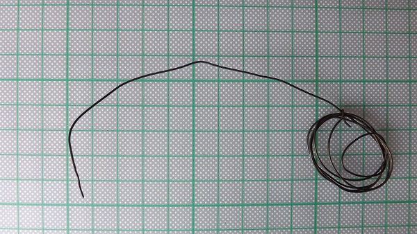

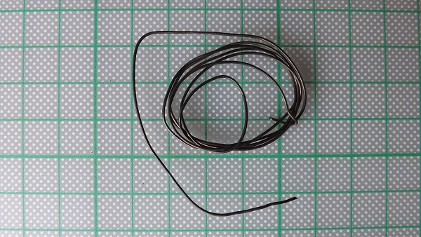

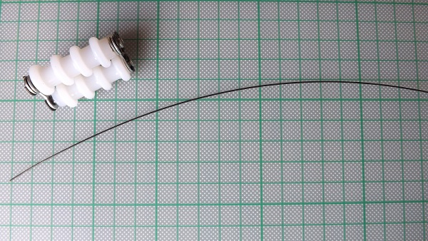

In the example pictures below I have taken a coil of Steel wire from a Model Expo kit and this is extremely hard and I cannot think this would be easy the straighten and remove the kinks from.
Having pulled the wire through the tool 3 times you can see that it does indeed straighten and remove kinks in the wire.

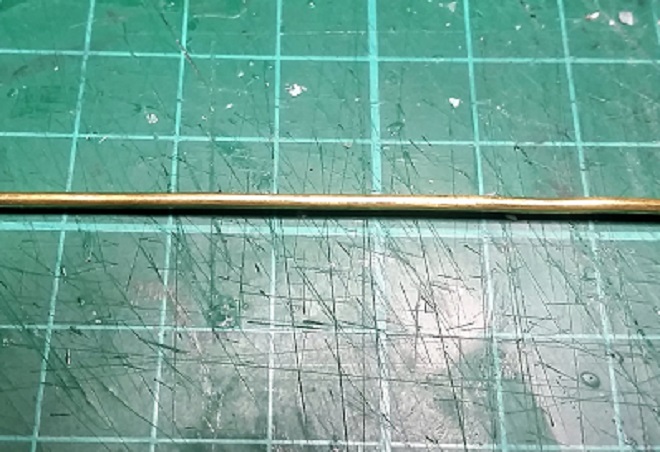

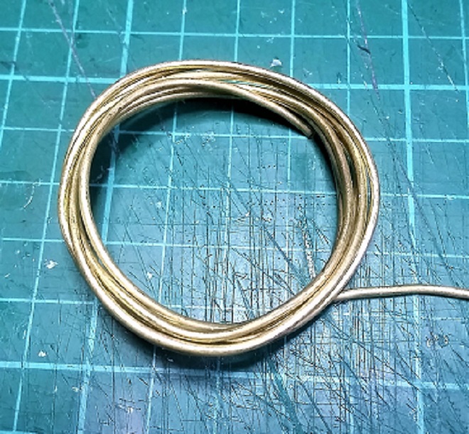

Following on from Tony`s test of this tool, I tried mine on some 1.5mm brass wire.
This wire came fairly tightly coiled. (See pic 1), but after some firm pressure and about ten times through the tool the end result seems quite impressive. (See pic 2)
This tool I think was designed for use in jewelry making, (where finer wire is used), but performed well on some thicker modellers wire.
