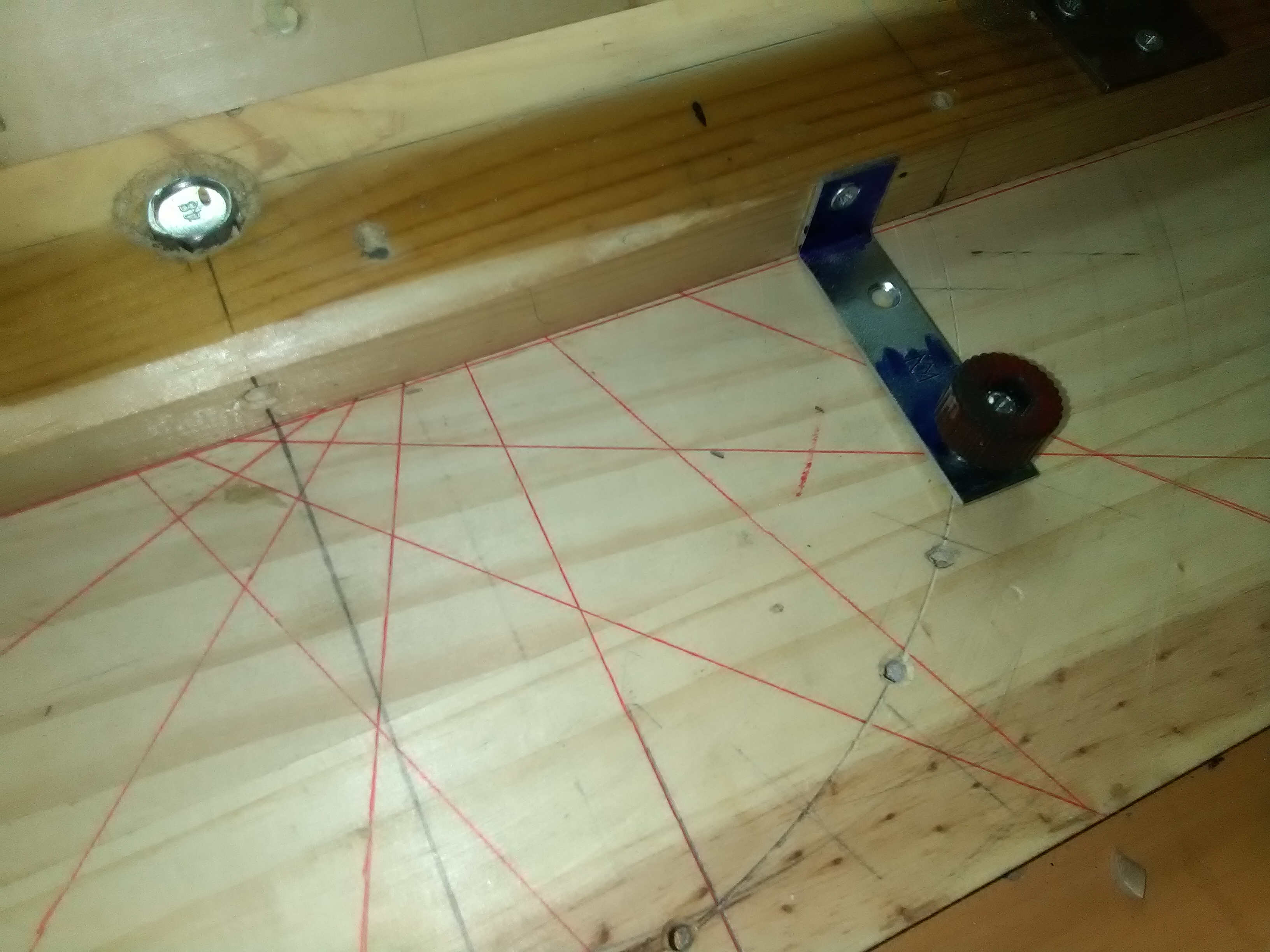

hi

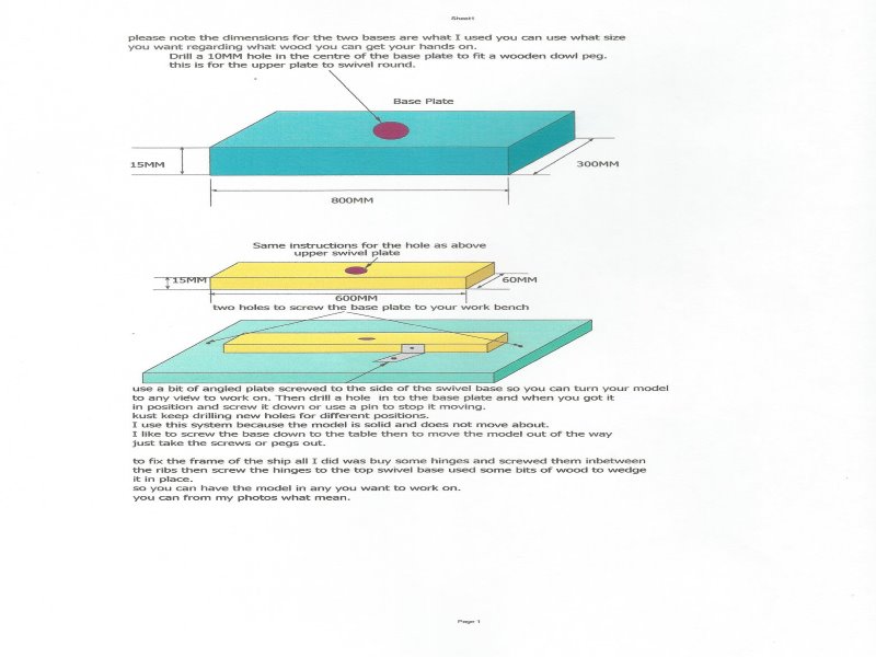

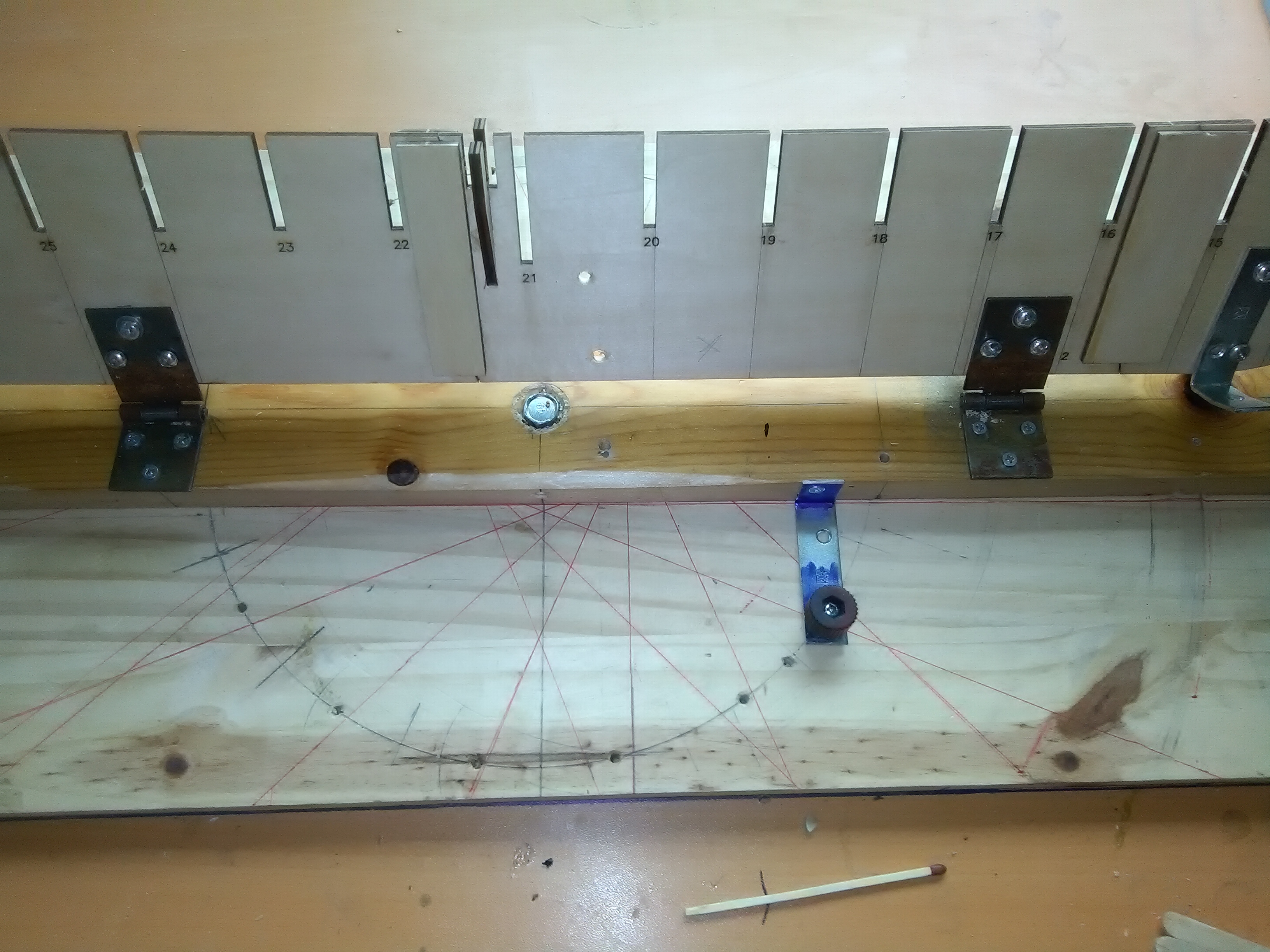

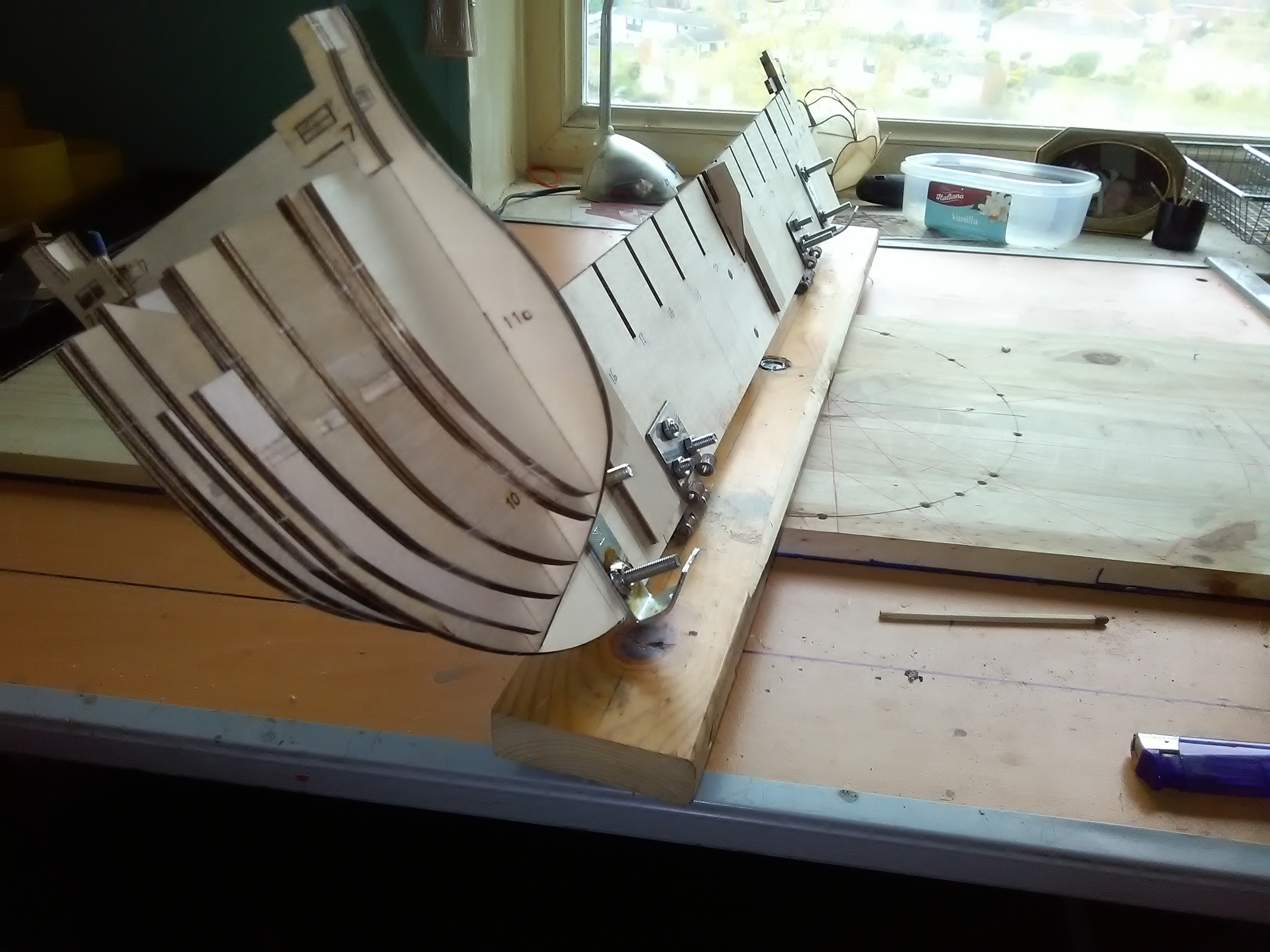

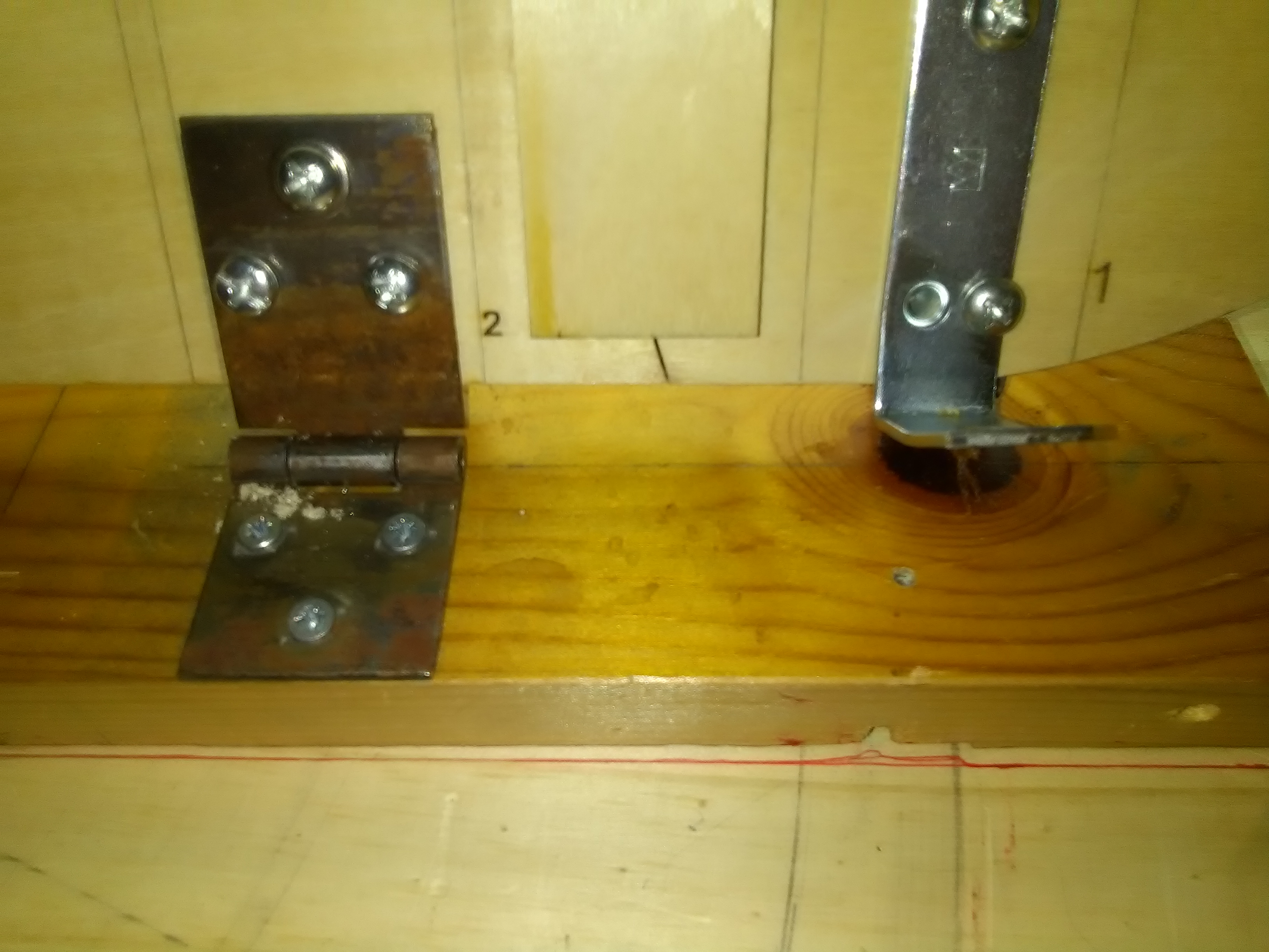

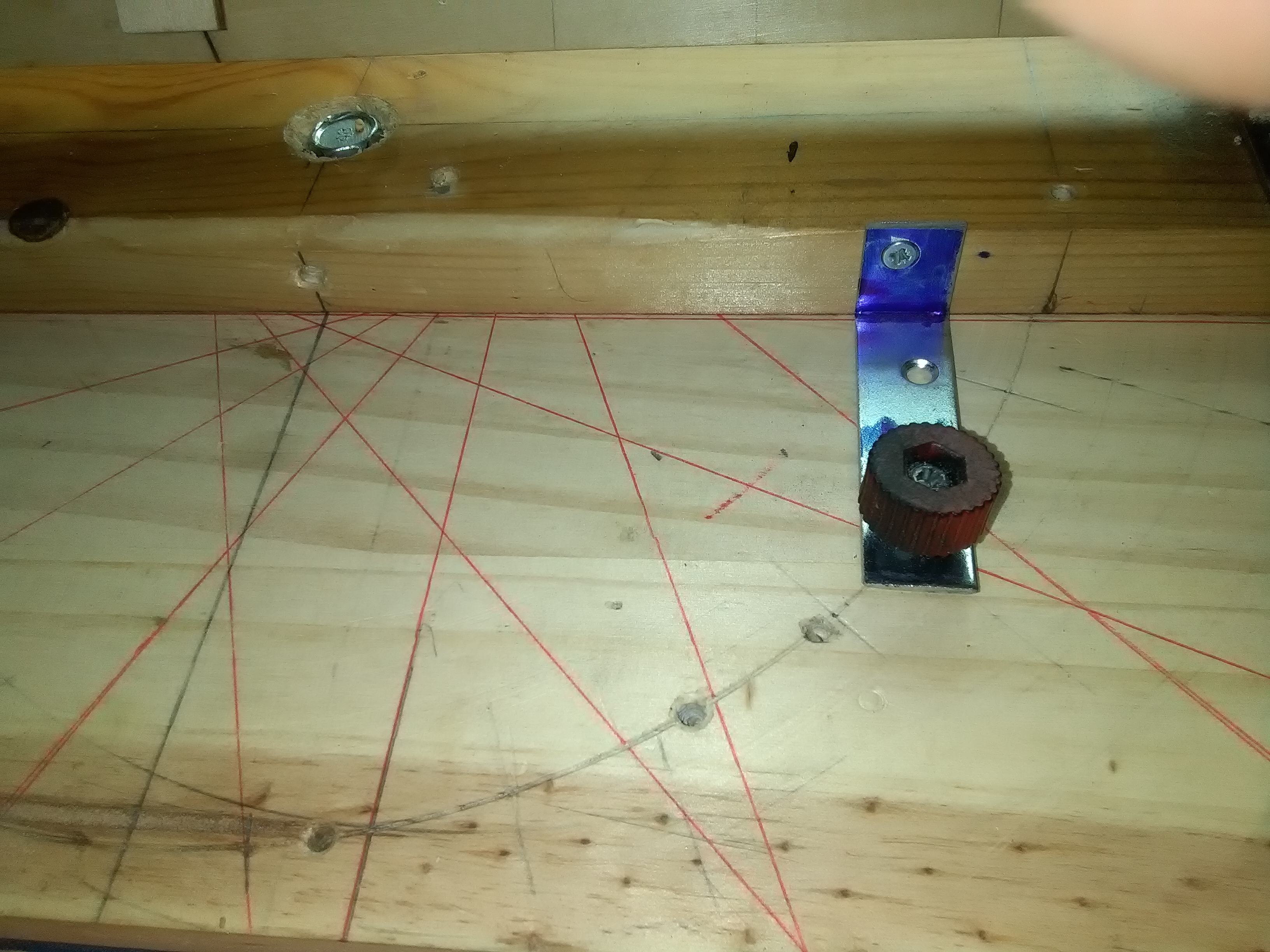

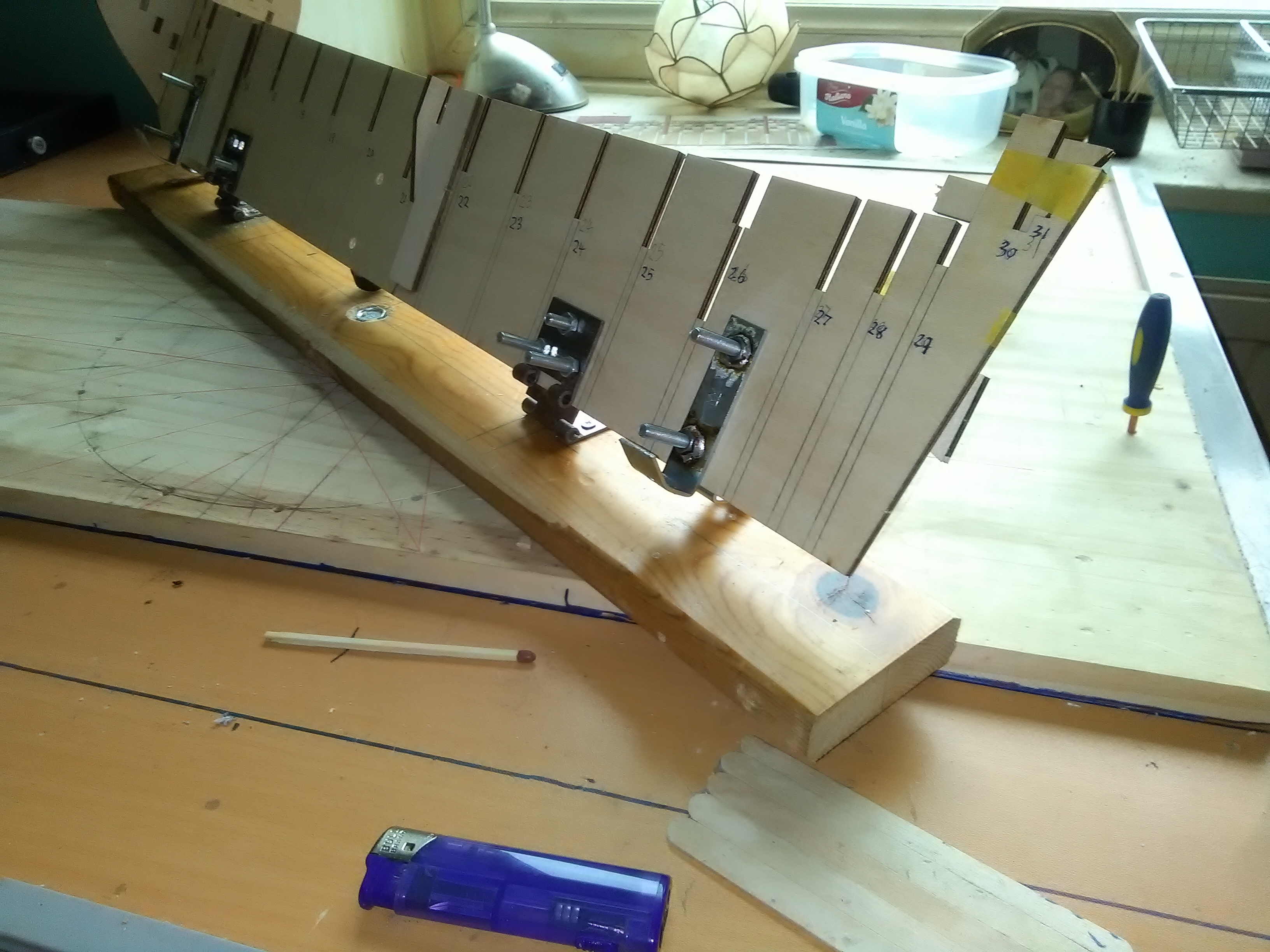

I've made a jig for the victory.
its fitted on a turn table and tilts both ways,
its got a peg system to lock it down in any position you want.
if any body wants me to put some pics and sizes let me know.
I've made some other tools and jigs.

hello jase.
yes no problems will make some drawings and pics for you.
here some pics for you.

hello guys.
think I got the hang of showing pics new cus they was too big in size.
going use 800x600 pixels size.
horatio62 attached the following image(s):

hello again every one.
just finished doing a drawing of my jig I use.
hope it helps you make easier to build the victory.
it works for me.
