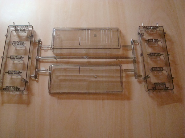

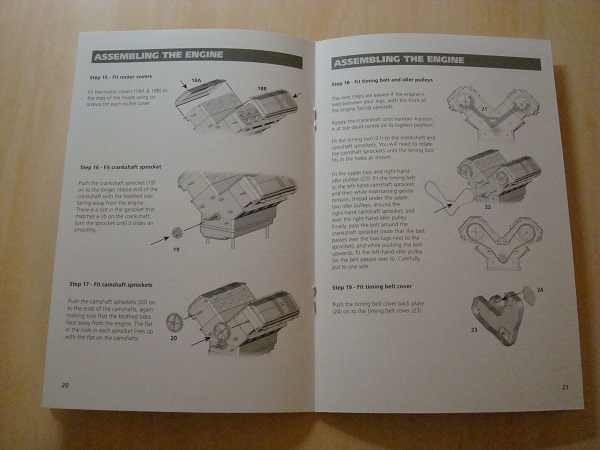

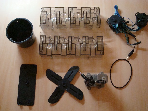

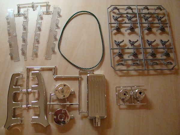

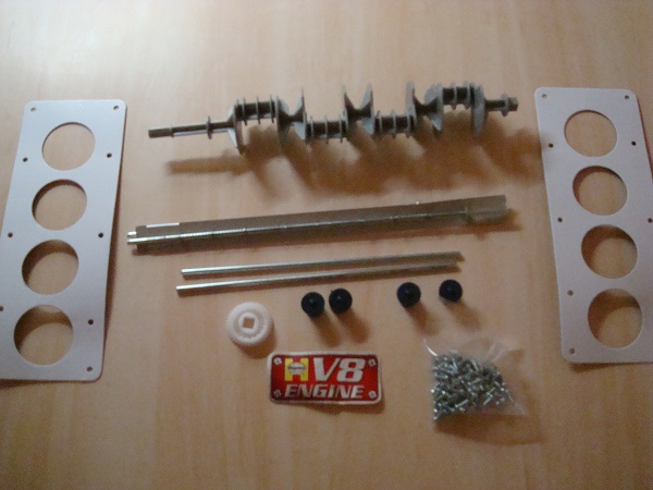

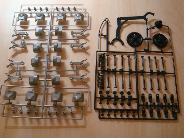

The rest of the pictures show all the parts that come with the kit, 250 parts plus a lot of screws and even a screwdriver. The instructions are all exploded diagrams and are very precise and much better than most kit instructions.

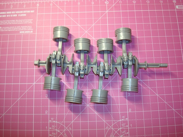

PICTURE 1 - Shows the parts needed for the first stage of the assembly. All the screws in this kit are of the same size and length.
Crankshaft - Connecting Rods - Gudgeon Pins - Piston Halves - Cylinder Blcock.

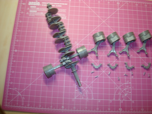

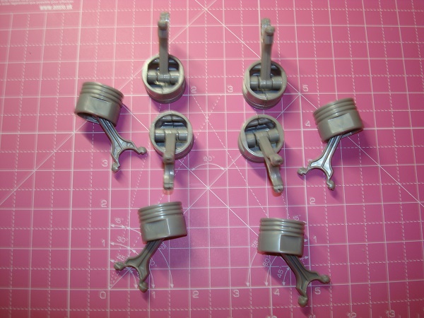

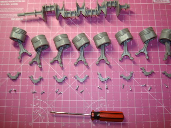

PICTURE 2 - Shows the eight piston halves and connecting rods assembled.
Procedure of assembly - First insert one of the gudgeon pins into the large hole in one side of a piston half. Then push the small end of the con rod over the gudgeon pin, then join the two piston halves together, making sure they are butted together firmly. Repeat this procedure for all the other pistons as shown in picture two.

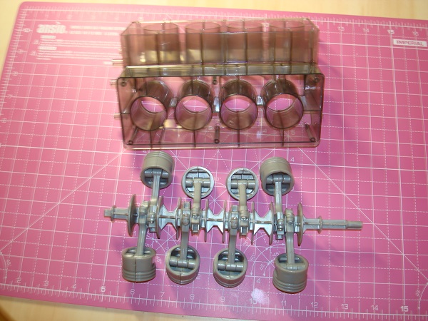

PICTURE 3 - Showing - Crankshaft - Assembled Pistons - Big End Bearing Caps and fixing screws.
Next, is to fit the big end bearing caps to the Connecting Rods, each with two screws.

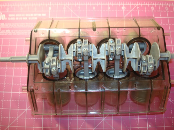

PICTURE 4 - Shows two of the Big Ends attached to the Crankshaft with the big end bearing caps having been screwed together.

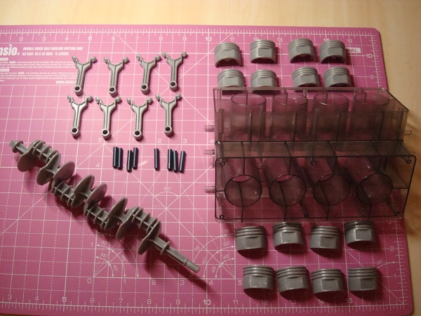

PICTURE 5 - Shows all the Big Ends attached to the Crankshaft.

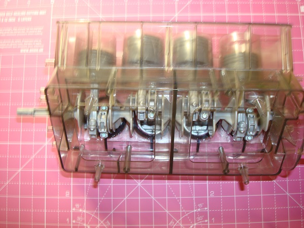

The next stage of the assembly, is to insert the pistons into their respective cylinders. The four cylinders on the left side of the Block, are slightly off set to the cylinders on the right side of the Block, so you can only insert the Pistons into the Block, one way. It can be a bit tricky trying to get them inserted but with a bit of jiggling, you will soon have it done.
At this stage, once the pistons have been inserted, you have to keep the whole assembly so that the crankshaft is facing upwards, until it is held in place with the Lower Crankcase piece.

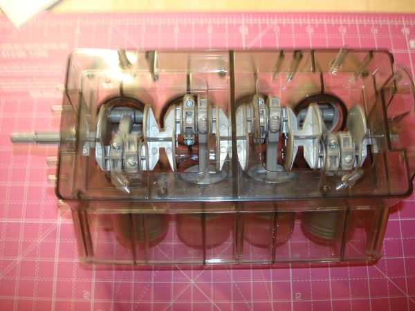

PICTURE 7 - Shows the underside of the Cylinder Block and the Crankshaft with all the Pistons inserted into the Cylinders.
PICTURE 8 - This shows the top of the Cylinders after inserting the Pistons.
Next we have to attach the Lower Crankcase to the bottom of the Cylinder Block, which will hold the Crankshaft in place. Again this will only fit one way. Once you have aligned the parts, insert four screws into the holes from inside the top end of the Cylinder Block (the holes for the screws are placed on a 45 degree angle) and screw the parts together.
PICTURE 9 - This shows the lower Crankcase having been attached to the lower end of the Cylinder Block and held in position with four screws. This forms the main Crankshaft Bearings, in which the crankshaft rotates. Once done, you can test the rotation of the Crankshaft, by turning the ends of the Crankshaft and see the Pistons moving up and down in the Cylinders.

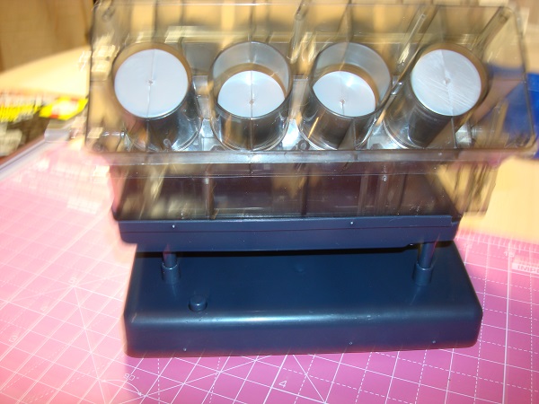

PICTURE 11 - Shows the Sump (left) and the Base Stand. Notice the holes for the speaker where the sound will come from when running the completed engine. The button on the lower right of the Base, is the starter button to start the engine. The battery box is located underneath the base and takes three AA batteries (not supplied).
PICTURE 12 - Shows the Sump in place on top of the Base Stand. The sump has four legs attached to the bottom of it, and these sit in the four holes in the base and are held in place with four screws, which are screwed from underneath the base plate, again it can only be fitted one way.
Before screwing the Sump to the Base, we first have to attach the Sump to the bottom of the Lower Crankcase, again with four screws. Once this is done we can then attach the whole assembly to the Base Stand. You now have the Engine Block firmly held on its base, ready to continue with the rest of the build.
PICTURE 13 - Shows the Cylinder Block, Lower Crankcase attached to the Sump, all in place on top of the Base Stand.
