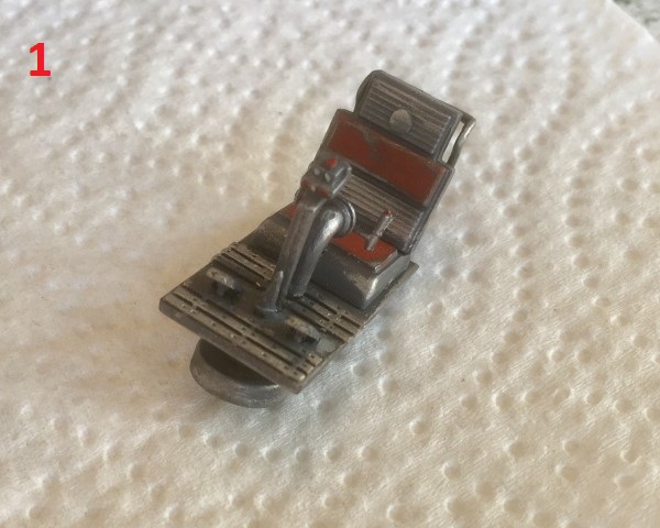

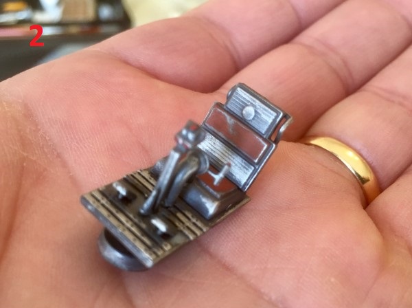

Next, I am building the gunners section. I have started with the gunner chair. I painted the parts with Humbrol Metalcote steel, polished and then painted the seats and applied some etched brass grills to give it a little more detail.

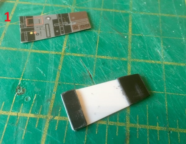

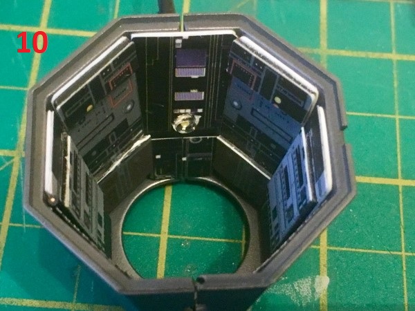

#3 Posted : 05 February 2017 19:01:03

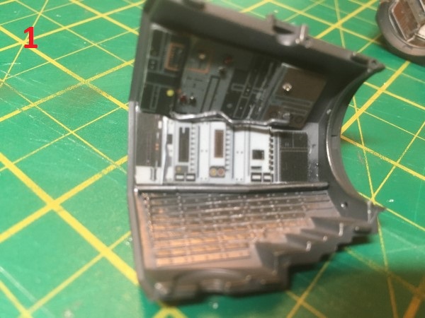

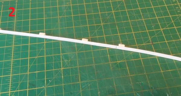

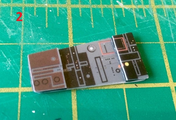

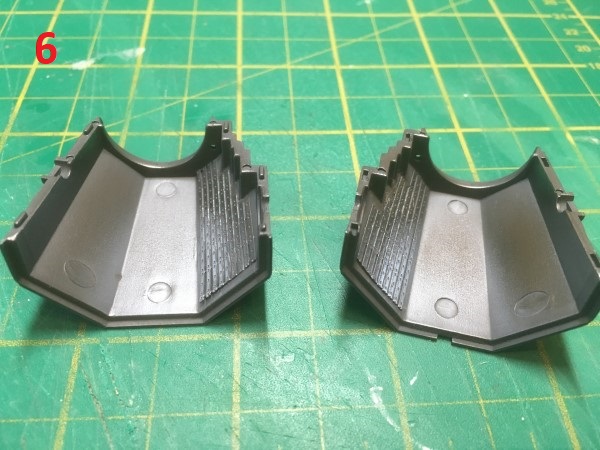

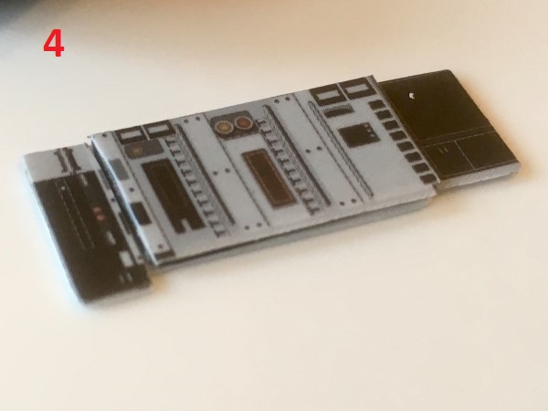

Pictures 1,2,3 &4. For the gunner’s room, I decided to try and give it a little more depth. I quite like to keep the adhesive panel stickers, but noticed on some of the reference picture, some of the panels stuck out more than others. Using some plastic card, I cut some pieces out and put in some raised areas. I then cut the appropriate sticker and attached it.
Picture 5. I then added some etched brass grating to the underside of the room. As you can also see in the picture, I have made a top piece to be added, as I didn’t like the seam where the two halves attach.
Pictures 6,7,8,9 & 10. I then sprayed the two halves with primer and Metalcote paint. Once dry I then dis a test fit.
Next, I will be adding some pipework, again to give it more depth, a little painting and then finally adding some red and amber lighting to the top side sections.

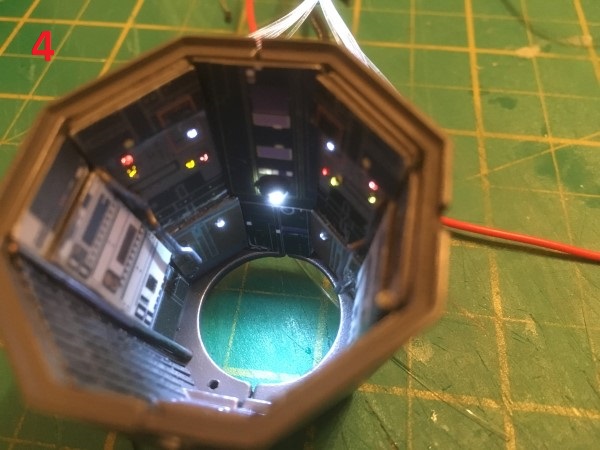

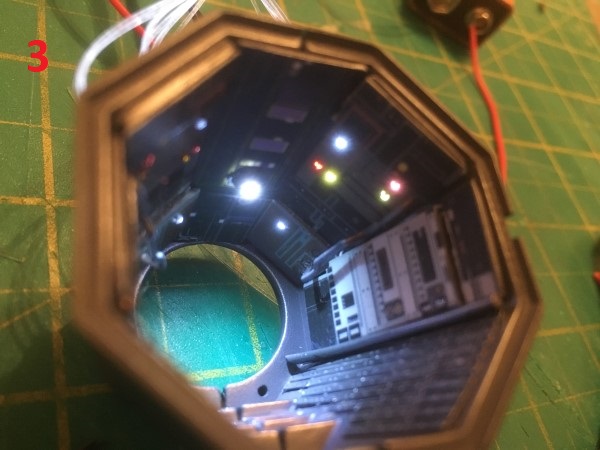

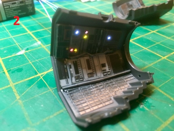

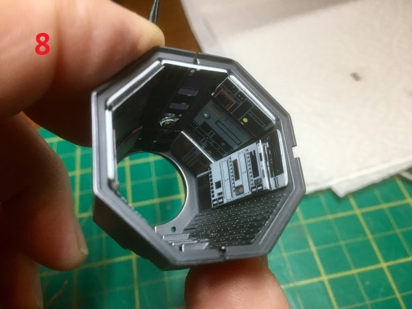

#4 Posted : 08 February 2017 00:27:26

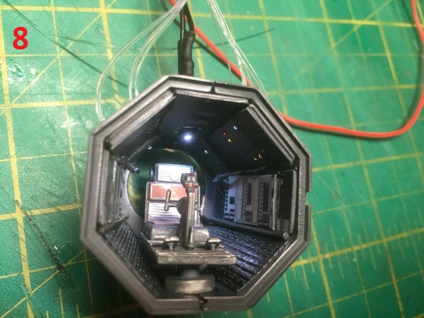

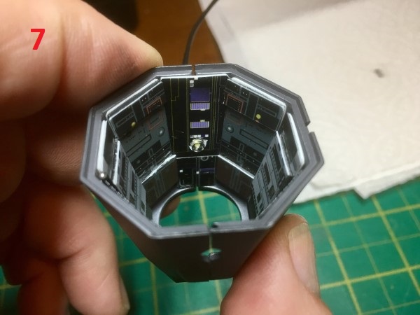

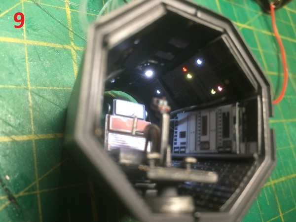

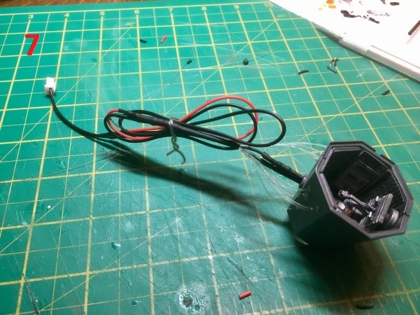

A little more progress. Pictures 1 & 2. I have drilled some holes into the top panels to both sides and fitted some fiber optic cables.
I used a 3mm white LED and coloured some of the optical cables with red and yellow translucent paint. As you see here I tested the lighting before I pieced the two halves together.

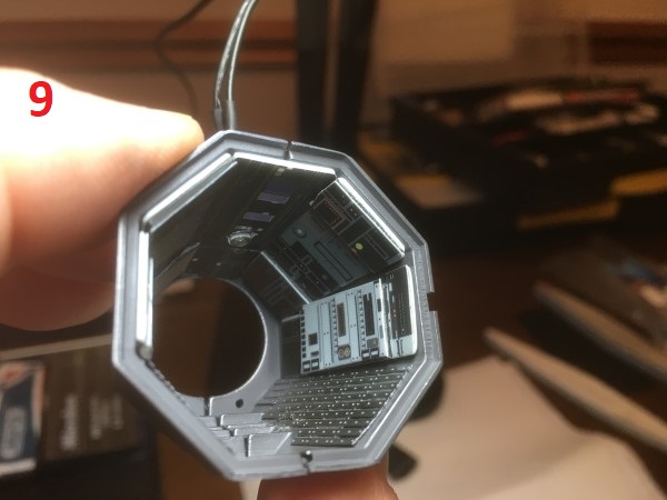

Pictures 3 & 4. Here is the piece with the supplied light in place. I painted the front part of the light black, so the light illuminates the rear of the room only and allows the fiber optics to be seen better.
Pictures 5 & 6. I then place the gunners chair into place to finish off.
Picture 7. This picture shows the gunners room with the wiring loom and fibers in place.

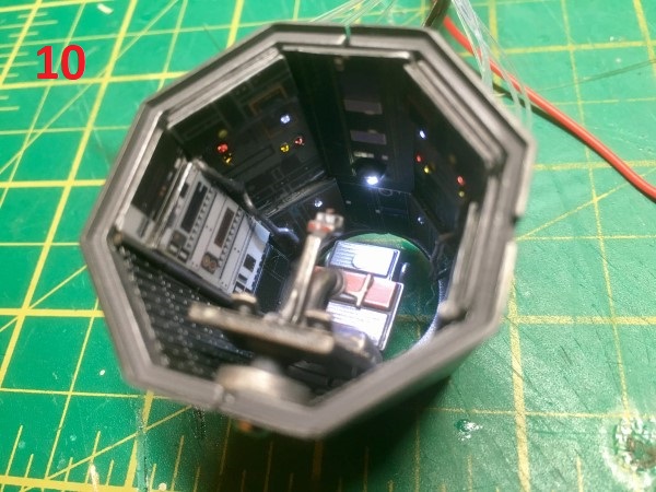

Pictures 8,9 & 10. And the final pictures of the finished gunner’s area with the lighting switched on. The pictures don’t really show the effect very well as I had a light shining on it whilst taking the photos.

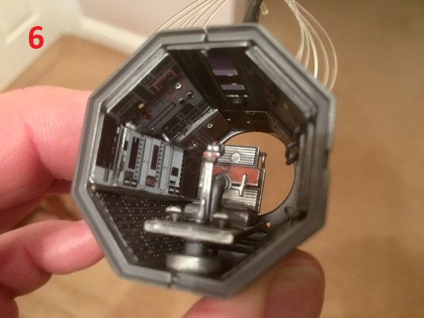

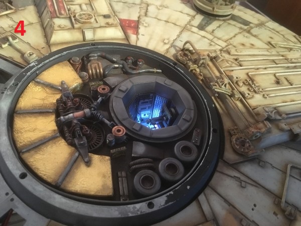

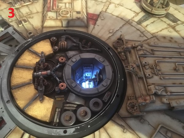

#5 Posted : 11 February 2017 16:57:19

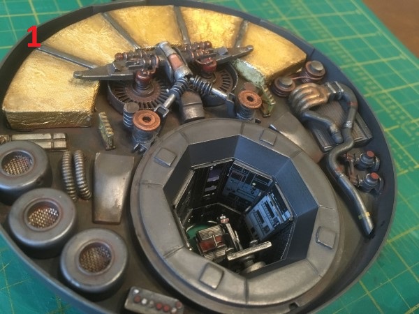

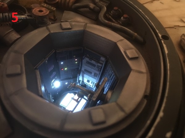

Pictures 1 & 2. I have now fitted and glued the gunner room to the internal turret section as shown.
I then test fit it into the hull with the internal sections in place, and everything fits as planned. Phew!!!
Whilst in place, I fitted the turret over the top and again fitted perfectly and snug. I now need to fit the other gunner room and glue it to the fixed turret to the lower section.
Pictures 3,4 & 5. Here are the pictures of the part in place and lit.

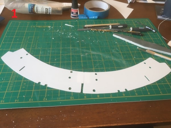

#6 Posted : 21 February 2017 22:33:08
A lot going on with the Falcon build. I’m painting the side panels to the mandibles at the moment, trying to finish off the second one before finishing the internal parts to fit the two halves together.
Whilst waiting for various painted parts to dry, I have started with preparing the sub light engine I have planned.
Picture 1. I have over the last few weeks deliberated on how I wanted it to look. As you can see in the illustration below, from a book I have, I wanted the rear section to have a little more depth and realism than the original prop model.

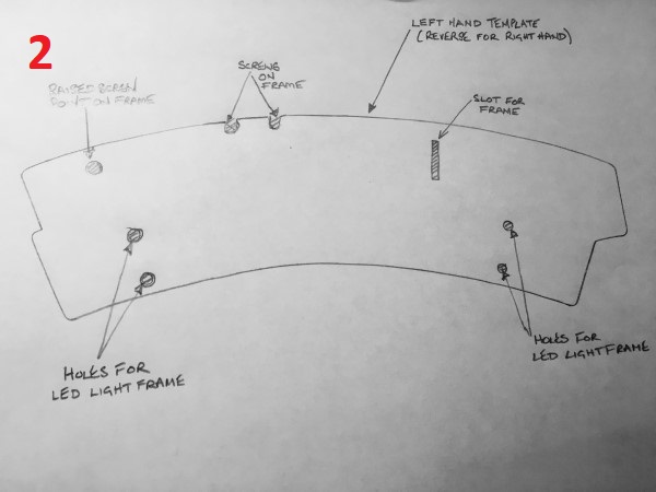

Pictures 2 & 3. I spent several days working out how I was going to make it look how I wanted it. Here, are some drawing and template I did as an experiment.

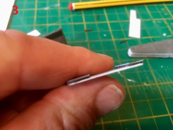

Pictures 4,5 & 6. I then made the template using plastic card and test fitted it to see how it looked, along with the supplied part. I was very happy with how it looked and decided to continue with the sub light engine.

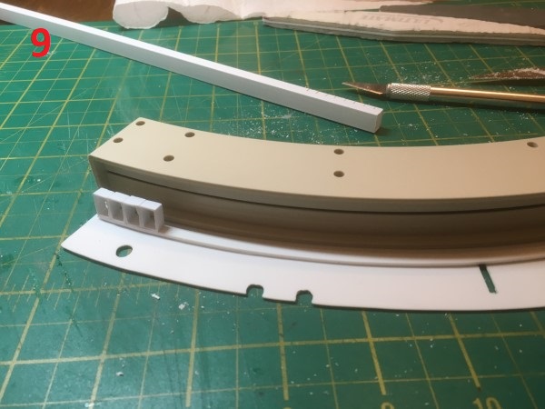

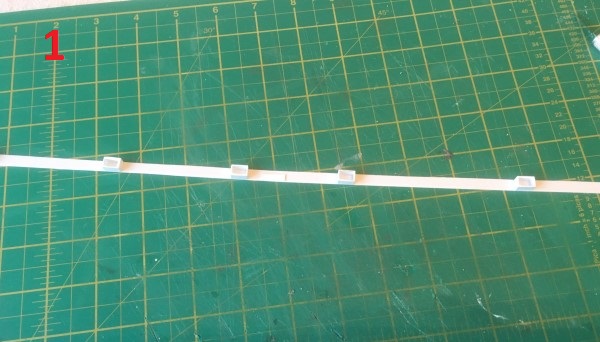

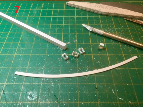

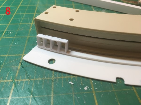

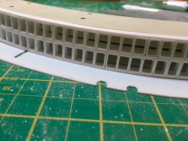

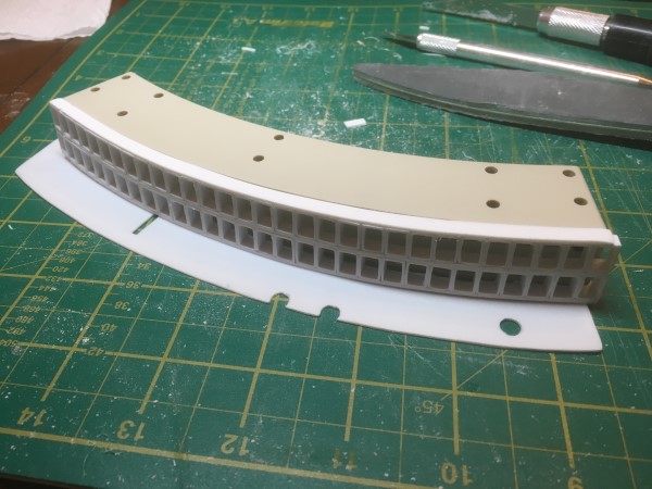

Pictures 7,8 & 9. For the sub light engine, I bought some plastic rectangular tubing and cutting them in 5mm segments and placing them on a 1mm cut plastic card. Gluing two lots of the tubing segments above each other and three lots of 1mm plastic card, the total height will be 22mm. Using this method means I don’t have to drill any holes and it will look very similar to the illustration in the first picture.
I’ll show more when finished this part, but I hope it gives some idea of how it will look.

Pictures 1 & 2. A little more done today. I have cut the right-hand side base for the sub light engine. The second picture is the test fit.
Pictures 3 & 4. I then sprayed it, first with primer and then a metallic silver paint to give it a reflective surface creating more light for the LED lighting. The photo doesn’t really show the silver very well, because of its reflectiveness, still looks like the white unpainted plastic.
Although I still have to make the right-hand side sub light engine, I have painted the left hand side with metalcote steel paint and then test fitted it. The last few pictures are to give some idea of how it’s all coming together.

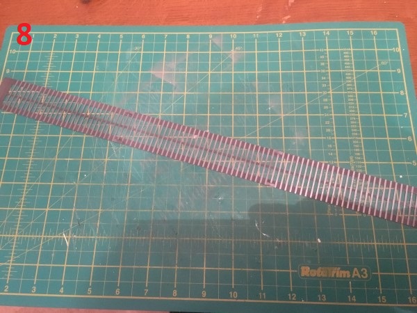

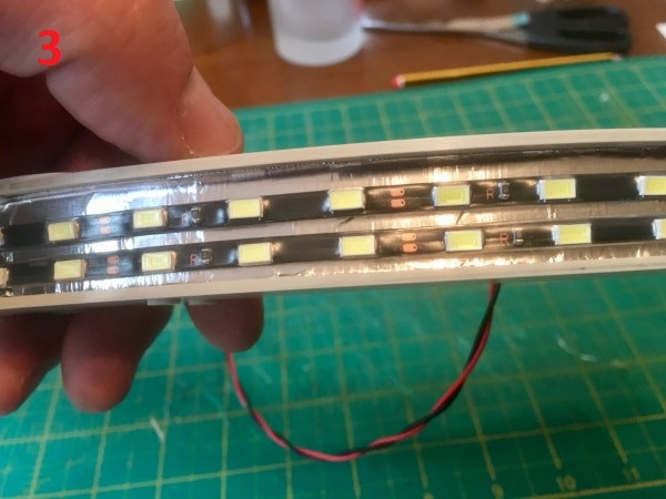

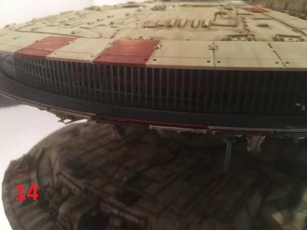

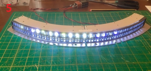

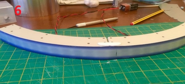

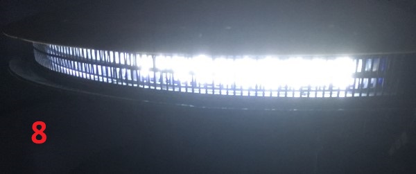

#9 Posted : 26 February 2017 21:01:23

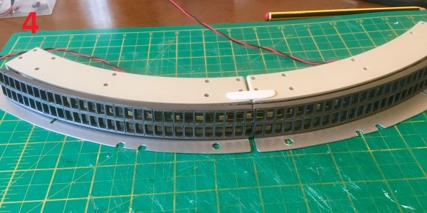

Pictire 1. I have finish the right-hand sub light engine and attached it to the one I made earlier, so it is now one piece. I have also attached the supplied light housings together, that way it will be easier to attach the strip LED lighting. You can also see in the picture below, that I have wired two strips of LED lights, these have been made at a length to fit across both housings.
Pictures 2 & 3. I then stuck some aluminium foil along the front of the housing before sticking the strip lighting in place. Once everything is fitted, I then screwed the top and bottom housings together.
Pictures 4 & 5. Next, I fit the relevant pieces together and then attach a 9v battery to test the lighting.

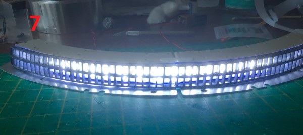

Pictures 6 & 7. I then defused the lighting effect, so you could not see the LED bulbs. As you can see, it defuses the light to give a more even effect. It also makes it brighter.
Picture 8. I then sprayed the grill with primer and metalcote paint, before I test fit it all in the Falcon housing.

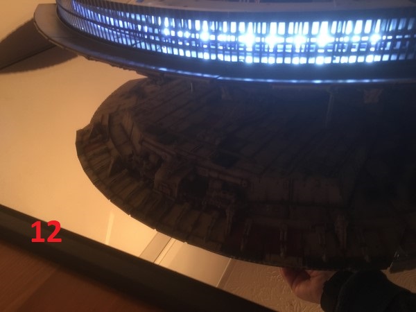

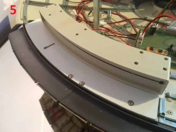

Pictures 9,10,11 &12. Here it is fitted into the Falcon. I have not screwed it in place as I still have some final detail to do and then some weathering to finish it off.
Pictures 13,14,15 & 16. The final pictures show it with the top panel in place.

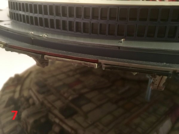

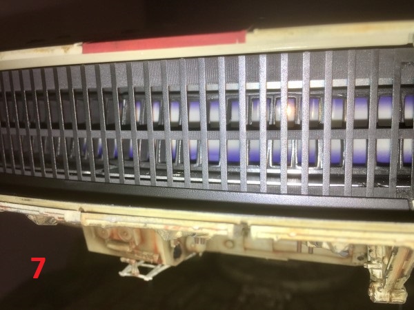

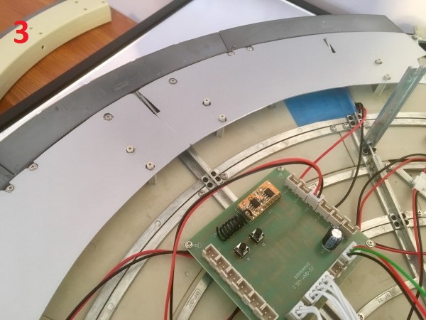

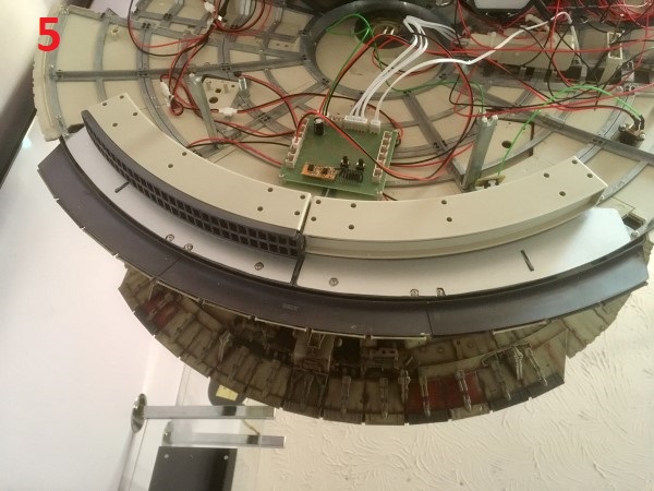

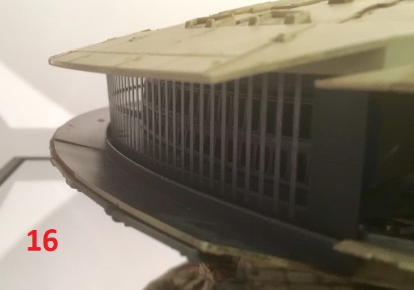

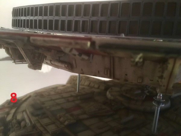

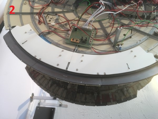

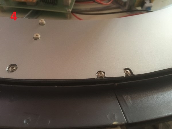

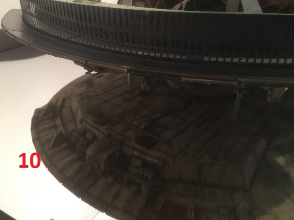

#10 Posted : 06 March 2017 23:30:13

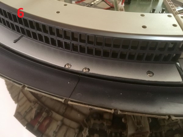

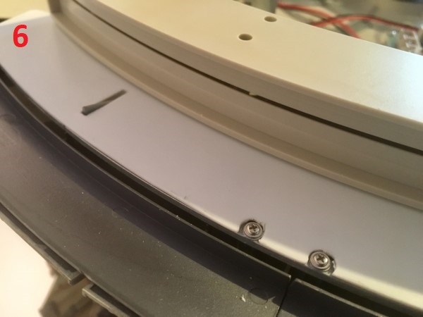

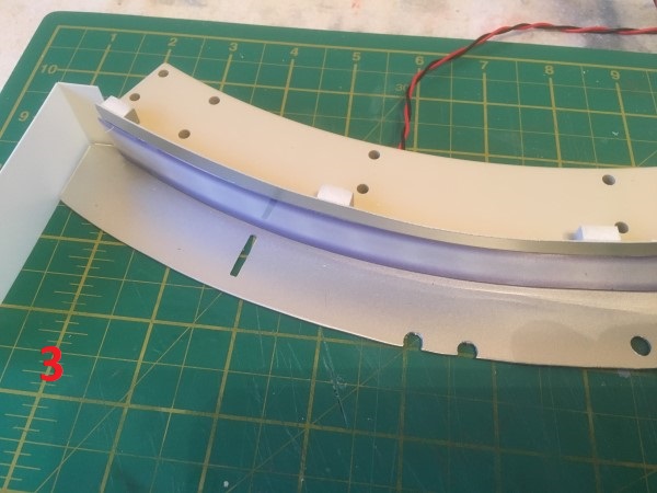

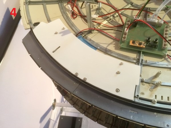

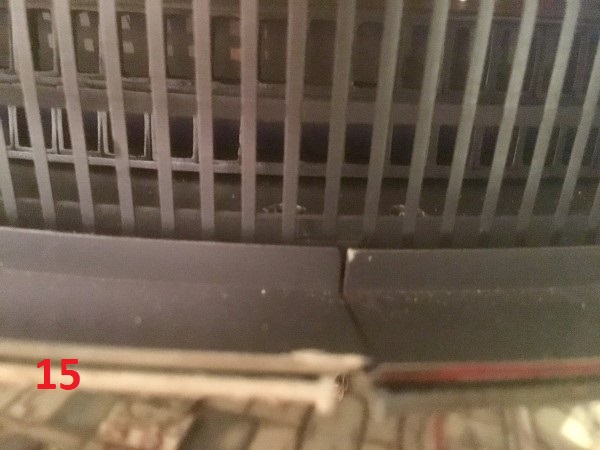

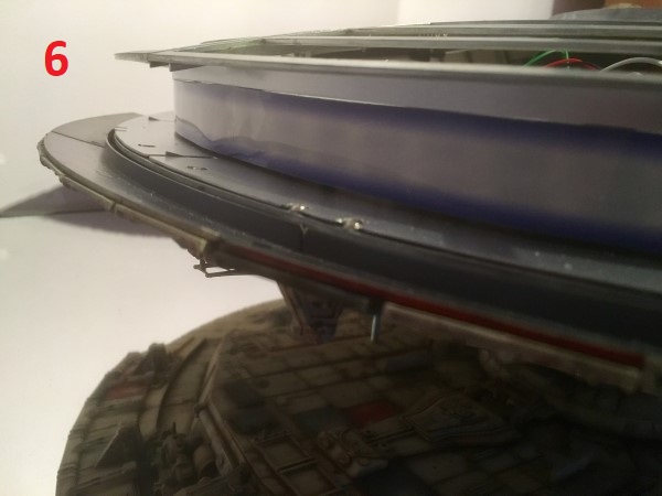

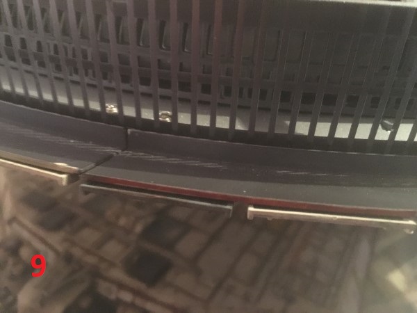

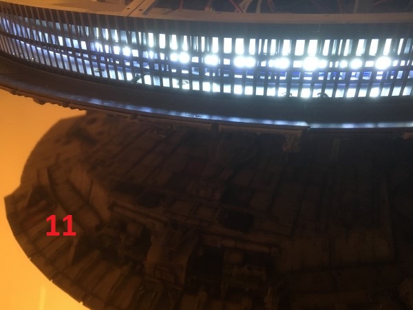

Pictures 1 & 2. Whilst I am doing a lot of painting on the hull sections, I did a little update on the rear sub light engines. The top part of the lighting area has a gap, and causes some light bleed. So, I decided to close the gap with a strip of silver painted plastic card to reflect the light towards the rear.
Pictures 3 & 4. I then painted it with reflective silver paint and glued it into position on the supplied parts. As you can see in the pictures below, I will also be making some side panel pieces.

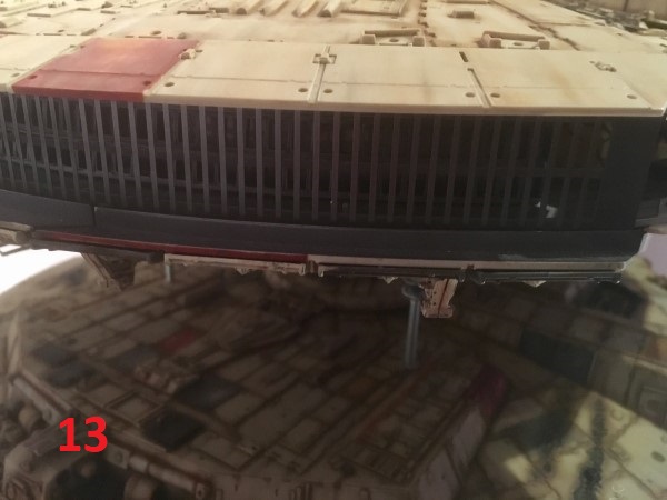

Pictures 5 & 6. I then placed the unit inside the Falcon. As you can see, it closes the gap above.
Pictures 7 & 8. These pictures show it with everything in places. The last two are with the lights on.
