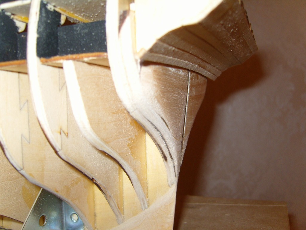

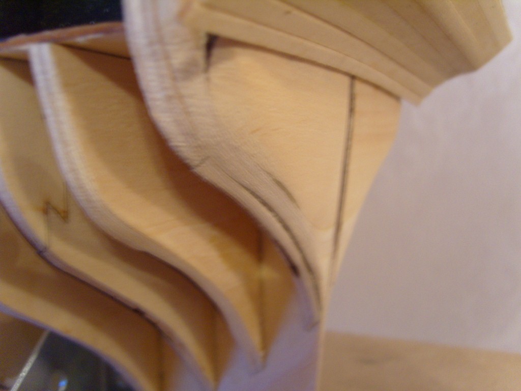

after last weeks 1st attempt at fairign i have spent the morning re-fairling the stern. is it ready now or do i need to do more of an angle from top to bottow?

The both halves of the final frame need to be flush with the keel following its angle down, looks like you have a couple of mm to go

cheers tomick.. will have another go with the sandpaper and repost for your comments if i may

hi tomick and all others,
you know when you have one of them eureka moments.... i just had one with your post and all has became clear. i have now sanded the stern pieces so they are flush with the false keel and think i am ready to start planking, which will hopefully start tomorrow as its not quite so messy and the wife gets a bit Cursing with me with all the sawdust over the furniture.
Thank you all for your help as i am a total thicky when it comes to wooden boat building, im more of a plastic kit builder, my lifelong hobby. its good to get out of the comfort zone.
