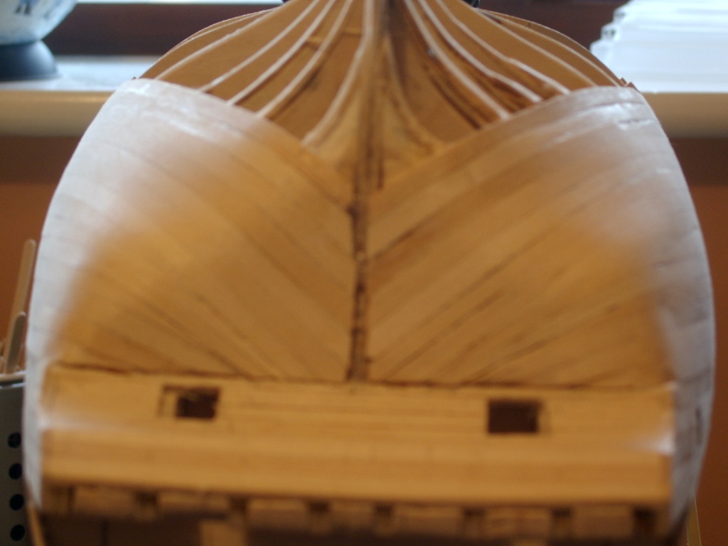

Here are my attempts so far and I seem to have hit a snag or two. Hopefully, someone will be able to shed some light on where I have gone wrong and I hope that you Tomick will be better qualified as to what I can do??
[/img]
When I came to start the lower planking of the hull around the bow, I found that the gap between the 1st three planks was just 1mm, so just carried on in the usual way, tapering those planks as I went. My question is: What do I do next? Do I carry out the procedure issue 32, page 12 from step !?
MY next problem is at the stern as you can see from the pic's:
When checking my model against Issue 33, I find that I somewhere, have gone wrong because you can see, I have gone further round with too few planks? Now, will I be able to get round this, or will I have to bite the bullet and strip those three planks out and start again??? Any suggestions ship mates.

hi tis,hope your aches and pains will get sorted out,good luck with that...on your second to last photo it looks like your planks are not secured flush with the ribs (BOTTOM PLANK LEFT HAND SIDE)the plank looks to be away from the rib at the bottom, if i am right take that one off and taper to fit..maybe the others are the same..cheers benny...by the way glad to see you have started your diary

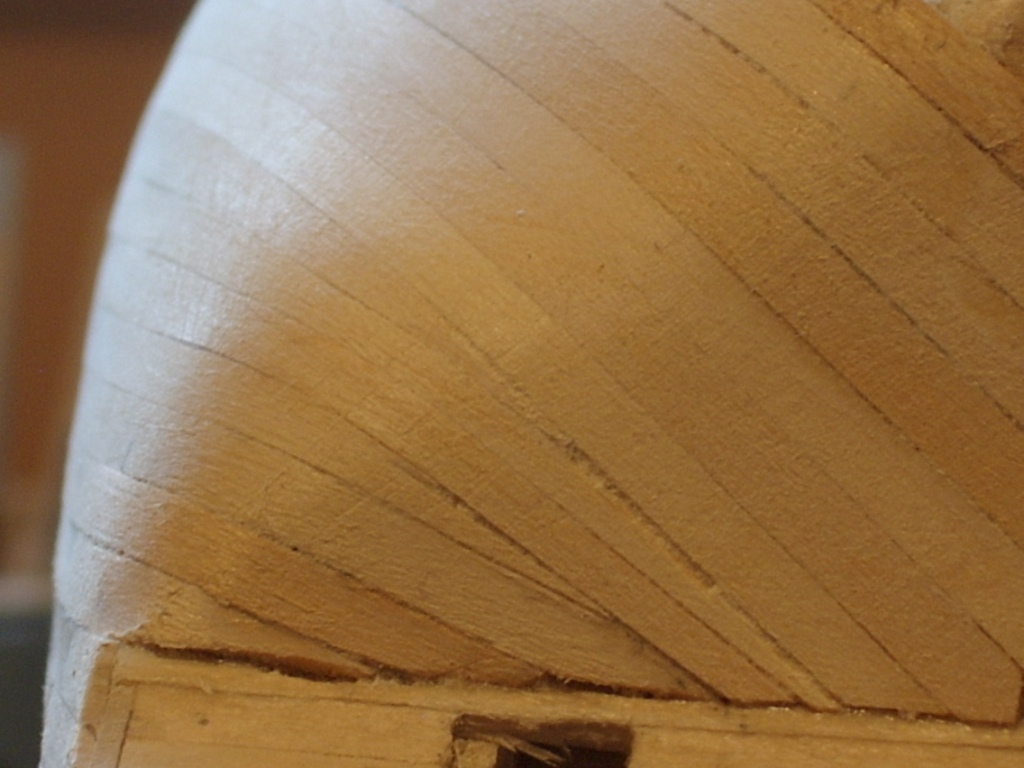

You will possibly find that the next plank over laps the first three by some margin,
Mine did and I removed the planks and tapered them all to suit, but this made them pointy at the end and did not look right.My solution was to very slowly trim the first three layers back to where the overlaping plank lay in order that further planks would follow in line. Picture attached, this is a close up showing the join which when sanded will be OK. Repeat on other side and you should be fine and dandy.
I know this is not strictly to the book but other than stripping all the planking back and refairing the stern section could not see any other way.
I hope this is of some help.

CMB

The stern strips appear have not been tapered, and the last of the strips appears not to be seated at the frame side.
If you want to avoid a strip you could do as CMB suggests, or strip and re-look at the stern fairing then re-lay, but ensuring there is adequate taper for them to sit neatly upon the transom, and don't let the any planking shortfall gap beneath the gallery get any wider than 2mm.

I'm in no way an expert, and don't know if its any help, but with so many people looking at double planking, perhaps you could just carry on regardless, and then try and get the finish better with some veneer

thankyou guys for your input. Will strip out the two problem planks and start again. Any views on what I have done and what needs to be done at the bow?

hi tiswas,as you are having probs, with the stern,get that right first,advice given so far is excellant,the bow is a different kettle of fish,look at darrens threads,he show exactly how to go about it,you will need to use droppers from the word go.to stop the clinkering effect,even if the first plank goe's round the bow nicely you still need to taper,so the next tapered plank starts to rise up the bow.this compound curve helps stop clinkering,I found it best to work with three planks at a time,and working out the taper to each one,and determining if droppers are needed.
