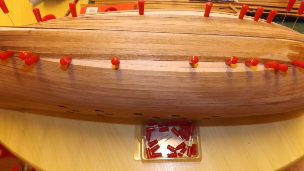

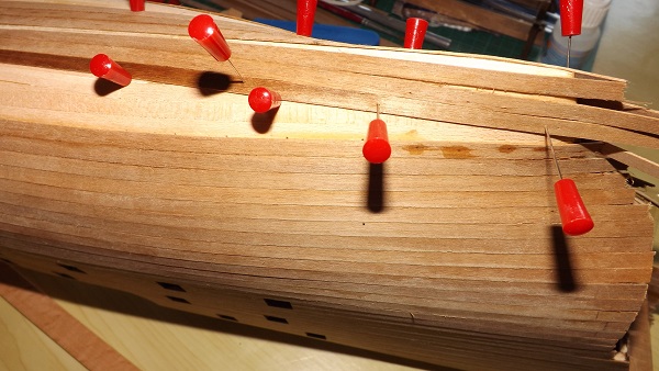

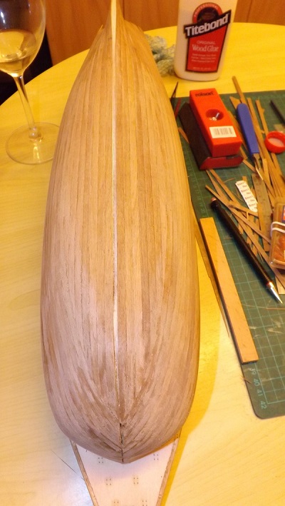

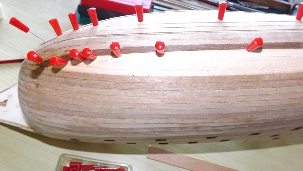

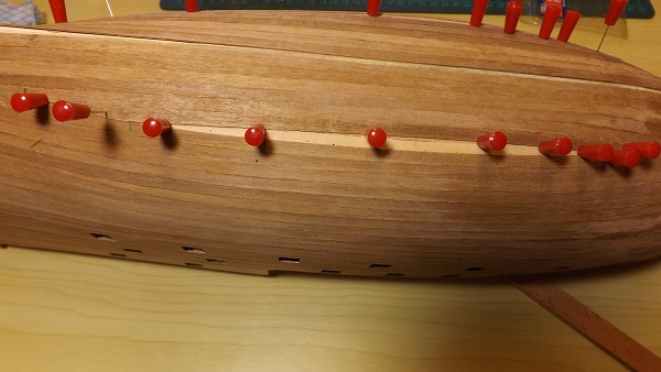

#148 Posted : 07 January 2017 21:38:39

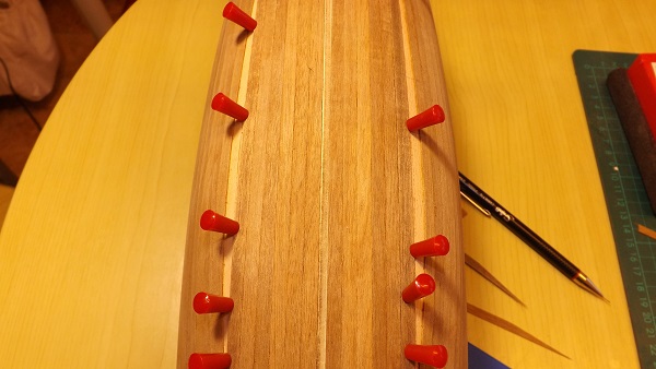

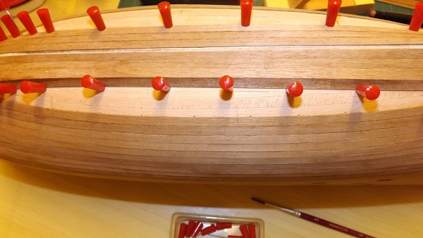

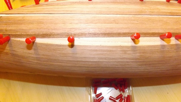

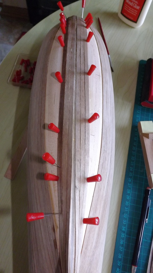

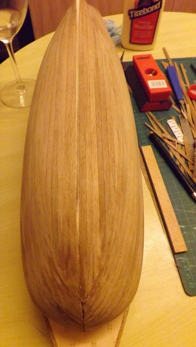

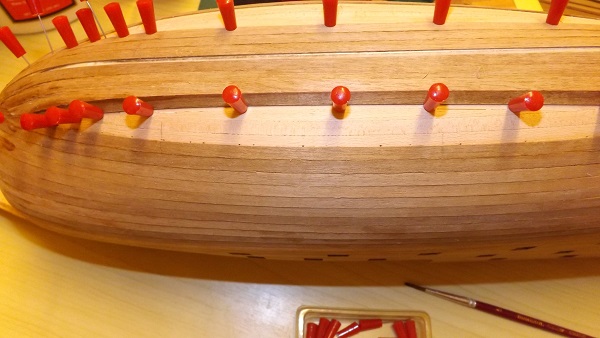

Saturday 07th January 2017 - Hull Planking now Complete BigGrin
Well after one of the worst Christmas times ever with some "weird" disease I contracted my best laid plans were somewhat delayed but I finally managed to finish the second planking on the hull of my Revenge.
Still some plank end trimming to be done and some (but really pleased its minor) final smoothing down to do.
This part of the build seems to have taken a "forever" and I never thought I would get to this stage with the kit. To say I am pleased would be the understatement of the year.
I really struggle with hull planking and my methods of soak, pin, dry, remove, glue is not a quick process but in this case I am pleased with the port and starboard symmetry I have managed to achieve.
Any filling is really minor and I will use sawdust from the walnut planking sanding mixed with glue to fill any minor areas.
Here are some final pictures from this part of the build. BigGrin
